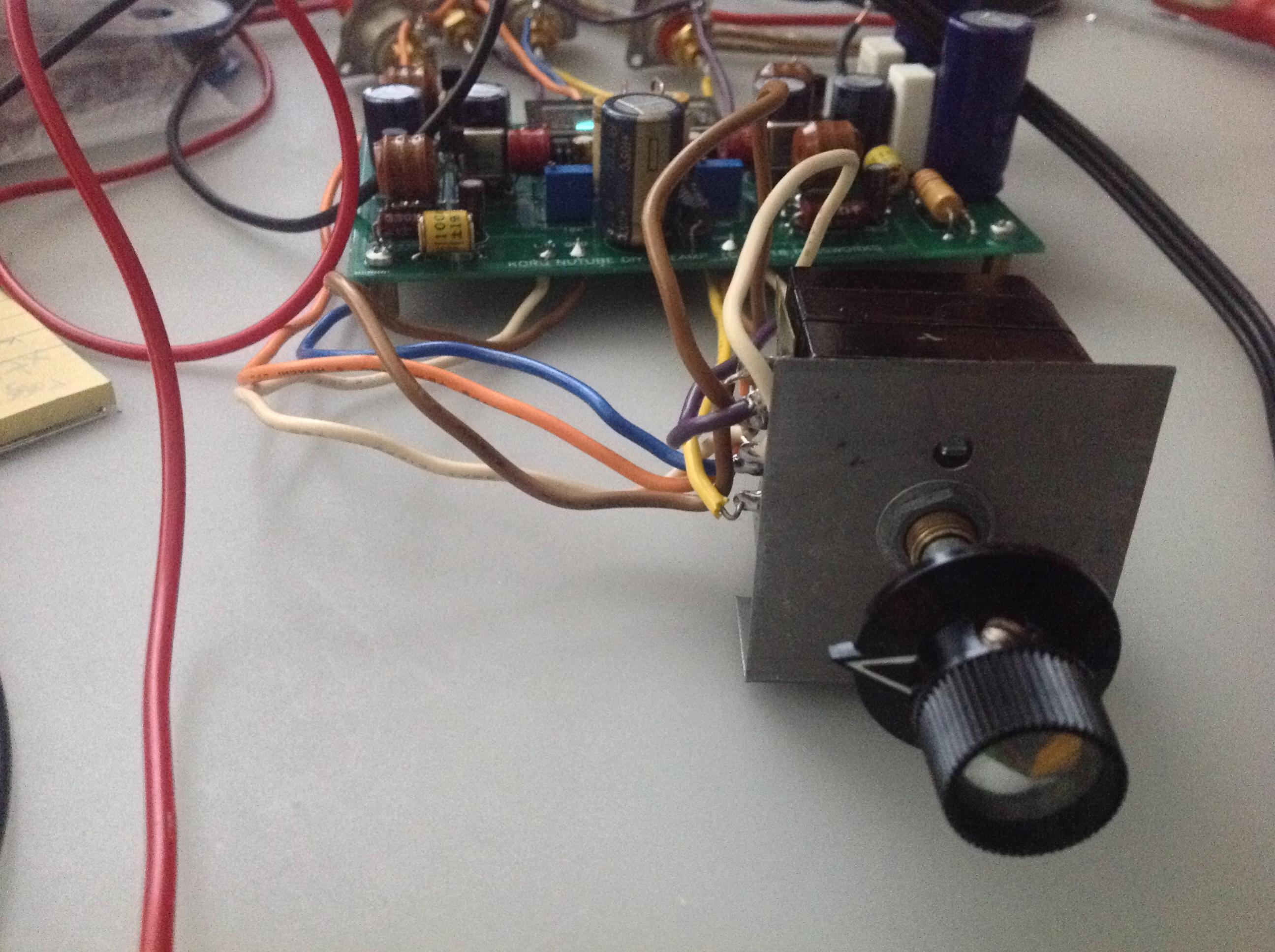

B1 with Korg Triode

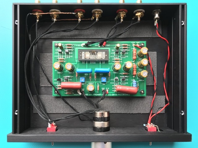

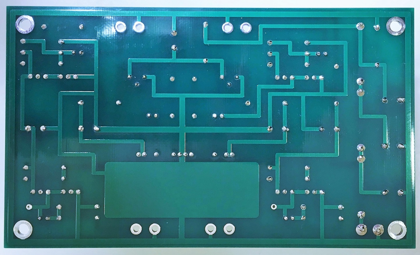

Volume pot is grounded at the board. Star ground is the large trace at the back of the board where inputs, output and power are grounded, as well as a single ground wire to the chassis. The pot is grounded through a dedicated trace on the board -- single ground path so no potential for current flow resulting in hum.
Thanks, can you please put some pic on how your connections are done. When you say large trace at the back of the Korg board I am not sure what you are referring to on the pcb board.

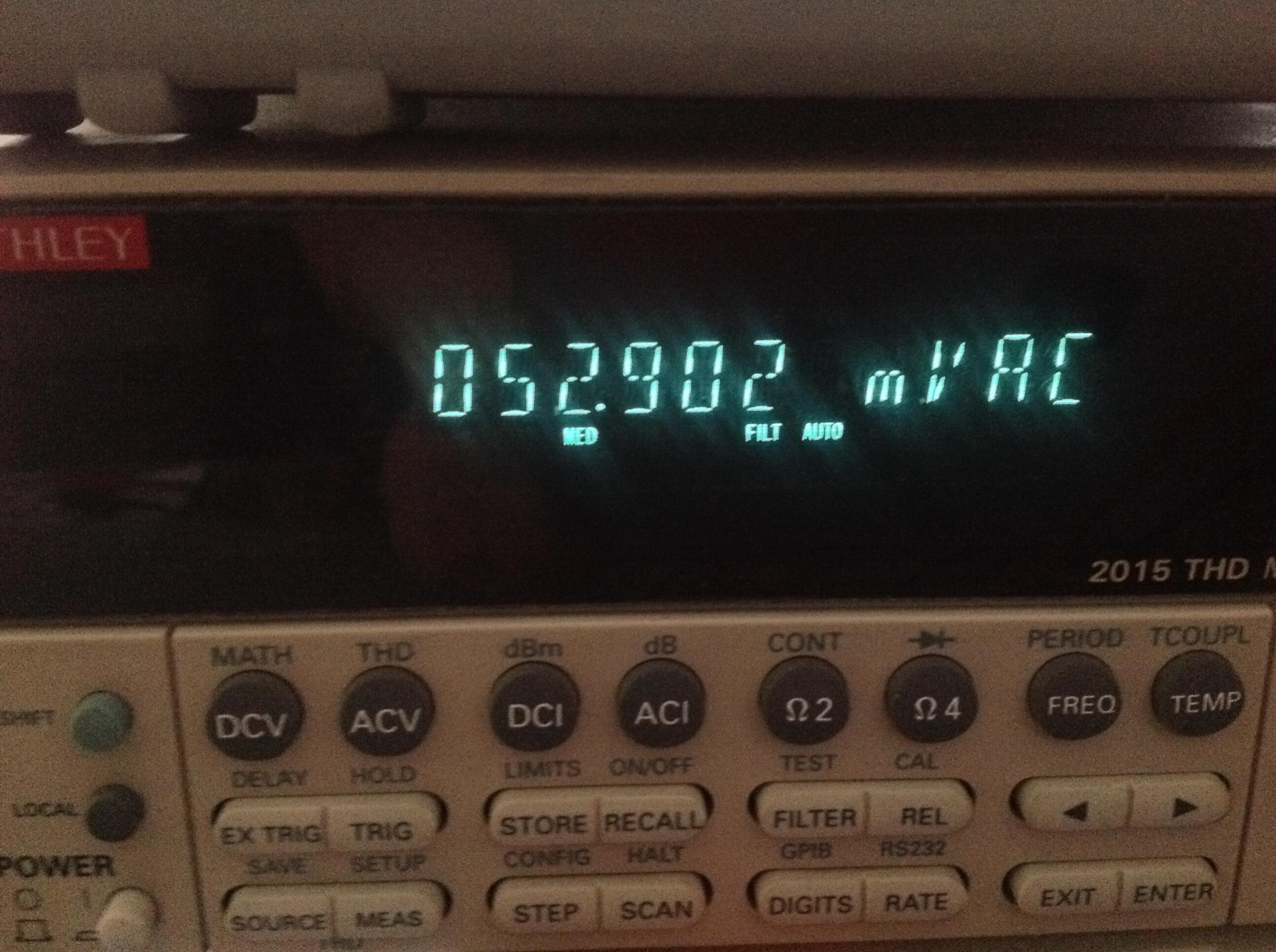

Hmm, might be tired, but THD 0.02% sounds very low to me... what output level is that in terms of V?
See on the photos at 9 o clock output is in low voltage range ~ 053 mV.
Potentiometer position at 12 o clock give 1.28 V at the output.
It's a work in progress.... preamplifier needs good quality chassis now.
Twisted wires or parallel doesn't make an audible difference, twisted are neat.

It is an interesting Multimeter with THD measurement?
I think 0.03% THD is correct during "normal" use and listening level. If sensitive speakers and a power amp with some gain the output voltage needed from Korg is quite low.
Yes Keithley do the electronic hobby job EEVblog #478 - Keithley 2015 THD Multimeter Teardown.
You right MEPER speakers are 98 dB and amplifier with gain of 20 dB and audio source DAC output are 2V.
The trace around the periphery of the board is the common ground point for input, output and power grounds. Post #1396 shows my wiring scheme. If I had placed an internal power supply within the case (either analog or switching) I would have shielded (coax or twisted) the inputs and connected the shield only at the input jacks.

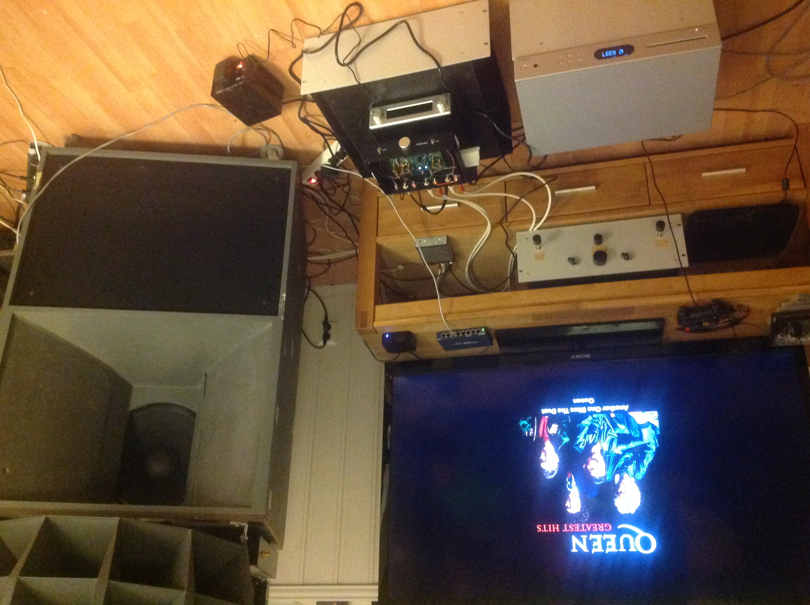

Just finished a diyaudiostore B1Korg kit. Running in now with ~ 9.6 V. Sounds quite good. Maybe a little bitt mellow as pre for my M2s. Need to adjust my ears, just came from a passive relay volume pre. Lots of detail and heft, no aggressiveness. Great pre 🙂
Some ringing when turning on and switching source, how erwer my altecs seem not to excite the korg. Runnig through a 230-110 trafo as I dont have a 110-230 adaptor for the std external powersupply.

Do reverse polaritys of the speakers make B1Triode phase effect on Your Voices of the Theatre ?
Thanks Soundhappy. Well triode phase effect, Im not sure, they have a lot of detail but still a smooth and rich sound signature. 3d is good, as far as the Altecs can conwey 3d. They dont however turn my M2 into a 300b amp. I have 300b, pentode driven, monoblocks to compare. Need to try them with other amps. Espesially a rather harsh and overcontrolling class D amp.
Thank you now I got it. I used one of the mounting legs as ground point in mine and used nylon legs to isolate the legs from the chassis mounting. But I think I may need to revisit my wiring after looking into yours as I get hum with a LDR based source and volume control all in one board.
