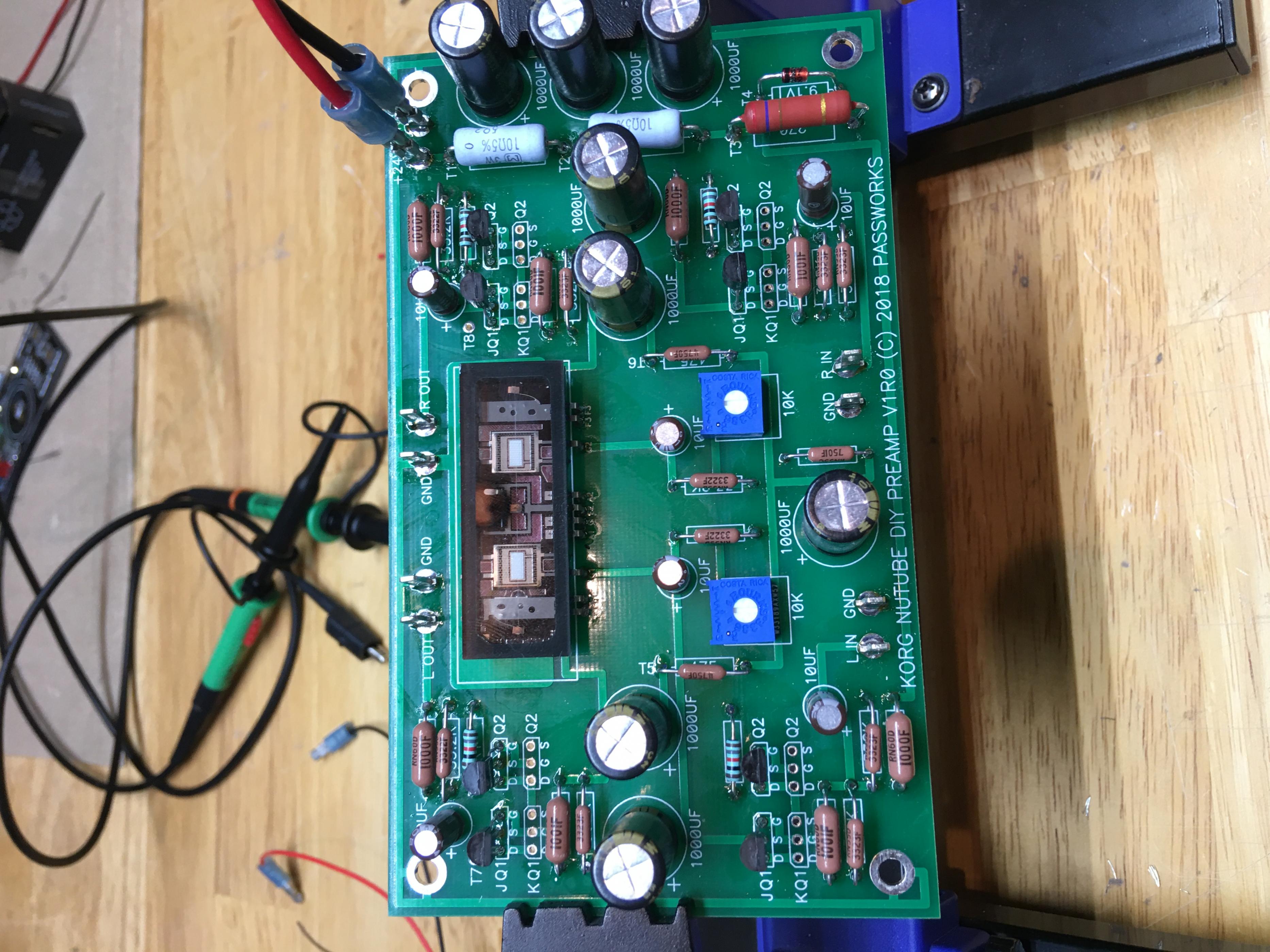

I reflowed the solder on every joint and added a touch of solder here and there but it did not help. I am still getting an imbalance between L/R channels. Left is louder side.
Voltages:
T1 = 24.15
T3 = 22.57
T4 = 9.26
T5 (Left heater) = .68
T6 (Right heater) = .69 (this is quieter channel)
T7/T8 = 11.8 (set it this way personal preference)
Source pins seem to equal between both sides on input and output JFETS at DC voltage.
Drain pins seem to be equal between both sides on input and output JFETS at DC voltage.
AC wise when playing sound, the input voltage on the board is mostly equal between L/R but output voltage from board is (for example) .3 - .7 volts AC on the left while right is .2 -.4 volts.
NuTube lights up equally well between both sides but I did not measure the pins.

On my channel imbalance, I have been checking AC and DC voltages trying to narrow down the problem spot. I am getting equal AC/DC reading between channels at the anode side of the Nutube. I am getting equal DC at T7 and and T8 but not AC. At whatever level I had it at, my Left channel was 12-13mV AC and right was 11-12 mV (playing dual mono pink noise). I am thinking my problem is at least narrowed down to either the 1K resistor, the output Q1/Q2 or the bias resistor for Q2.
I did check every resistor to verify it's the right value and within tolerance before I installed it, could've still made a mistake of course. If its a problem with Q1/Q2 can I change the bias resistor to make up the difference? If that is an acceptable resolution, how do I calculate what value it should be?

You could try swapping Q1/Q2from left to right channel and see if the problem moves.
