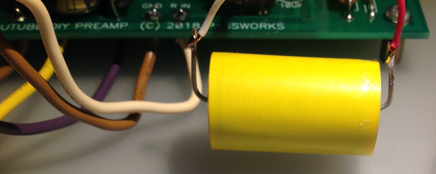

To the better or .... worseSoldered wires for experiments with bulky MKP caps etc....yes music presentation is changed

Haha is DIY fun with audio Is subtile nuanced not binary simple game.To the better or .... worse

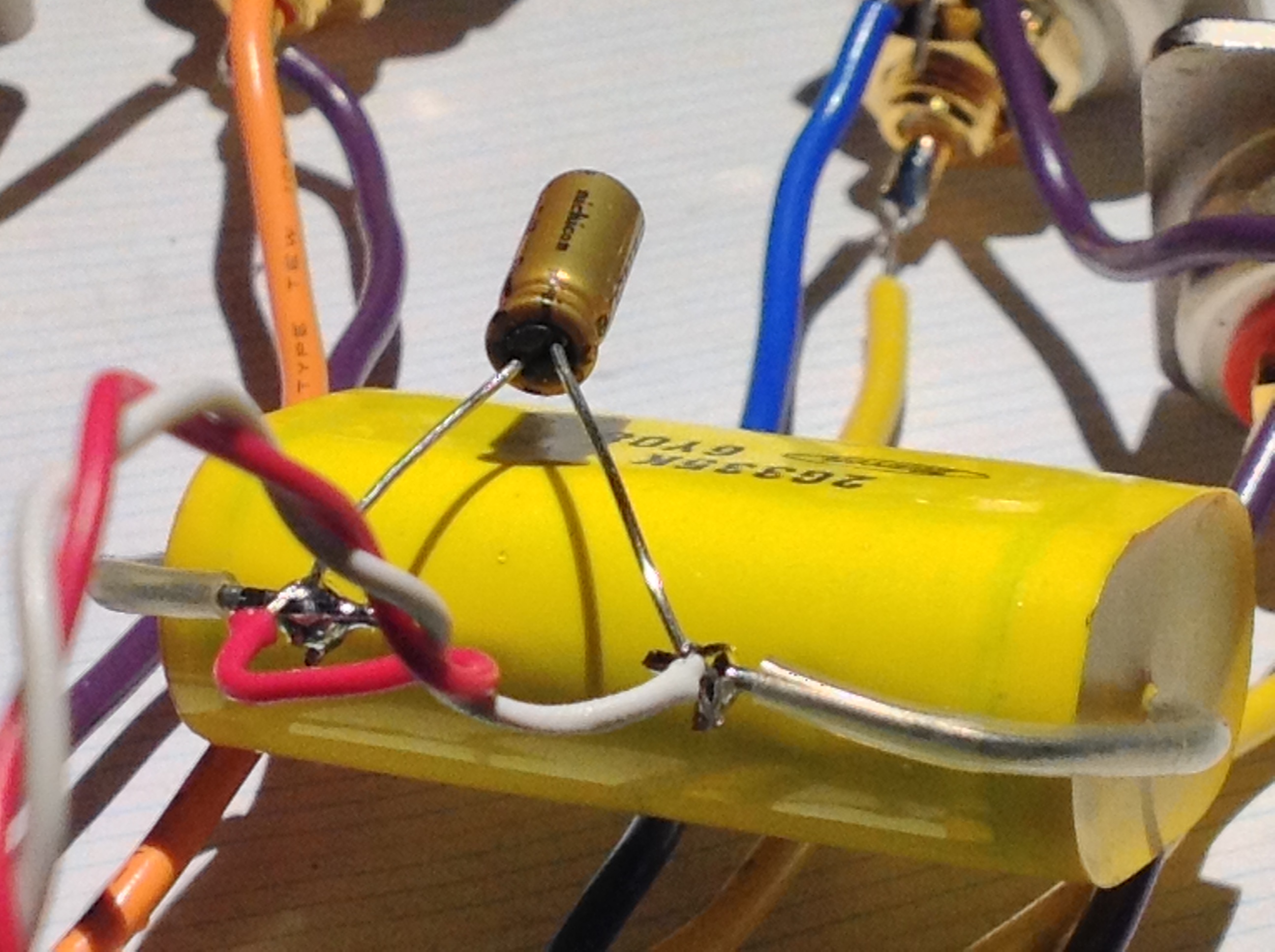

Last evening first was this 3uF yellows then soldered in parallel another 2 uF for total of 5 uF.
Now I have under test back 10 uF Silmic II but bypassed with 5uF MKP + little styroflex
Often the physical large caps picks up a lot of noise. The very large caps may be better for speaker crossovers where current is much larger and signal across the cap can be large compared to a signal bypass cap where signal is small where cap has not much influence on signal. I have learned to use the small E-caps as signal bypass caps. Before I was quite obsessed by the large MKPs used as signal bypass cap (DC-blockers).

..Before I was quite obsessed by the large MKPs used as signal bypass cap (DC-blockers).
