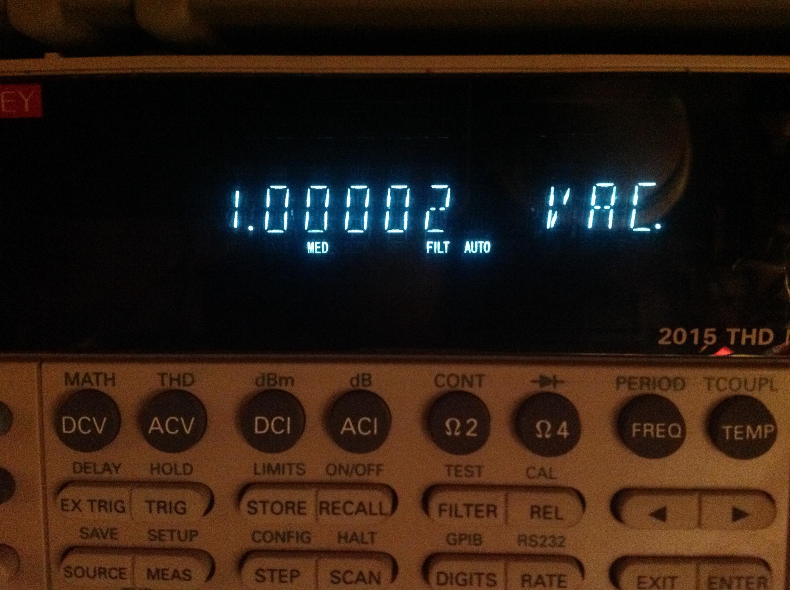

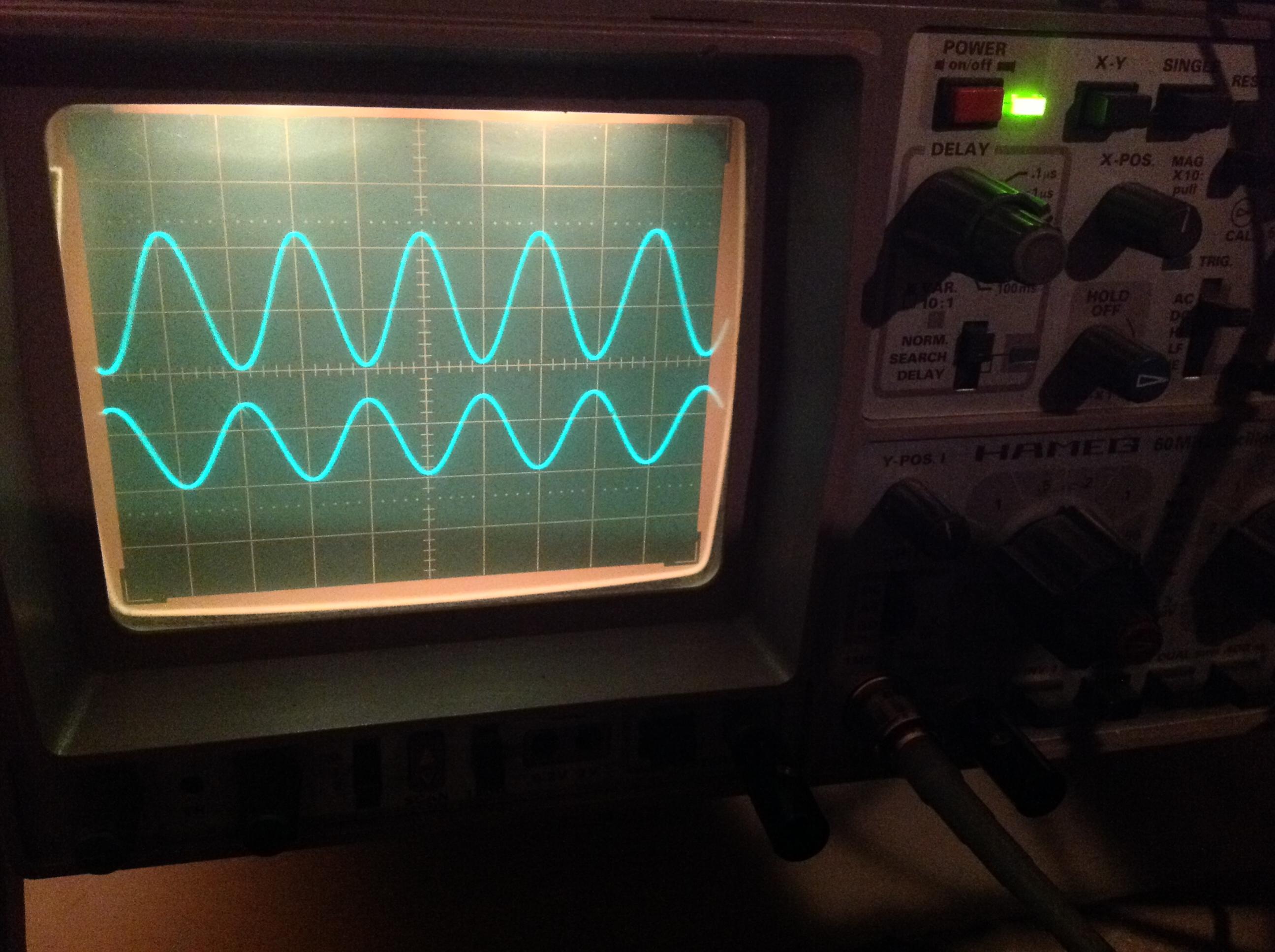

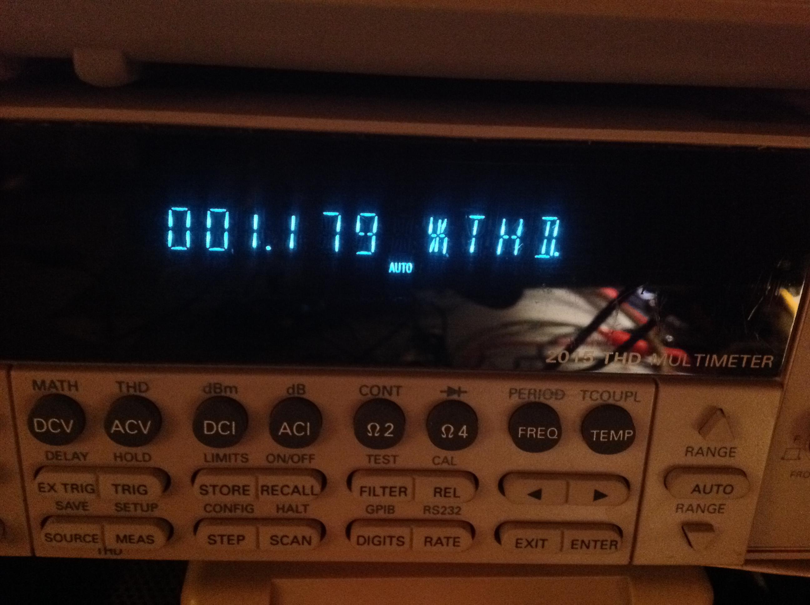

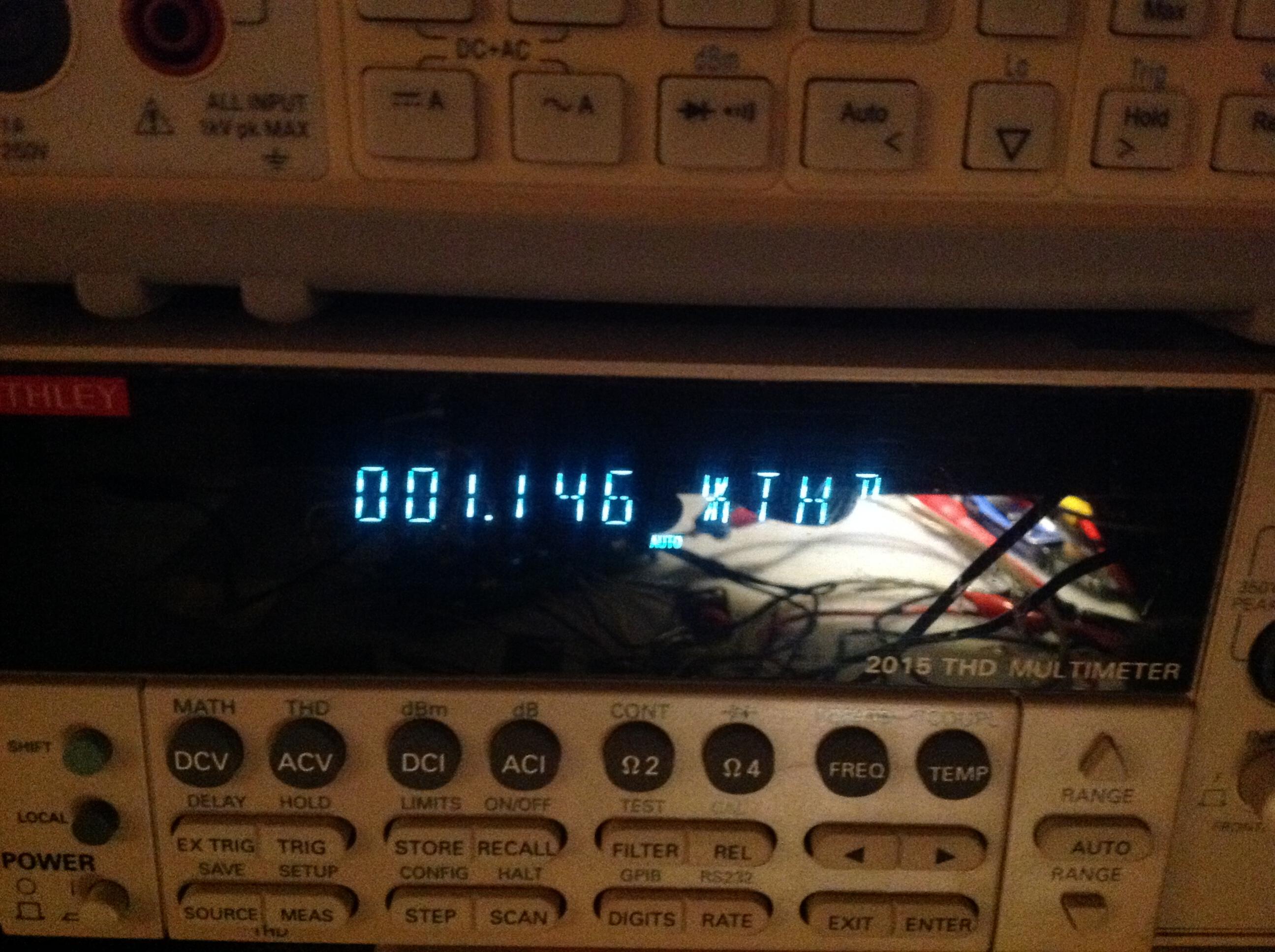

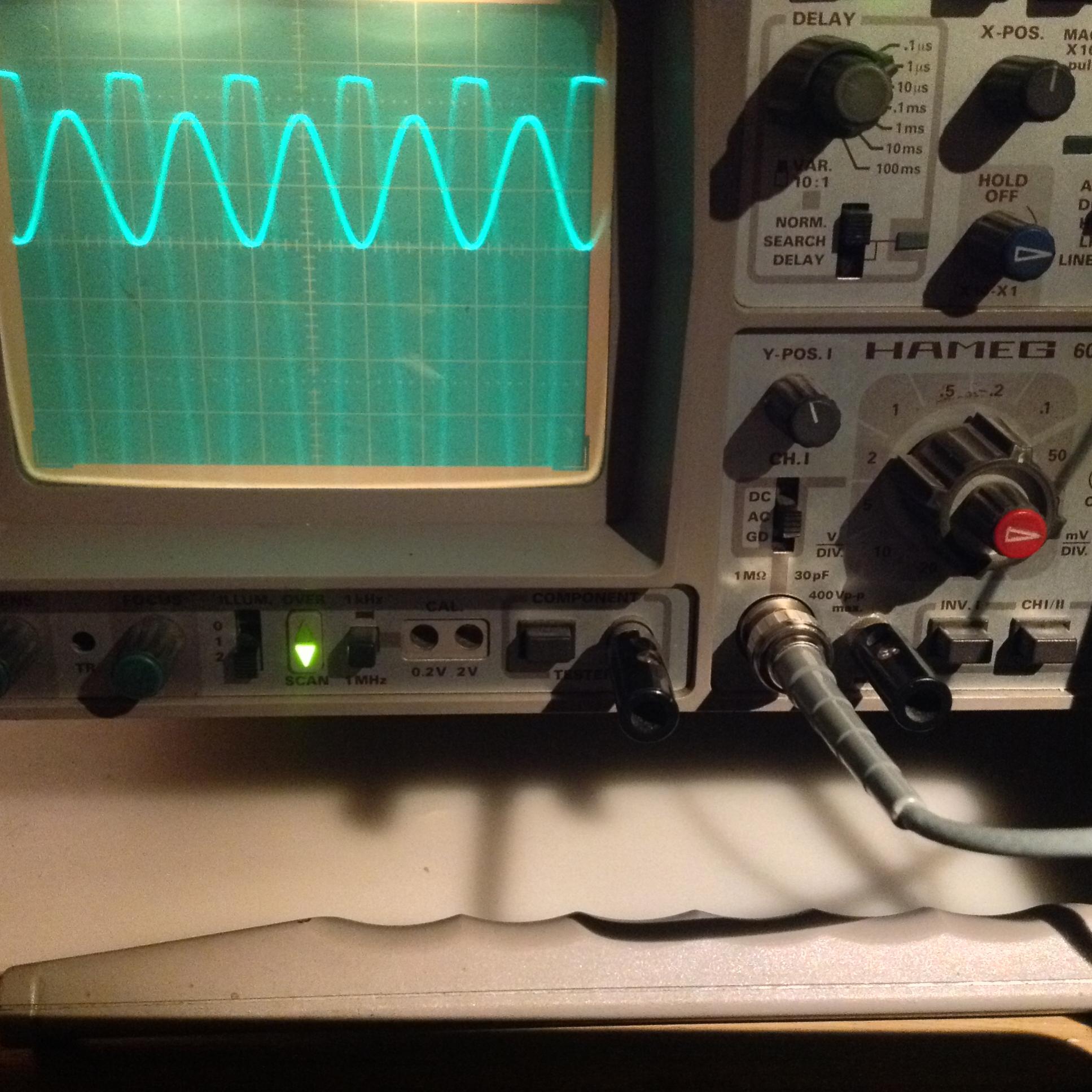

Korg two channels level and wave shape
After my errors bugs correction wave shape , amplitude and distortion are better now
1V output distortionTHD are L = 1.14 % and R= 1.17 % Signals clip at maximum volume = 7 V see on the last pic.
If I play music on my Hi-Fi volume potentiometer are in 9 o clock position and THD = 0.02 ~ 0.03%

Hmm, might be tired, but THD 0.02% sounds very low to me... what output level is that in terms of V?
It is an interesting Multimeter with THD measurement?
I think 0.03% THD is correct during "normal" use and listening level. If sensitive speakers and a power amp with some gain the output voltage needed from Korg is quite low. Also the reason I found Korg more neutral sounding than expected (positive for me)…..and also therefor Korg was a very good combination with MoFo in my setup.
