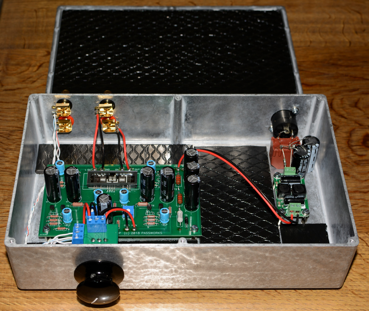

My Korg B1 using the DIY Audio external wall wart power supply is still sensitive to placement of other mains carying cables near it. I think you need to re-position the two boards as far from each other as possible in the case then put a shield over the power supply or at least a vertical barrier. Very nice looking case though.

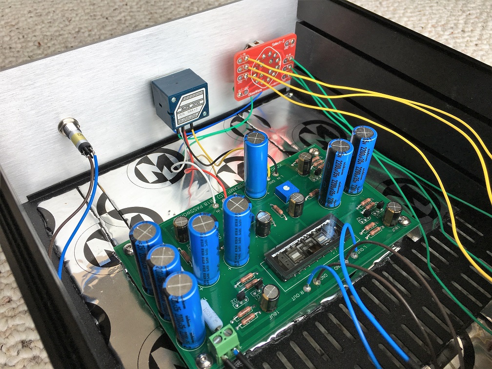

An update on my unit: Hum problem solved. I tried grouping all of the RCA grounds together as suggested but it made no difference so that was not the problem. However that did lead me to discover that my chassis to system ground did not have continuity. The MeanWell PS I am using has one corner for its ground so I connected everything to it because it was in the most convenient spot for my wiring. Since the case is completely anodized and the PS is sitting on nylon standoffs and the mounting screw is sitting on top of the PCB, there was nothing connecting the case itself to the rest of my grounds. A resister lead fixed that and the hum is completely gone. I do hear the slightest bit of noise/hum with my ear against the speaker but a foot away and its gone. I still need to attach 1M resisters to the RCA jacks, I now know I need that after playing with the selector switch while testing. (covers ears).

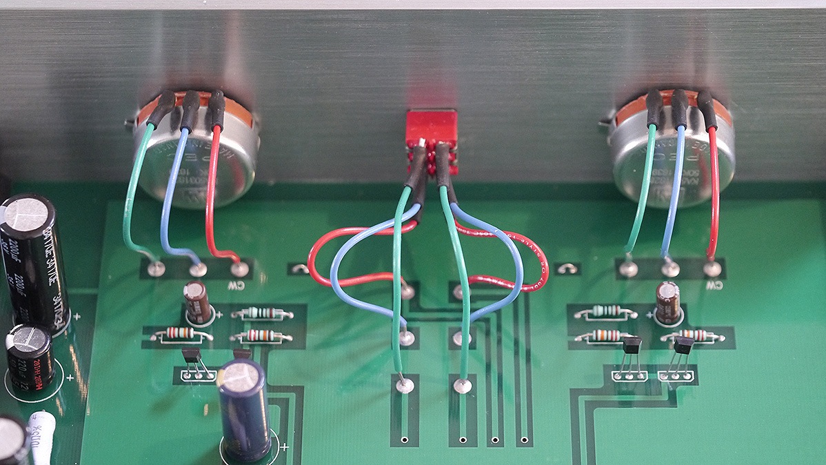

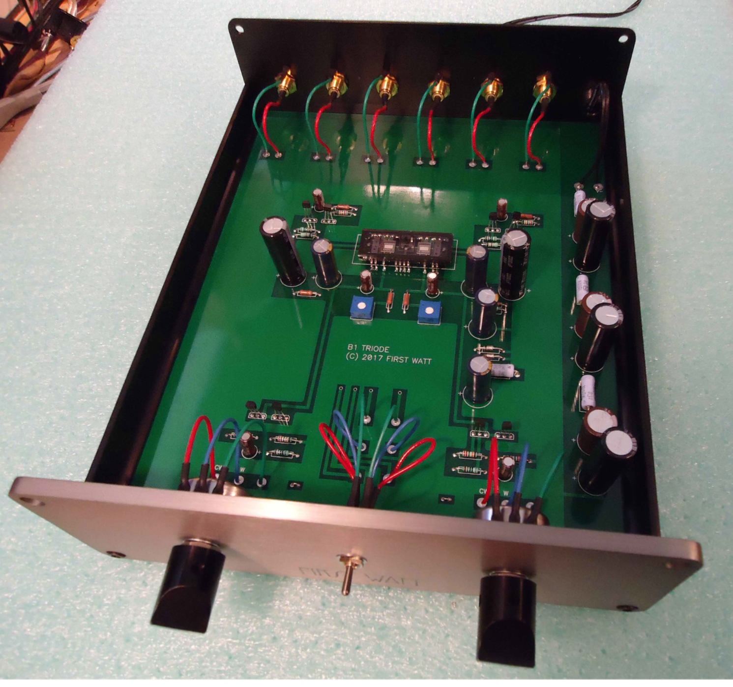

@soundwavesteve
As elwood625 suggests, grounding protocol is important to eliminate hum. Here's what I did following Nelson's advice and including the 1Mohm resistors to eliminate switching transients:
Very interesting wiring there, can you please post a picture from the front panel side as I wanted to see how did you wire the input signal ground wiring coming from the volume/source selector pots.
