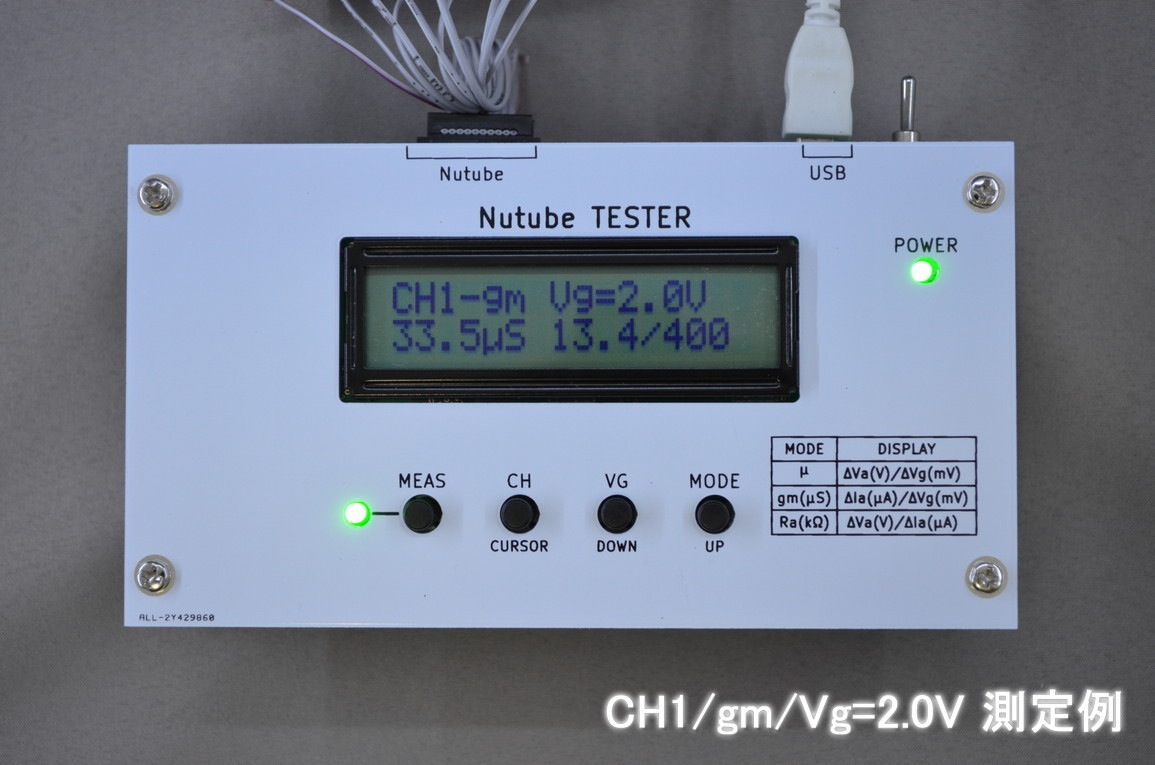

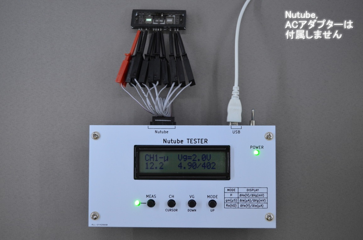

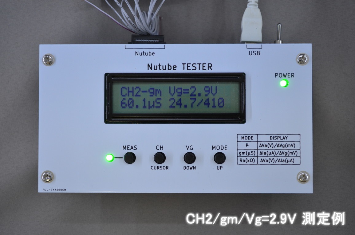

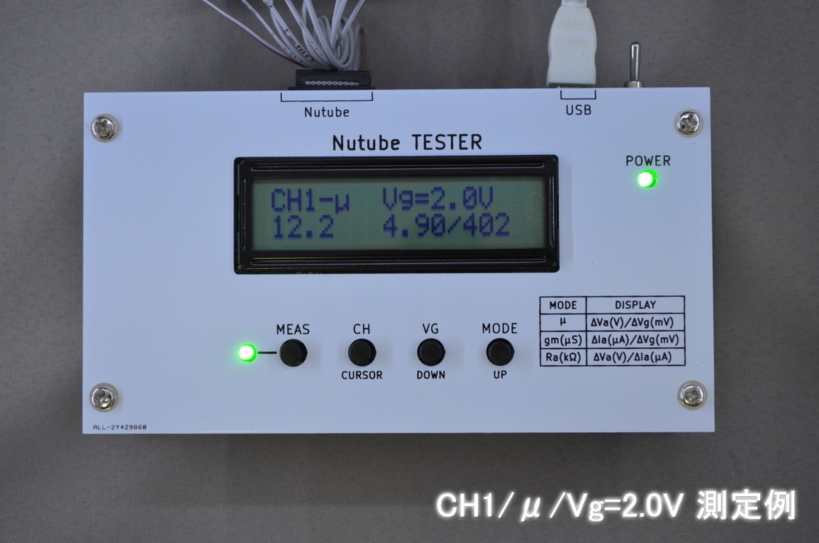

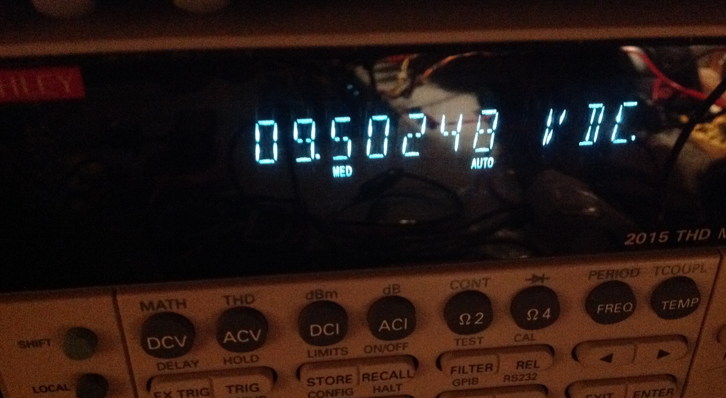

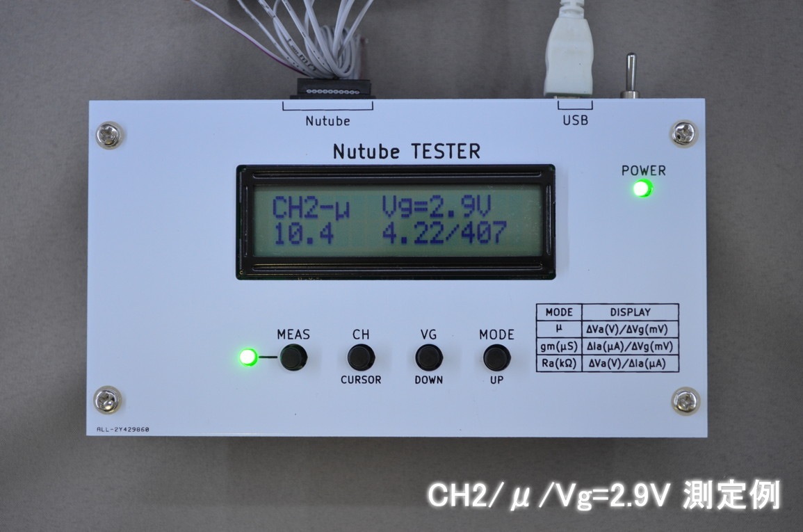

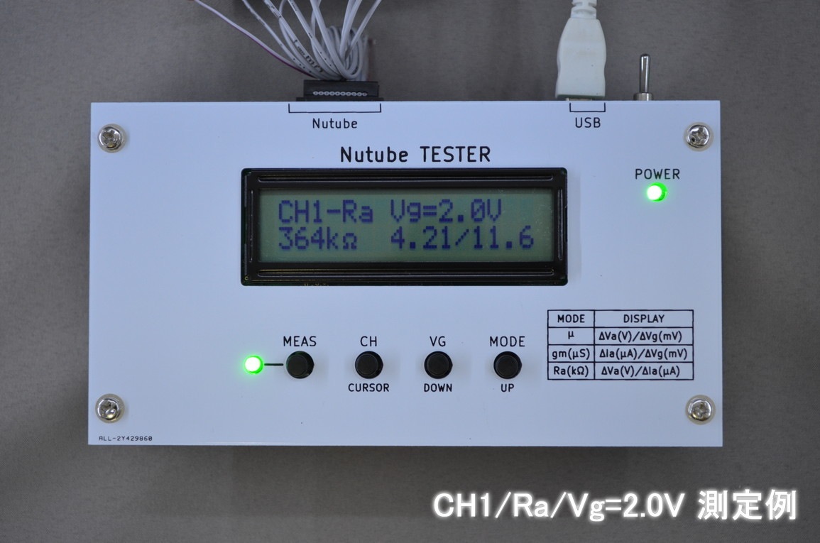

I see Korg tester photos

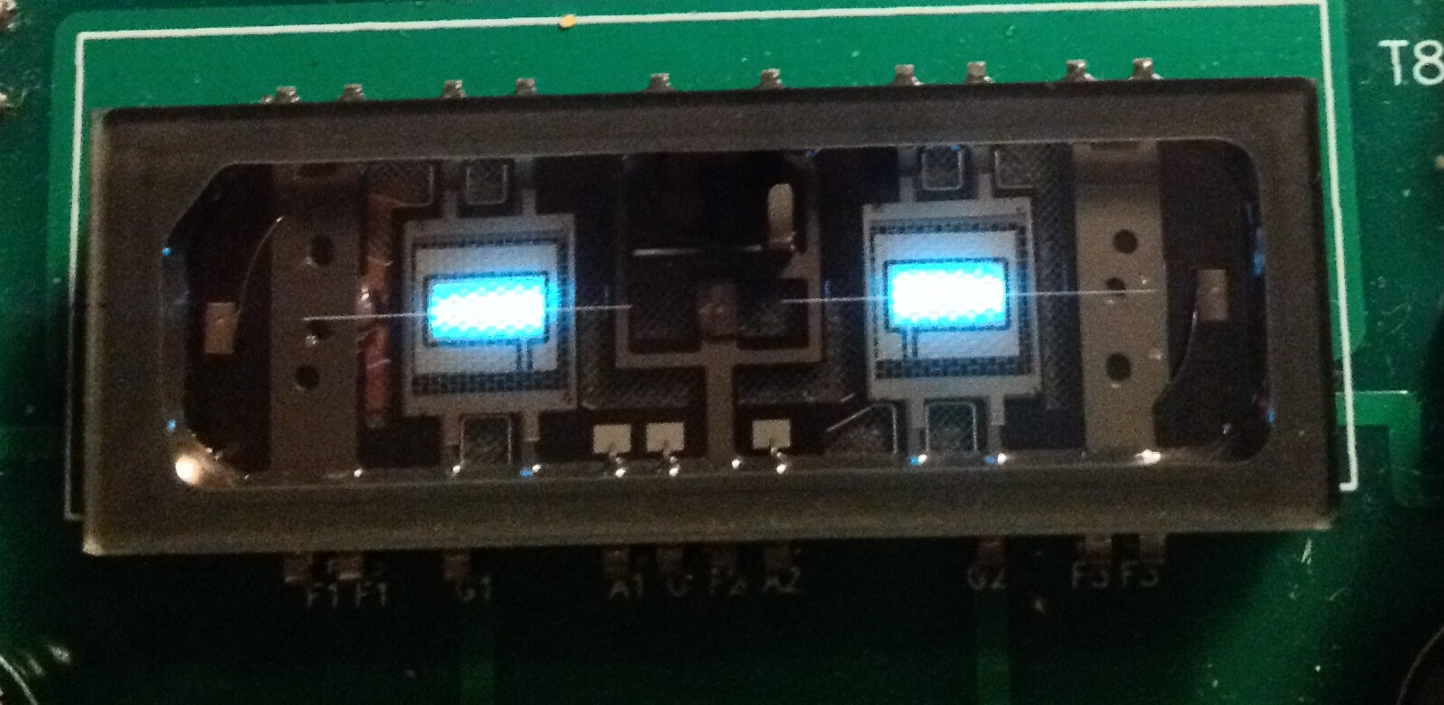

Yes Soundhappy, My Korg B1 had a weak left channel. The NuTube was also extremely microphonic. My B1V2 got a brand new NuTube which thankfully is not very microphonic. The channel balance is better too although still not perfect.

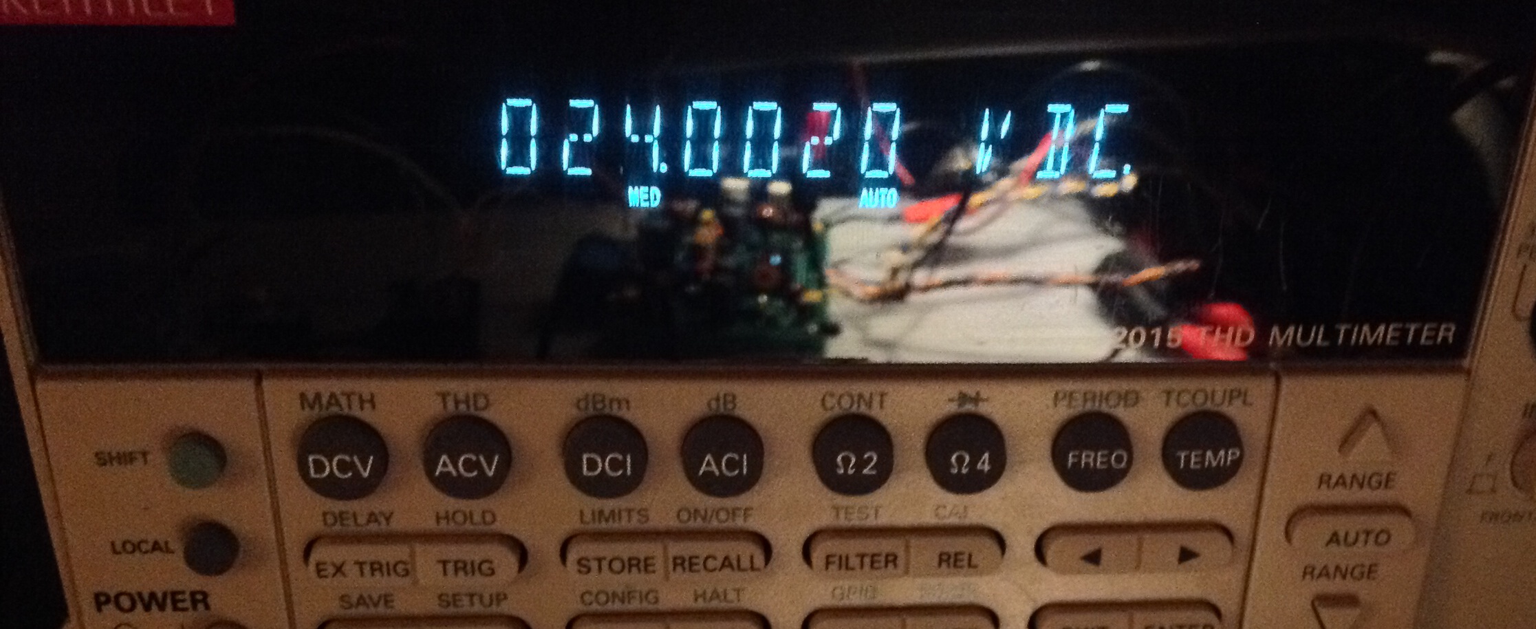

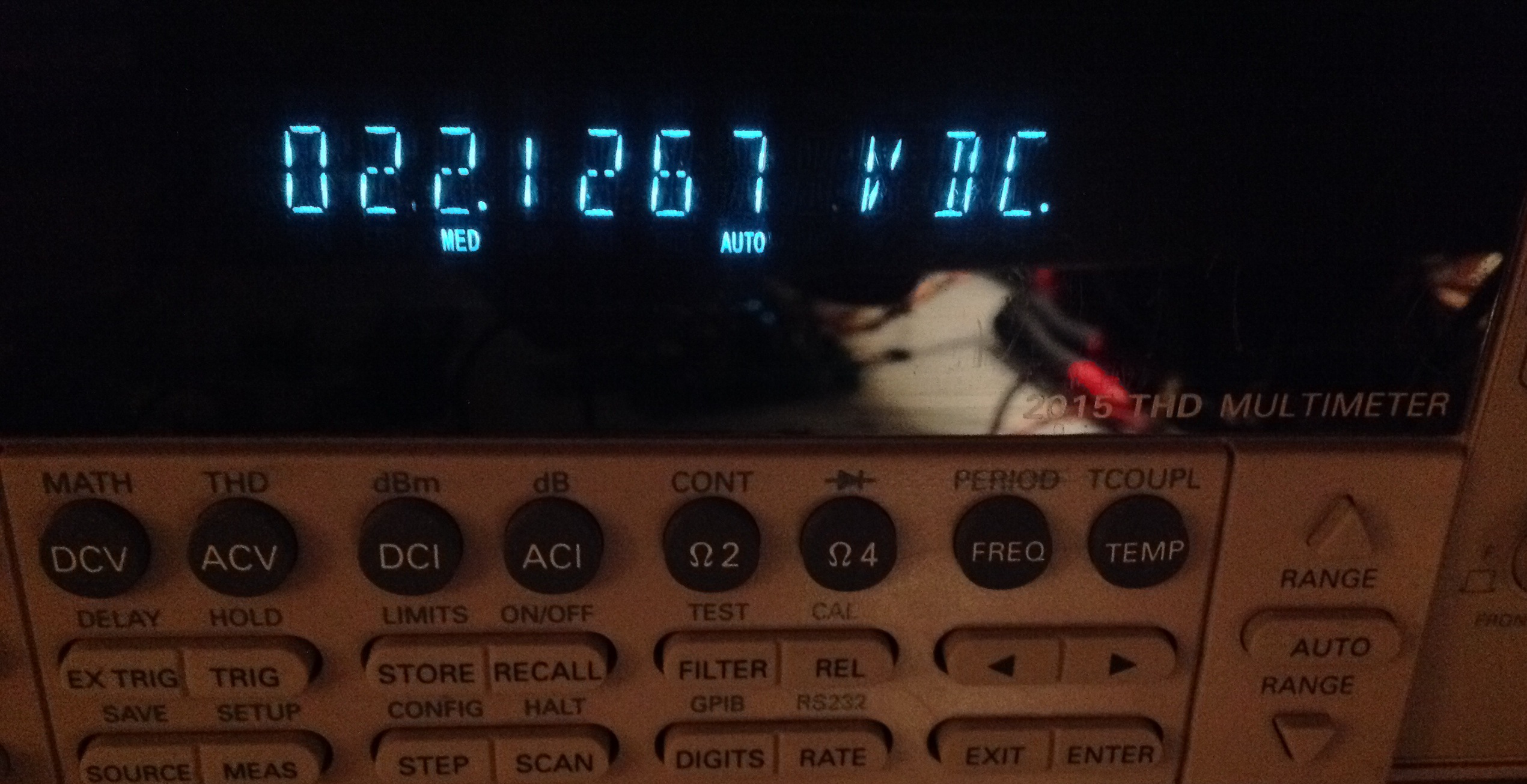

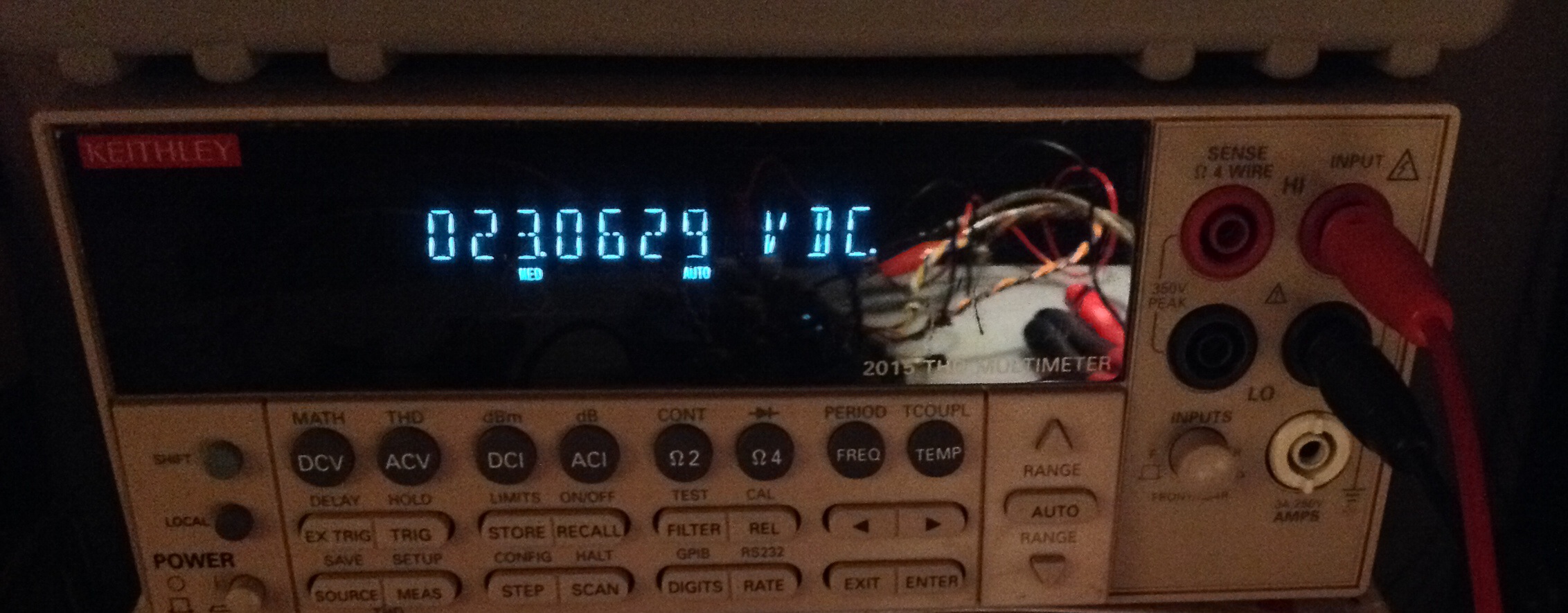

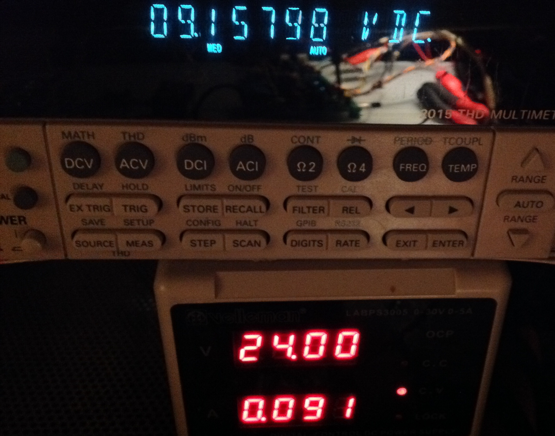

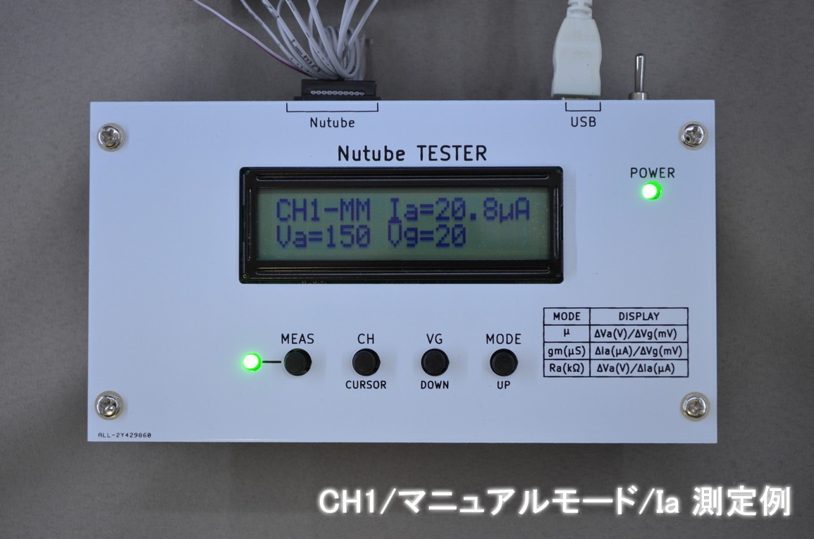

My all test mesurements values from T1 to T8

And Your Nutube mesurement are ?
My have half or less of the other channel..

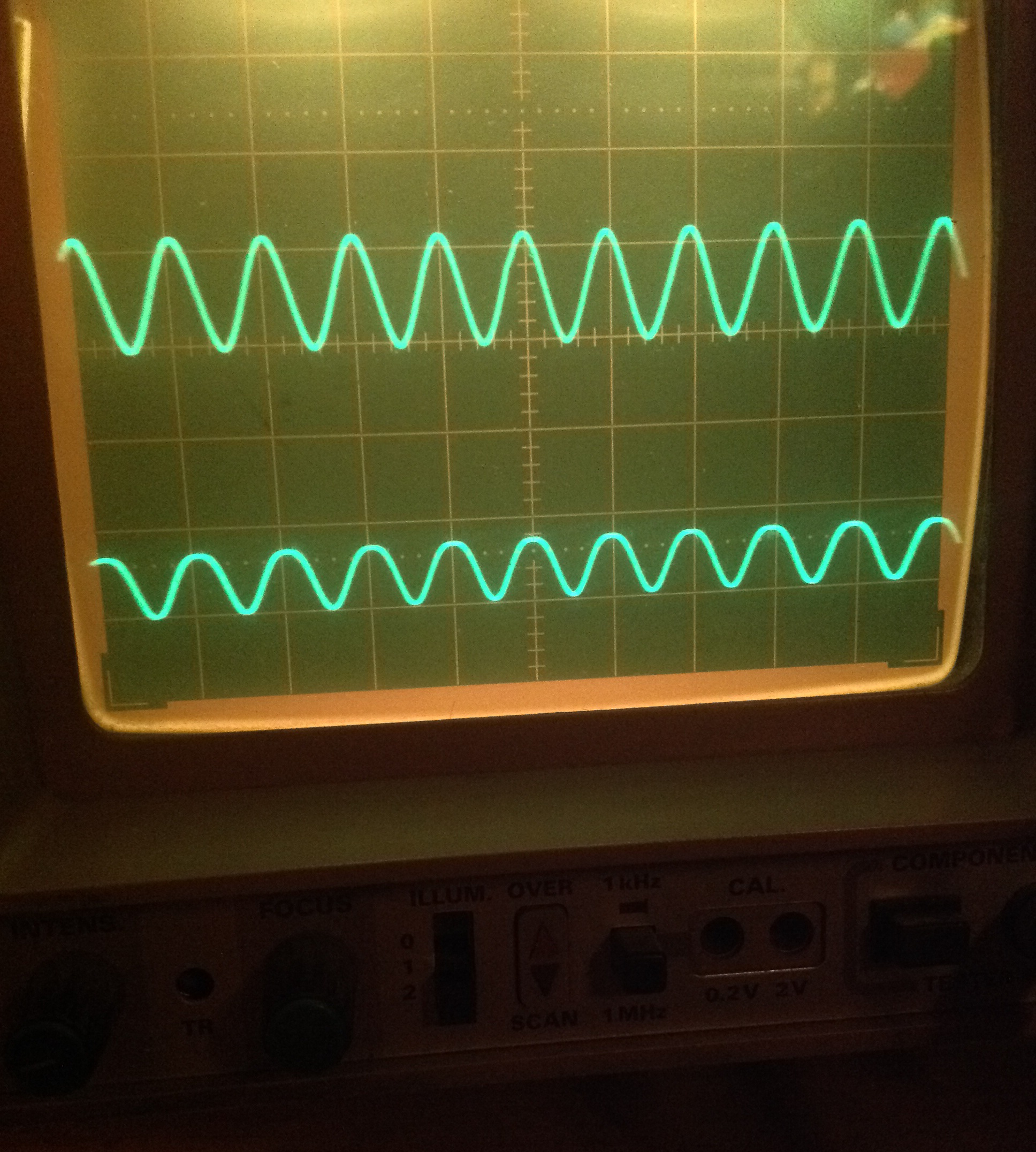

Volume pot at full o clock my channels outputs difference is 1:16
max left = 0.5V , max right = 8V

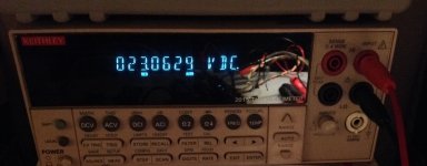

Meantime, I learn more about scope use and how do precise gain measurements
Oscilloscope: DC & AC, Signal Tracing in Amp Circuit, RMS Output Measurement

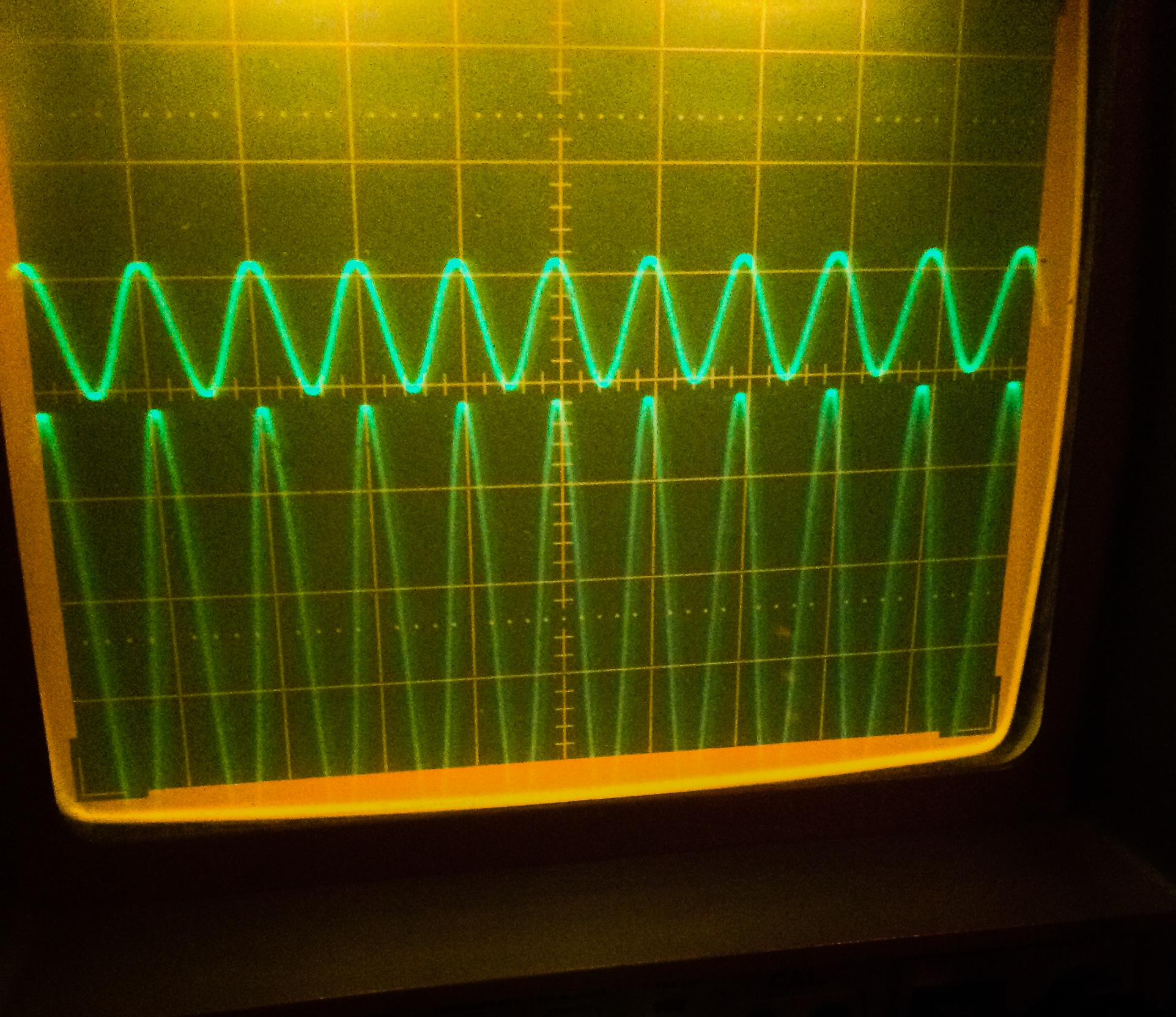

Perfect balance in less 5 minutes

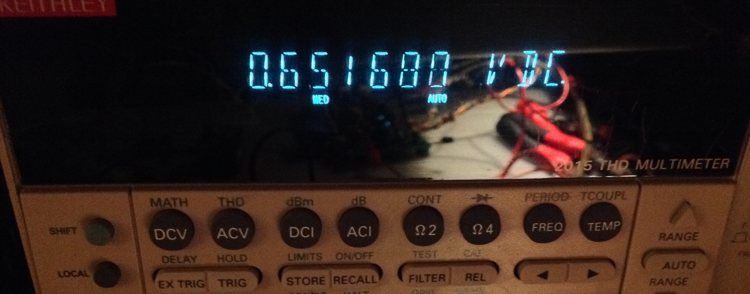

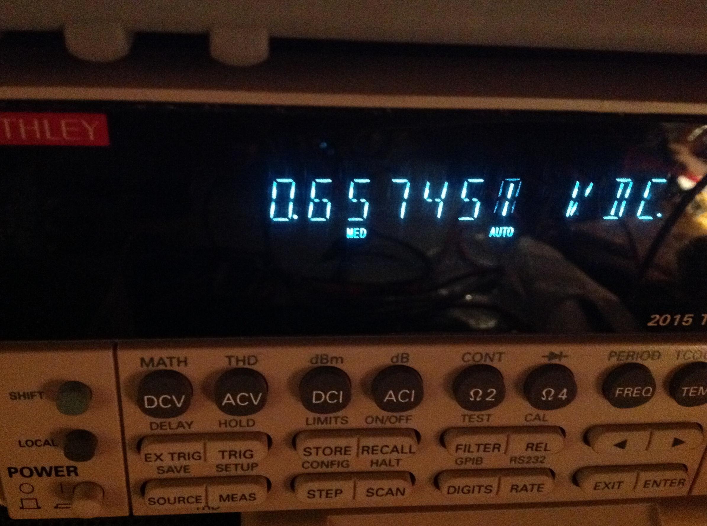

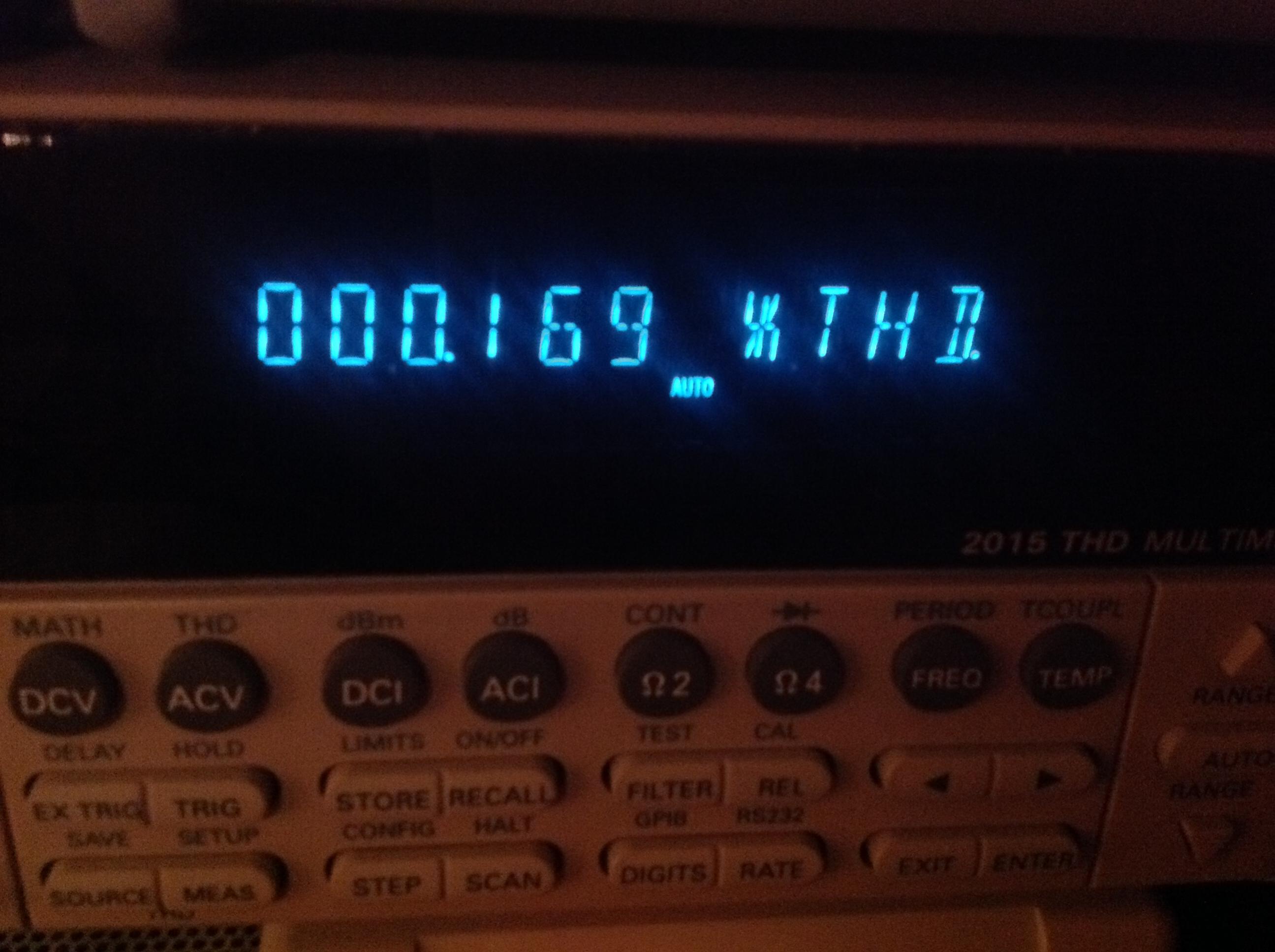

I have a good time today: amplitudes measurements with scope and search for the same distortion value for both channels.
Photo 1 low % THD, photo 2 Right, photo 3 Left "weak" channel signal amplitude at maximum with the same V/ Division scale.
The solution is simple and no need for laboratory tools.
Only ears and music.
Play Your favorite song with B1 Korg in the audio chain.
Do with trimmer adjustment on the strong channel slowly.... step by little, step.... tube light does glow less than the other triode
and You hear two channels is perfectly balanced now on both sides.

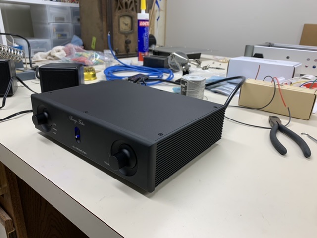

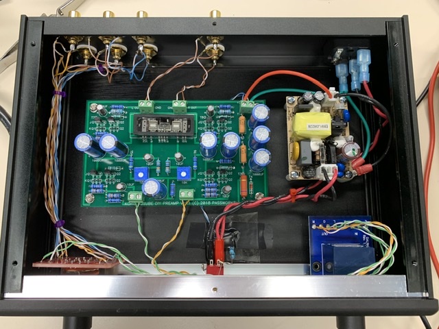

Just finished this version today, nice Christmas gift to myself having it work first time 🙂. I’ll post thoughts tomorrow but first thing I noticed is I am getting a noticeable 60hz hum, measurable from listening seat. It is volume dependent, though it goes away at full volume. The case is a Chinese piece from eBay. Beautiful machining, not a single flaw. I did have to machine out one of the knobs to get it fit over the Tubecad Select2 selector shaft.
I had the same problem with my build, I had wired the RCA grounds separate up to the selector and then to ground twisted with the positive side of each RCA. I had to wire all the RCA grounds together at the jacks and then wired it to the closest mounting point of the PCB, which is connected to ground, to solve my 60 Hz hum issue.
My build used the wall wart power supply, and yours has the power supply in the chassis, so it probably isn't the same.
Nice build, great looking chassis. I hope you find the cause, what a great sounding preamp IMHO. I love the ability to 'tune" the sound to your liking. I've had preamps in the past where you could make small changes to the sound, nothing like the B1 Korg where the changes are so dramatic.
Thanks for the tip elwood, I will investigate tonight. Dew, my Bugle 2 phono pre is grounded and I get no additional hum when listening to vinyl with the setup as it is.
