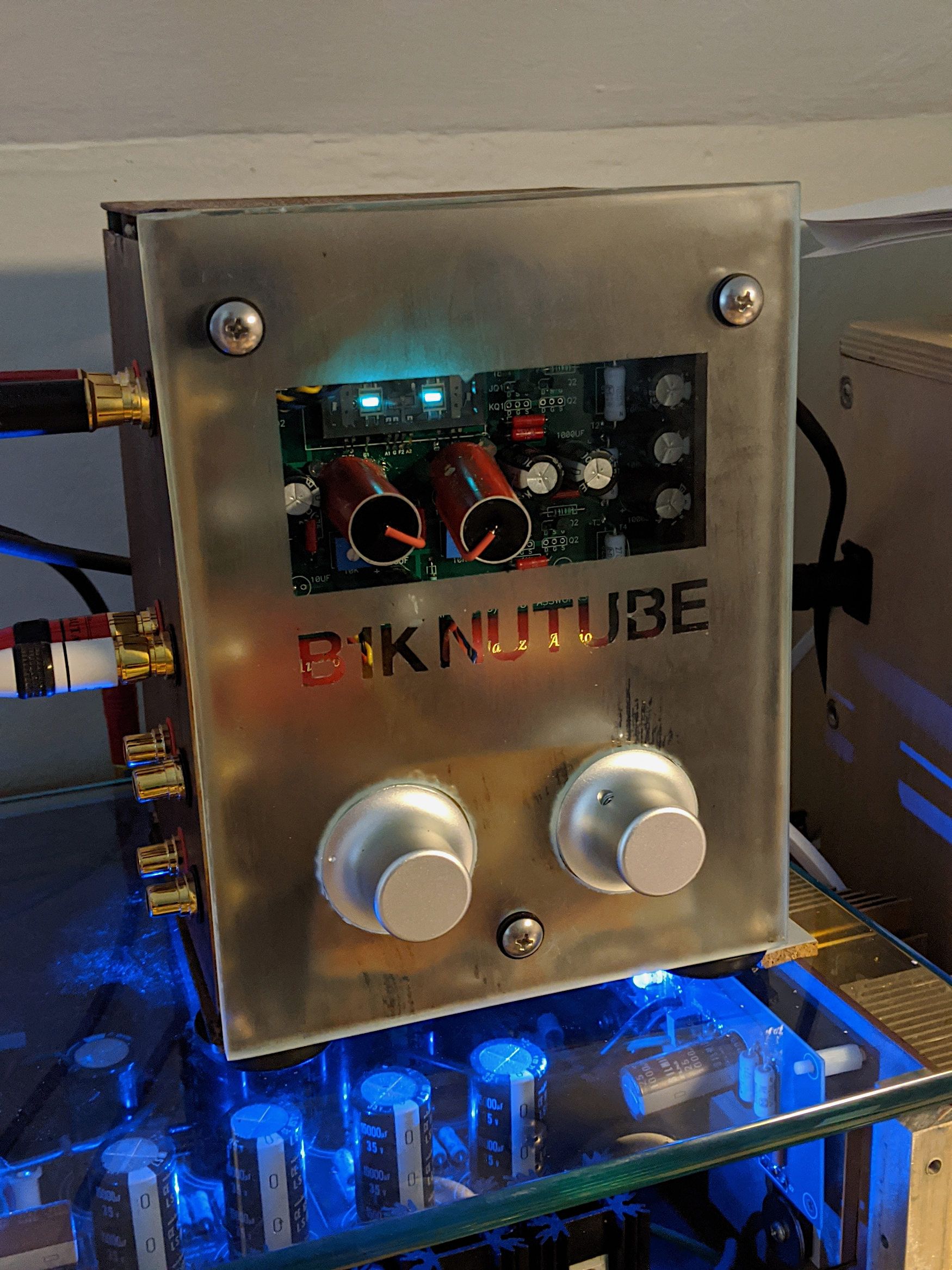

Some of the NuTube triodes ring very easily from mechanical vibrations transmitted through the chassis and standoffs...
Yep, I've found a ring at about 5200-5300Hz. Using a set of rubber standoffs will reduce the ringing by about 15dB. This reduced my ring to a point where I don't hear it anymore. Others have added better feet and vibration damping to the chassis to good effect as well. Definitely worth a bit of effort to make the mods for such a nice preamp!

I was having a bit of ringing before I got the glass front on, has been fine since. This thing is rather heavy for its size, and while vented around the top and bottom, the nutube is fairly sheltered. The F6 will get a matching glass front.

Well, to my ears it sounds terrific. Bass is solid and deep, detail and soundstage very nice.
Michael
That’s very cool. Have you created a mask and the sandblasted it or bought window privacy film and cut through it?
