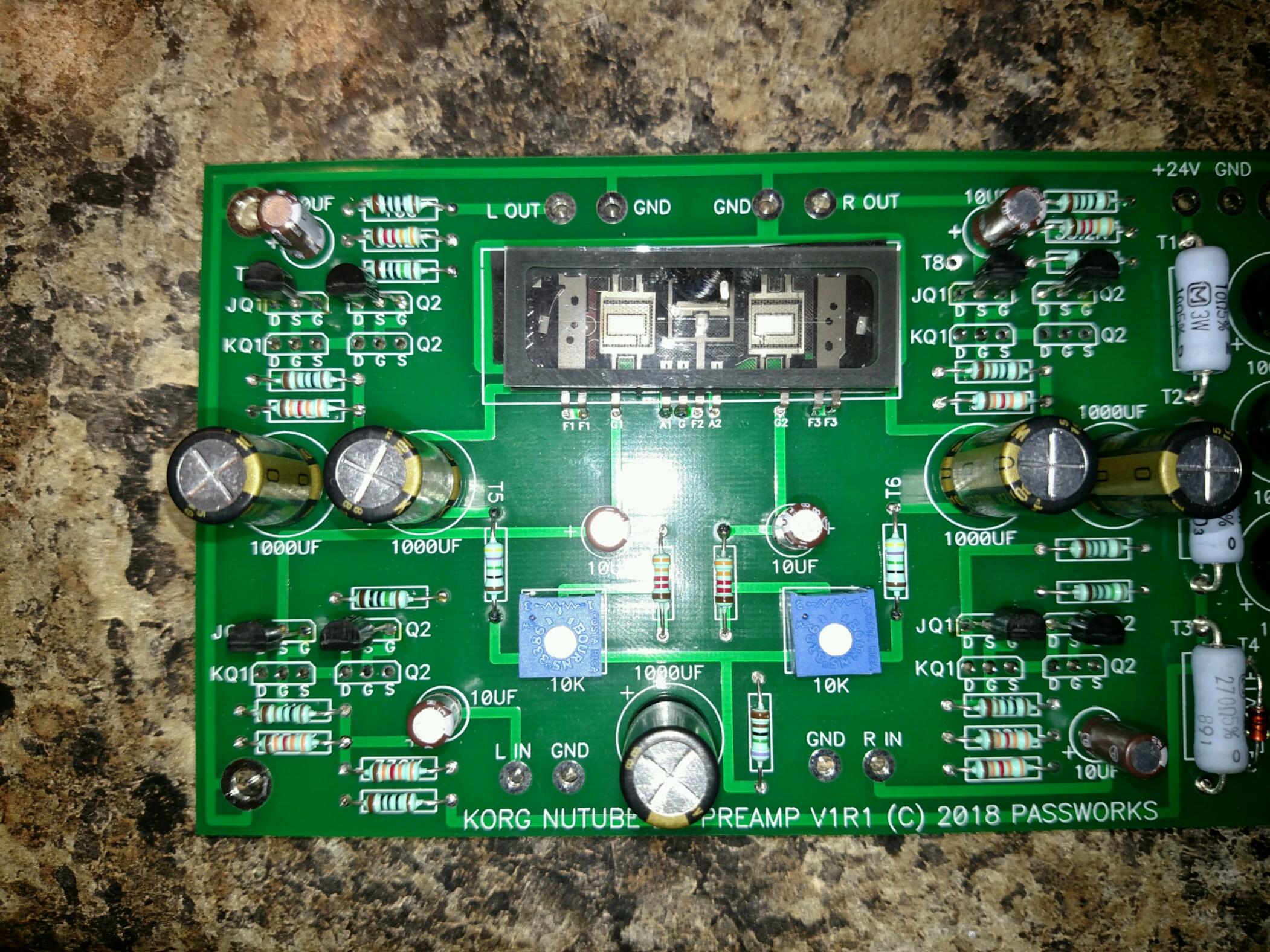

I bought Tocos 50k (because of ClaudeG :) ) on eBay, it just arrived today. First thing I noticed is that it is very light weight, maybe half the weight of my Blue Alps. I didn't think it was going to work, but nevertheless replaced the Blue Alps in my B1Korg. Luckily it played music :)
I find it much more transparent and revealing than Alps. And a little bit thinner in bass department.
I read somewhere on this forum that fake Tocos are detected by their 'miniscule' weight and I wonder if I got the fake one. And how good the real thing would have sounded :)
Ok, pic didnt stick

Just received a 50k Tocos Cosmos volume pot from the eBay seller ClaudeG referenced. I am also going to switch to Polypropylene film caps for the inputs. For the output caps, I might bypass the stock 10uF Nichicon FW with a pair of 0.01uF Polypropylene film caps or dig through my stash for a pair of NOS 4.7uF Black Gate N non-polar electrolytic caps. Using the diyAudio store 1U chassis, so there isn’t much room to fit bulky 3.3uF film caps in the output.
I wonder if ClaudeG’s combination of film caps and the Tocos Cosmos volume pot is providing the improved bass weight and detail.
For now, the stock Completion Kit components and chassis are great. The only thing I would change with the chassis is to go with top and bottom chassis cover plates without the ventilation slots. I think I have a sensitive microphonic Korg NuTube, and mounting the PCB on the vibration damping standoffs was a huge help. Additionally, when I cover the vent slots on the chassis, the preamp has no issues with microphony whatsoever. It is a very impressive preamp at that point with smooth and clear sound. In my system, 9.5V is just right.

Thanks for the suggestions. I left my B1 Korg NuTube with a buddy in California after attending the recent Burning Amp Festival. My friend is just blown away with how this preamp sounds in his system. I think ClaudeG’s tweaks will extract extra performance from the preamp. Can’t wait to get it back to install all the caps and volume pot. The 1U chassis will force me to be a little more creative in fitting the 1uF caps.
I would pop in a couple of resistors at the front end of the circuit in a voltage divider (or a 50k pot if you have it)
After months of waiting for powder coating (long story), I am ready to complete my amplifier. It's been a while since I last touched it. I am looking for some advice on setting up the voltage divider portion (mine is a hybrid amplifier with no volume control).
For testing, I hooked up a 50K pot (backwards) and determined the maximum volume occurs at the 35K/15K split. I bought some 15K and 34K resistors. Logically I would assume the 15K is R1 and 34K is R2. Is that correct? Also does it matter where I ground R2?
