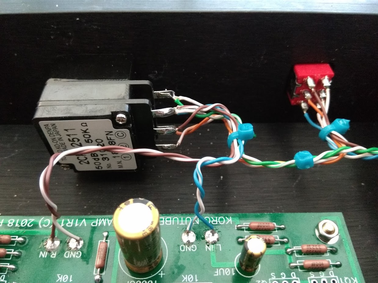

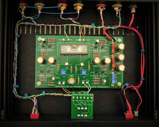

Potentiometer TKD 2CP-2511 50k received this morning and installed immediately on my preamp Korg B1!
I have not really had today the opportunity to notice any obvious differences in listening with the TOCOS or the ALPS, but it still seems to me that the brightness in the highest frequencies found with the TOCOS is attenuated, what remains to be confirmed with deep listening on different musical styles ...
Gidu

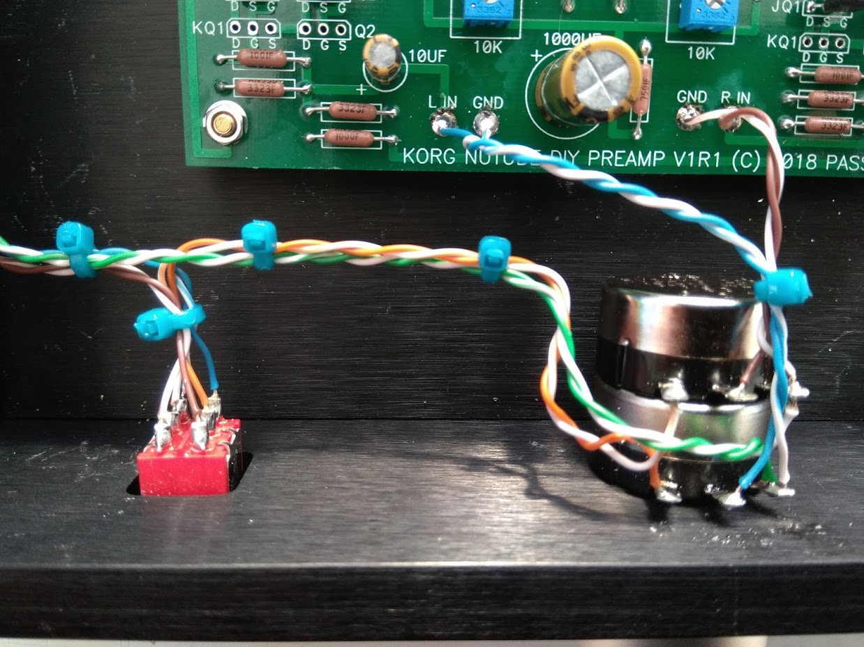

At first :
TOCOS pot :
TKD pot :
New tests and listening of potentiometer TKD 2CP-2511 this morning, and some observations that follow:
The more in-depth listening of several recordings of classical music confirms a more relaxed listening, with the virtual disappearance of the small point of aggressiveness seen in the high-end spectrum (especially in female voices) with the TOCOS knob, all not noticing a noticeable decrease in the sound image, either in depth or width.
On the other hand, the manipulation of the volume knob is mechanically extremely smooth (compared to the pot TOCOS and especially compared to the pot ALPS) and much more pleasant in the low levels compared to the TOCOS (listening at moderate level in position 8 hours on the TOCOS and 10 hours on the TKD!), Which indicates a better management of the logarithmic curve of volume progression on the TKD.
So, my preferences, both in terms of sound quality and quality of handling or finishing, go first to the potentiometer TKD 2CP-2511, then the ALPS RK27 and finally, lastly, the TOCOS ...
