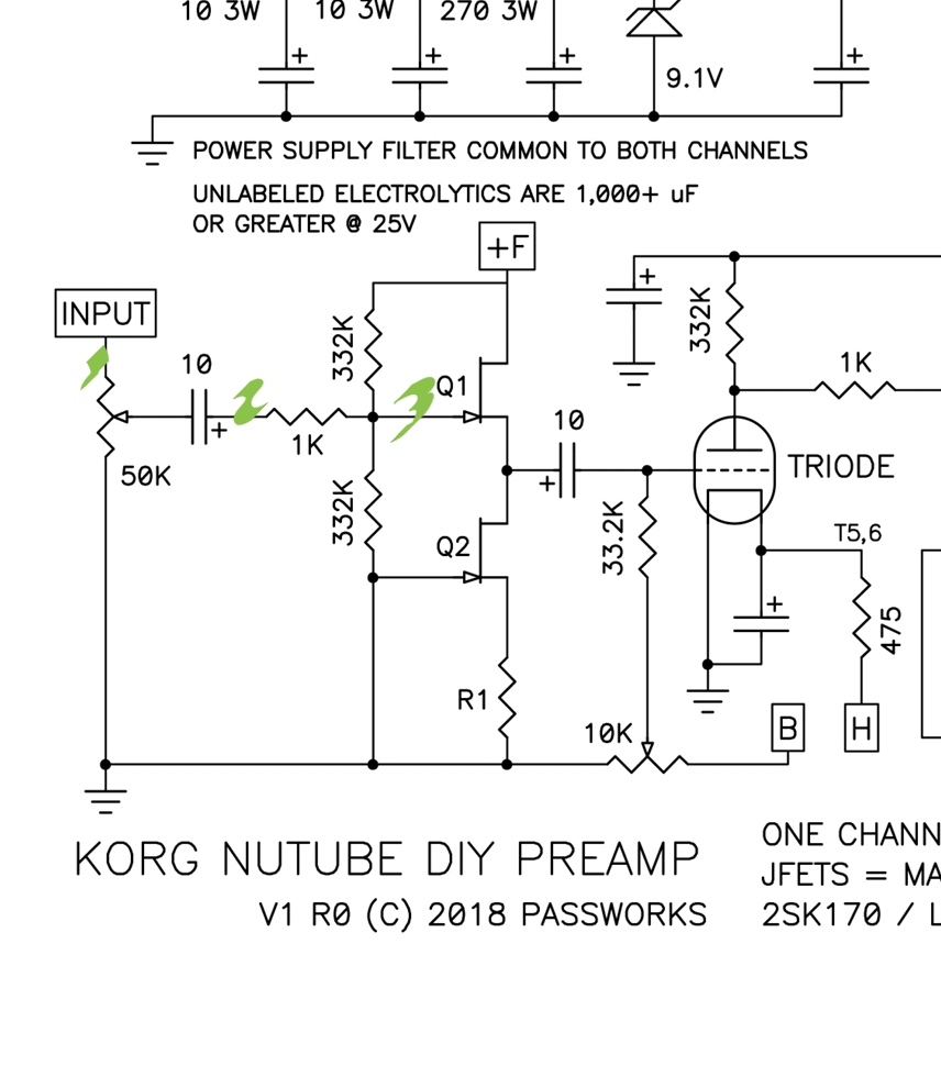

I'd like to try add an additional inverting stage to this circuit by adding a unity gain inverting opamp buffer (sacrilege, I know!) but not entirely sure where an appropriate insertion point would be.
attachment.php
I use the circuit as a headphone amp so I can't just swap speaker leads to correct the phase and I'm interested to see if the korg can possibly sound better with correct phase.
Its just an experiment that I'd like to try but a little nudge in the right direction would be appreciated!

Not an expert but perhaps in front of pot saves you from potential issues such as having another cap in the signal / DC offset or eleminating devices at the output of your "inverting additional circuit", and also from impedance mismatches?
If such things is easily doable, perhaps long term solution could be getting rid of the original first stage and replacing it by an inverting first stage with low output impedance?
Just thinking loud with limited knowledge, I leave it to ZM & Co !
I have used the Jensen JT-11P-1 line transformers with the primaries reversed. They sound very good. Much more money than opamps but very easy to get right.
