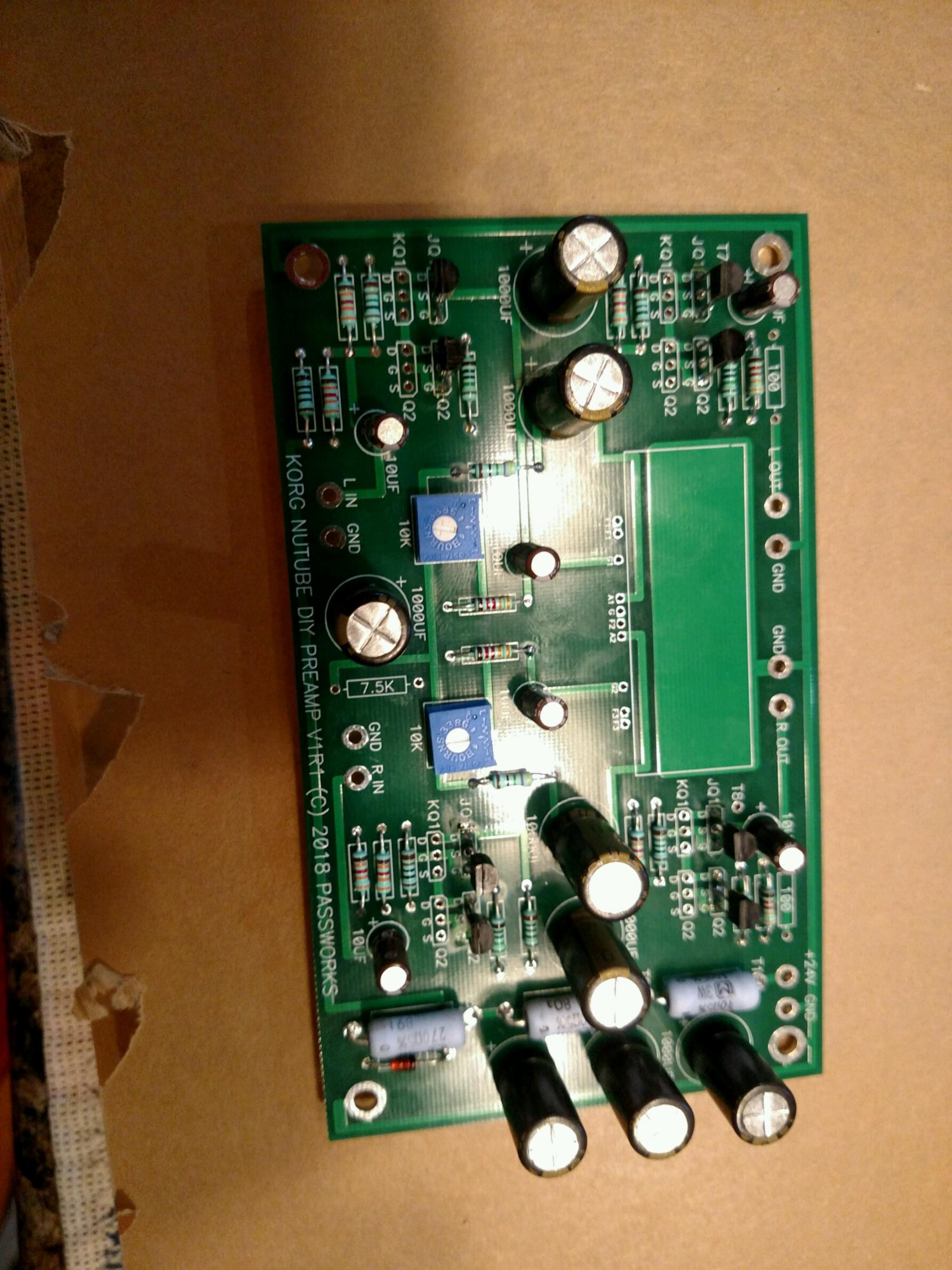

I have now thanks. I only found one pair that didn't match other build photos earlier in the threads. Have others go this wrong too?
There are 3323F and 3322F which ones are which?
For the full build kit colour coded and sorted resistors would be safer and less confusing.

As for color coded... you can buy banded resistors if you like. The advice that is peppered throughout multiple threads is to measure each and every resistor before installation. It takes seconds and can save hours - as you're noticing.

I tried but my multimeter was all over the place on these. I had zero problem measuring all the resistors on two ACA builds and sorting them are the values on the supplied ones so low that some meters just won't pick them up properly?

Resistors at those values should show proper readings. Check the batteries in your meter.
The Dale resistors have thier value printed on the side, the code is 3-digit + multiplier at values greater than 100ohm, and below 100ohm the "R" is the decimal.
So, from top to bottom you see -
10K (100+2 zeros, 10000ohm)
1K (100+1 zero, 1000ohm)
100 ohm (100+0 zeros, 100ohm)
10.0 ohm (10R0, 10.0 ohm)
Steve Luck - can I guess that you don't have an auto ranging multimeter? High resistances are easy for the meters to read accurately, but yes, check the battery. That said, it's confusing when you have to read ohms and then place the decimal depending where your meter is set. Honestly, buy a cheap and cheerful auto ranging meter similar to this, I guarantee you'll find it to be worth every penny.

Well here is my build so far, almost gave up on this from the reports of people having the ringing thing going on.
Screw it. nothing ventured, nothing learned.
Worked for NP, I am going to make it work too.
So, the parts I ordered were from a BOM I downloaded from, well, somewhere.
All Digikey part #s.
It was way easy looking at the individual package labels and then the boards to know where things had to go.
The BOM however was short 2 100 ohm resistors.

I've checked all the resistor values - I only had two transposed in the board so will wait now for a new tube to arrive and see what I get after that's installed this time on sill connectors if they'll fit.

I think one side of the tube has failed slowly as it wasn't producing off centre stereo when I first ran it.
Fingers crossed that a tube fixes it.
