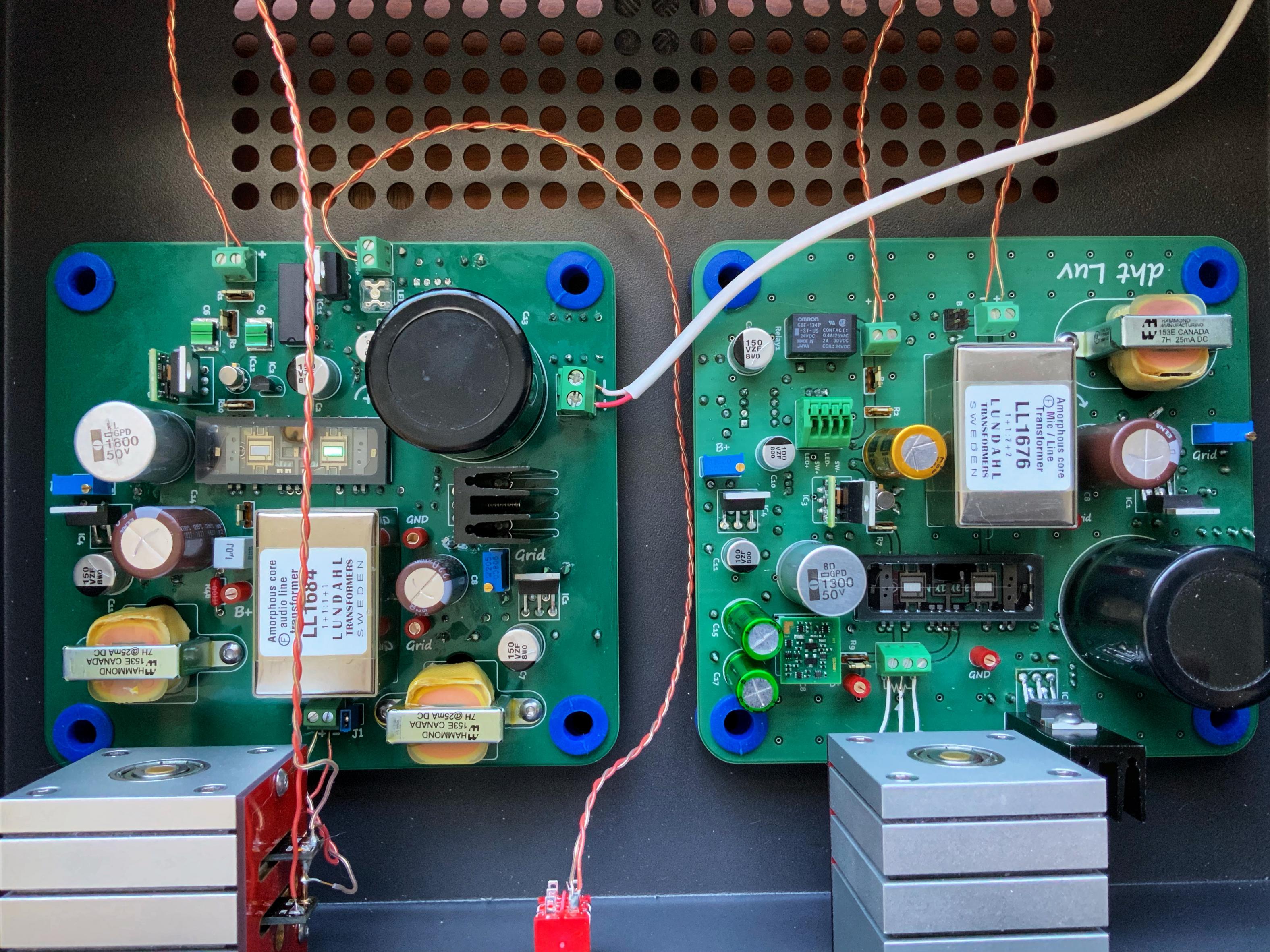

A little NuTube Luv 😉. Thank you Mr Pass for introducing me to this lovely little tube. 1st version on right. 2nd on the left. 1 channel per pcb.
Tonight I experimented with additional capacitance in the PSU.
PSU is a big caged meanwell 10A switcher. Way overkill for this application but I had it.
Caps on board are 2700uf panasonic FM.
I added 33,000uf (!!!) bypassed with a 6.8uf poly cap between the meanwell supply and PCB. The meanwell did not shut down, didn't seem to care about the additional capacitance.
Soundwise, not much different. I was surprised. Maybe a tad bit more liquid but not a big difference. Bass was same. Amp did not seem less noisy. Really, nothing different to note.
Maybe the Korg doesn't care so much about PSU quality? This has made me rethink my plans for a well regulated linear supply. Maybe I don't need it.
More PSU experiments:
I changed the 10A big meanwell psu to a 32V switcher followed by a lm317 reg set to 32V.
Sound is somehow a bit cleaner and smoother but less dynamic and edgy. Not a big change, but it is a change. Less lively with the lm317 but more refined.
I think my final psu will be linear w/a shunt.

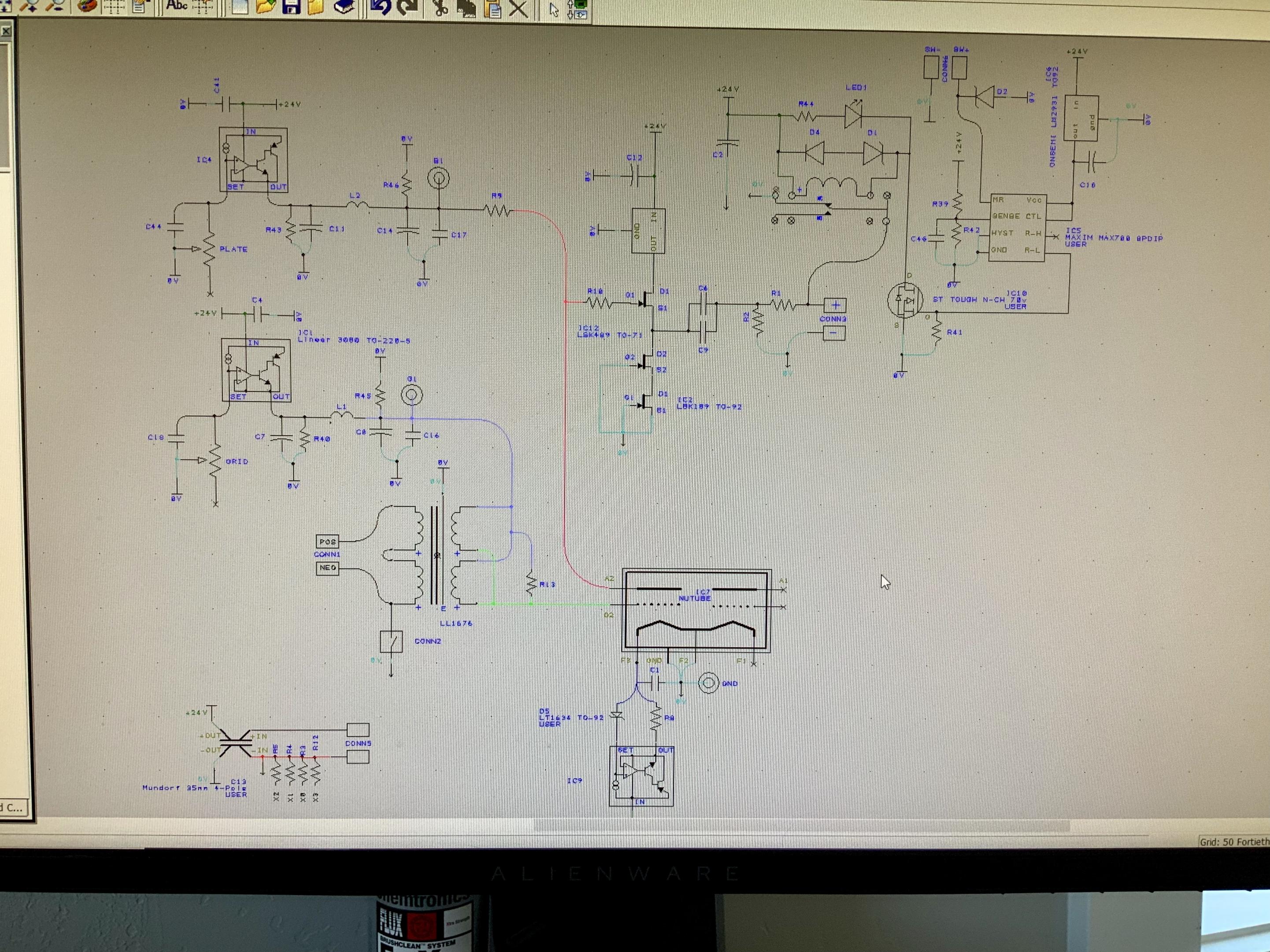

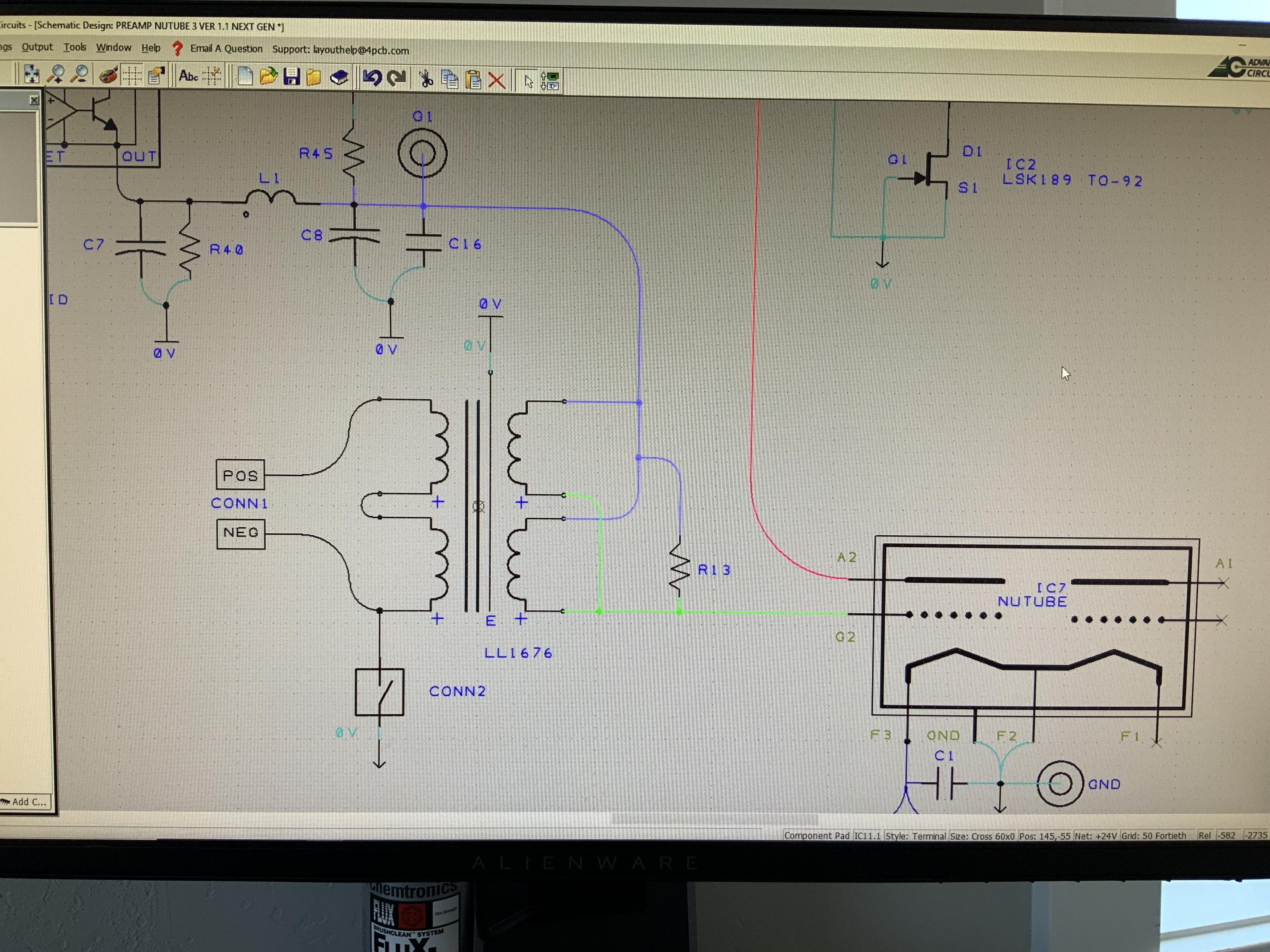

Here go Brian... sorry for the bad resolution. Similar to the pass diy project. I also added a CCS to the filament and a Cascode CCS to the voltage follower (LSK489 & LSK170) . Seems to work well.. YMMV
