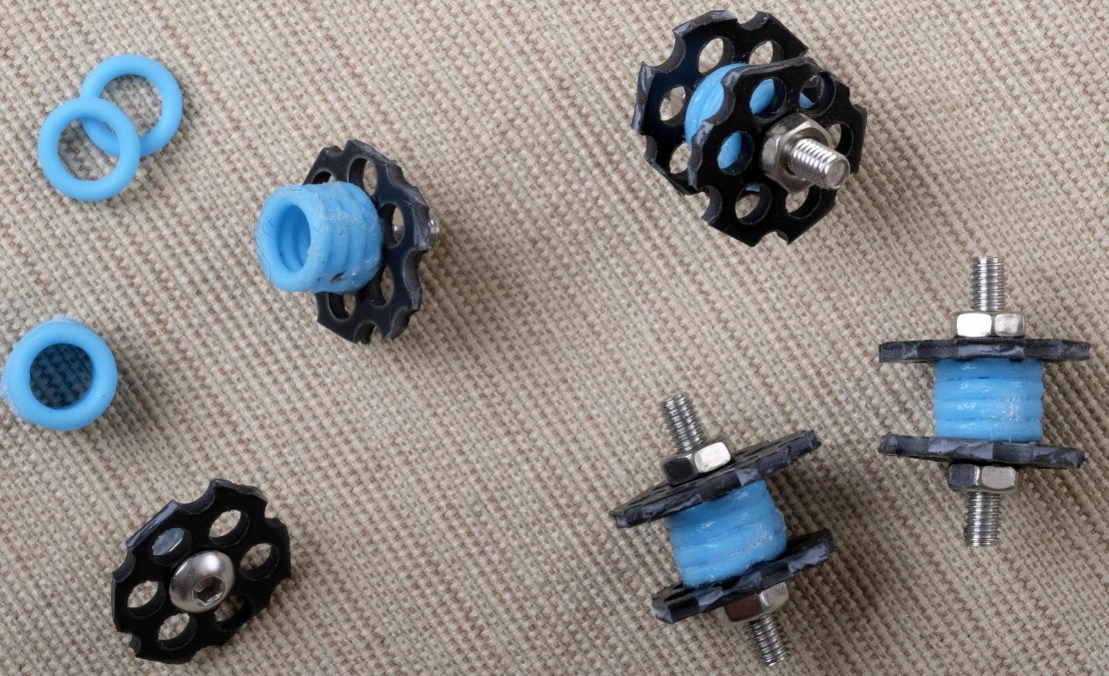

Just FYI, I found a solution for my microphonics issue by mounting the PC board on stacks of Sorbothane washers on #6 nylon hardware. I only kept one of the kit standoffs so I could mount a ground lug under it. I ran a ground wire up to the big land on the PC board. There are two washers on the standoff as well but I don't think they contact the PC Board.
Now the NuTube will only ring when I work the selector switch or tap on the cabinet.

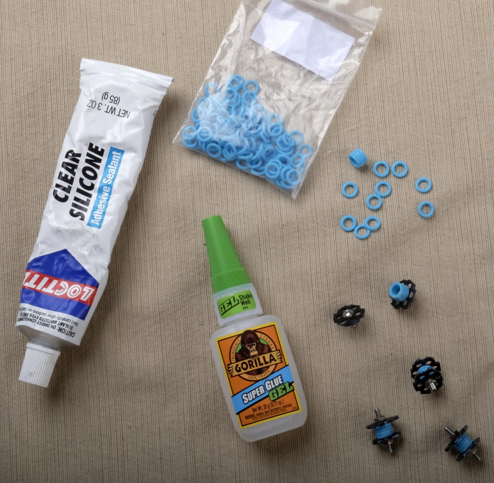

Rather than buy a commercial isolator, with the spirit of DIY here is my take on some homemade isolators. Please note the attempt at Pass blue. These are silicon dampers used in keyboards. A few cents apiece. The grids they are mounted on is some plastic screen I had on hand. Some 3mm screws and a stack of four dampers with the circuit board in place along with the tallest component will fit. Hopefully this will help some on vibrations. The two adhesives I found that would work with the dampers I bought are shown in one of the photos.
