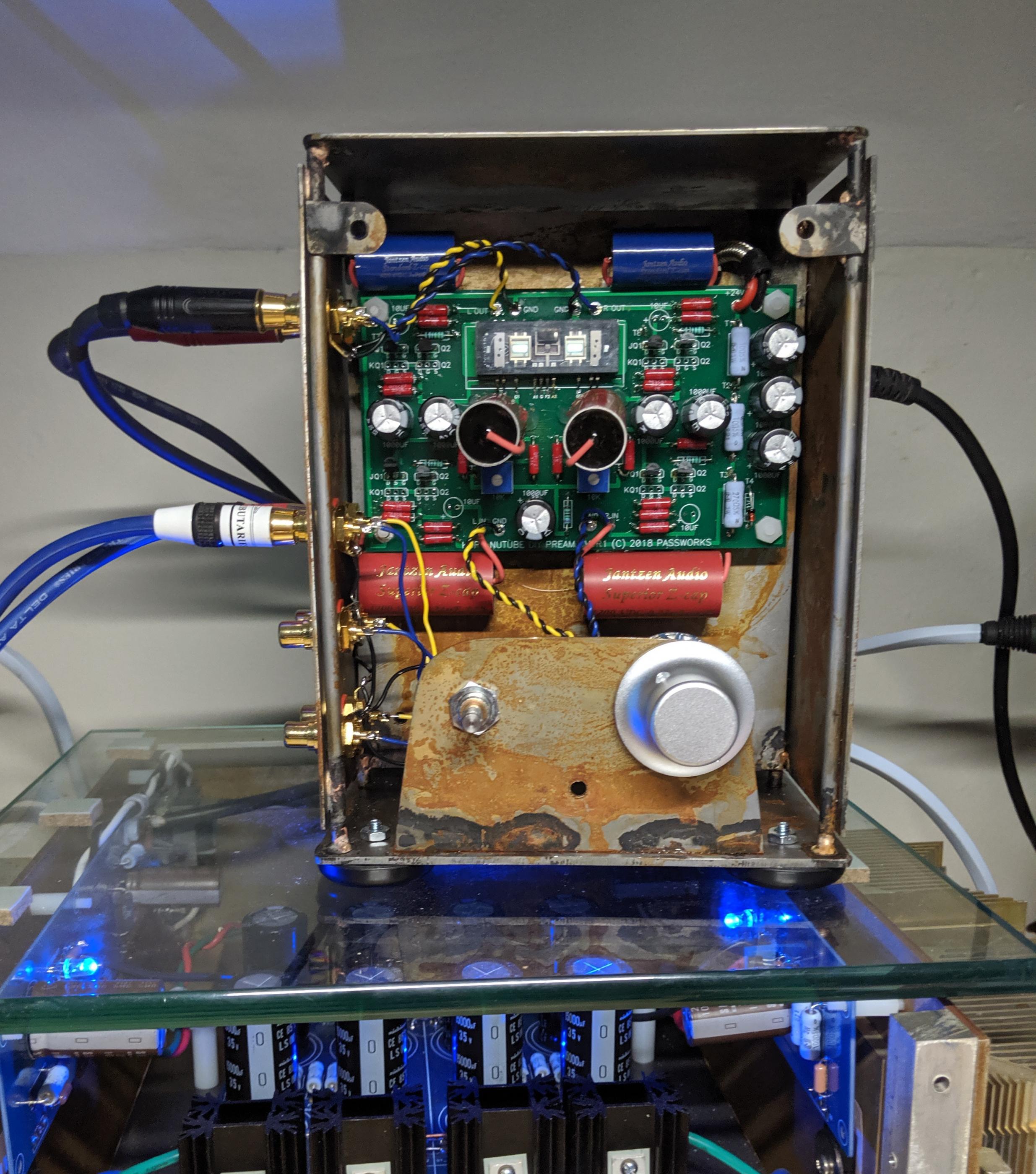

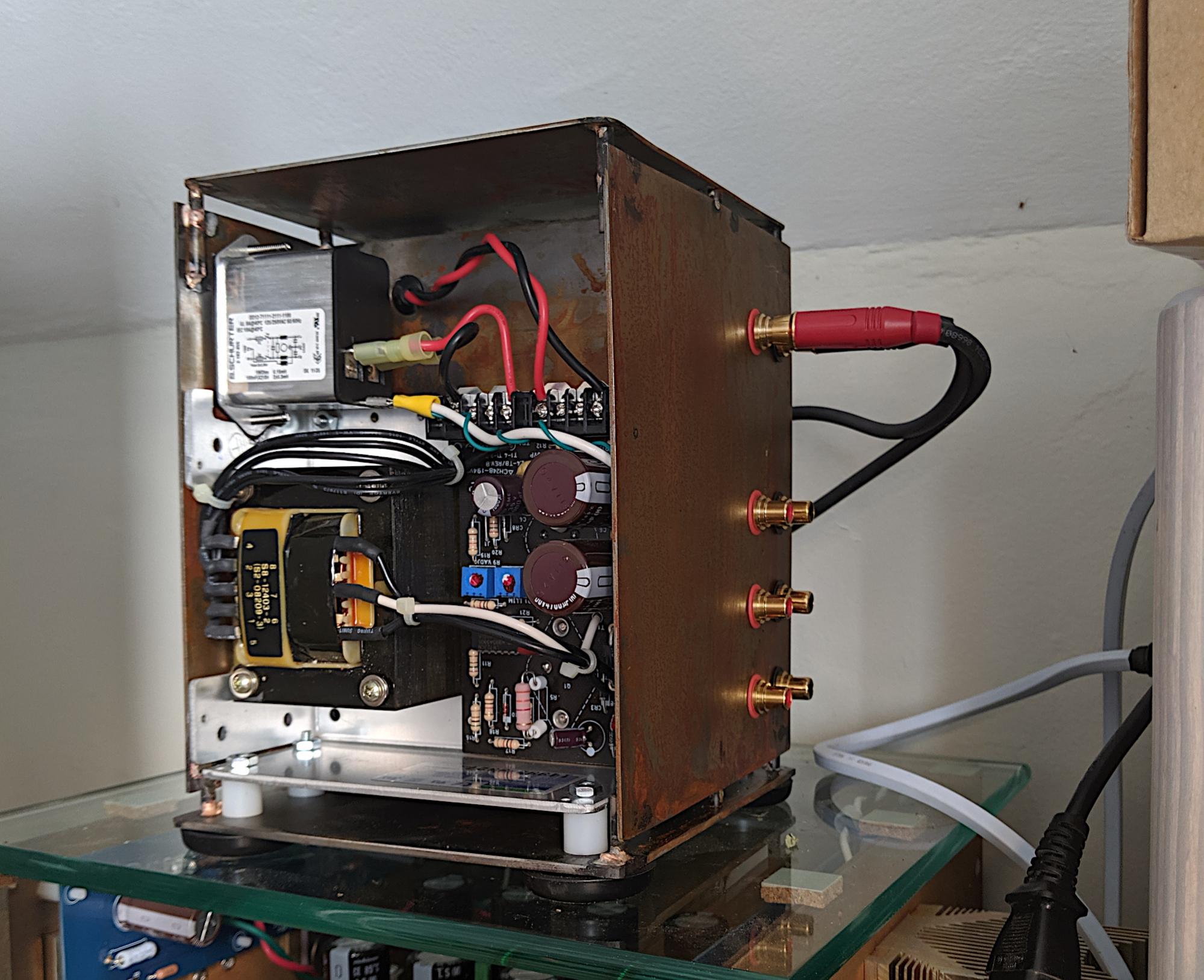

Here is mine, making wonderful music.
It is 6" square, 8" tall. I am waiting on a piece of glass for the front, which I plan to drill a couple 40mm holes for the knobs, and 3 6mm holes for some button head screws. I have some stick on letters I plan on using to mask the glass and 'armour etch' the glass, leaving the name clear (and similarly on the F6 below). Waiting on another slow boat knob, was going to use a toggle for inputs, but added the Elma rotary. The steel I washed with muriatic acid, and applied some vinegar and hydrogen peroxide to get it to rust, but I should have used a good degreaser, as it is not too uniform. I spray a coat of clear sealer over it.
The back half houses a linear ps, and the power entry, with a piece of 16g between. The Sola Silverline (SLS-24-024T) I found new on Ebay, seems to be a nice quiet ps. It was right on 24v. All the test points were very good.
It is tuned to approx 9.4v at the moment, haven't got to experimenting.
In some casual listening, (desktop, Amazon HD and Youtube Music Premium to Khadas Tone Board to B1K, F6), various country, blues, jazz - it just sounds terrific - vocals and acoustic instruments in particular, close your eyes and Chris Stapleton or Emmylou Harris are 10 feet away. Bass is excellent.
I had a strong ringing at first, then realized I had the preamp sitting right in front of a woofer - has been fine sitting on the F6.

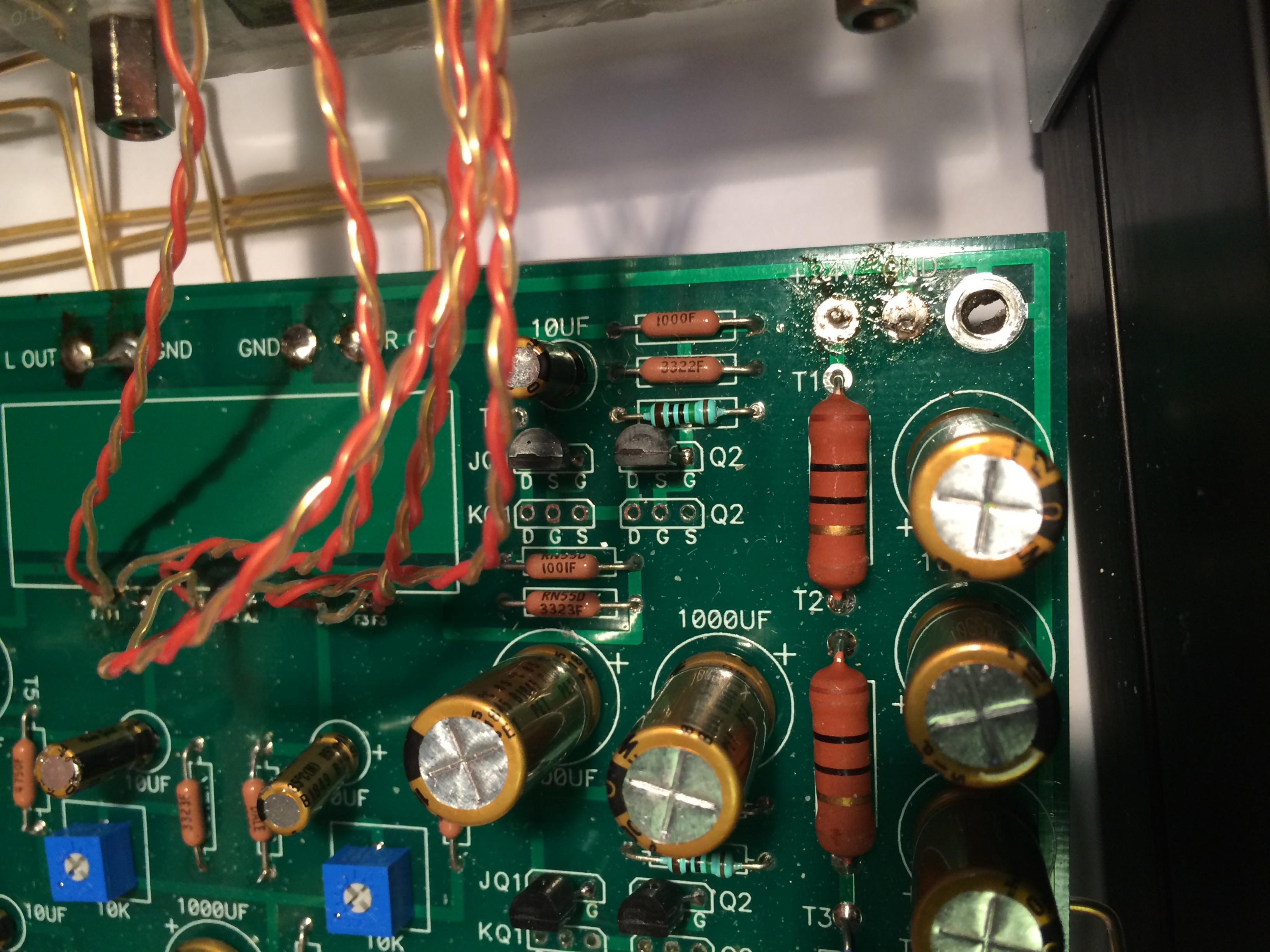

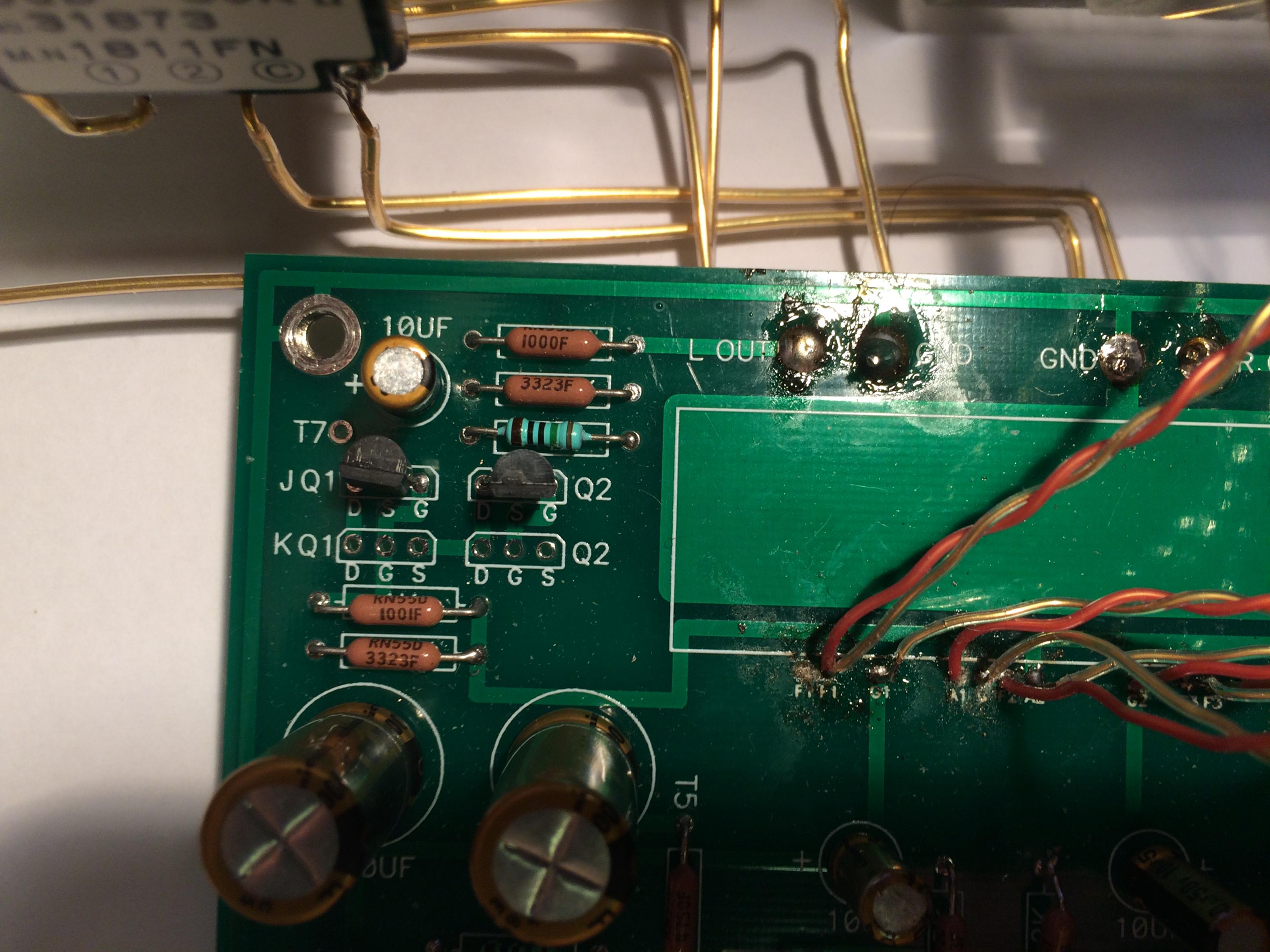

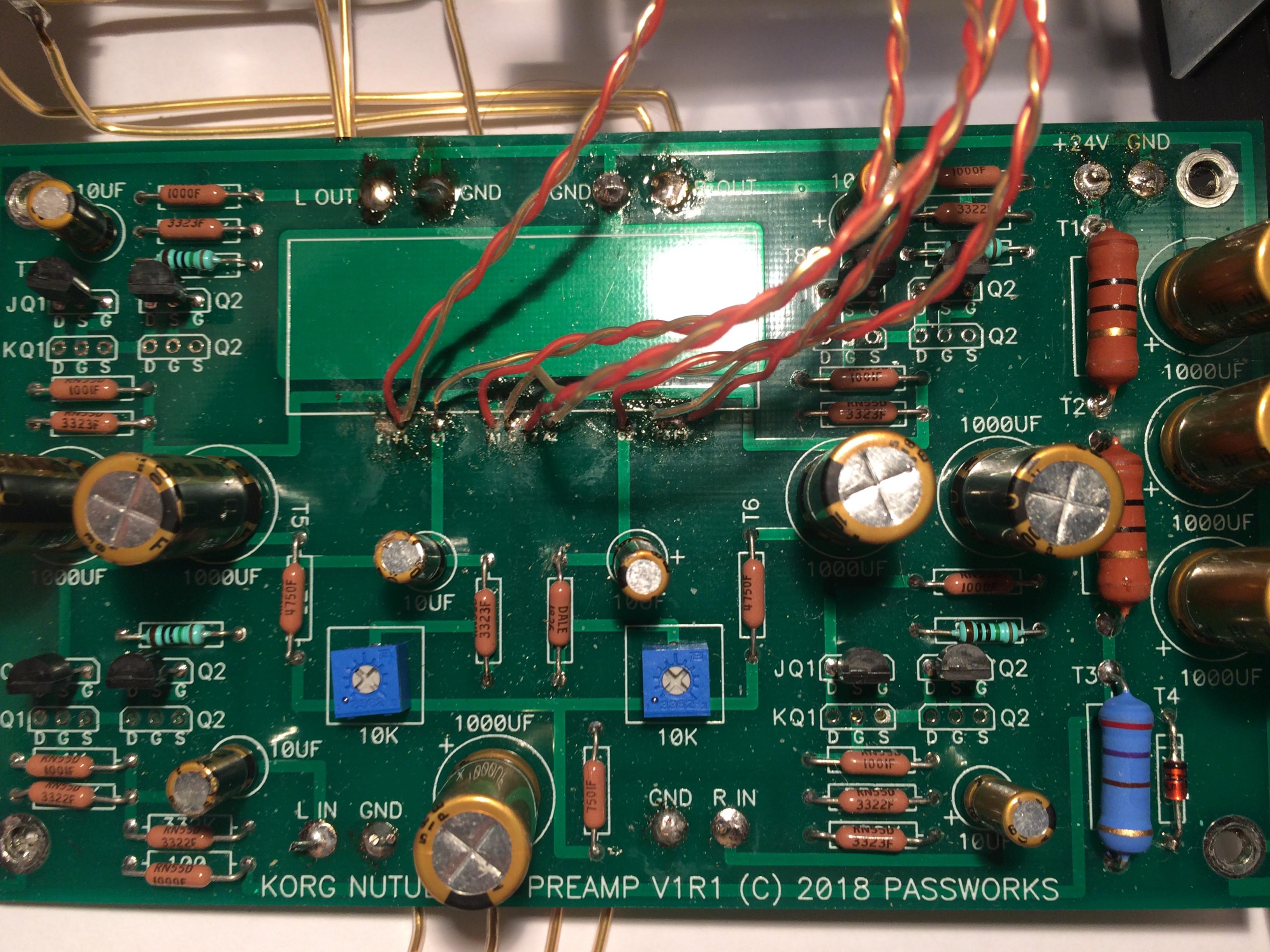

Idiot check required - would appreciate someone having a look at these as I posted previously I can't get my voltages down to below 10.5 on one side and 10.2 on the other. I have a new tube on order just in case i've gotten the original too hot soldering it and desoldering it to swap cables. As an ex welder you can assume my soldering is good but i had to work hard to workout where the resistors should go.

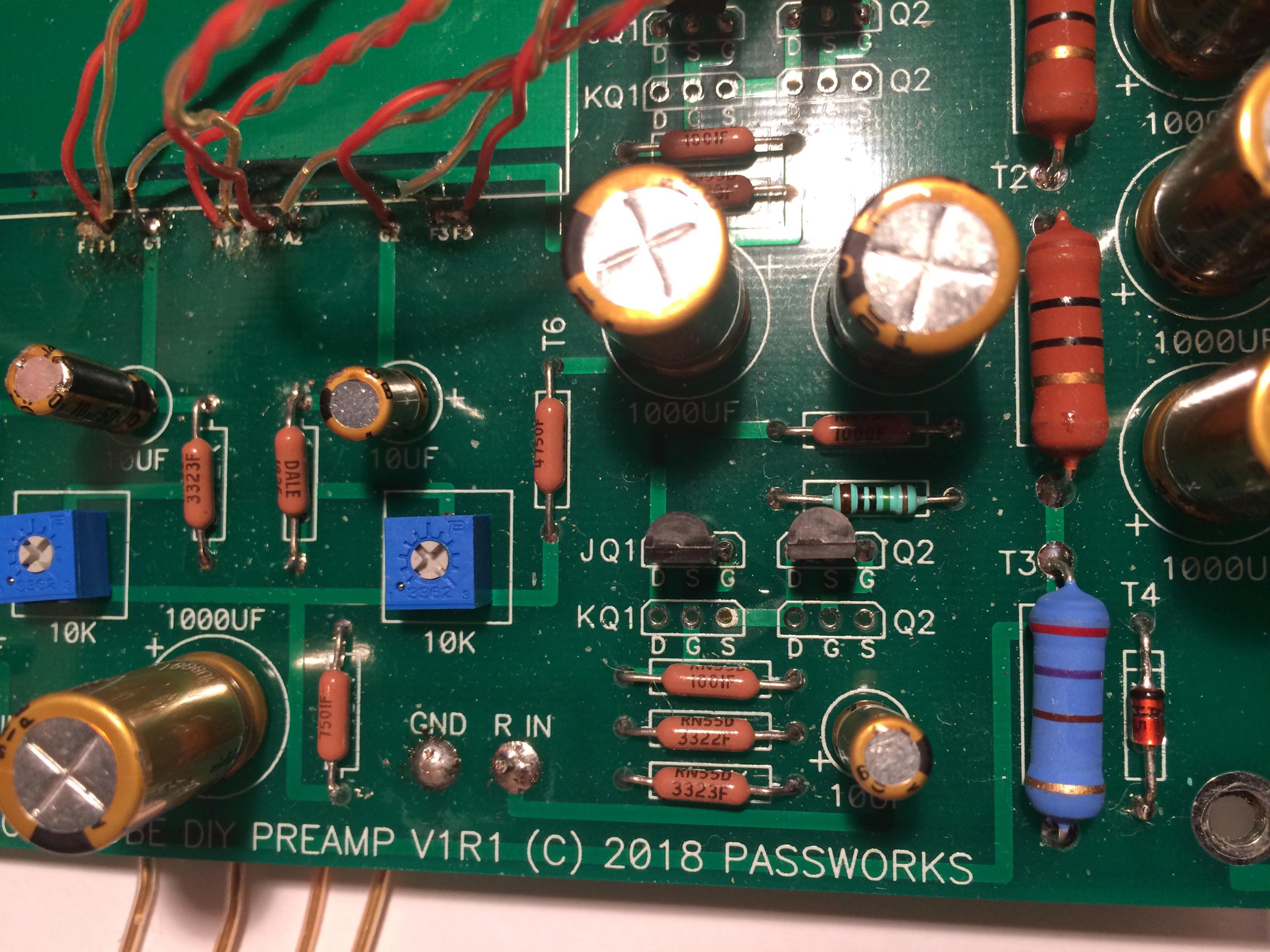

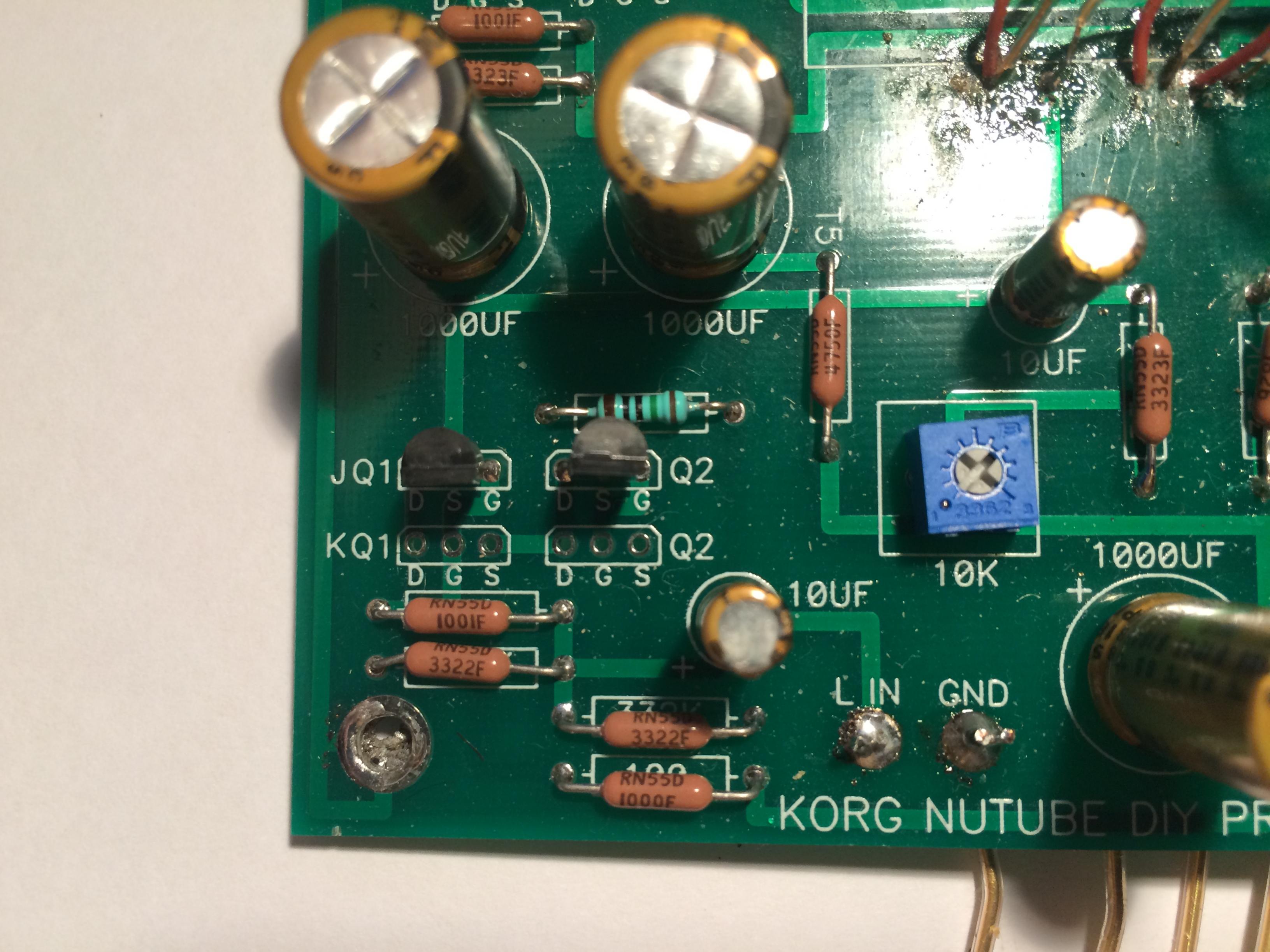

Check your 33.2k and 332k resistors, you may have confused a couple.
Michael
Yep. Take care with "3322F" and "3323F".
332 is the value, last digit is how many zeroes - 3323 = 332,000 ohm or 332k.
Found one misplaced checking others now! I should know as a draughstmen you don't spot mistakes till you've printed them - spotted first one in the photo the minute i posted it!!!
Been looking over your pics and I could be wrong here, but the part number on the adjustment pots appears to be 3362 which is a 100k pot according to mouser, when it should be a 3386 10k pot.

Not relevant to fixing the problem, but once you've troubleshot and fixed the problem, consider using a flux removal cleaning to remove flux from the board. Will likely avoid future problems.
Those markings are not the resistance value. 3362 is one series / configuration of Bourns pot, and 3386 is another series / configuration. The resistance is noted on the side and not visible in the pictures. You can get either series in the correct value.

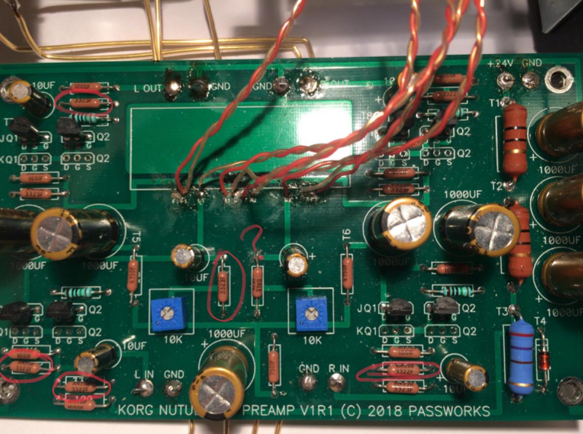

Hi Steve,
I was checking out your picture closely and it looks like some of the 3322 and 3323 resistors are incorrect. The attached picture has circles around the suspect ones. Give it a look over

I will clean the board it looks messy now i've soldered and unsoldered a few things. Is it worth buying a multimeter capable of testing the transistors? Is it easy to fry those.

Did you look at post# 3570?
I have now thanks. I only found one pair that didn't match other build photos earlier in the threads. Have others go this wrong too?
There are 3323F and 3322F which ones are which?
For the full build kit colour coded and sorted resistors would be safer and less confusing.
