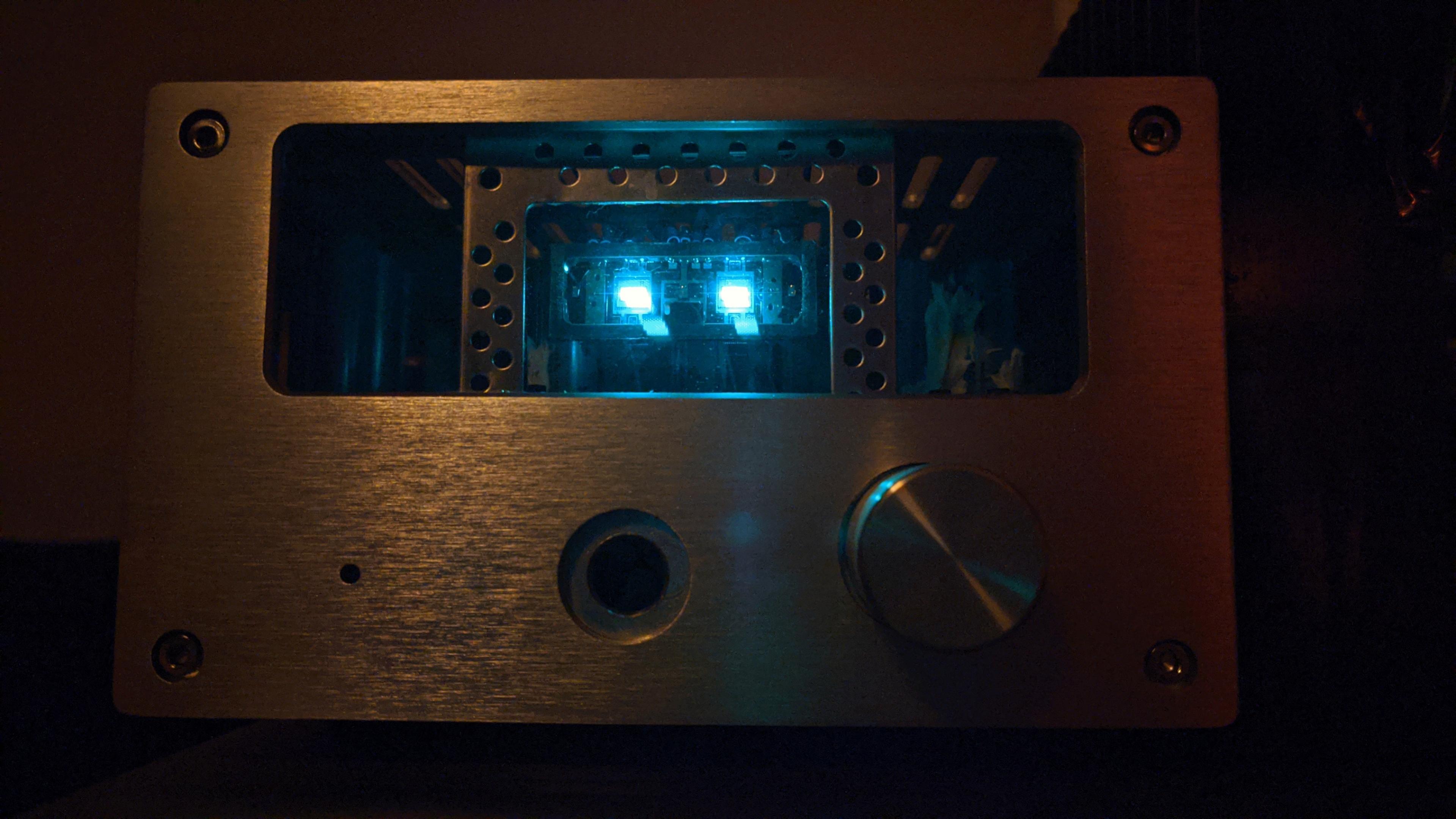

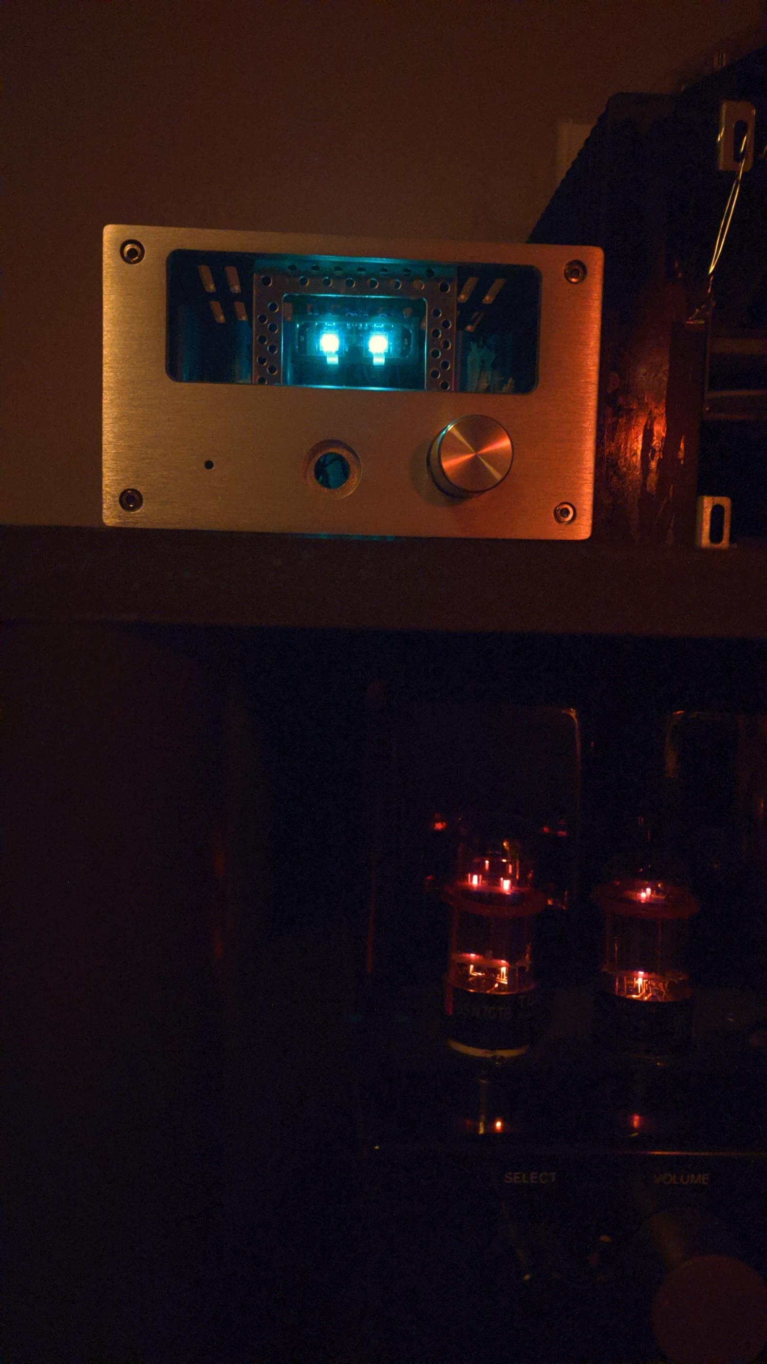

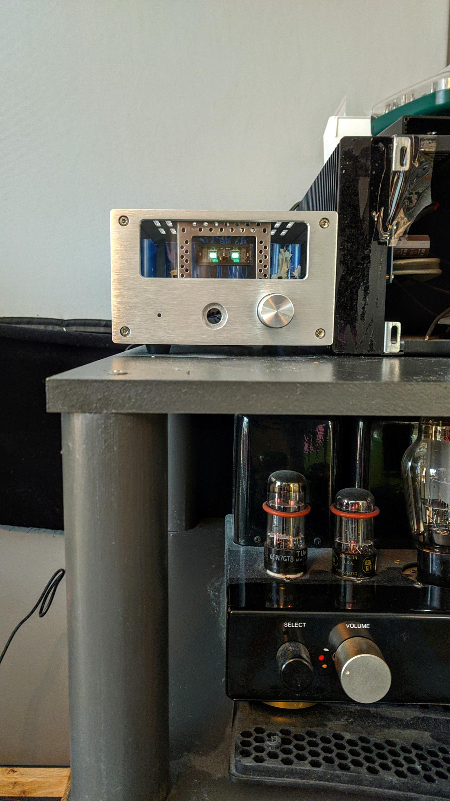

Here is my attempt. Was pretty easy to dial in the 9.5 V om T7 and T8 (after flushing all the solder points). I used velcro to dampen the piece of plexy glass it is glued to, behind the front front plexy glass. I can still hear some microphonics, but only when smashing two pieces of wooden toys together, which happens surprisingly frequently in my home.
Sound is warm and open, but the tube saturation is more towards a fuzz guitar pedal than a tube preamp. I use it with an F5 amplifier, and it has never sounded better. I used a B1 preamp before, which now is used with an integrated Sun Audio 2A3 replica amp. This gave me the opportunity to try the Sun Audio amp on max volume with B1 as a volume control, and it became overwhelmingly FAT! Had to tone it down a little. I use the B1 + tube amp on 15" JBL woofers, and the B1 Triode + F5 on my mid and high horns. All I can say it is that it is better than before, but I wonder if I should use a real tube preamp with the F5. I thought the Sun Audio replica amp is too imprecise for mid-range, here the F5 is more accurate, but the F5 was always it bit hard sounding, but not any more thanks the B1 Triode. I may add some decorative flourescent volt meters for T7 and T8 in the future, with an off switch, just to fill that empty hole in the middle of the chassis.
