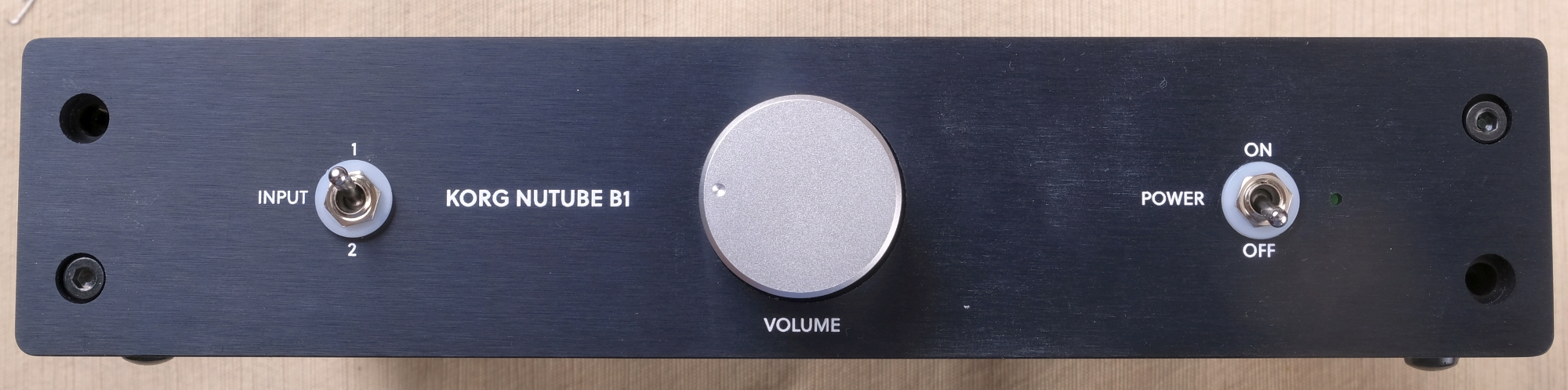

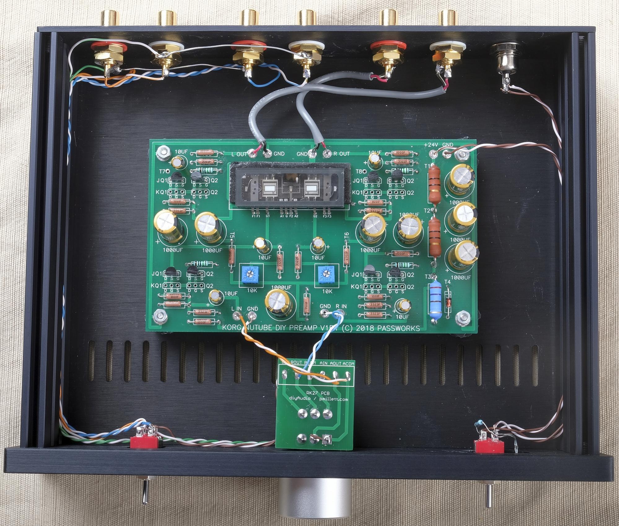

B1 with Korg Triode
What it does do different than the above preamps is layer front to back. Sometimes it sounds too forward, sometimes too recessed. It’s really picking up cues from the recording and varies from album to album.
I thought it would sound “dark” but actually I find it a bit bright? Like a little upper midrange emphasis?
I also found it a little too bright with the project settings of 9.5v on the pots when combined with my M2-x (ishikawa input board). For me the remedy was to raise the pots adjustment voltage until I liked what I heard, and Ended settling on 10.5v
Great little preamp!

B1 replaced by B1 Korg sounds gooood
I removed my B1 to resolve the ringing when changing input and listened to my straight B1 for a while. Sounded good with the improved 24v supply, should have done that sooner.
The Korg is now sat on some sorbithane I had. Can't get anything to stick to it so ended up clamping using what I hhad around. The PCB is mounted on the rubber stand offs suggested earlier. These probably do more to suppress than the sorbothane. Removind the Korg was not easy, so good luck to anyone with ringing that isn't solves by the rubber stand offs.
The b1 Korg is back in, and staying. Bothe are using the same caps. Standard 9.5v setting with speaker polarity reversed. I get the deeper sound stage described by others. But its the tone that seems to have got more full and lush that I'm really enjoying. Didn't expect that.

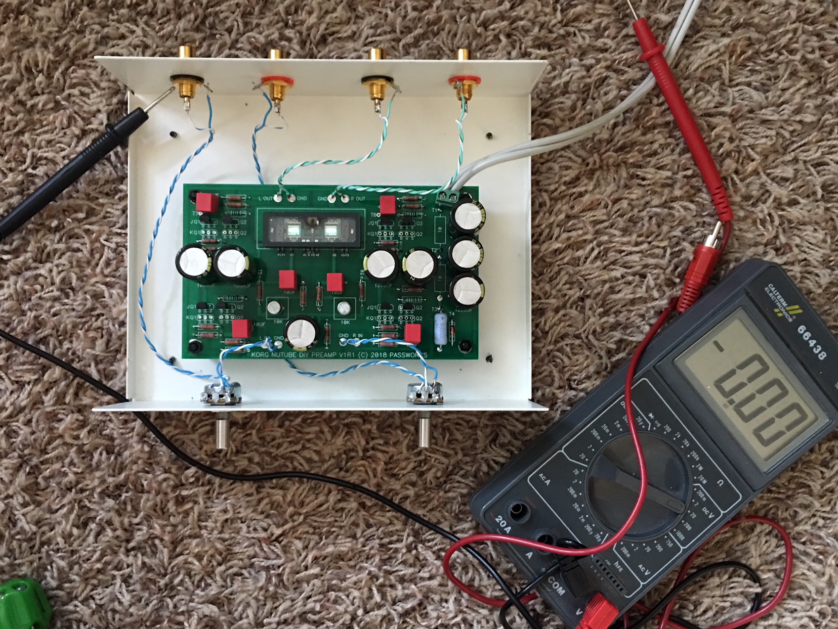

Jim, all is well now. I have a Hakko powered solder sucker. I removed each of the active devices using it. Put everything back and resoldered.
Now all of the voltages are correct and I can vary the voltage at the T7 and T8.
I have two theories, one mostly likely is poor soldering on my part, the other might be on some of the holes or perhaps just it didn't plate through.
Oh well, it works and music flows from it.

Glad you got it sorted out. Enjoy the music!
