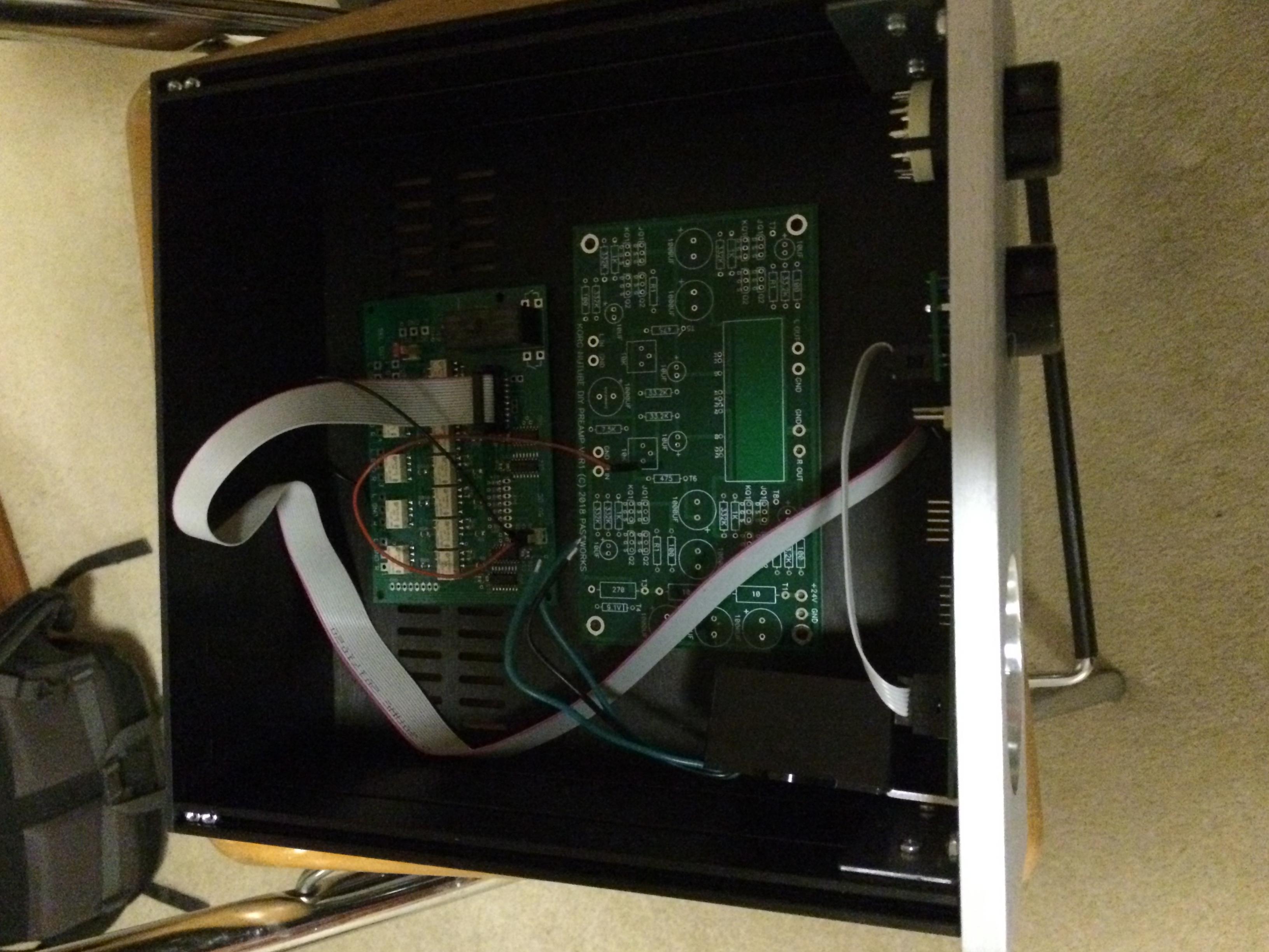

Re-soldered all joints on the PCB and now all working fine.
As to hook up wire I replaced the included wire for the power only because I prefer red and black for a DC supply. The supplied wire is perfectly good.

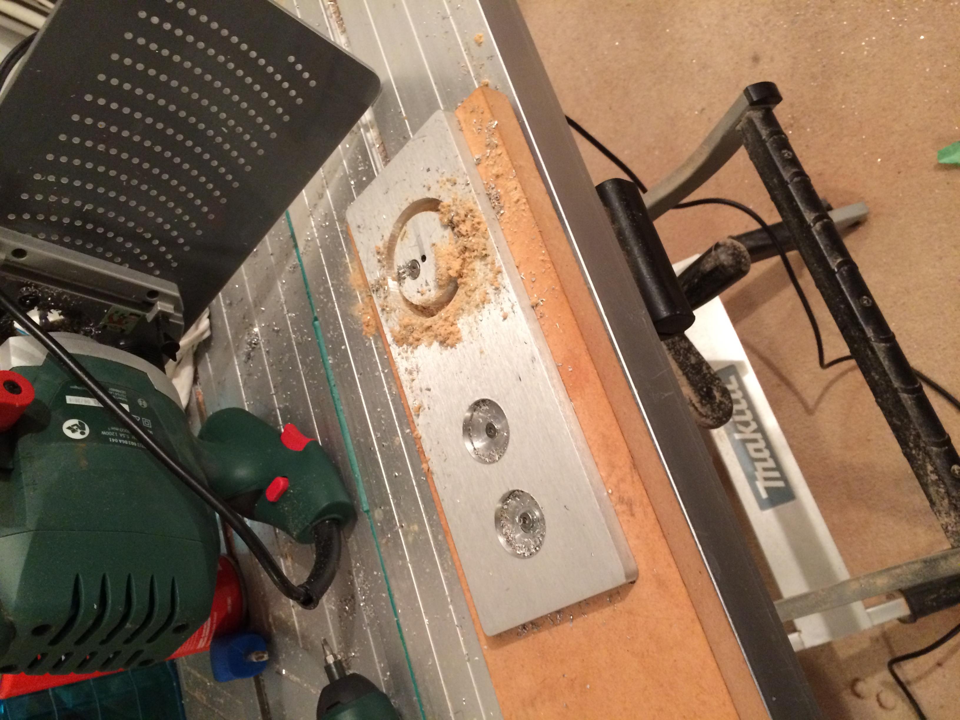

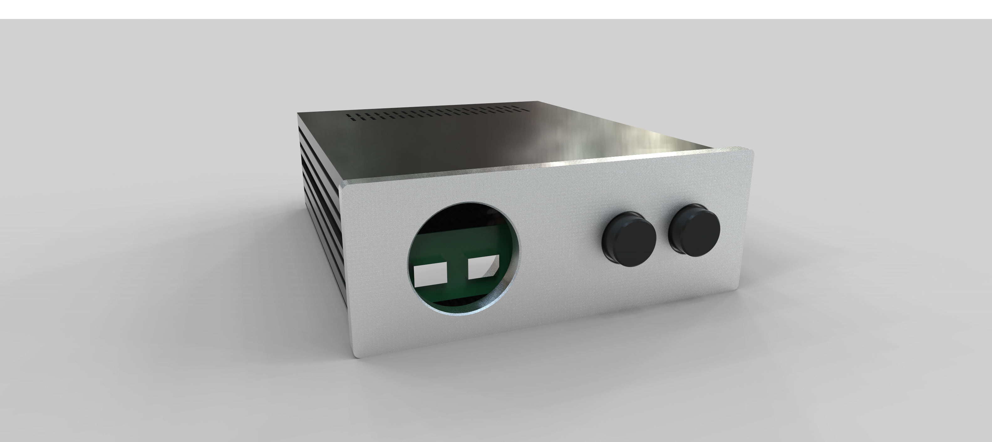

I down loaded the CAD files for the Galaxy 2U imported them into Rhino3D and played for ages trying to get something that would look good and would work with the boards and got this:

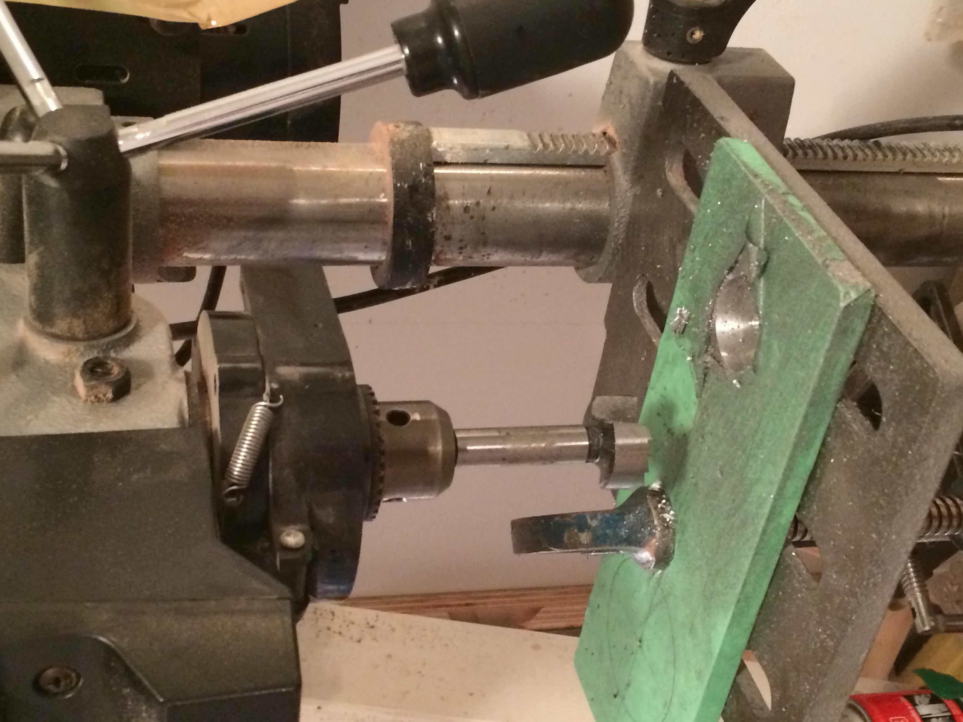

Watched some videos on youtube of guys doing stuff to Aluminium with woodworking tools that seems wrong at every level but felt the fear and did it anyway:
Scary stuff taken slowly with lots of care clamping and WD40

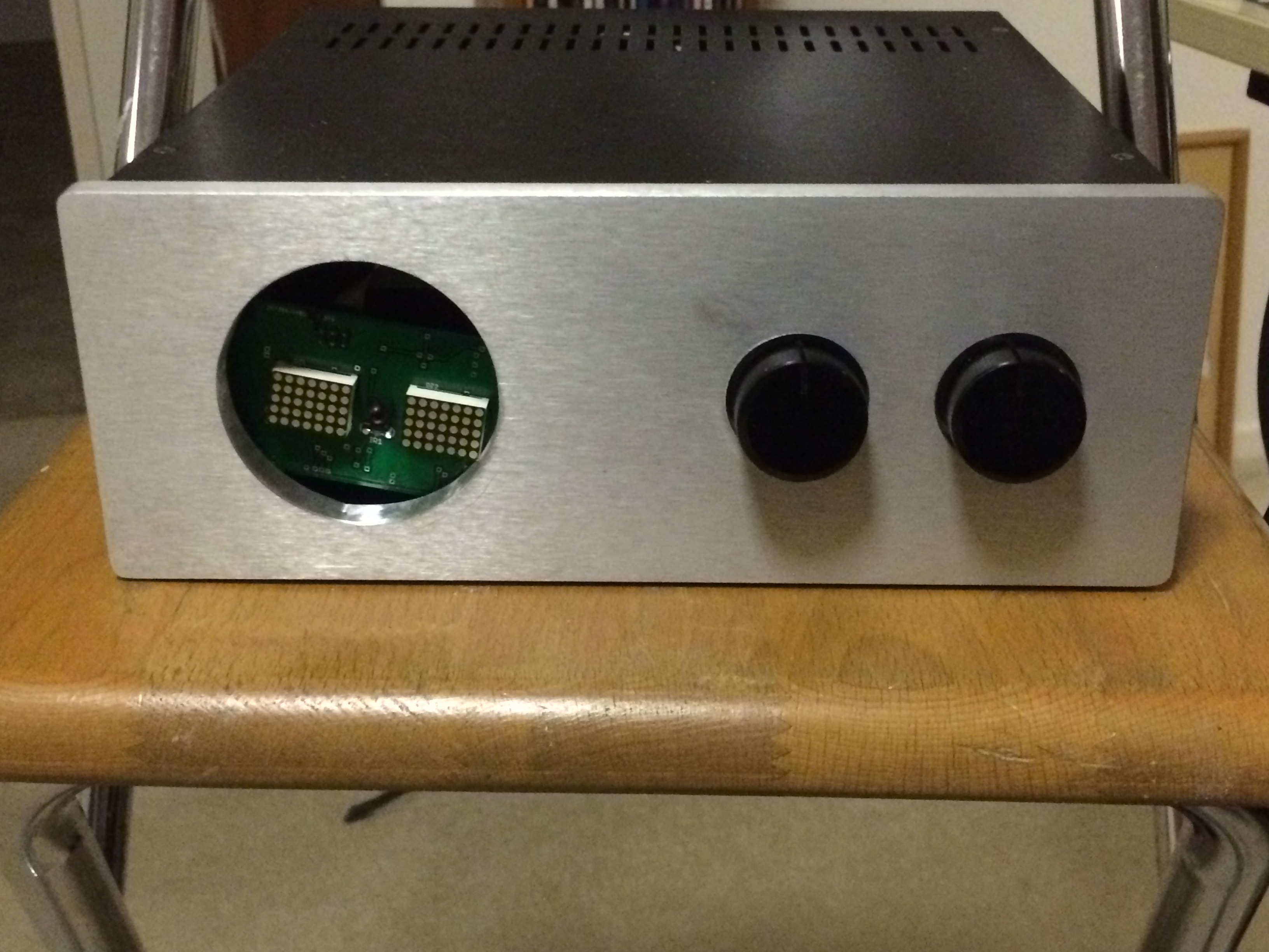

Two boards visible the Korg and the Khozomo at the back. Khozomo led matrix and korg will be visible through the window behind smoked perspex I picked up for $5
Looks nice, Steve.
WD40 is key to keeping the chips of ally from fusing with your tools when cutting. Look forward to seeing the end product!
Steve Luck:
Which kind to router bit do you use for cutting into aluminium?
Do you run "full speed" like cutting into wood?
I think it was a double fluted 6mm Tungsten Carbide. Nothing special just one that looked sturdy enough not to snap off and small enough not to lose speed and bog down. It took a couple of dozen passes and I stopped a few times to clear out the swarf and spray some more oil on it. You tube videos suggest you slow the speed down but I found it worked better with a bit of speed. Too fast and you'd heat everything up. As with circle cutting wood using a router the biggest trick is to ensure the centre of the circle stays put when you break through because it's whats holding the router in position. You'll see in the photo a screw offset from the centre of the circle holding it in place. The result isn't CNC perfect but it's cleaned up with bit of sandpaper in the drill press. I have a bit of dowel with a slot cut into it that I can put strips of sandpaper into to polish things up with. I thought the brushed finish would suffer and kept a sharp eye out for any swarf between the router base and the front. There's a couple of micro scratches that might benefit from being gone over with a scouring pad but not something instantly obvious.
avtech, if you are close, you'll have to come over sometime, I have a few DIY bits in my system. Building speakers next, a Lenehan LK1 kit.
Thanks Batty, drop me a PM which suburb you're in.
How did the Forstener bit fair in ally?
I was very surprised by the forstner bit it made slow but steady progress and did a neat job creating countersinks for the knobs. I put the drill on the lowest speed for that to get some torque as the drill is pretty gutless and the motor stalls given a chance. Guy on Youtube compared using a forstner bit to using a spade drill. The spade drill went through very easily creating big ribbons but left a threaded edge. Forstner bit is smooth cut with a small bur on the top edge.
