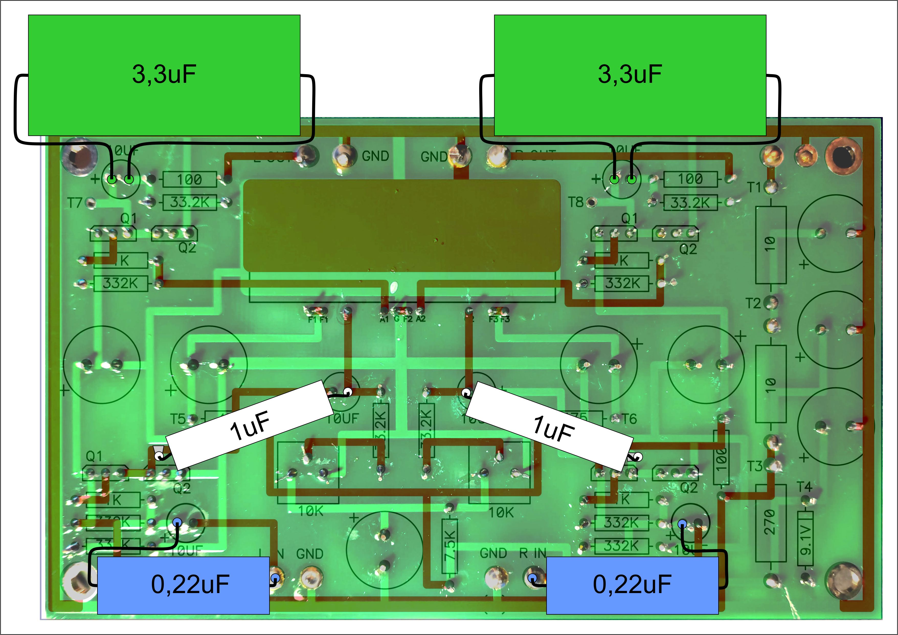

This might be useful to people who want to change the elcos in the signal path for film caps. Note that board is a Christmas giveaway board!
The top is in red-ish. The second pic shows how I have placed film caps on my board.

I am sure the Elna is ok for this purpose. I have tried electrolytics several times and the sound is ok because off the dc on them. If not I would not use them. And never for more the aprox 15 vdc. More then that and there will be dc after them. And I can not explain why.
Of course, electrolytics do their job, but film caps bring the sound to another level!
Depends on the Quality. Often they are worse. To much focus from upper midrange to treble. I always use KP and not MKP.
Ok, I never intended to start a neverending debate on caps...
I just wanted to give people who wish to try installing film caps a useful picture diagram. That's all.

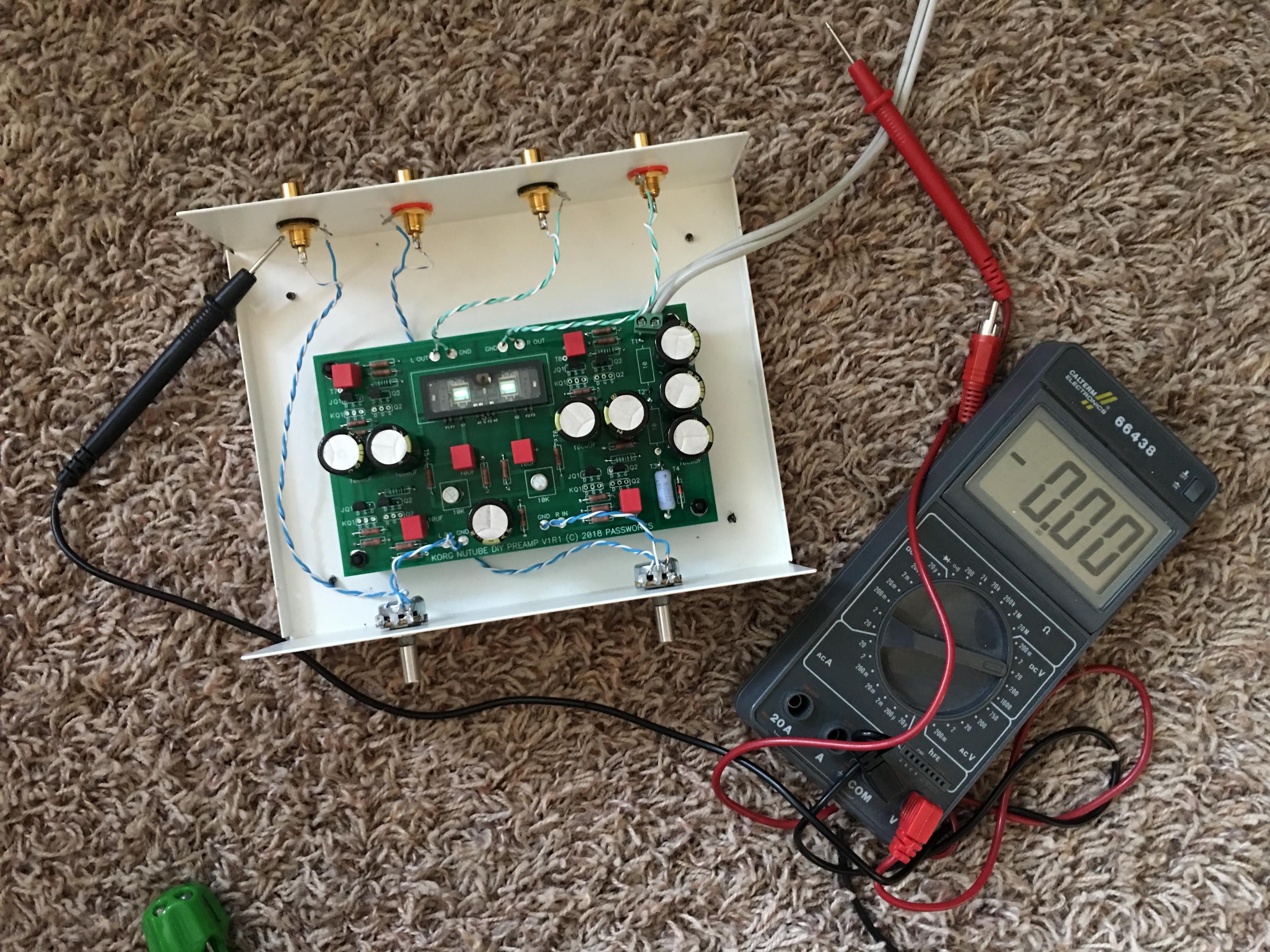

Ok finished "pioneer kit" this evening. Voltages check at first then, all decline.
I checked all solder connections, then passive components and then active components.
Ah Ha moment. I didn't check the bag of Q1 and Q2 to make sure that I had same four transistors in each. Just soldered them in place. My bad.
Q1 bag = 4- J113 KH33
Q2 bag = 3- J113 KH43 and 1-KH33
I suspect this is why I have nothing.
Please help me Nelson!!

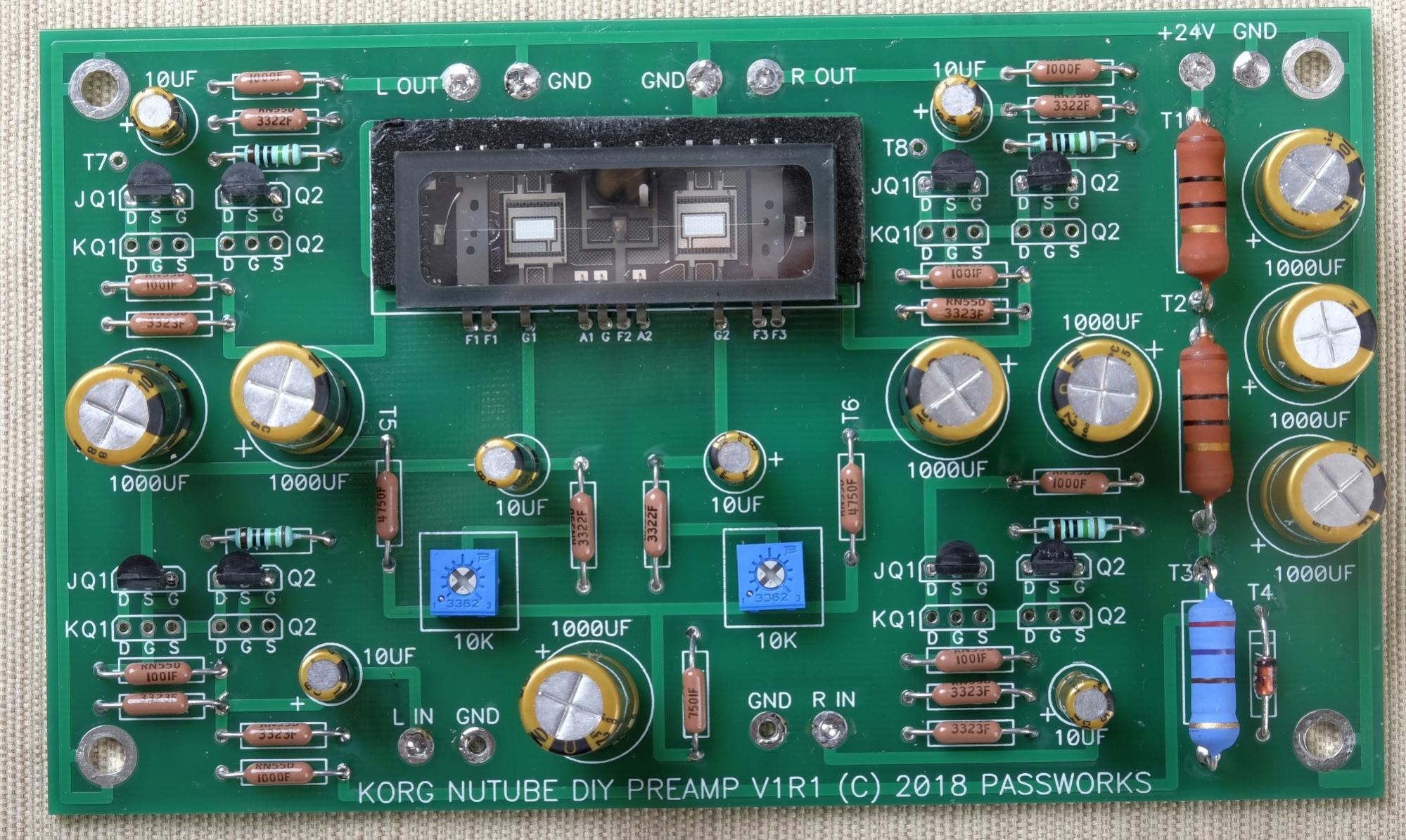

I think those are the date codes...
Your transistors appear to be 7.3 in both bags, so you should be able to mix/match with no detriment.
Can you post a couple well-lit, in-focus photos of your PCB? If you can show the back that would be helpful as well.
T7 is 10V but T8 is around 16v, any ideas?
You cannot adjust t8 with the pot? Perhaps your pots were not set equally when you started it up.
