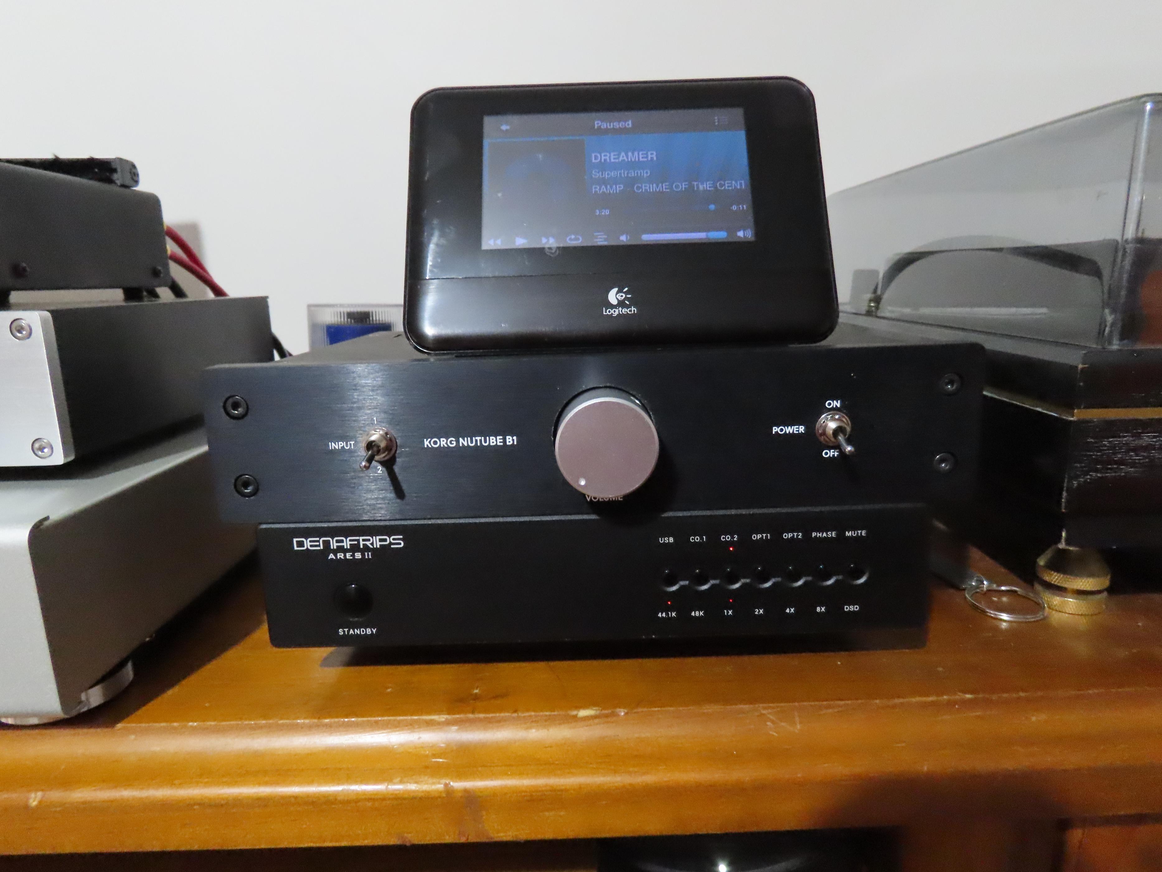

Just finished up my pre amp now, its 03:06 in the morning here in Norway..
More images and impressions will come during the weekend.
But so far, i am so pleased with it.

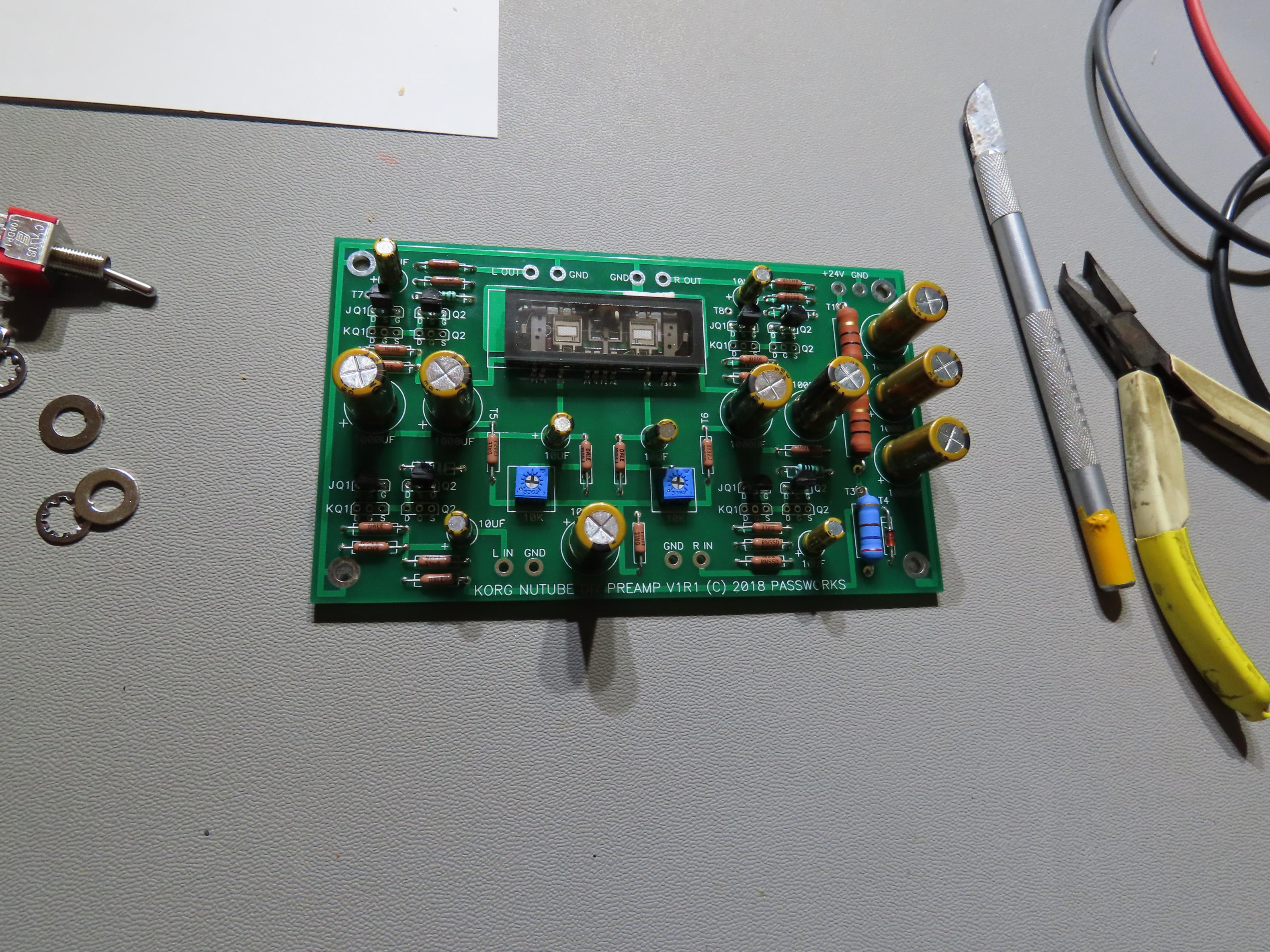

PCB built and put in chassis, still to do internal wiring though

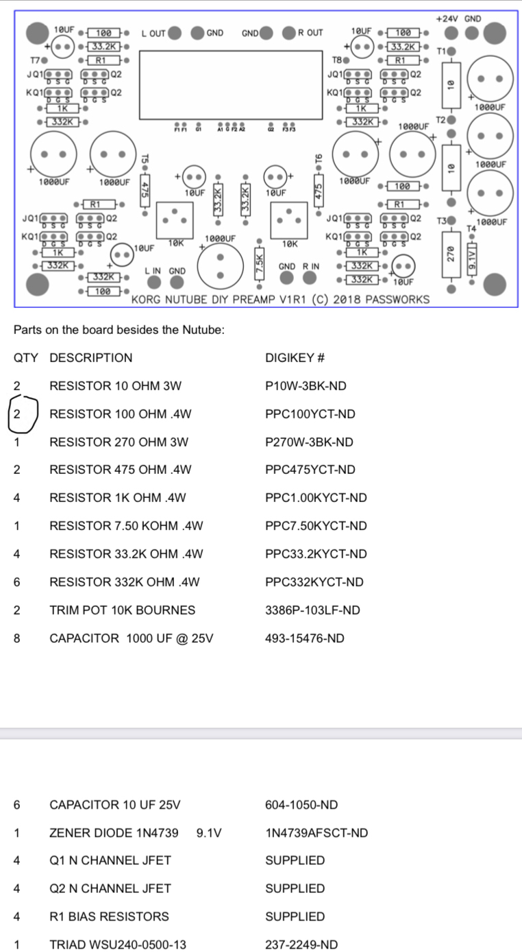

There are some incorrect BOMs out there. Check the components on your board layout vs the BOM you reference. I've asked Nelson to correct them. But so far I see nothing corrected.
The schematic in the B1 article on firstwatt.com is updated and correct. The silkscreen matches this schematic.
http://www.firstwatt.com/pdf/art_diy_nutube_preamp.pdf
The schematic printed out and included in the (first batch only) kit of parts is one of the older versions. My error. Use the schematic in the article and/or just stuff the parts into the PCB as labeled, the silk is correct.

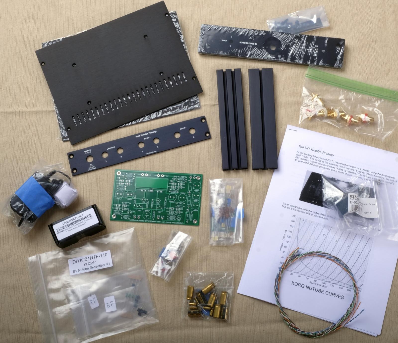

Just starting my build. Supporting the store and all that have contributed to this project. I built the Pete Millett head amp awhile back and know how the vibrations affect the Korg tube.

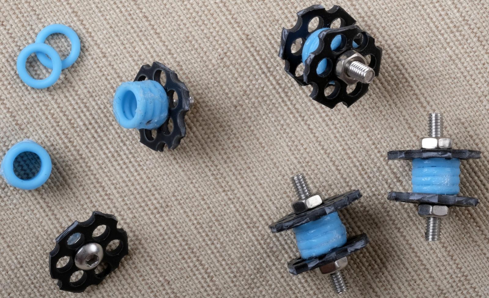

Rather than buy a commercial isolator, with the spirit of DIY here is my take on some homemade isolators. Please note the attempt at Pass blue. These are silicon dampers used in keyboards. A few cents apiece. The grids they are mounted on is some plastic screen I had on hand. Some 3mm screws and a stack of four dampers with the circuit board in place along with the tallest component will fit. Hopefully this will help some on vibrations. The two adhesives I found that would work with the dampers I bought are shown in one of the photos.
More to follow.
More to follow.
I believe that the BOM in the article states that only two 100 ohm resistors are needed when 4 are needed. This has been brought up a few times in the thread as mentioned by Bullitt a few posts back. Following the BOM along with the Silkscreen on the board as 6L6 mentioned will help.
