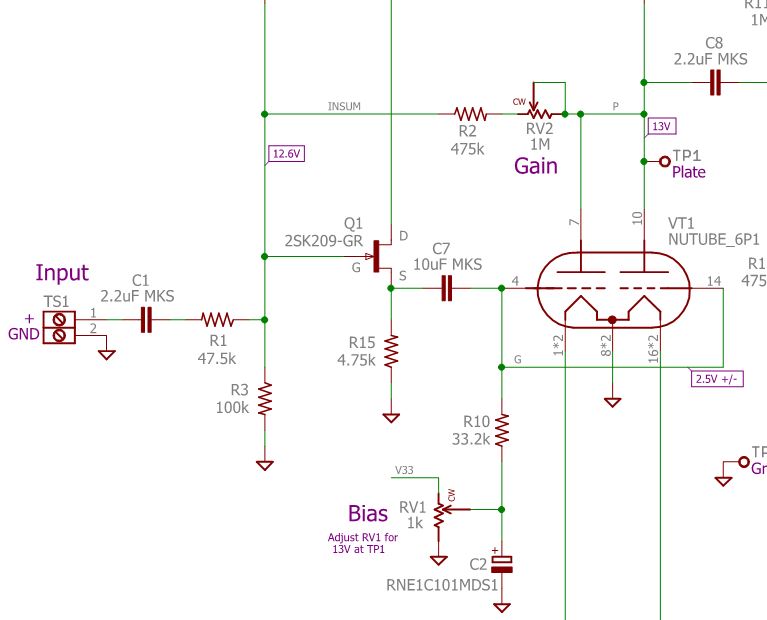

The attachment is a Schematic that was forwarded following the purchase.

The original schematic was an example provided by Korg, and my version is just a
small variation. Pete Millet has one of his own, and probably there are others by now.

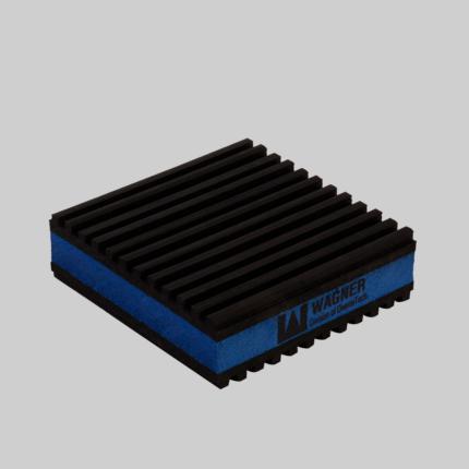

So far, the preamp sounds great piping music through my McIntosh MC240 tube amp; however, the microphony is a problem. I used the double side foamed tape to mount the NuTube to the PCB, but the ringing is audible. I will comb through this forum on remedies, but I would think that builders would like a proven solution for this.

I suspect the magnet damps the 5K filament wire resonance. I had a Millett NuClassD amp with one tube that had filament resonance much worse than the other. The amp uses a separate tube for each channel with the tube sections in parallel, so you get 2X the filament ringing problem. Loudspeaker bass notes would excite the ringing, even inside a covered chassis.
The NuClassD circuit has a variable resistance connected directly between the plate and the input JFET gate to provide a small amount of negative feedback. It is a 475K resistor in series with a 1 meg pot wired as a variable resistor. Pete put it in ostensibly to balance channel gains. I found that increasing the NFB just a bit got rid of the ringing and totally improved the sound of the amp without the NuTube H2 magic going away. I had previously changed the plate resistors to allow tube biasing at less than half supply, to provide a higher H2 than the circuit can provide as drawn. So I guess I had some H2 "to burn" when increasing the NFB.
My next experiment will be adding adjustable NFB to my B1Korg to play with the sound character. I know NFB is supposed to be this "awful" thing, supposedly avoided at any cost, but in the NuClassD situation it really made a positive difference. I used a fixed signal input level at 1 KHz and lowered the output voltage in small fixed steps until the problem went away, then balanced the other channel to match. It should be easy enough to add this to the B1K and see what happens. Then, not only can the harmonic content be adjusted with the bias pot but low level tube resonances can be dialed out with NFB.
Well I tried Zen Mod’s first suggestion and so far, so good. I am using these rubber and foamed EVA polymer composite pads used for vibration isolation of HVAC equipment. I have these under my ARC phono stage and ARC line stage preamps, and they seem to do a good job with those components.
On switching inputs, it did trigger some ringing, but once that disappeared, the preamp was quiet. Before using the rubber pads, the ringing never went away.
With the absence of sustained microphonic ringing, I can really enjoy the music. This little preamp is impressive indeed.

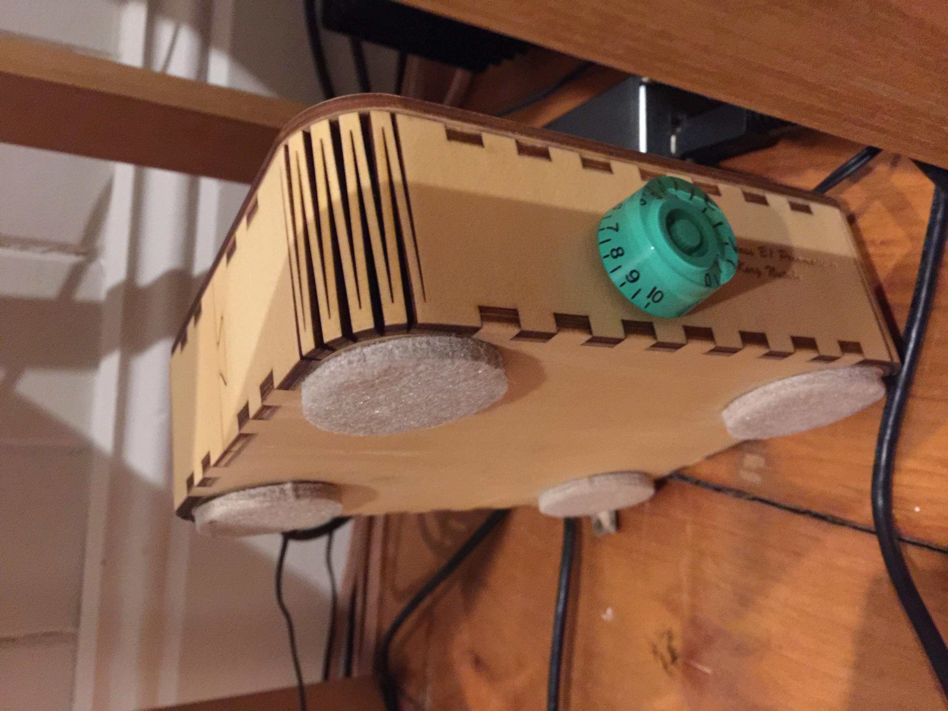

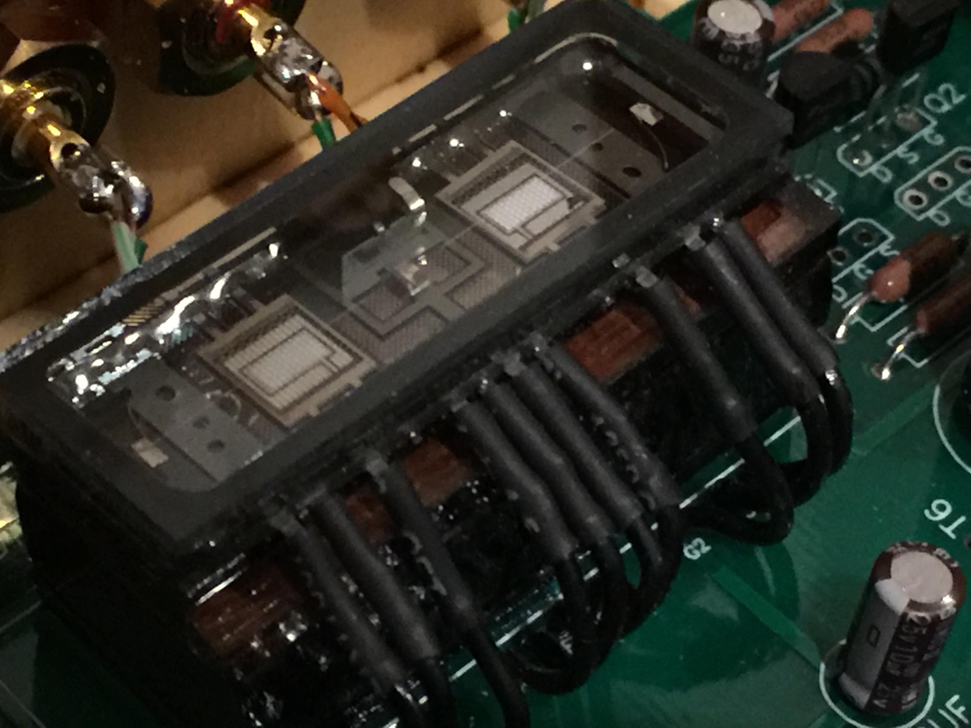

My microphony mitigation is a bit over the top but it’s worked. No ringing at all. A bit hard to see in the photo. Under the Nutube is a piece of 3mm thick double sided gel tape, a 1/2” thick piece of very dense hardwood and another piece of 3mm thick gel tape to stick the stack to the pcb. Flexible wiring between the Nutube pins and the pcb. My “add mass and damping” solution..
As well as that... The pcb is mounted on rubber isolating standoffs similar to those mentioned above. The kind that drone builders use to mount flight controllers into quadcopter frames..
As well as that..... I’ve put soft felt feet on the box.
