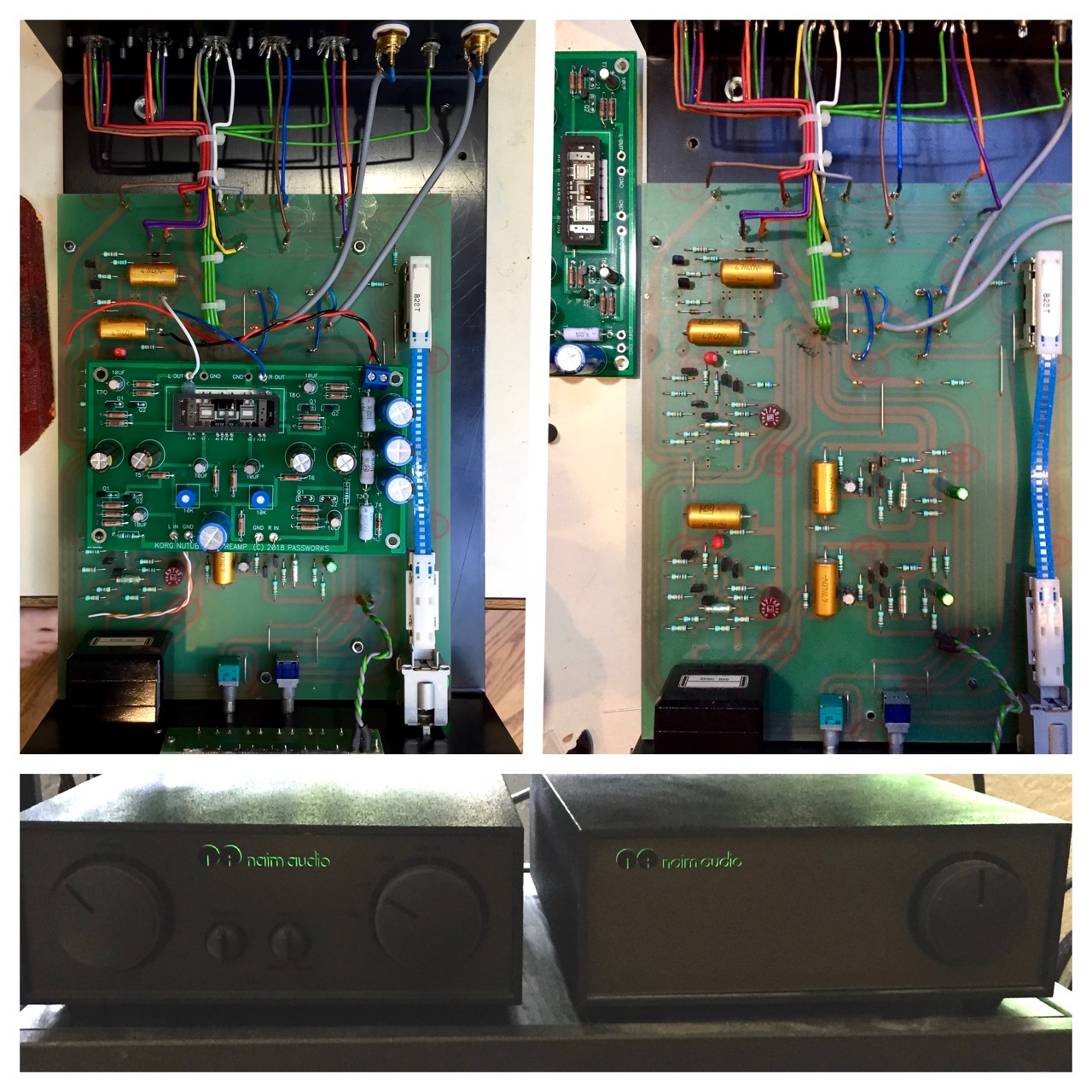

This is a B1 Korg build using the Xmas board and matched set of Toshiba JFets. Many thanks to Papa Nelson!
I had a full plate of other amp builds earlier in the year, so wasn't in a big hurry to build the B1 Korg preamp right away. I thought about some of the other options for chassis, volume & switching controls, then realized that a quality donor chassis would be a nice way to go. The Naim NAC 62 preamp is a great entry level preamp which fits in nicely with the rest of my system. It also happens to have plenty of room for the B1 Korg PCB. This ended up going very well. The basic NAC 62 circuit consists of a set of line level inputs (plus phono with extra gain & eq board), followed by a selector switch which feeds an initial buffer stage. Next are the volume and balance controls and finally a pair of amplifier circuits that provide the overall gain for the preamp. The power supply is external, and may come from one of the smaller Naim amplifiers (NAP 140, 150, etc) or a separate HiCap supply.
I constructed my preamp so the B1 Korg replaced the final gain stages, keeping the rest of the buffer, volume and balance circuits intact. I did take the opportunity to upgrade the coupling caps in the buffer to 2.2 uF Nichicon ES series caps on the input and 10 uF Elna Silmics on the output. The NAC 62 allows for two regulated +24V power supplies, split between the low level and high level gain stages. I took advantage of this to give the B1 Korg a +24V rail that is separate from the input buffer.
I kept the B1 Korg build pretty much according to spec (weird, I know), using 1000 uF, 35V Nichicon KA series caps for the first four positions in the boards local supply, and 1000 uF, 25V Nichicon KW series for the local channel supply decoupling. Initial voltage checks showed things to be in the proper range, and I set the T7 & T8 voltages to 11.75V to keep harmonic content fairly clean. My HP 339 distortion analyzer shows about 0.03% THD while the output of the preamp is producing 4V p-p.
The Naim preamp is housed in a sturdy chassis which is designed to offer some isolation from external vibration. The PCB has large piece of foam rubber underneath the buffer and gain stages, and an external one piece heavy aluminum box which slides over the U-channel base plate which houses front and rear controls & connectors. I mounted the B1 Korg PCB onto the main PCB with a pair of left over foam pieces from the interior of a Pelican case, using double sided foam tape to hold everything securely in place.
The extra measures to isolate the Korg Nutube from vibration paid off. While the case was open during initial testing and bias set, I tapped directly on the Korg PCB and observed a brief 5kHz signal riding on my 1kH test tone. After the case was all buttoned up, tapping on the outside produced no noticeable ringing artifacts at my speakers.
I have been running the new B1 Korg62 with my old HiCap power supply that was replaced with a custom unit that I built for my NAC 82. Source is a Naim XCD2 with another custom PSU, power amp is my Aleph J, and speakers are my venerable Vandersteen 2C. The B1 Korg combo is very pleasant to listen to, much like another good tube preamp that I have. There is no noticeable hum and only the slightest amount of hiss which is barely detectable with an ear next to the speaker. Initial tonal presentation was somewhat forward, but this became more relaxed as the new preamp broke in. In addition to the integrity of harmonic structure that I am accustomed to with Naim gear, the B1 Korg presents music with an engaging sense of flow. Again, one of the things I appreciate about better tube electronics.
Though it is somewhat unfair to compare this preamp to my reference NAC 82, for the much the same reason as comparing it to a Pass Labs XP-22, the B1 Korg does remarkably good job. Where the 82 – Aleph J combination is positively uncanny at imaging, presence and detail, the B1 Korg is simply excellent. And that excellence makes for a wonderful listening experience.

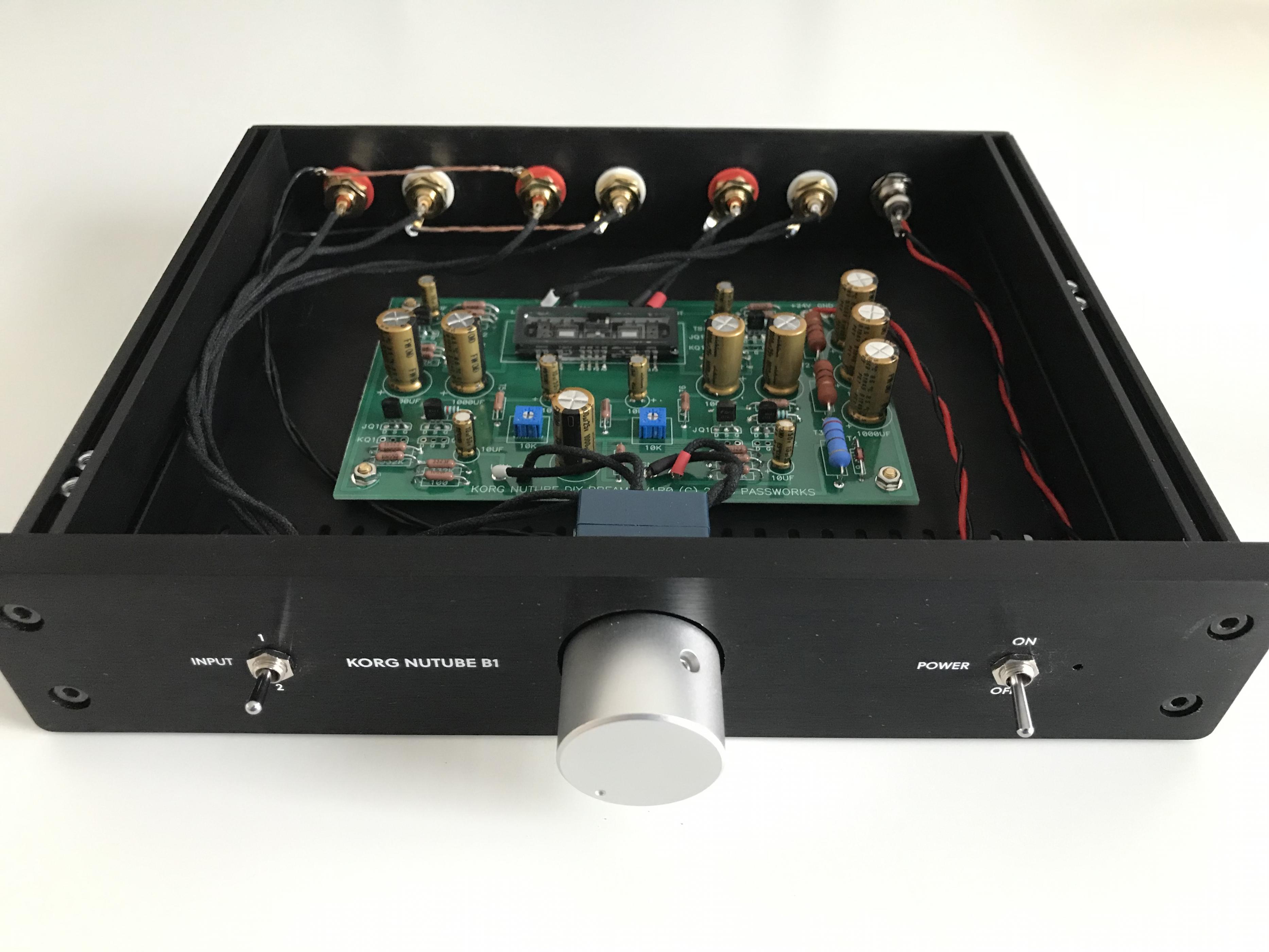

Thanks everyone for their help, especially 6L6. I finished the preamp and everything tests perfectly. However, I won’t be able to do any listening tests until this evening. I am going to try it out with my Pass DIY Sony VFET amp and my McIntosh MC240 tube amp.
Construction of the amp was straightforward as I used my own wire rather than the kit-supplied CAT-5 wire. Everything else is stock as supplied in the kits. As usual, the chassis is impeccably made and easy to assemble.

Absolutely fantastic! Looks very good!
Glad you stepped out of the box a bit and tried your own wire, the supplied wire is for convenience, and though I do quite like it for internal chassis duty, there's a lot of different ways to put these tings together. This is DIY after all... :yes:

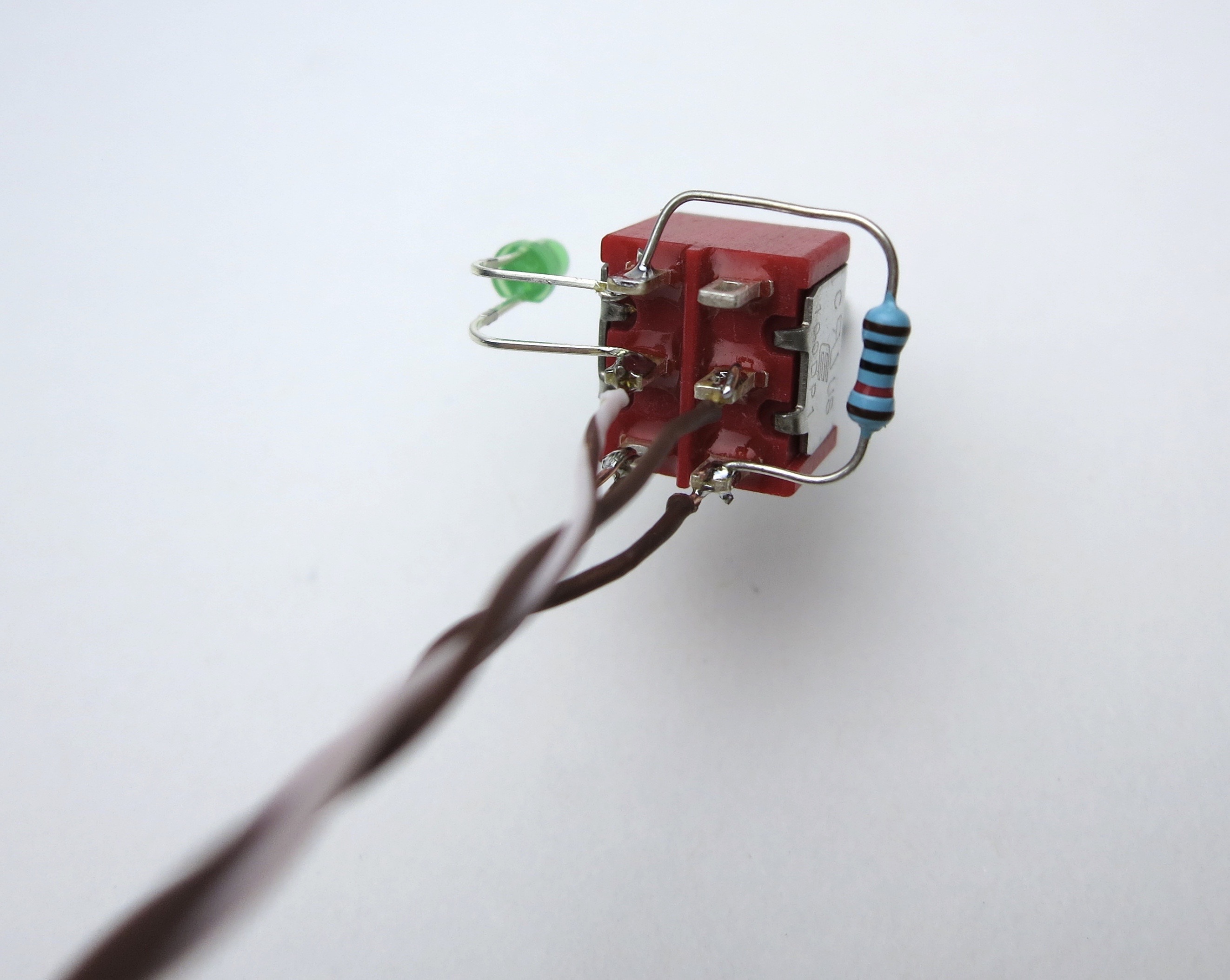

I did wire the LED backwards, but fixed that. That was just a careless error on my part. Anyway, I am looking forward to listening to this in my system. I am traveling to my old stomping grounds in the San Francisco Bay Area, and some of my audio buddies there have asked me to bring it along for auditions in their respective systems. The nice compact and sturdy chassis will fit well in my luggage.
