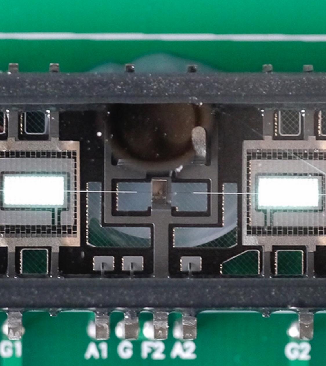

So my relatives have decided to stay put in Florida. I took a general inventory of the Completion Kit parts, and I didn’t see anything for mounting/damping like foam or rubber tape to mount under the Korg Triode IC. What is the general consensus for the best damping material?
...and I didn’t see anything for mounting/damping like foam or rubber tape to mount under the Korg Triode IC. What is the general consensus for the best damping material?
Mine came with some small white foam pads in the box—I took these to be for that purpose?. What a beautiful object!

I have now built (2) B1 Korgs, (1) NuHybrid headphone amp, (1) NuTube Buffer and (1) NuClassD power amplifier (uses 2 NuTubes, one per channel). That's a total of (6) NuTubes. They have all been mounted using the little double sided foam pads supplied with the device, stuck directly to the PCB and the device leads soldered directly into the PCB.
I only had a problem with one of the NuTubes, and that was one channel of the NuClassD amp. It turns out the filament will resonate around 5 KHz which is the ringing you can sometimes hear when you tap on the tube. Apparently some tubes ring worse than others. Interestingly enough, slightly increasing the NFB using the circuit trim pot designed for that purpose, which reduced the overall tube circuit gain and cleaned up the signal a bit, solved the problem without resorting to additional physical vibration isolation. This problem and its attendant solution may be peculiar to the NuClassD design, which uses both halves of the tube in parallel to provide the voltage gain for one amplifier channel.
The NuTube does not generate enough heat to matter, so one way to reduce any low level ringing that might not be obvious but still might be very subtly coloring the sound, would be to apply some damping to the exposed side of the tube glass and the connections to the PCB. I intend to experiment with this, and will report back.

I bought the Korg NuTube and Pass DIY PCB a few months ago and I never opened the NuTube box until I read your post. Just as you described, I found two pieces of the white foam pads. I will use these for starters. Thanks. Thanks

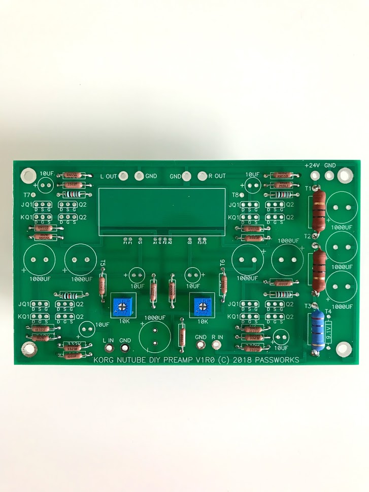

People who buy the Pioneer completion kit - I printed out the wrong schematic and stuffed it into the kit bag. The one in the article on firstwatt.com is correct, and also the parts in the kit match the printing on the PCB.
Use the schematic on page two of this article - http://www.firstwatt.com/pdf/art_diy_nutube_preamp.pdf

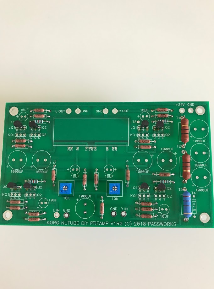

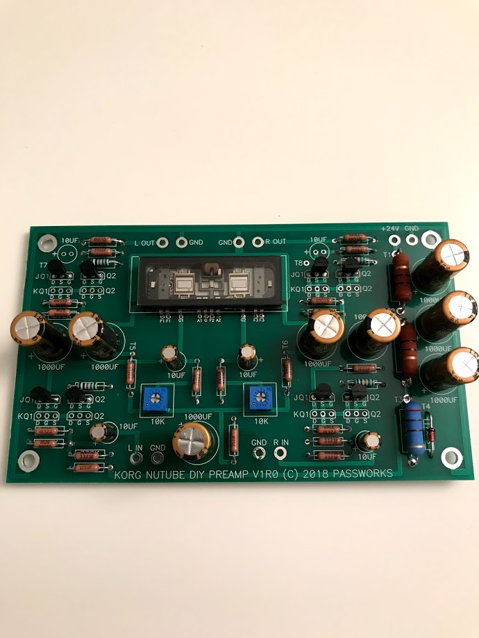

I measured all the resistors that came in the bag and followed the construction instructions in Nelson Pass' First Watt article: http://www.firstwatt.com/pdf/art_diy_nutube_preamp.pdf.
Starting with the shortest components, I first installed the resistors:
Next, I added the Fairchild JFETs that came with the bias resistors and PCB:
I then added the Nichicon FW capacitors, NuTube and diode:
I will begin work on the chassis and connections tomorrow.
