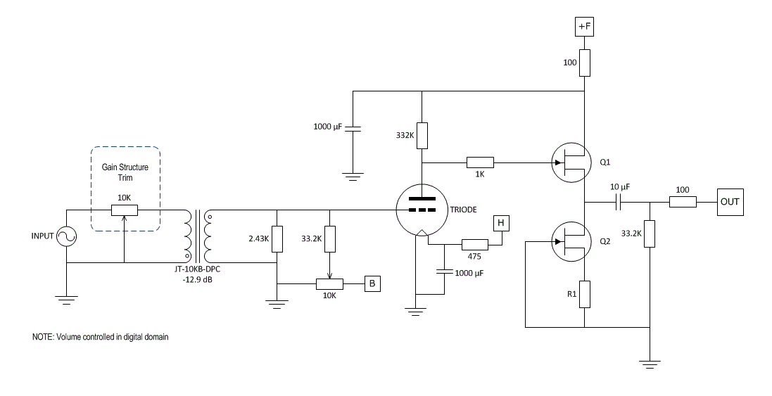

Input line transformer question
If a line input transformer is used for attenuation and phase correction (and side-benefit of galvanic isolation), could it replace the first buffer stage? The Jensen JT-10KB-DPC datasheet shows a output impedance of 225Ω. This seems to be similar to the output impedance of the first buffer stage that I observed in my LTSpice model of the B1K (assuming I'm reading it correctly).
A step-down transformer is specified because I simply don't need that much gain. And the pot ahead of it would be to further "tune" the overall gain structure of the system. Volume control would be in the digital domain (via Apple AirPlay).
I attached a schematic of what I was thinking of. The input buffer is replaced with the Jensen transformer and the first two coupling caps are eliminated. The output stage after the Nutube is unchanged.

signal xformers do not like DC across winding
you can use winding to route DC through it , but you can't place DC across it ( meaning - ends on different potentials)
