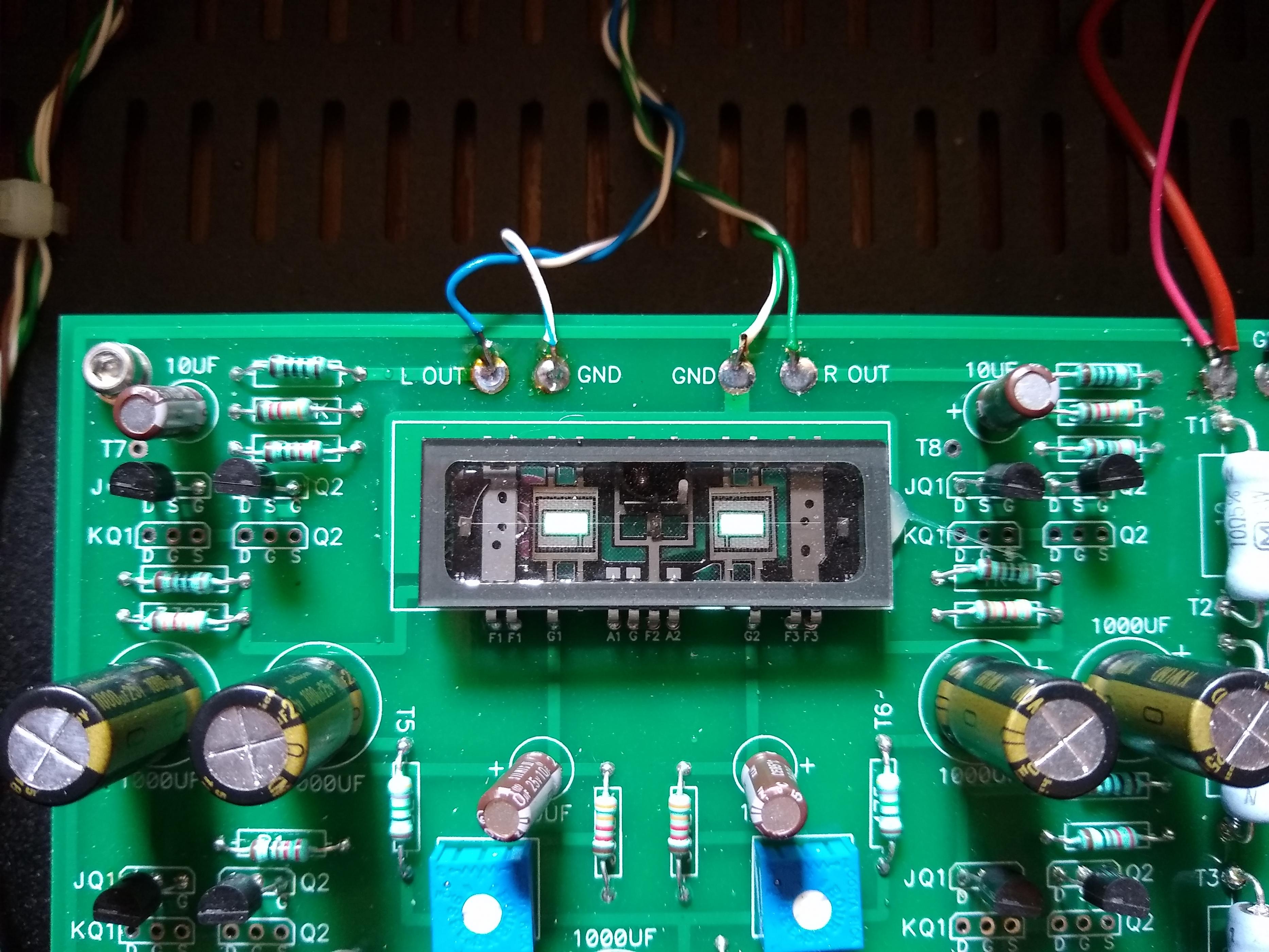

I recently completed my B1 Korg. Basic build.
-T7 and T8 set at about 9.5V
-using Triad power switching supply advised by Nelson Pass

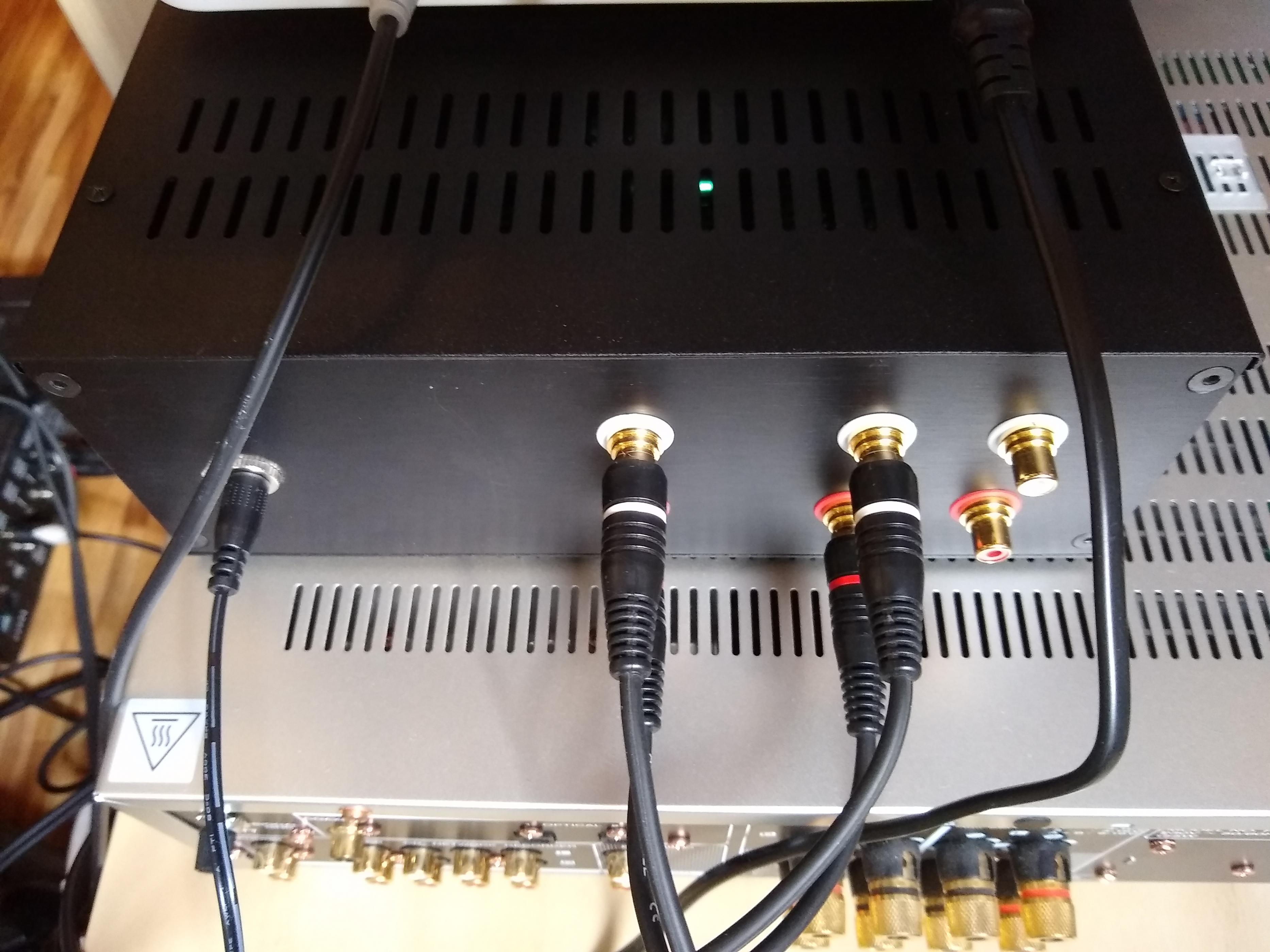

-I only connected one input for the moment (I tried 2 inputs, but it was a pain soldering the toggle selector, and I got hum, probably my fault, will give it another try when I have time)
I did try using the B1 korg as a buffer, bypassing the Alps RK27 100k pot (using my dac volume control), it sound much clearer that way, the Alps volume control takes away some detail.
I did not inverse polarity because I have a small room with bass problems, inverse polarity cancels out some bass making the sound bass lean.
Sounds pretty good on my ACA and M2X.

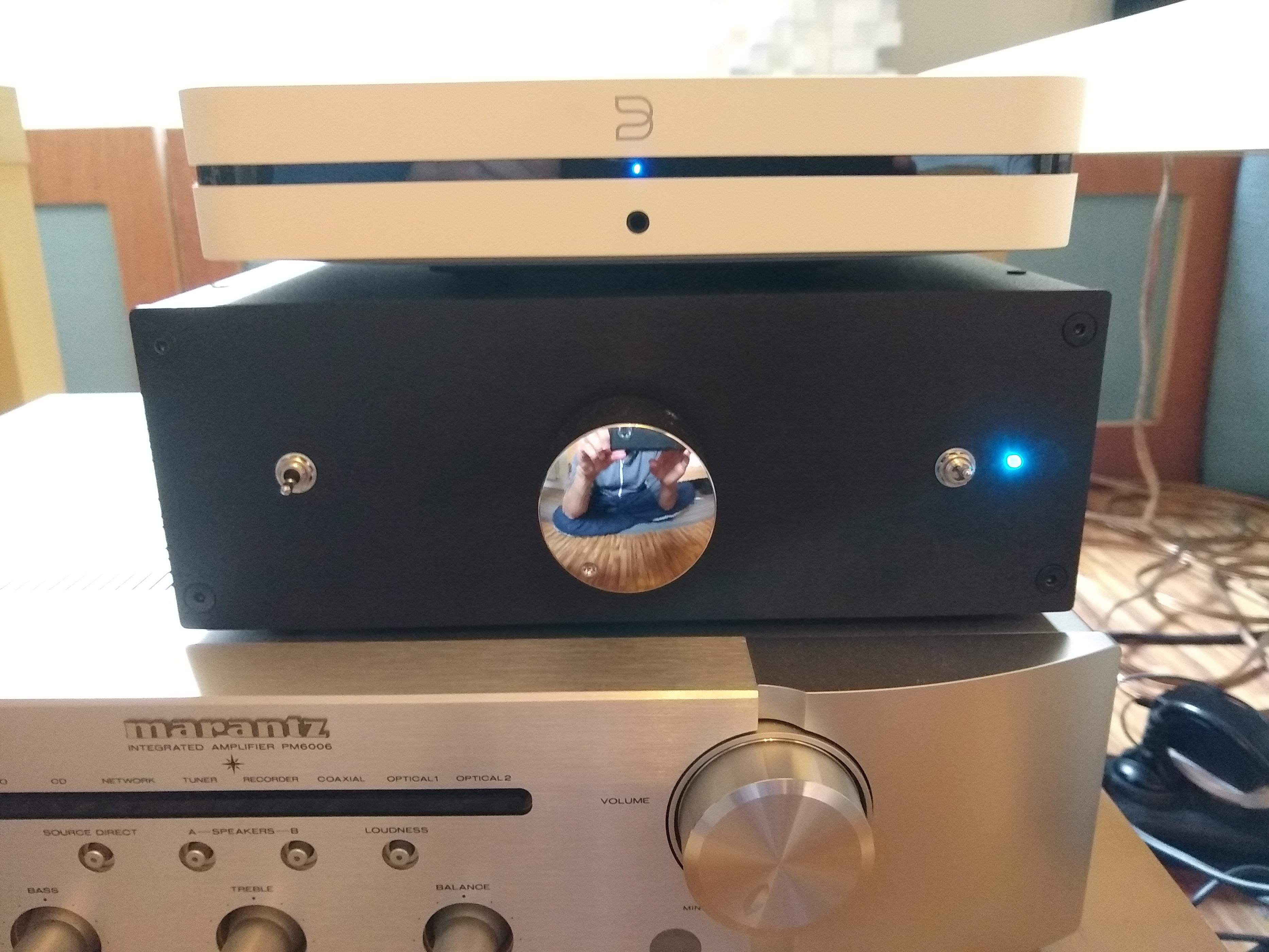

I think the big volume knob is cool, my girlfriend says it looks like a shower faucet...
I will be building the BA3 preamplifier too, always nice to have 2 flavours to switch around.
Thanks Nelson Pass for the design.

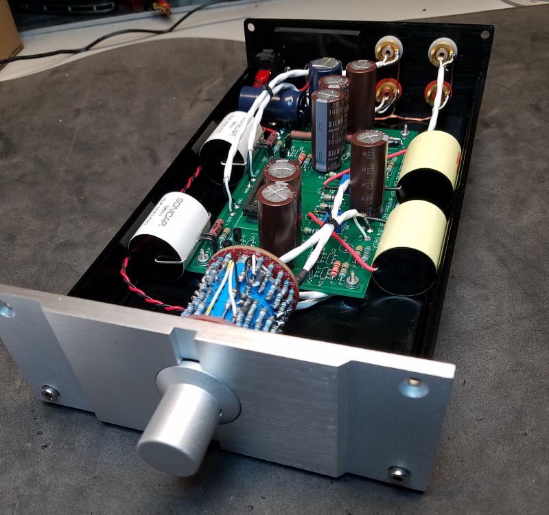

Super secret caps? Why not share with the rest of the class?
Not secret, just don't want to confuse anyone, but because you asked, here are the caps.
NOTE: This is NOT how Nelson's design is spec'd.
Blue caps - Panansonic FC 4700uF
Brown caps - Elna Silmic 1000uF (audio grade)
Yellow caps - Audiocap Theta 2uF
White caps - Gen 1 Sonic Cap 6uF
All Elna by passed with RTE REL-CAP 0.01uf under the board.
