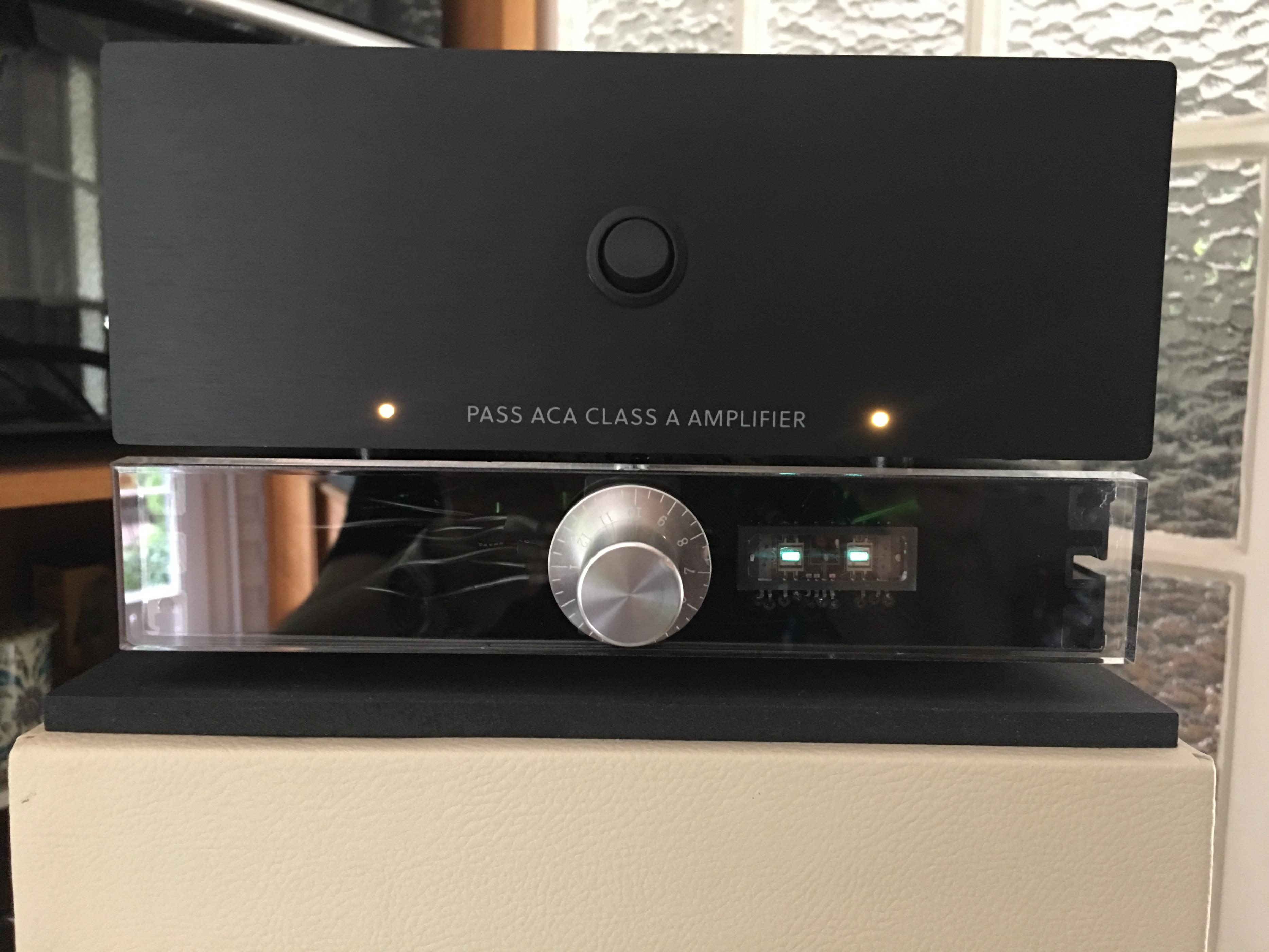

Good afternoon gentlemen,
I just finish to build my Korg Triode preamplifier and it is sounding really great !
See attached picture.
I would like to warmly thank Nelson and Jim ( 6L6) and all of you for your support and help.
I am just feeling a little “sad” to have finished so quickly and need, now, a new DIY project... let’s continue to discover and enjoy audio DIY.
Yours sincerely
TYM

That is very nicely executed! I like the clear front and the ability to see the Korg glowing inside.
I'm also using mine with an ACA. I am amazed at the performance of that combination. Spent a couple of hours in front of it last night in fact. As soon as the Italians return from their month long vacation/shutdown and send me the 4U chassis I have on order, I have an F5 populated and ready to go into it. I'm really looking forward to seeing what that will do to the sound. That was my next DIY project. This is very addicting!
Again, great looking build!

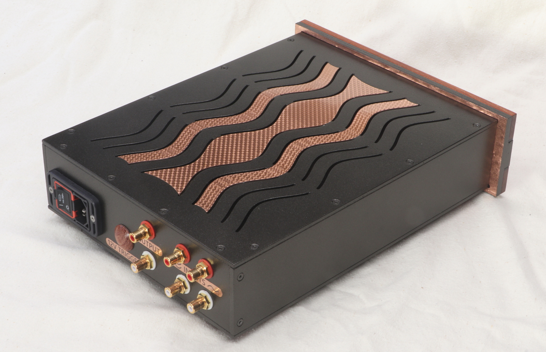

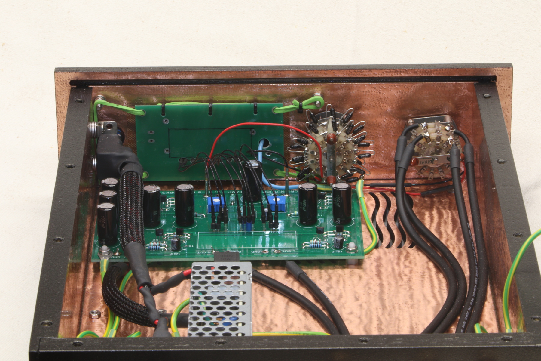

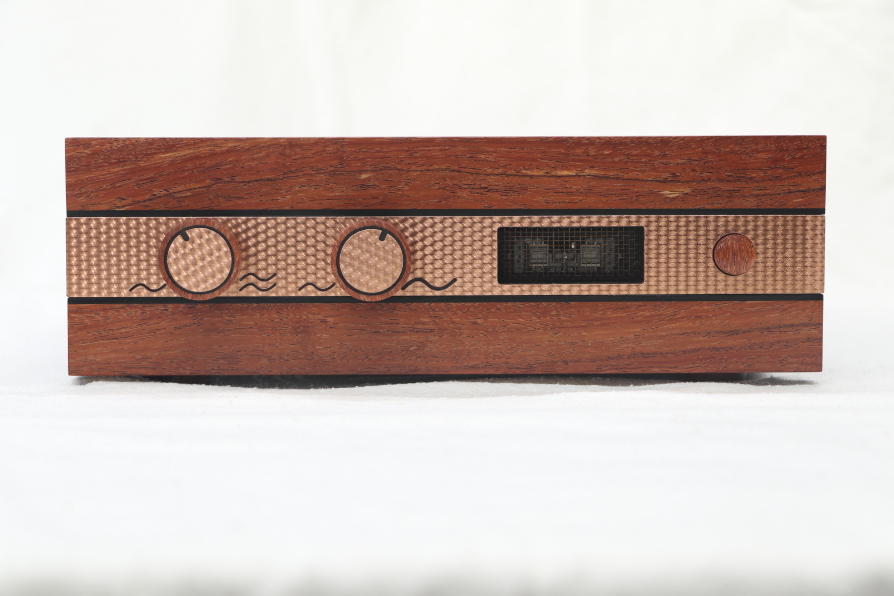

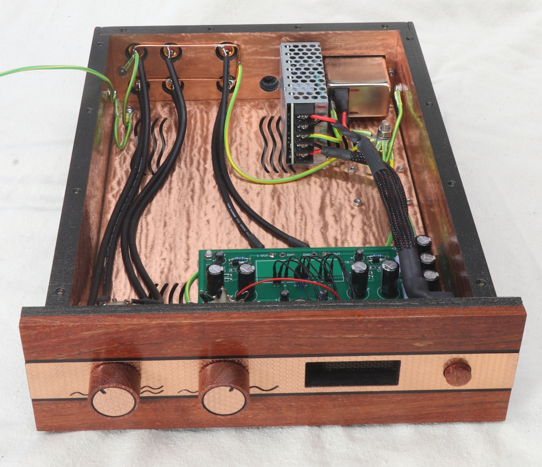

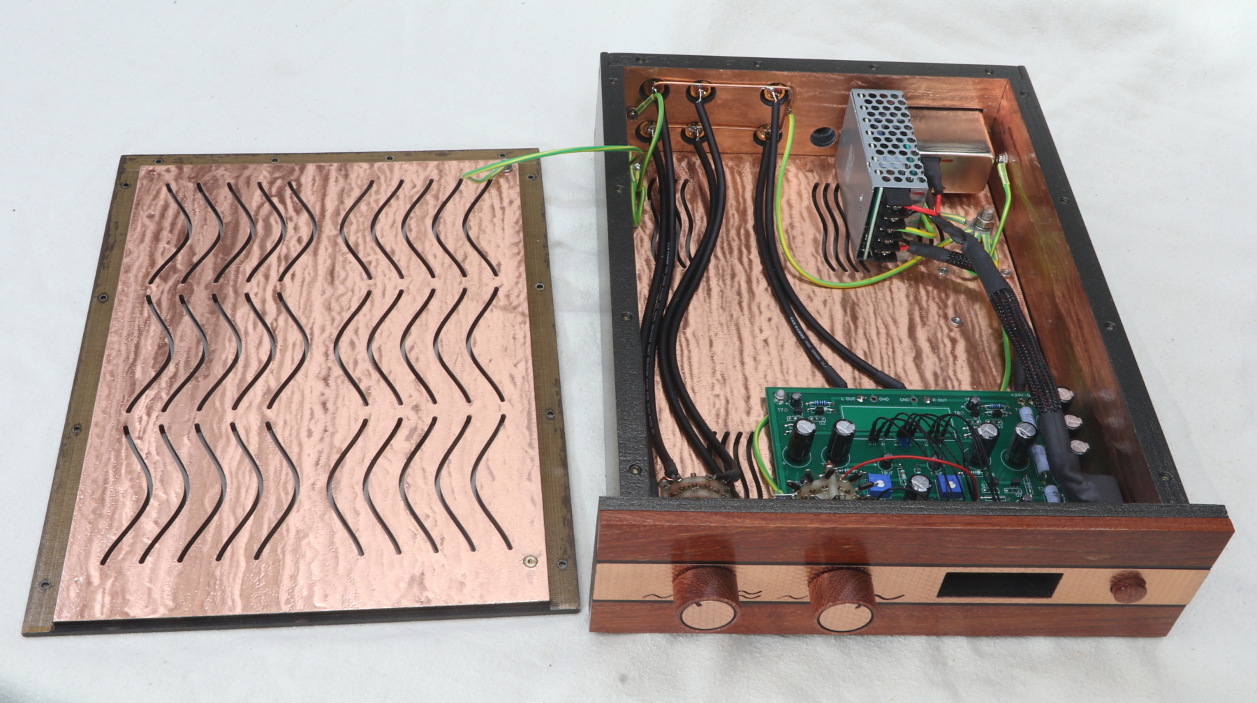

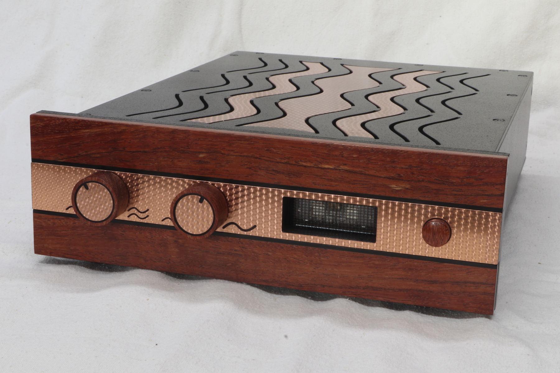

Finally go the job done. I really like the sound, and I'm expecting my son will as well.

That is over the top impressive. Major skills and imagination there. Makes me want to up my game on my wood working.
What Chassis is that you started with? Did it have the vents on top or do you use a router to make those?
The Chassis is made from plywood laminated with fiberglass, obviously the P&F is nonconductive so I have added a thin layer of copper (0.1mm) sheet to the inside surfaces. When I put the internal copper sheet on it looked terrible, so I spent a stupid amount of time applying a pattern to it (patina pehaps) by hand, and then over coated with clear sealer. The exterior has a texture coat sprayed on it which is over sprayed with automotive colour.
A couple of years ago I built myself a CNC router, so it was used for all of the routing, engraving, and the Engine Turning pattern on the exterior copper (0.55mm thick). The CNC router open up a whole world of possibilities.
Once I sort out some other project (they take forever) I will build one for myself.
You have incredible skills. I can tell there are many hours tied up in this build. Kudos to you sir.
