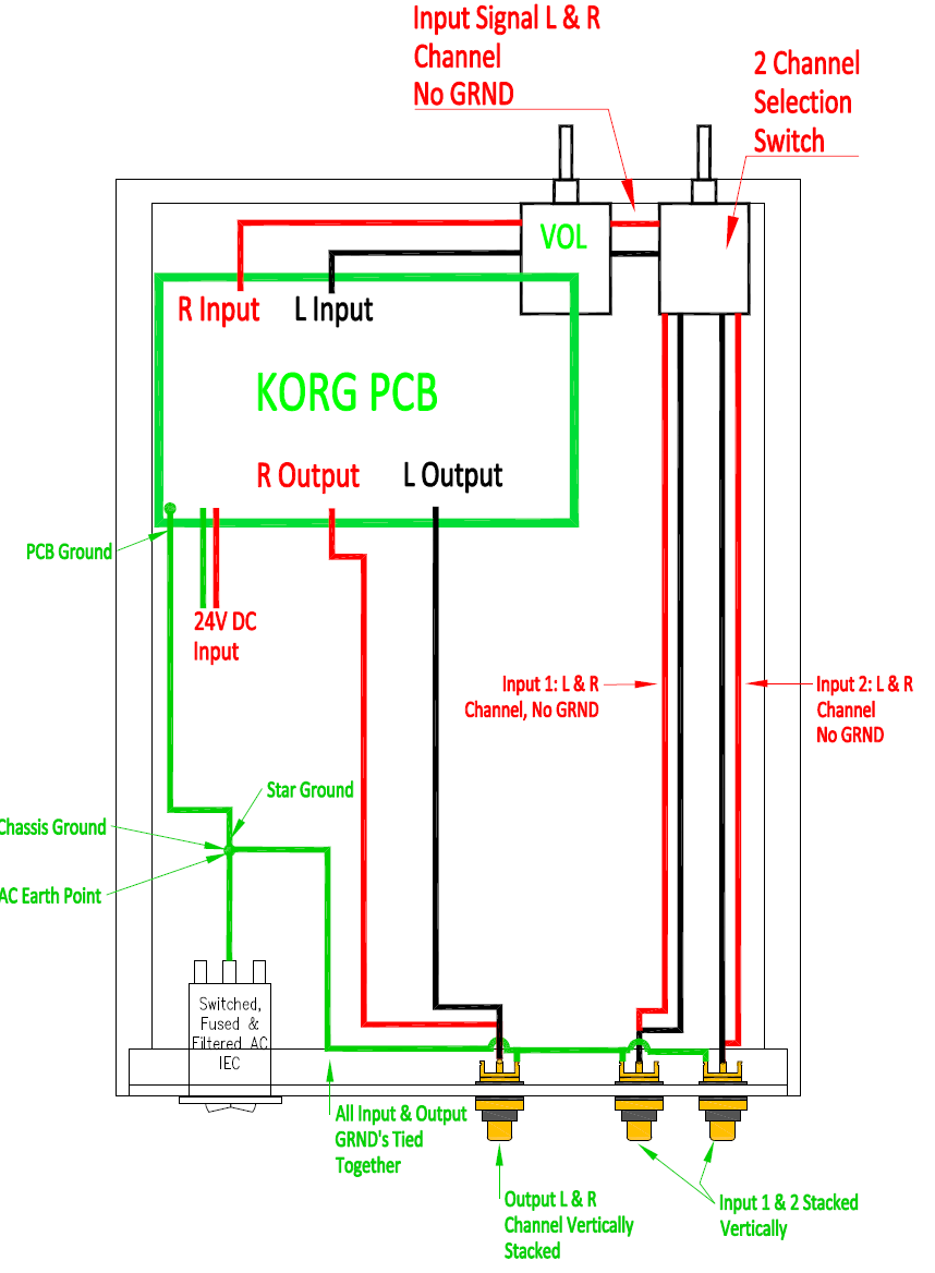

I'm a bit challenged when it comes to grounding and I keep reading contradictory information on the best way to go about it.
My Selection Switch & Volume Control dont have ground inputs and I was hoping to get advice whether the grounding scheme below will work ok?

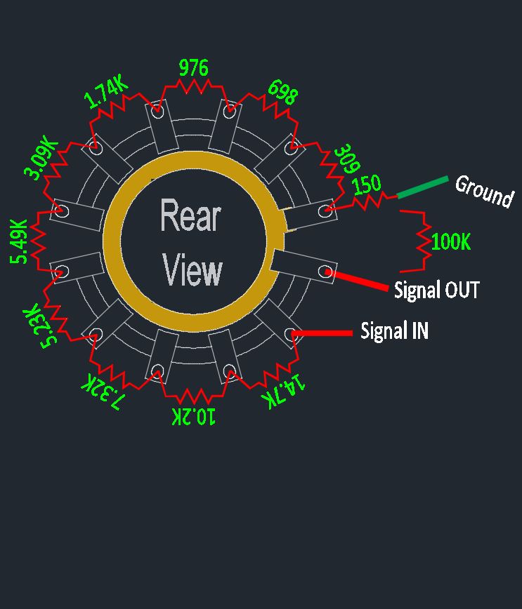

Turns out I'm impedance challenged as well 🙂
Many moons ago I replaced the Alps Blue pots I put in a couple of amps I built with pots made up using Russian NOS 12 position selection switches. I used good quality 0.1 % resistors and it made a world of difference to the sound, I assumed I got the setup right because they worked 🙂
I had 2 switches leftover and decided to use on for the pot in the KORG, most of the volume work will be done by the source, so no need for lots of positions.
I was hoping someone who is not impedance challenged could look at the diagram below to see if there are any fundamental errors in the pot layout.
This is going to sound stupid but I'm not sure what the 100k resistor between the ground and the output is all about. It was in my original design but for love nor money I cant workout what it was doing.
It is common practice to provide some guaranteed connection to ground
after a pot or switch if you are not certain that whatever follows has
one. This prevents possible open input circuits and the noise and offset
that might accompany them.

Looks good to me....
Could you abandon that star grounding method altogether? Meaning, can I just have signal wires directly routed to the ins/outs of board without star grounding everything together like shown in DQ828's schematic? In which case, it would just be the PCB grounding to case and nothing tied together except what occurs within PCB.
DQ828 also shows the potentiometer used as a variable resistor. Choosing between variable resistor and voltage divider... is there any reason for choosing one over the other?
