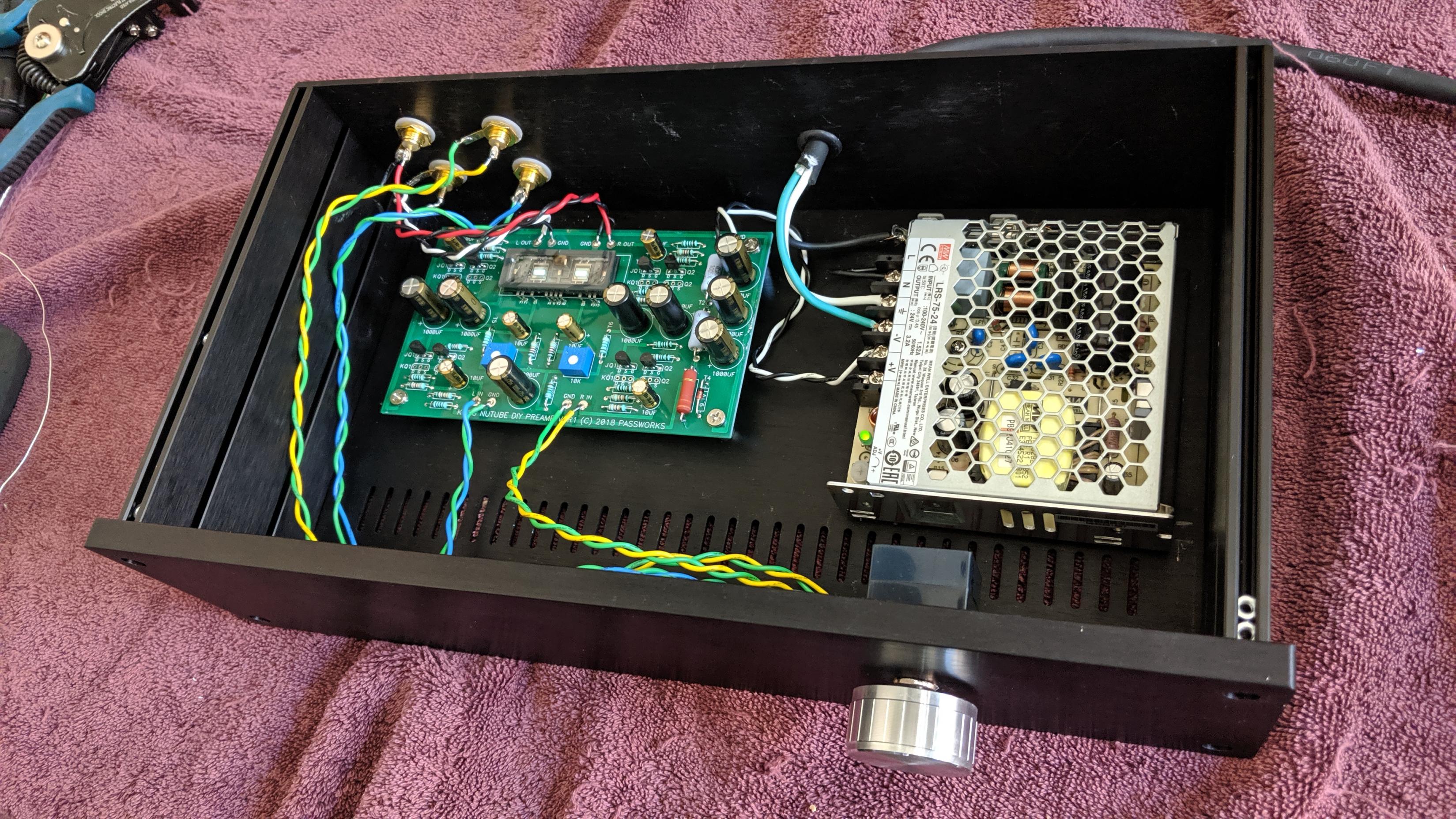

So I completed the "no frills" version of the B1K. All voltages came out within tolerances and I've set the bias at 10V per Mr. P's recommendations. I used a laptop with Roon, and an iFI Black DAC to feed it. I let it push my ACA to my Tekton Ulfberht speakers. I was shocked at how good it all sounded. The ACA had NO problem pushing my 100+ dB efficient Tektons using the gain from the Korg. Even the low end was present and accounted for with no sub connected. With 5 watts? Really? Thanks Mr. Pass. This is just awesome.
At this point I haven't even installed an off-on switch. But now I'm going to circle back with some additions and upgrades AFTER I finish the F5 build I have going because I'm very interested in how this will sound going from the ACA to the F5.
My wife loves my audio hobby and often listens. But she is also my most critical listener. She has bat hearing too. She was amazed with what she heard from the first song. That just never happens. Well anyway, below is my version of the B1K base version. Now on to the F5. Hope my beginners luck holds for a while.

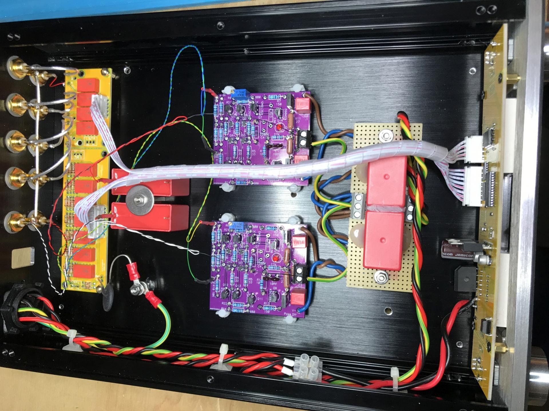

... a few weeks ago I asked advice on it mounting it in a case with a remote 128 step vol, see
Volume Remote Control Relay 128 Steps Exponential Constant input impedance 4 CH | eBay
... but as I turned up the vol on the 128 step pre, I got a increase of hum at 3 intervals 60, 96, 115 then when I got to 127/128 the hum reduced to the level of the 96 vol range.
If anyone has an idea about what could be causing the different sages of hum increase I would appreciate it. My next thought was to mount the Korg in a separate box with short RCA connecting the units.
I have built two preamps so far using this case / "passive preamp", one an Aikido, the other Wayne's BA 2018 linestage.
Initially, in at least one of them I had hum issues as well. The fix I did was as follows: If you look at the relay board in the back of the unit, the left part of the board with the seven relays is the volume attenuator. At the front left of this board are two eyelets in the board, named "case" and "aground" respectively. (as you can see in the photos on the eBay auction).
I don't remember exactly if the relay board had been grounded to the case via the mounting screws, but with no audio cables connected, there should not be an electric connection between these two points and the case. You can check with an Ohm meter. If necessary, you might have to isolate some of the standoffs from the board.
Then, I connected the eyelet "aground" through a CL-60 to the case, but you can use a 10R - 100R resistor for this as well. The case itself is grounded / connected to PE / earth ground.
That gives a defined path between audio ground and earth ground / case without the risk of a ground loop.
This cured the hum completely for me.
Hope this helps, otherwise we will look into it in more detail. Since I have gotten two different units completely hum-free, the odds are good ... 🙂
Best regards, Claas

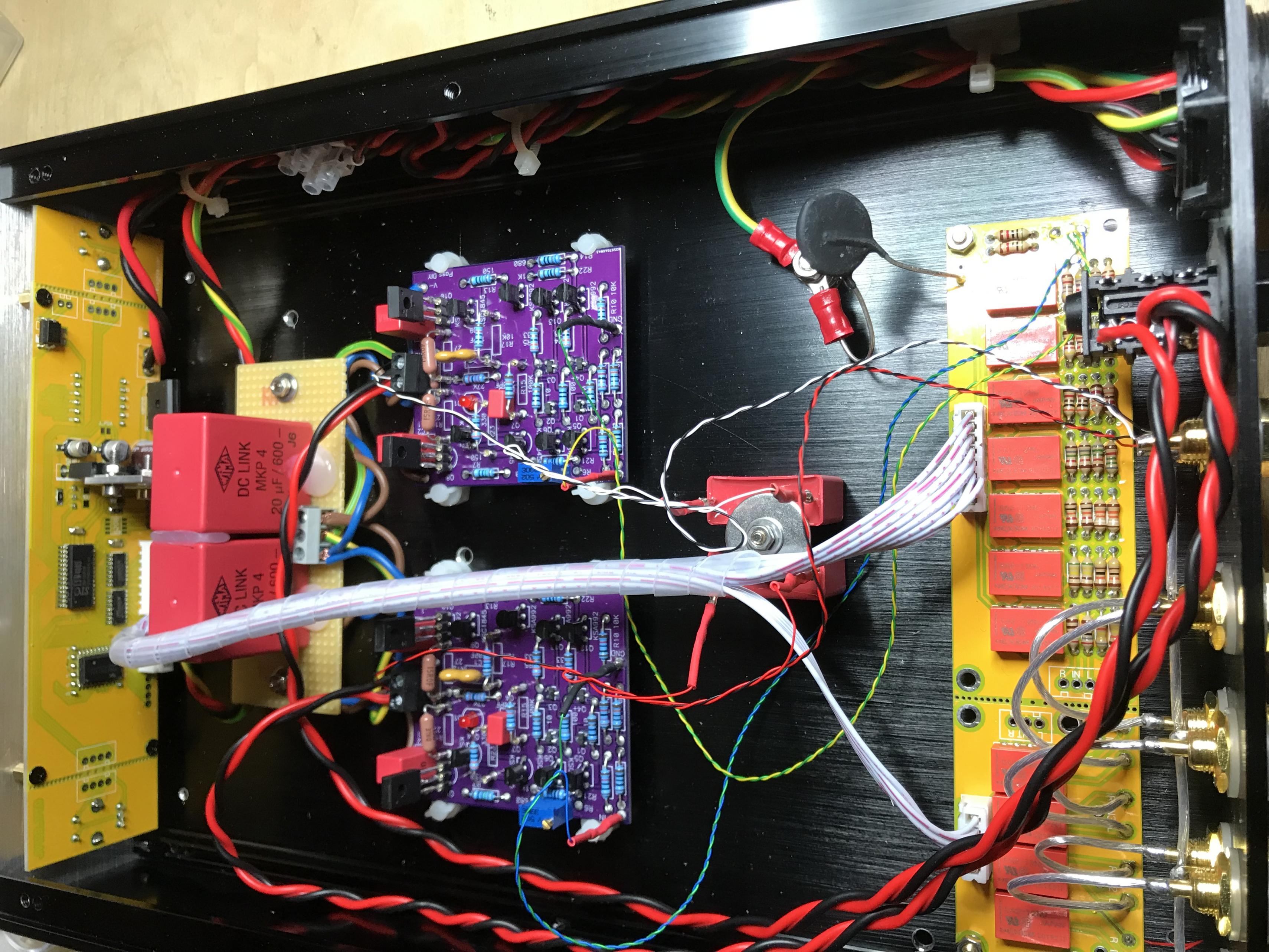

I am at home again and have attached two pictures of my Wayne's BA 2018 linestage build that uses this chassis. You can see the connection from "Aground" (or "A gnd", don't remember what it was named) to the case via a CL-60 (a 10R-100R resistor would work as well).
Don't remember if the board itself had a connection to the case via the standoffs, but in any case, I didn't change that.
Because I use an external PSU, I brought in PE / house earth on one of the wires in the umbilical to connect the case to PE. This in the end grounds the audio ground "Aground".
It also provides a proper safety ground to the case (which was more important with my Aikido build, because that's running 250-300V DC as B+ 😀)

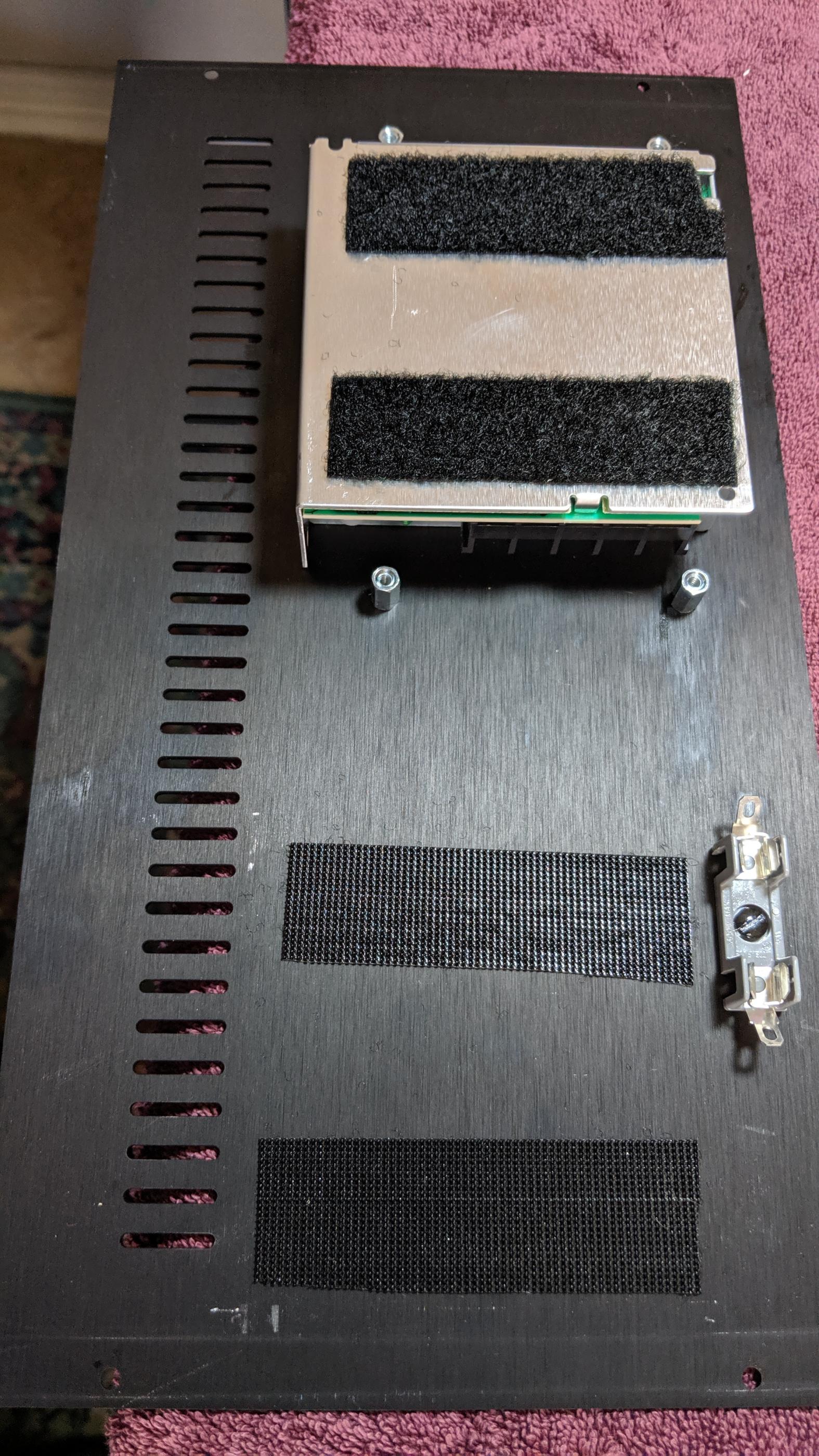

I’m curious if both sides of the Velcro would work even better at vibration reduction... wouldn’t need a big piece, maybe 10x10mm at the biggest. Attach the glue sides to the NuTube and the PCB. Hmmmm... it’s intriguing, I should try it.
Does this qualify me as a "contributor" now?
You folks are in big trouble now.

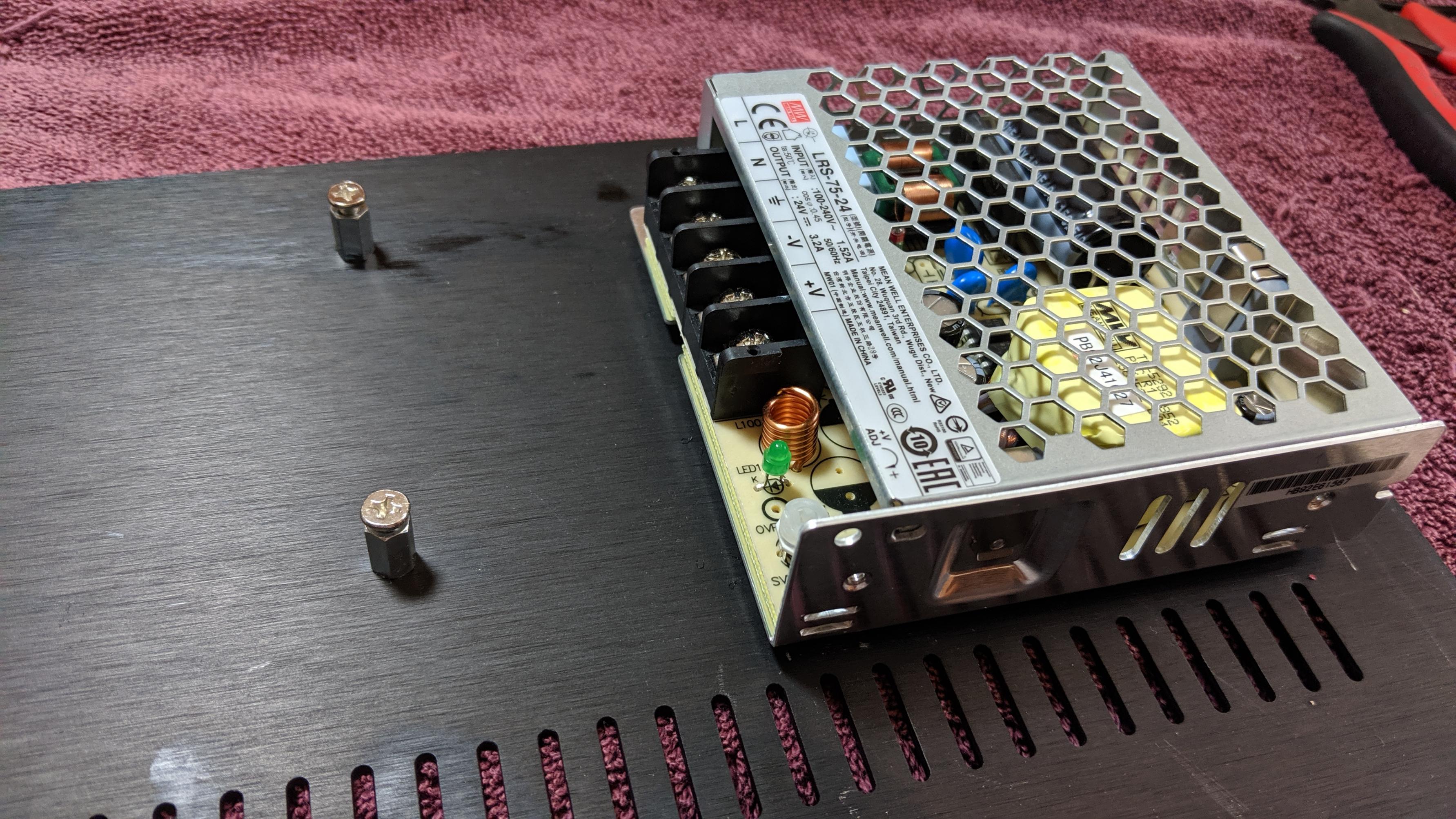

The other thing I did is to use spacers that are leftover from mounting computer motherboards over the years. I have a bag full of those. They are 6-32 so easy to drill/tap them into the bottom plate.

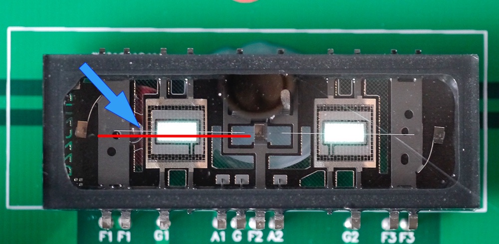

While trying to fix my volume pot, I think I accidentally shorted the pins of the NuTube and it doesnt light up anymore, how can I test to see if it's still good?
T7 and T8 are measuring ~21V whereas T5 and 6 are ~10V2.
Sob, it is not. So it's the end? Sounds like I am the first to blow the fuse. Lol.Is the fuse string intact? Above red line.
Been there done that, bought the T-shirt. 🙂 I replaced the Nutube.
Lol, thanks for sharing. I will be the second to blow the fuse then. ;-)
