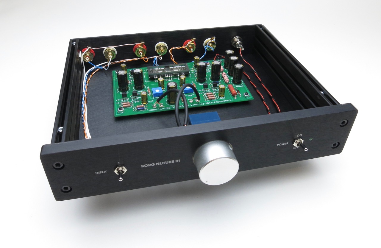

Is this the chassis?
Will it be on some page other than the full kit page? I don't see a place for it under the chassis section.

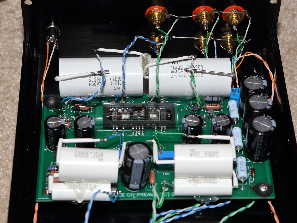

Just finished up the cap replacement in my B1 Korg. I used the film caps that Claude suggested (thank you). While I was at it, I added in the rubber vibration isolation mounts that I picked up on ebay (these are linked in one of my posts above). The rubber mounts reduced the magnitude of Nutube ringing by 15-20dB when I adjust the stepped attenuator. Not gone, but clearly better.
It took a little while to figure out how to arrange the caps so I'd still have access to the trim pots and the Nutube. I used hot glue to hold them in place on the board - it seems to have worked well. Just put it all back together, so I haven't had time to sit and listen yet.
With the new cap values (0.22uF, 1.0uF, and 3.3uF instead of 10uF all around) the -3dB points are about 10Hz and about 65kHz. At 20Hz, response is down just a small fraction of a dB. Since my main speakers (FHLXs) don't really "do" the 20Hz thing, this is a difference I'll never notice.
Looking forward to some time to listen in the coming days!

While I was playing around, I also adjusted each channel for a combination of highest H2 with lowest H3. I was surprised by the difference in T7/T8 voltage settings to make this happen. I ended up with 9.8v on the right channel (pretty close to the recommended 9.5v), but it took 10.2v on the left channel to come closest to matching it. With a 1kHz signal and an overall output level of about -10dB (trying not to overwhelm the sound card) I was able to directly match H2 magnitude (at -47dB), but the H3 levels were still rather different. H3 measured -78dB in the left channel and about -97dB in the right channel. I was unable to get the left channel H3 any lower. Guess the individual tubes have a bit of variation to them...
