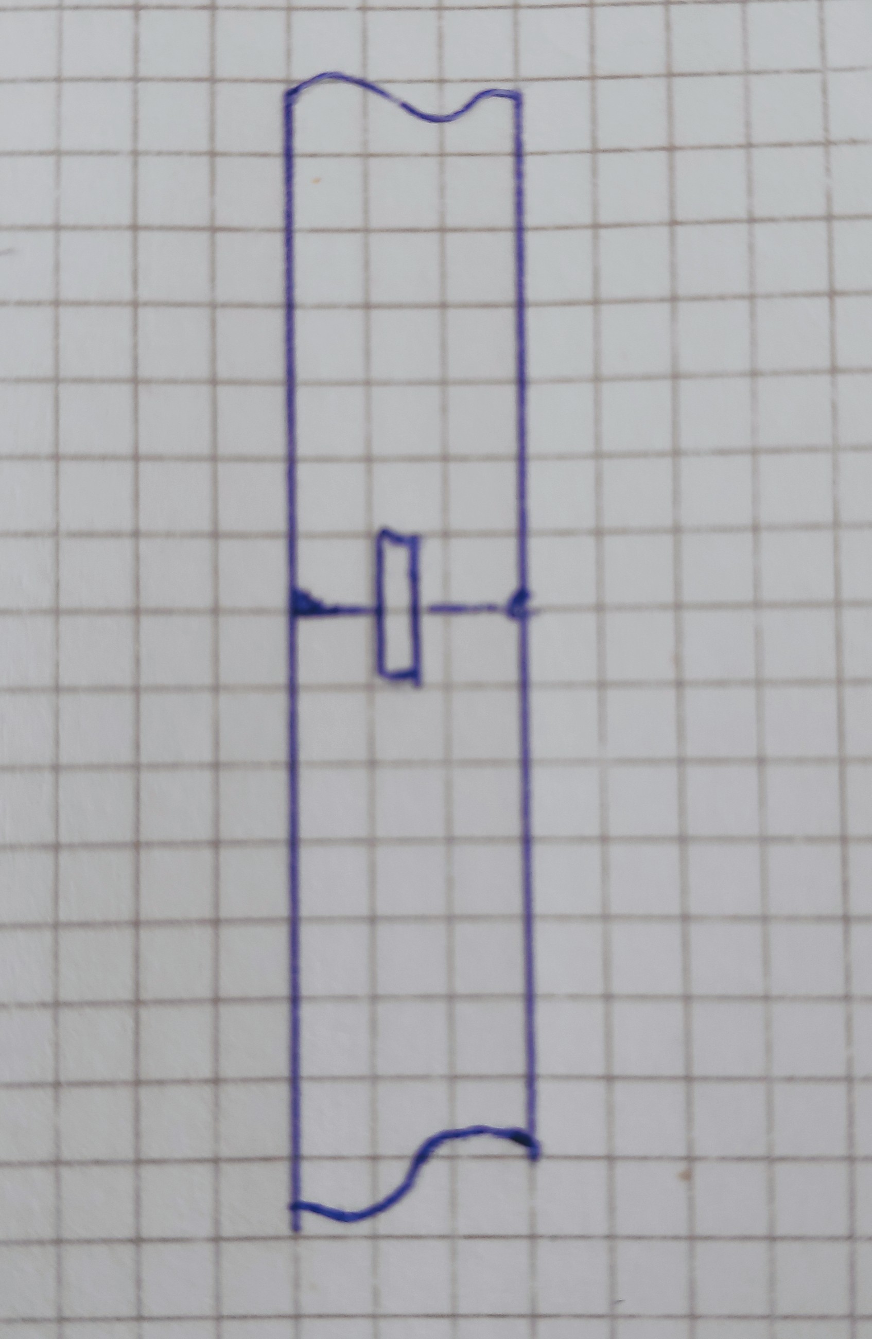

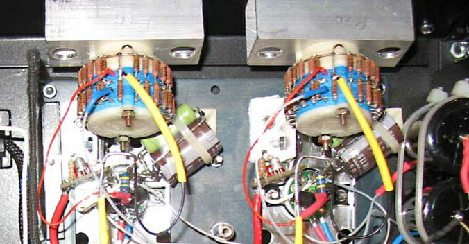

A while back I did something like this in pictures. Aluminum square rod drilled to couple front panel and pot. Pot extended with 6mm rod glued with epoxy and secured with flat metal in slot...
I guess pictures explain.

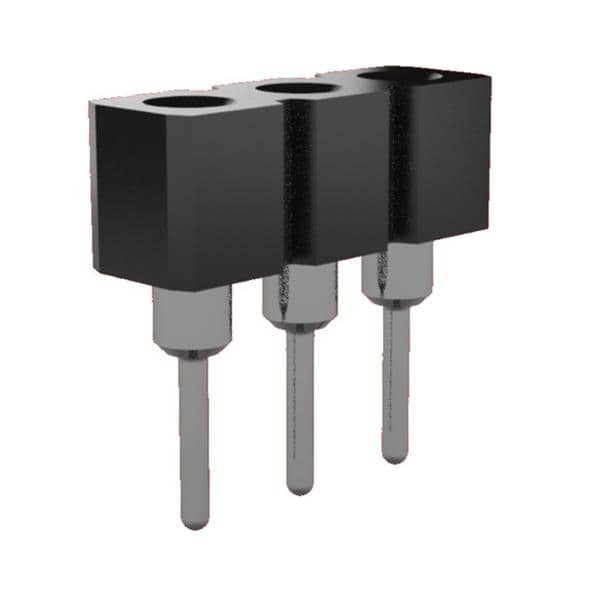

Any thoughts on using socket strip for jfet installation ? It would make trouble shooting that involves moving, replacing jfets easier. But would it compromise performance or reliability ?
Works just fine IMHO.
I use this arrangement in my stripboard Pearl Phono for all the JFets and BP semis in it.
One has to remember that Revox had a similar approach in some of their decks.
Go ahead and don't worry too much.

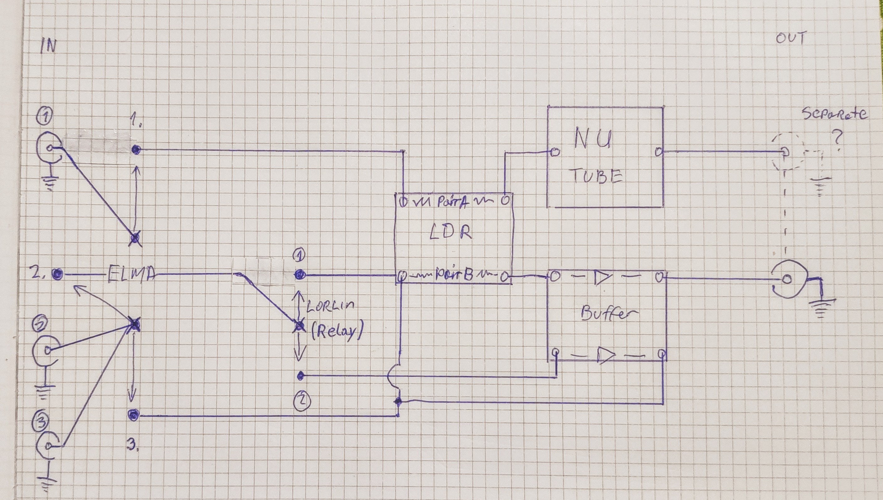

Dear audio frends, I’m planning on putting Nutube in box with my good old PSMLS with buffer. For those not familiar with it, it’s Poor Serbian Man Light Speed, aka LDR optocoupler based attenuator. I had it running in balance mod that I no longer need. That means I have 4 signal lines in both Elma selector, LDR and buffer. It gives me a ton possibilities to wire in normal RCA mode. I have done some drawings by hand since I’m on vacation and have no computer at hand. I came with pretty complicated wiring idea and would be delighted if someone knowledgeable had a look at it if there are some flaws and possibly problems.
1. Input> LDR pair a)> NUtube> RCA out (probably dedicated)
2. Input> Lolrlin a) >LDR pair b)> Buffer pair b)> RCA out // Lorlin b)> Buffer pair a)> LDR pair b)> Buffer pair b)> RCA out
3. Input >LDR pair b)> Buffer pair b)> RCA out

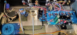

Here’s schematic and pic of current buffer and LDR attenuator that would be rearranged.
both NuTube and PSMLS Buffer are having high Rin , so you can use standard selector - attenuator (LDR) arrangement , then feeding both Nu and PSMLS Buffer (practically inputs in parallel ) , then taking each output separately , using whichever you want whenever you want
