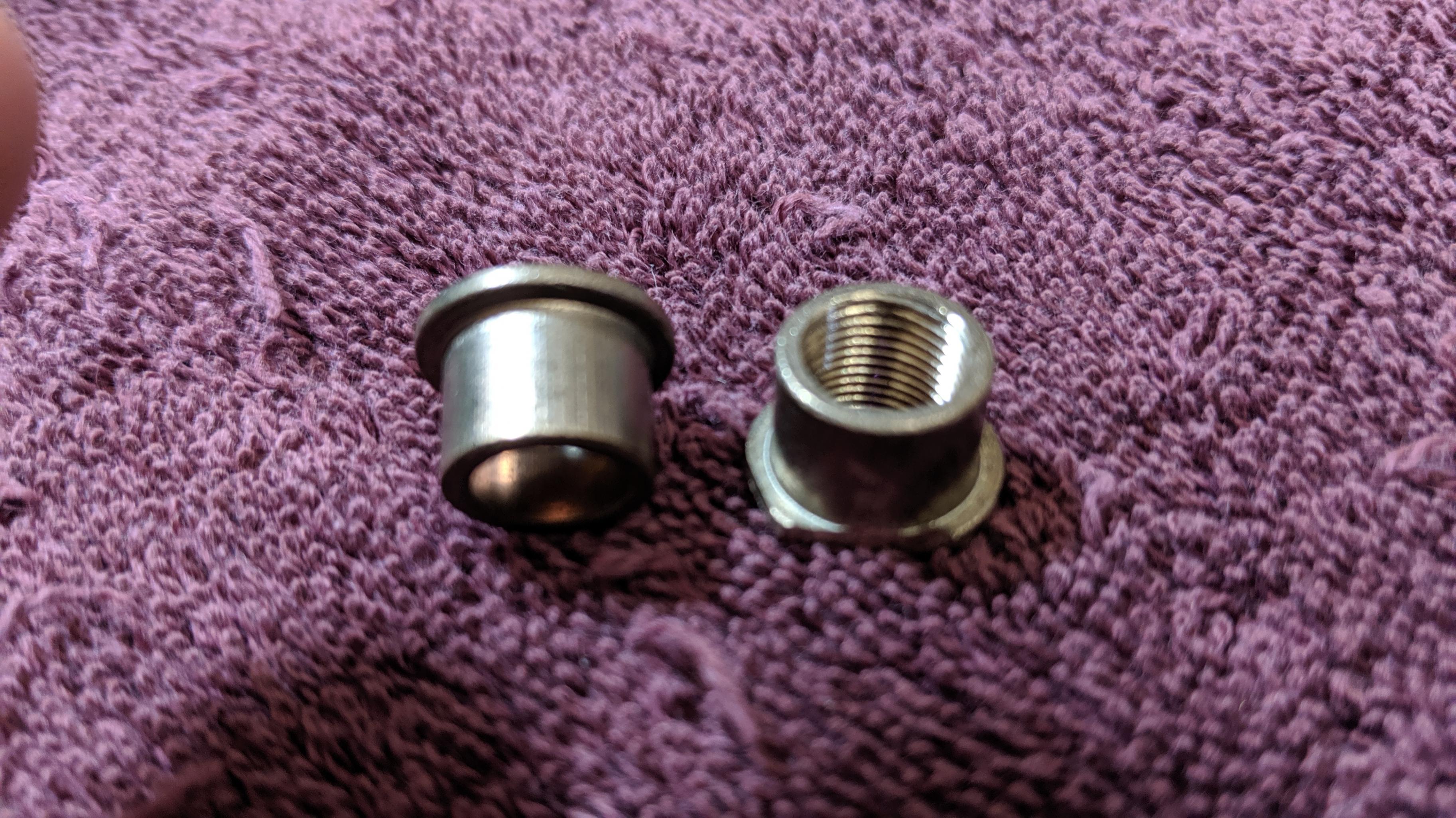

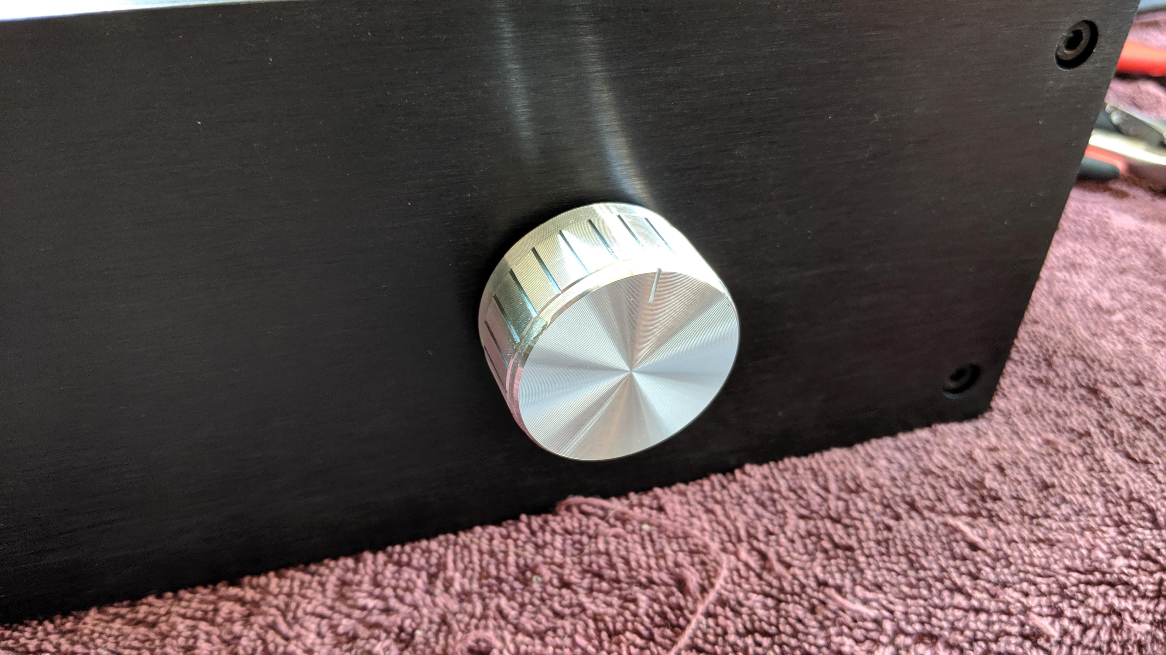

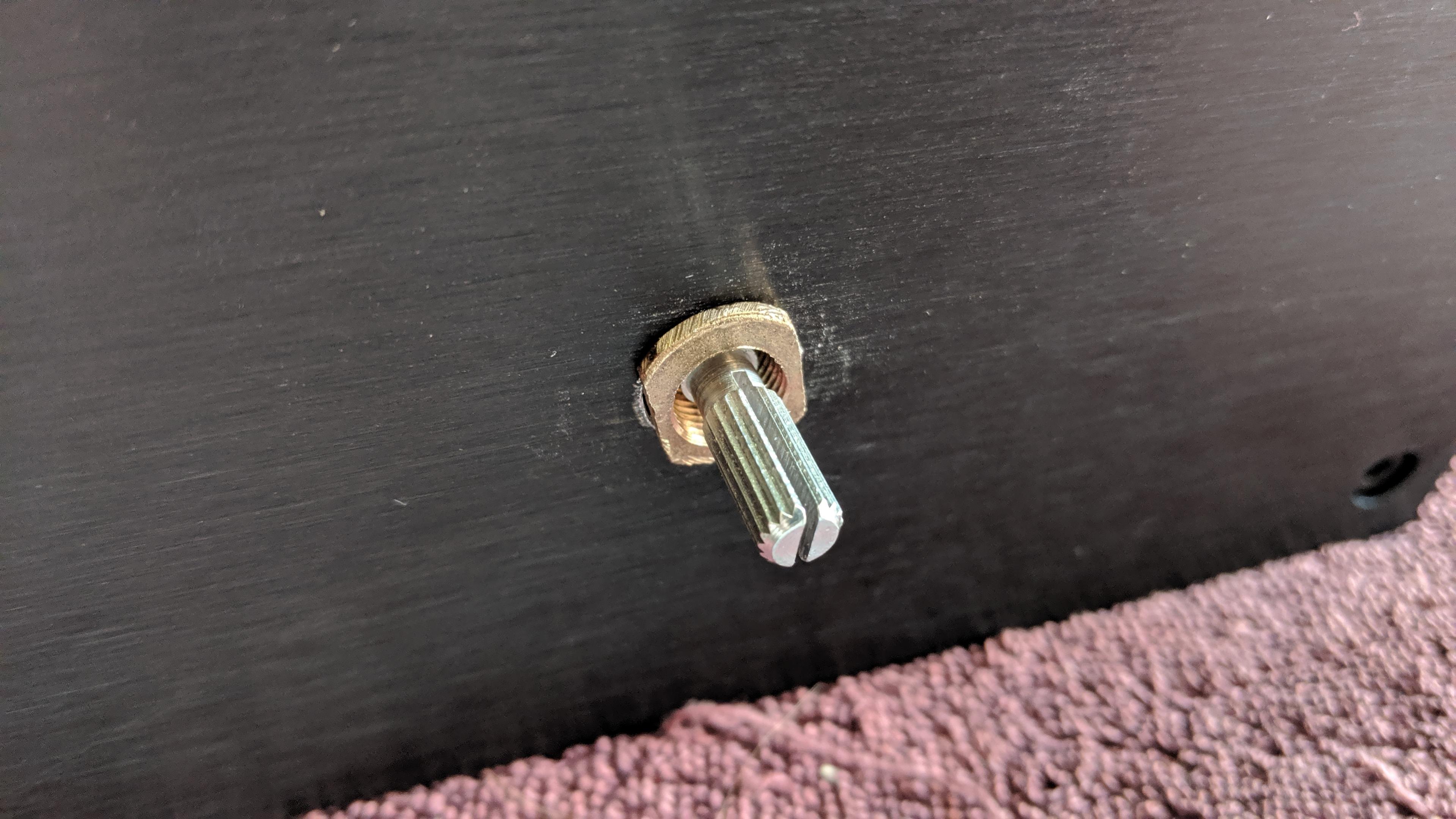

So here is my Alps Pot mounting solution. I bought a bronze bearing off Amazon with a hole slightly smaller than the 9mm diameter of the Alps. I also bought a 9mm x .27 tap. I put flats on the bearing flange to hold it while tapping and also to tighten it later. I tapped it for the Pot shaft. I then made the hole in the faceplate slightly larger than the OD of the bearing shank. Put the Pot through the hole and screwed the flange screw in from the outside. Works very well.
Congrats on working through the issue and coming up with a great solution.

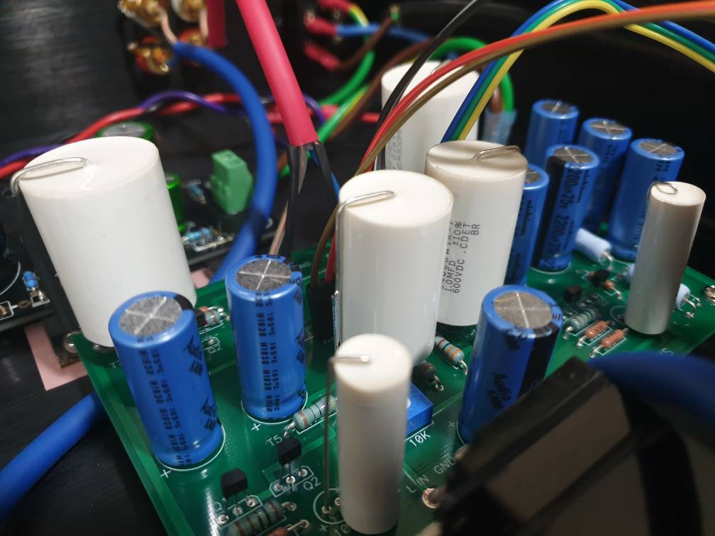

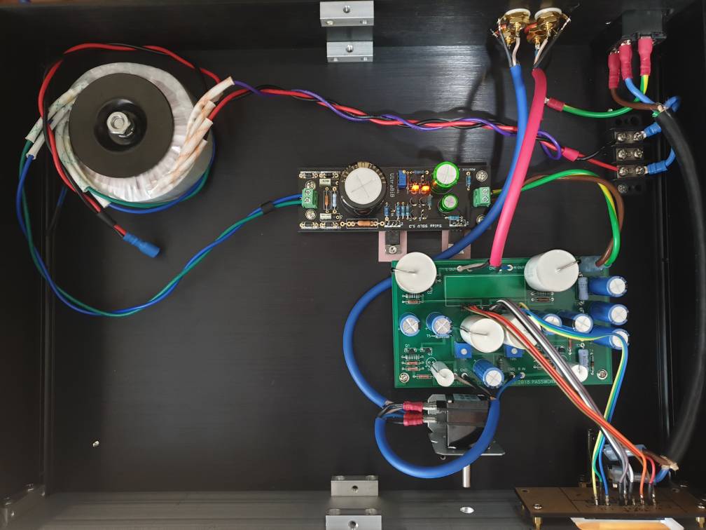

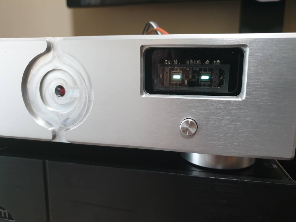

Finally finished putting together the B1 Korg in a nice chassis, combining what Claude and Dirk recommended. Thanks guys. No real listening yet as I am missing the knob for the pot as the extension coupler is still on the way. Thanks to Papa for his gift too!View attachment 772552View attachment 772553View attachment 772554
Beautiful job! 🙂
I would only move the board as close as possible to front to have shorter leads to NUtube....

Very nice build dewdrop! I like the design of your frontplate.
Very nice soundmachine!

That's true, I used the stock cables which come with the connectors.Beautiful job! 🙂
Thanks Dirk! I bought it ready made.Very nice build dewdrop! I like the design of your frontplate.
Greets
Dirk![]()
