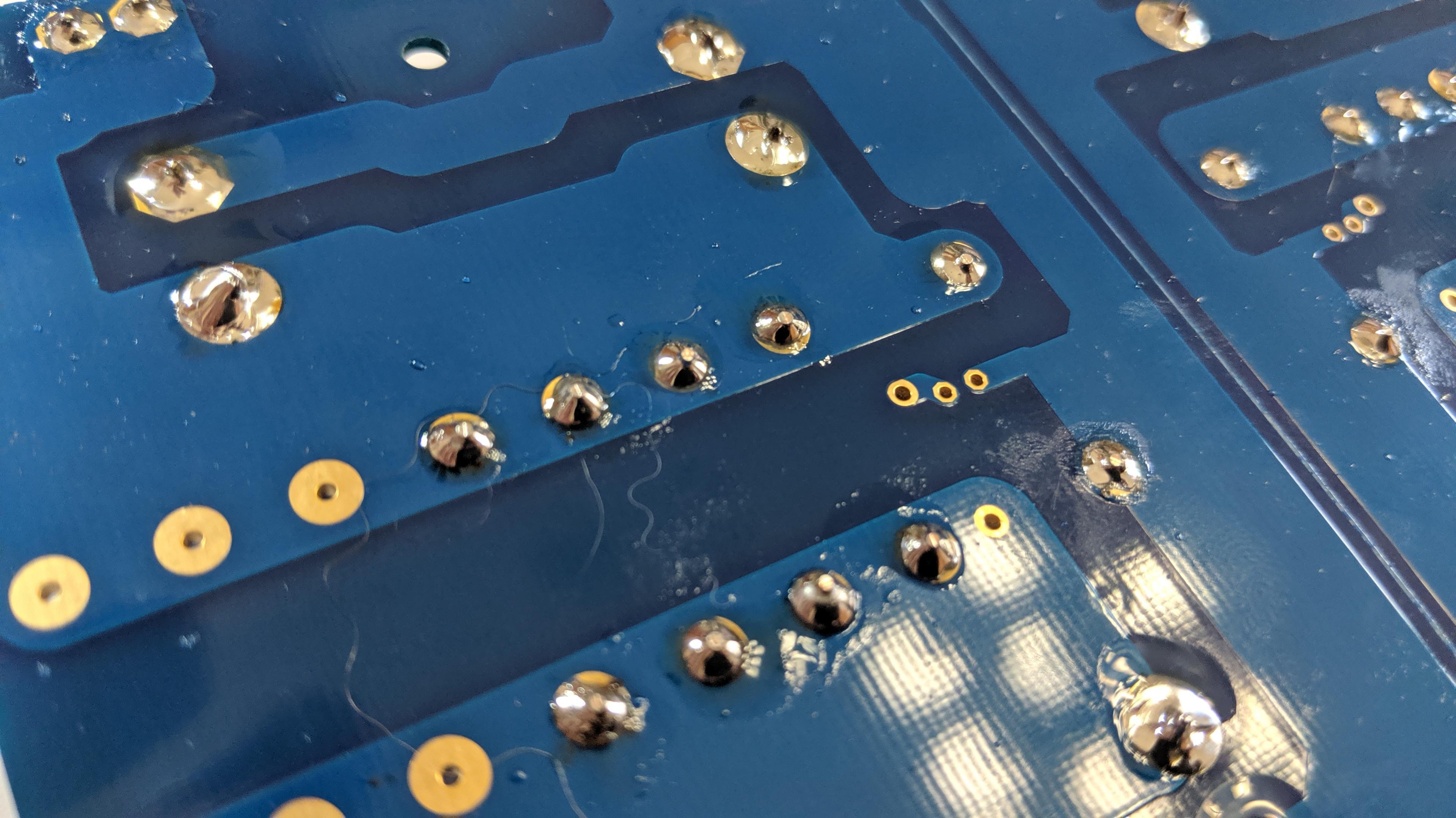

I would also like to be sure the solder joints are looking like they are suppose to. So far everything I've done works, but thought I'd at least have the experts comment. I am using Kester 44 solder recommended in the "Solder 101" article.

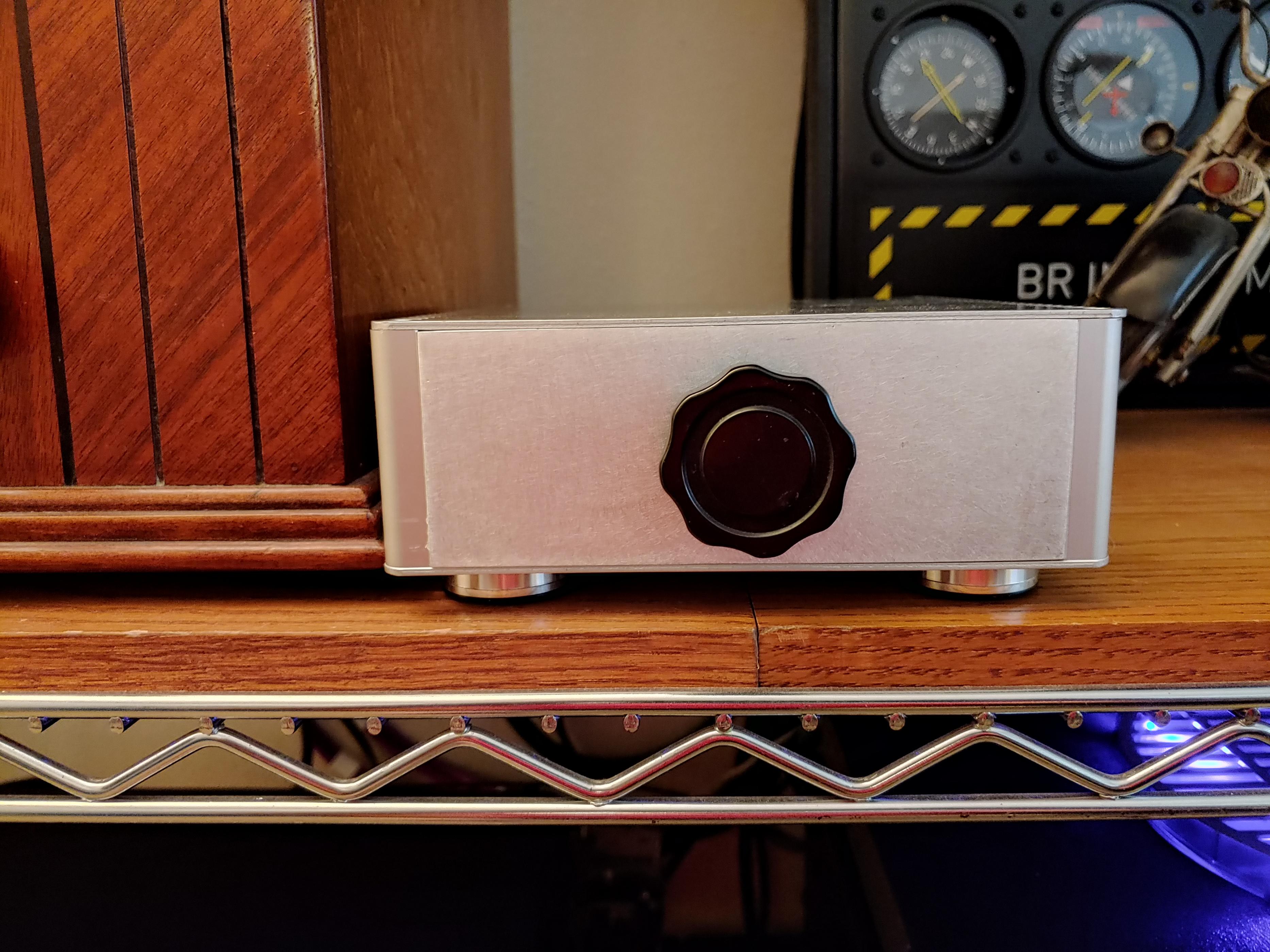

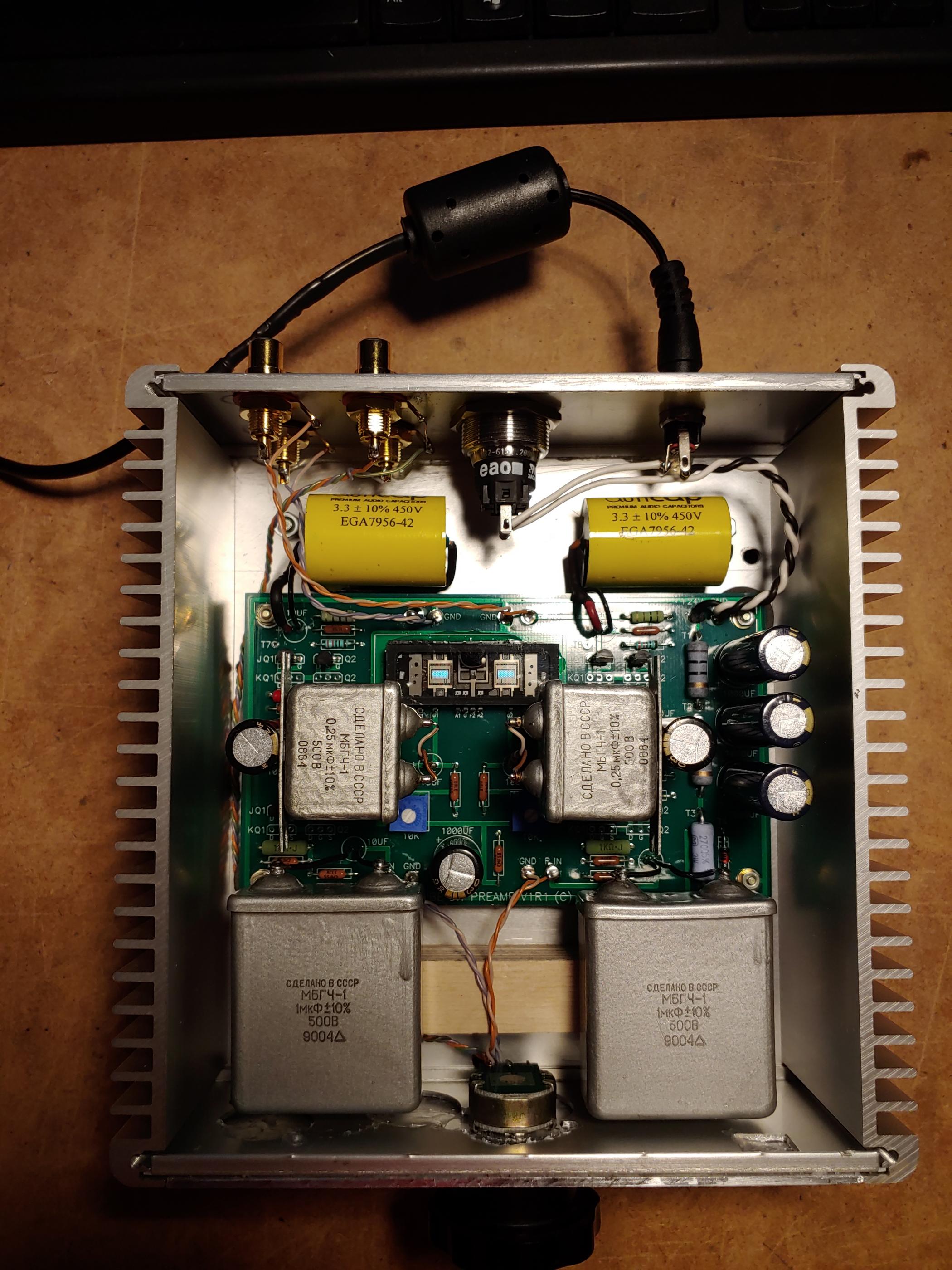

I decided to make this project using as many of the components and parts that I already had as I could. I am glad that I didn't toss the enclosure that was from a dead DAC.
I did the "stuff a fat lady into a girdle" thing and was able to get those ridiculous, large caps glued into place without fouling anything.
I placed a sheet of Sorbothane beneath the Nutube and also beneath the board, on top of some washers on the stand-offs. The top and bottom of the case also have sheets of Deflex. Tapping the enclosure stoutly with my finger does nothing.
All the volts are within spec, and I am getting used to it now. I look forward to comparing it to my current preamp, which is an AKSA-Lender that I am very happy with.
