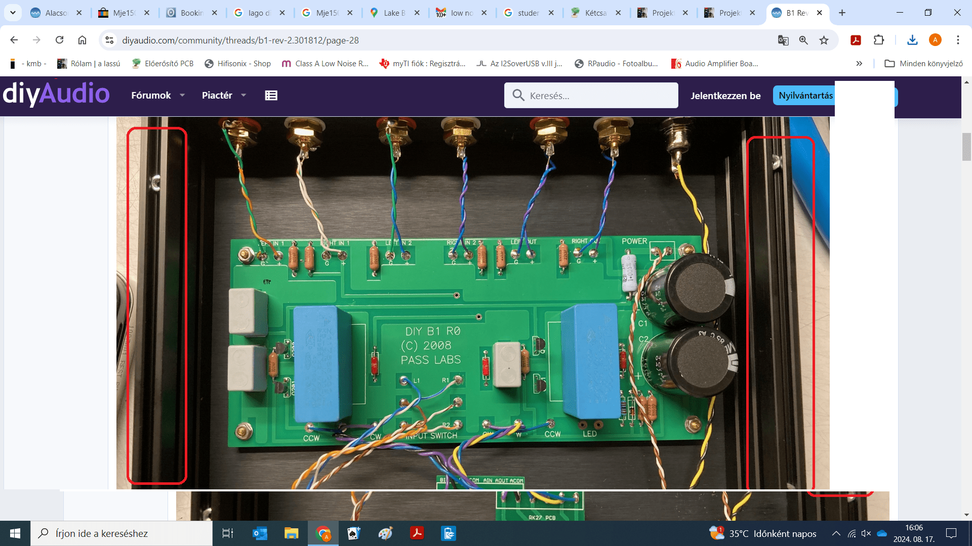

Sidepanel 170mm or 230mm or 280mm? 2U?

Hi Walter
Thanks for the answer.
I know the Modushop store.
Unfortunately, I need different lengths and heights. That's why I'm looking for an aluminum profile manufacturer or dealer like ALU-KÖNIG-stahl.
But they don't have such a profile.
I think you really need to dig deep to find the one cure for your problem. I would contact Zen Mod. He can make anything. But, when you contact him, always call him «Your Grace», «The holy one» or «Prince of Bač». Only then will he - perhaps - help you extrude your wishes.
Pogany:
I don’t understand. modushop sells those side panels separately. Are you saying you need lengths and heights that modushop doesn’t offer?
Scott
Different heights and lengths are required.
I asked for a full catalog but he doesn't answer.
Worry about the shipping cost from Italy to Hungary.
If I can't find a solution, I will make it on my own machine from an aluminum sheet
They have vacation now, or a week or to more. Gianluca is fast, but not during the vacation. You can reach him by bm «gianluca».
Shipping cost won’t be a real issue. (Innereuropean tariffs probably are better than 🇮🇹-🇨🇭
AFAIK, the heights are fix since it’s extruded profiles and the geometry/cross-section has a „rhythm“.
But this is pure guessing, I am just a small customer, liking modushop‘s products.
I have answered your email yesterday but it was not not very clear. We can also customize our side panels to have custom dimensions but it will take a bit longer to produce them and they will be more expensive than our standard ones.Different heights and lengths are required.
Shipping costs should not be higher than 12 EUR if you don't need a lot of panels
