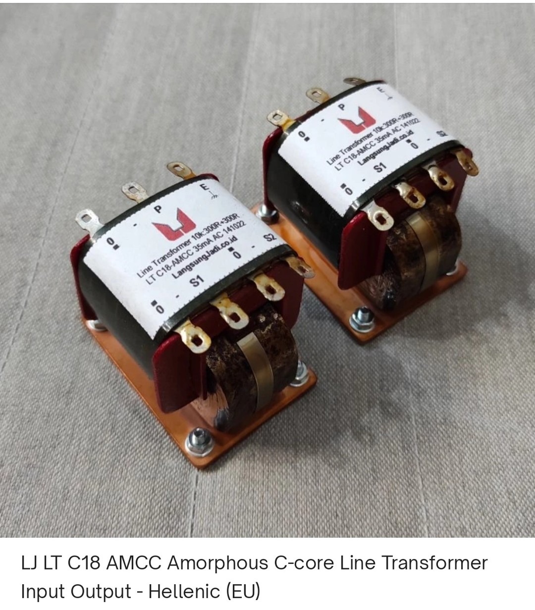

thanks for reminding me of this autoformer, subs ZM thread long time ago but still never purchased any maybe due to the cost hahaha. another 30% for customs fee will end around 650 eur which is alot for me

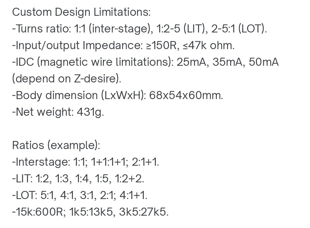

anyway i find this local made LoT which will cost me around 140usd per pair, stated it can be configured from 1:2 up to 1:5
any input which gain should I choose? will 1:5 become too much gain or just keep 1:2?

The impedance reflected back to the buffer by the load will be the load impedance divided the square of the turns ratio. So if your load is 10k ohms and you use the 1:5 ratio, the load on the B1 will be 400 ohms. At 1:2 it will be 2500 ohms. The output Z of a B1 buffer is about 150 ohms if memory serves, but the standard schematic shows a 1k resistor between the output cap and the output. ZM once suggested removing or jumpering that output resistor when presenting the B1 with a heavier than normal load like from an line transformer.

more info about inductances of thingie?
from numbers and winding arrangement, configurable ( in pure transformer mode) as 10K: 300 (which is 5.77:1 voltage vise) and 10K:1200 (which is 2.88:1 voltage wise)
late in my head, so I can't fathom proper ratios for autoformer config now

I'm thinking about SIT L'Amp, because it has no input buffer. for FW clone should be no issue due to B1 built in amplifier
it's really useful if you respond to questions ....... I'm still not sure that you bought exact xformers shown in post #522, and list shown in post #525 is general one .....
when you confirm xformers you're having in your hands, I can go in simple calc exercise, to see what you have with (my preferred) autoformer arrangement
ok, to paraphrase my self - above written what you get with regular xformer arrangement
if you connect it as autoformer, you'll get 6.77V/V or 3.88V/V gain
say that B1 is having Rout in range of 40R, so here is what you have with B1 followed with autoformer (without second B1 in cascade, after autoformer)
in first case Rout should be 6.77^2*40R
in second case 3.88^2*40R
that, if you buy xformer shown on pic in #522
