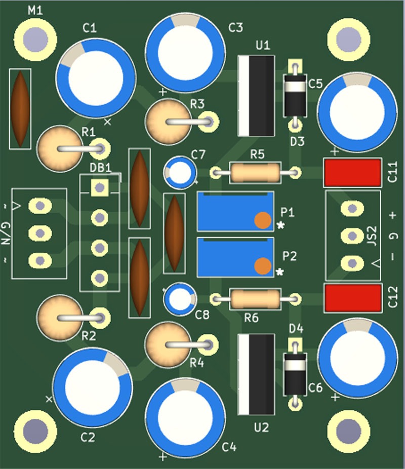

I used a 317/337 linear supply for mine with a 24V AC 1A wall wart. It works great. The same board will also work with a dual secondary transformer.
I'd be happy to share the schematic and or gerbers if you want them. It's definitely not dialysis. Not even close.

@carlpysd, I'll post something soon, or PM you. I don't want to hijack this thread. @SRMcGee. Yes, Heat sinks would be a very good idea if needed. But not needed for an aplication that draws little current. They were not overlloked but were left out by design. But.. I suppose the TO-220 regulators could be placed so the leads could be bent and the parts bolted to the base of the chassis a a heat sink, if needed, rather than upright.
