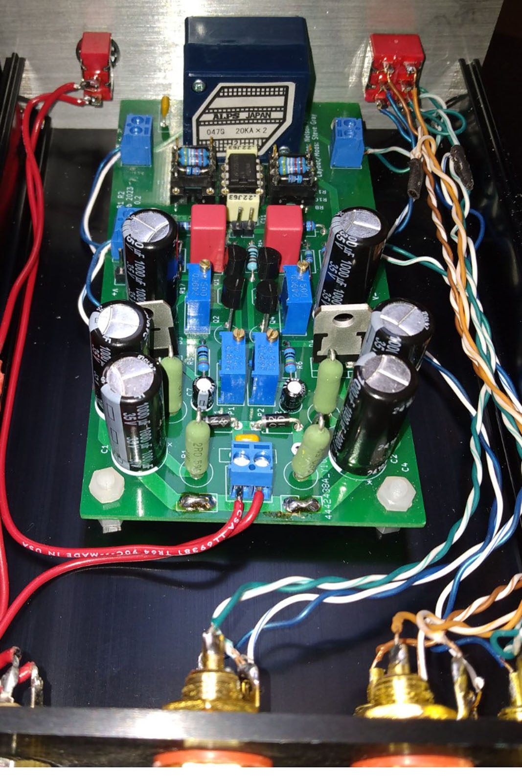

I finished and posted my B1R2 with the bells and whistles elsewhere on the site but it did not get much notice with the B1R2 crowd. I obviously put the post in the wrong place. So here it is again for my fellow B1R2-o-philes.

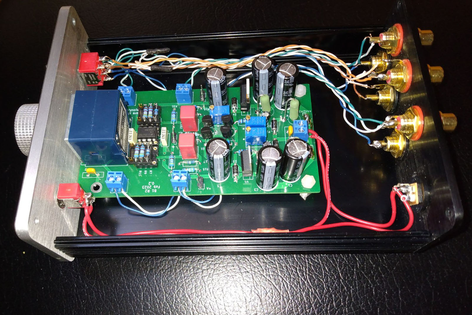

This is for my office rig that also uses an ACA-Mini with boards laid out so it can be housed in a conventional chassis with heat sinks.
I'm working on balanced supply version of that as well. I populated the boards and power supply this weekend.
The output buffer is where the magic is and is pretty much as designed by Papa (Thanks Papa! 🙏). But I also added a few other things I wanted,
There is an adjustable LM317/337 based power supply w/RCRC front end, a volume pot and a configurable gain stage all on one PCB.
The AC source is a 24Vwall transformer using a standard 2.1 mm barrel connector.
This build has 12dB of gain and I really like that a lot.
But the gain stage can be de-populated and omitted or easily changed with socketed components.
Same goes for the PS. It's easy enough to de-pop and bypass,
The pot is a 20k Alps RK2.
Using a 20k Pot with 50k input impedance was pretty stupid. That will change.
The next build will use a wider chassis and and a front panel 1/8" input, an LED power indicator. load R's on the inputs and a 10k pot with a higher input Z. Maybe a mute switch, too. The next build will go in the main rig.
How does it sound? I think it's great but I am biased. It is very open, detailed and dynamic with great imaging and depth. My office stereo never sounded this good. BTW, dDoes anyone want an almost completed BA-3 gain stage? I see no reason to finish it. How much better could if be, if audibly better to me at all?
The board was created in KiCad. I'd be happy to share if anyone is interested in the design files or Gerbers

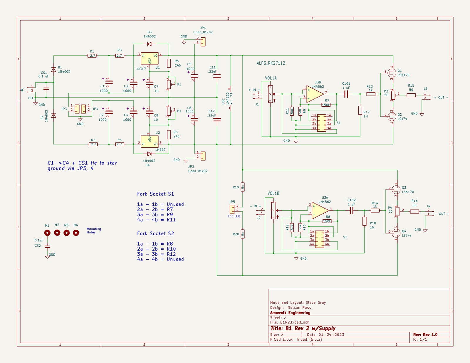

The attached schematic is as built. I have a new rev with tiny improvements not yet built and it probably never will be built. I ordered the five board minimum for the first build and expect to only build a few more.

REMOVING OUTPUT RESISTORS: I bought some fancy zfoil audio resistors (low inductance) that were pricey...but found out the best sound I have from my B1 rev 2 buffer (2019) is if I remove ALL the resistors from the output. The transistors from the store are so well matched that without a pot and even with removing output resistors the DC voltage at the src output of the transistors is only 0.7mV for one channel and 0.4mv for the other. My power supply with filtering is working great.
NO ATTENUATION: On the input I did some testing using those sockets suggested and found that the simplest was the best sounding for my setup-- by that I mean no -12dB or -6dB attenuation... just a 930 ohm resistor (replacing the 1K in the schematic) and having a 26K shunt resistor at the input to ground (instead of Pot+1Meg) and I'm using my DAC for volume control. The resistors I'm using at the front right now are audio resistors. I'm not selecting between inputs. It seems the more I reduce components the more transparent it gets (I can still hear slight effects of the buffer).
QUESTION about INPUT RESISTORS: I haven't tried stripping out all the resistors on the input but I'm wondering about that. All of my interconnects to and from this buffer are helix design, low noise, low capacitance, low mass KLE rca.. I'm trying to squeeze the last ounce of transparency that I can out of the buffer. (My amp is a very high bandwidth amp...sensitive to everything).
Is it safe to remove all resistors at the front end of the B1 rev 2? (will it cause problematic oscillations): do I need the 930ohm (1K in the diagram) at the gates to the transistors? If I try it without a resistor in there and it sounds okay will it perhaps later damage the transistors somehow?
Is the 26K resistor from input to ground... is it really necessary? Would it help to have the 26K resistor bumped up way higher (even if it's a traditional resistor and not an audio low inductance one)? Any suggestions?

I may be wrong but I would do the following since you run it without a pot:
Remove the shunt resistor, reduce the 930R to 400-500R, and leave the outputs open. You can also potentially try to remove the 1M resistor to gnd, the one that is originally attached to the wiper, but this will likely provide little or no audible benefits.
You could drop the gate resistors, but the gates can theoretically begin to draw current and create issues, so if you do this I would monitor the output with a scope and see what happens in the high freq reign. MZM sez approx 500R is fine in that position. Papa uses 1K also in his beast cells and the original F6 circuit, for safeguarding. But he also notes he did not observe oscillations without it. So maybe worth a shot testing with 500R and some lower values too
Thanks GndSense and I largely agree with What Andynor says .....
But you could need a path from the FET gates to ground if they are to auto bias. I would not remove the 1M R before the gate unless there is another R to ground right in front of it.
You want the gate at 0V. Hence the R from gate to ground and, in my case above, a coupling cap to prevent a DC level at the gate.
You could drop that value to 100k and it would still be fine. But you should have something and, considering it's not in the signal path, I'm not sure the specific value is of huge importance or audible.

I think the R to ground (i.e. DC ref to ground), is needed. I made a mistake on my first layout and put the coupling cap between the 1M and the 1k R to the gate. So the gate had no DC ground reference. I got no music from the buffer. I patched the board to move the 1M to ground between the cap and 1k and it started to work. That gave a 1M DC path to ground instead of an open. It seems odd that, even through it is 1M, it worked. But with no DC ref to ground at all it did not work. Maybe something else was happening as well. I'm just a hobbyist, not an expert. I'm just relating my experience.
