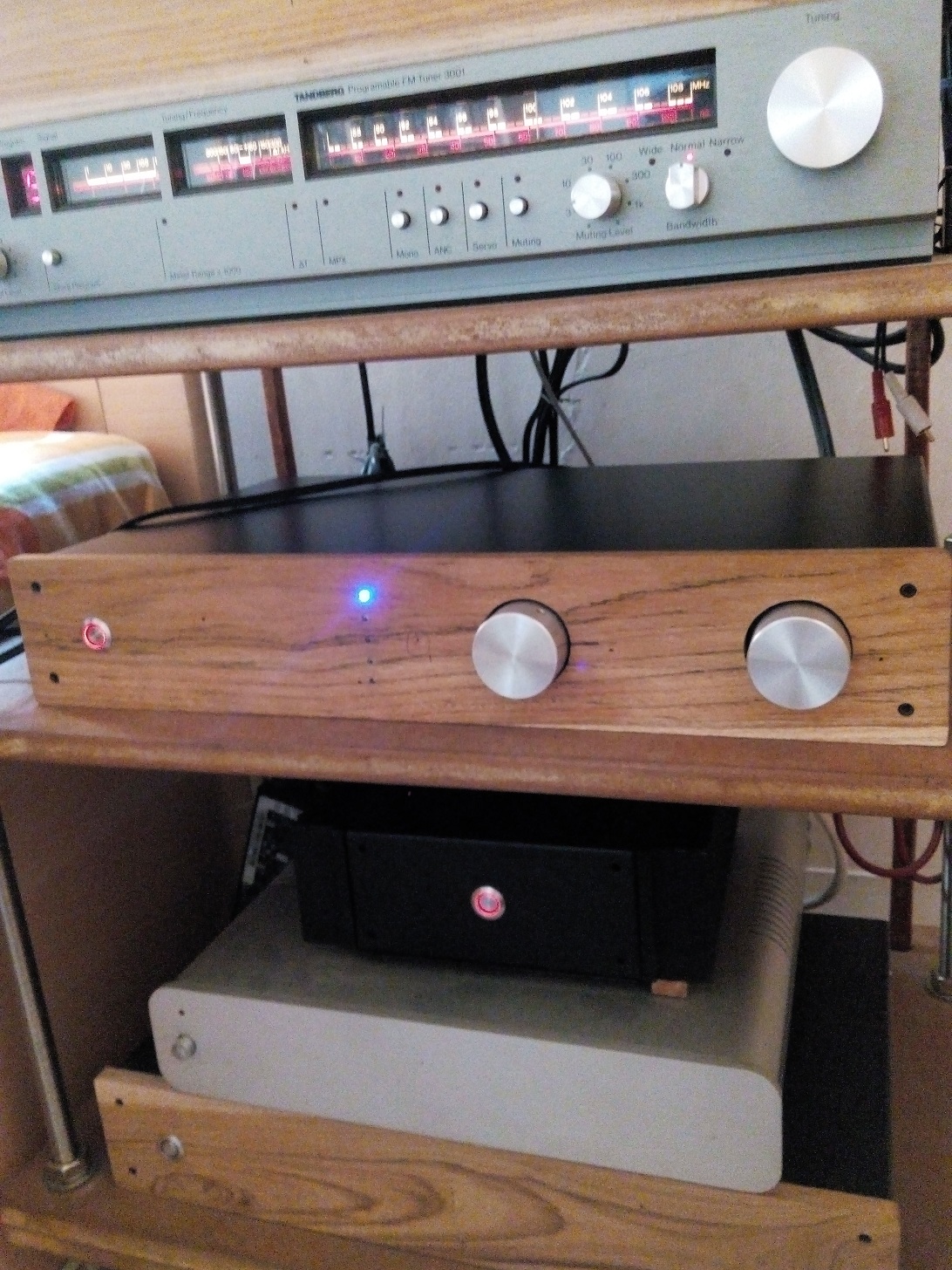

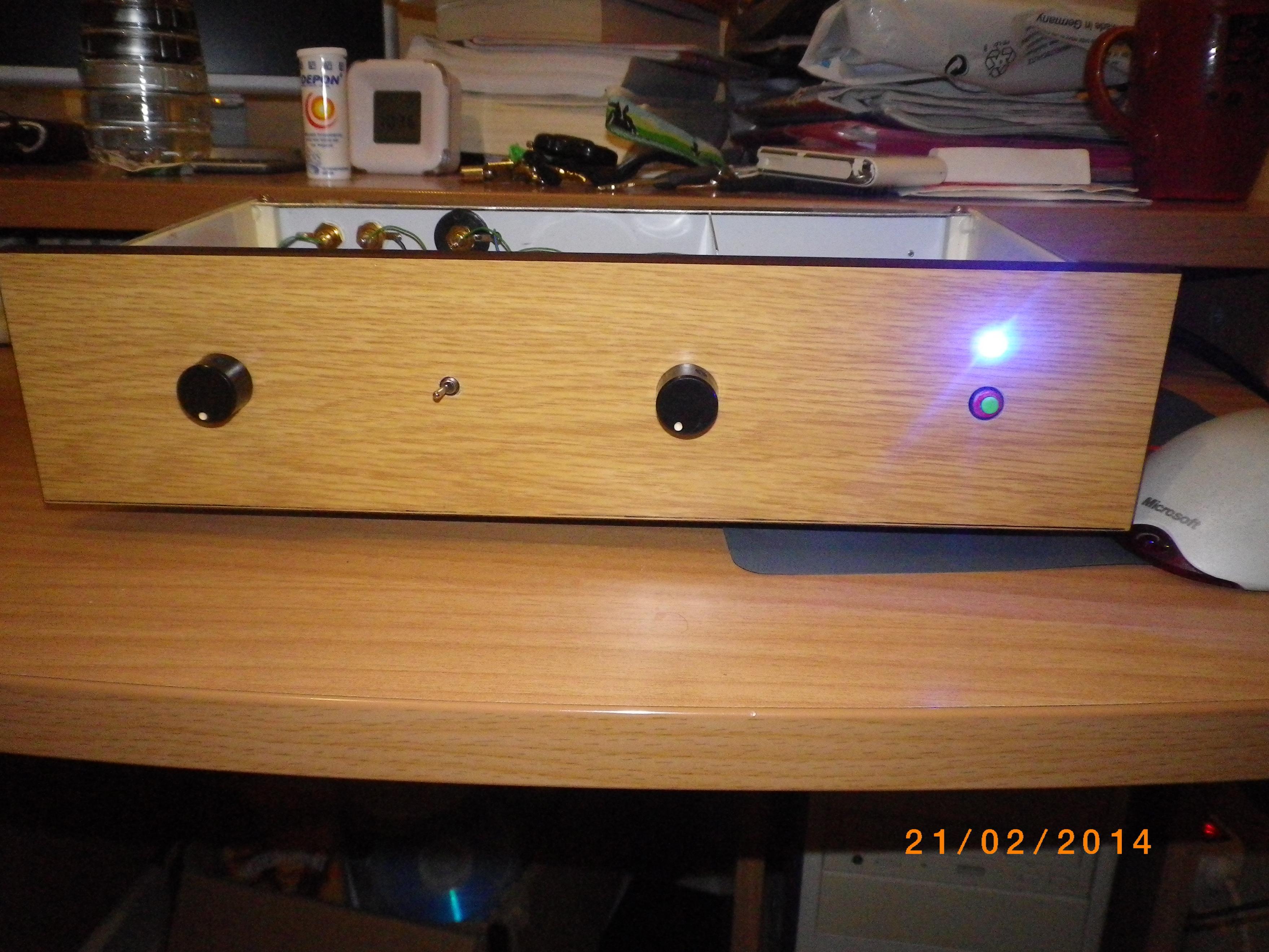

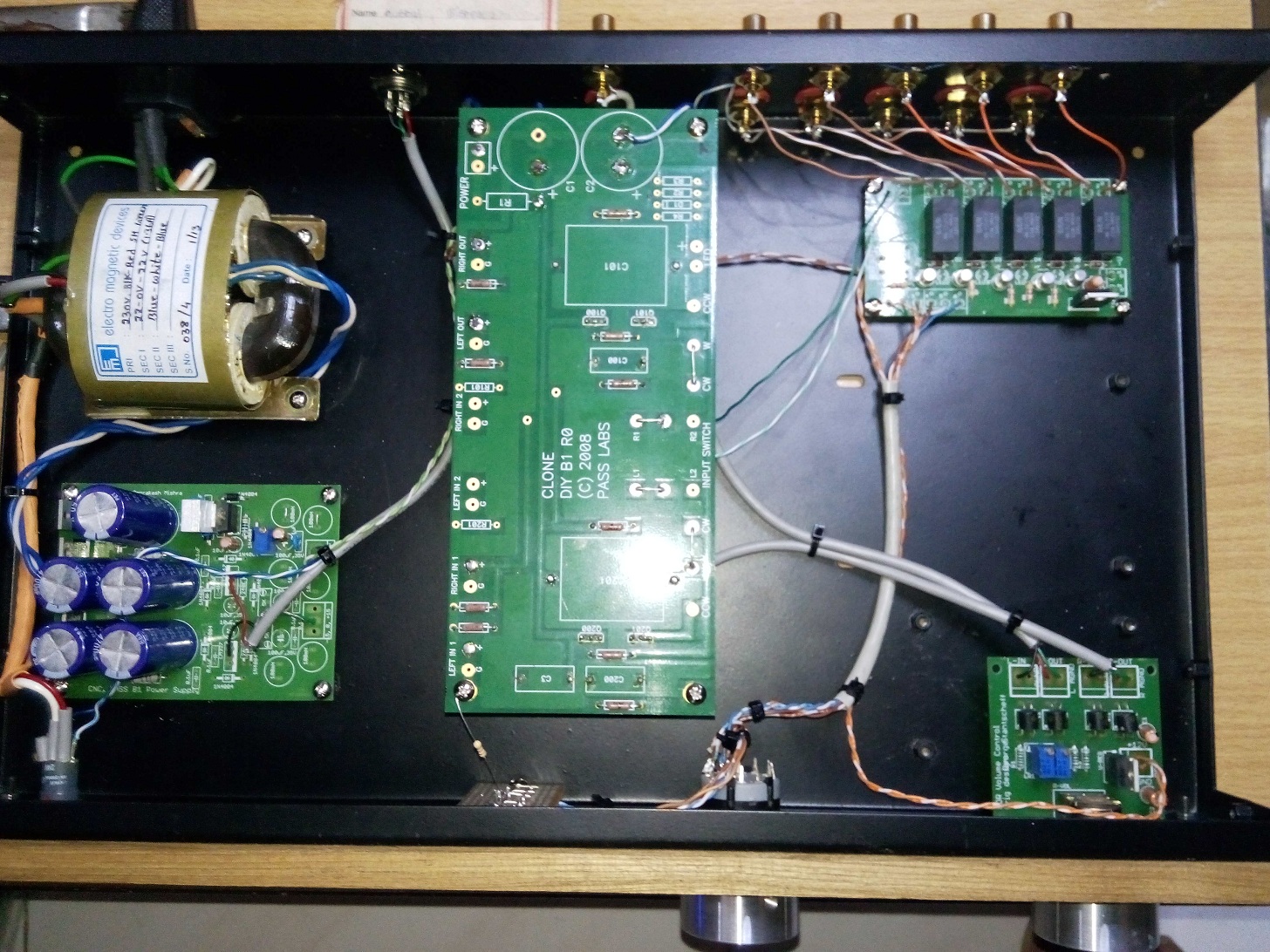

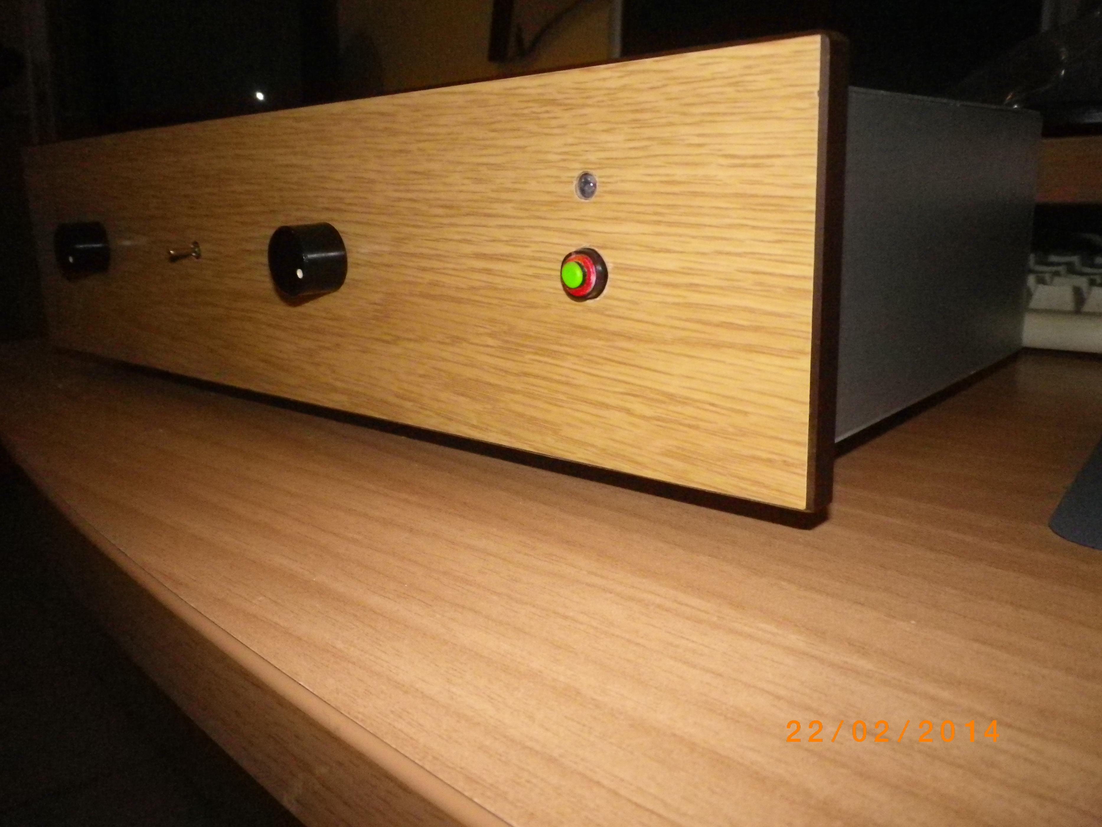

I recently completed two pass B1 preamps - 1. for my son and 2 for me. Both are paired with ACAmp and I plan to use F5 turbo v2 with it. Both have 5-1 source stereo selector.

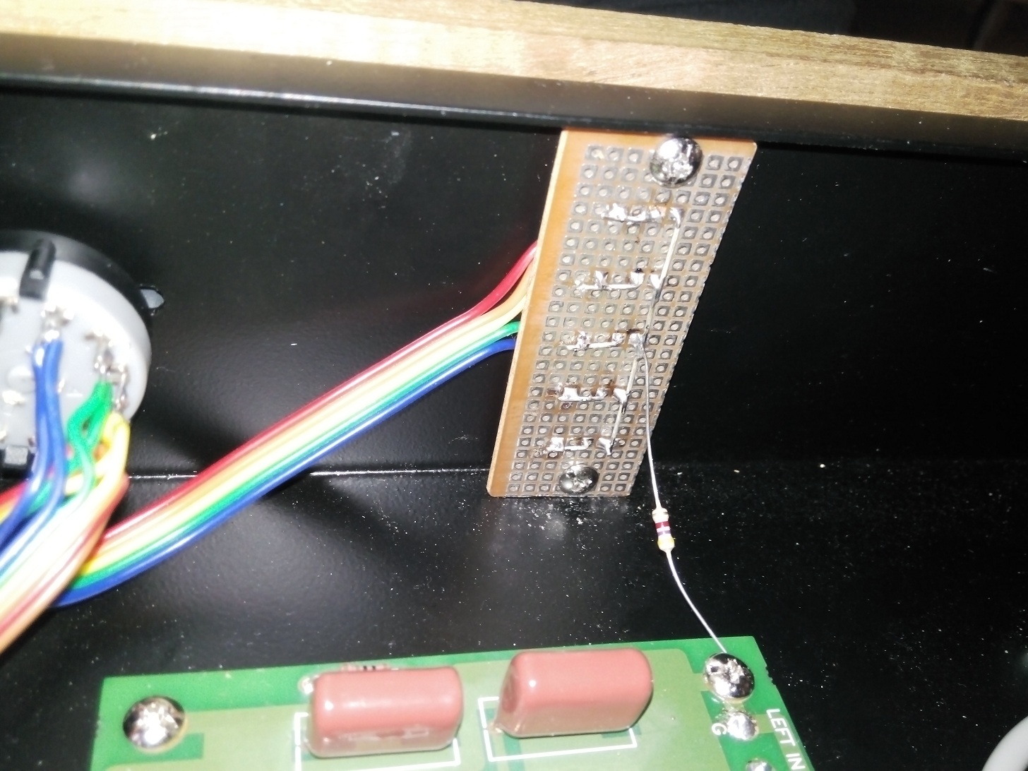

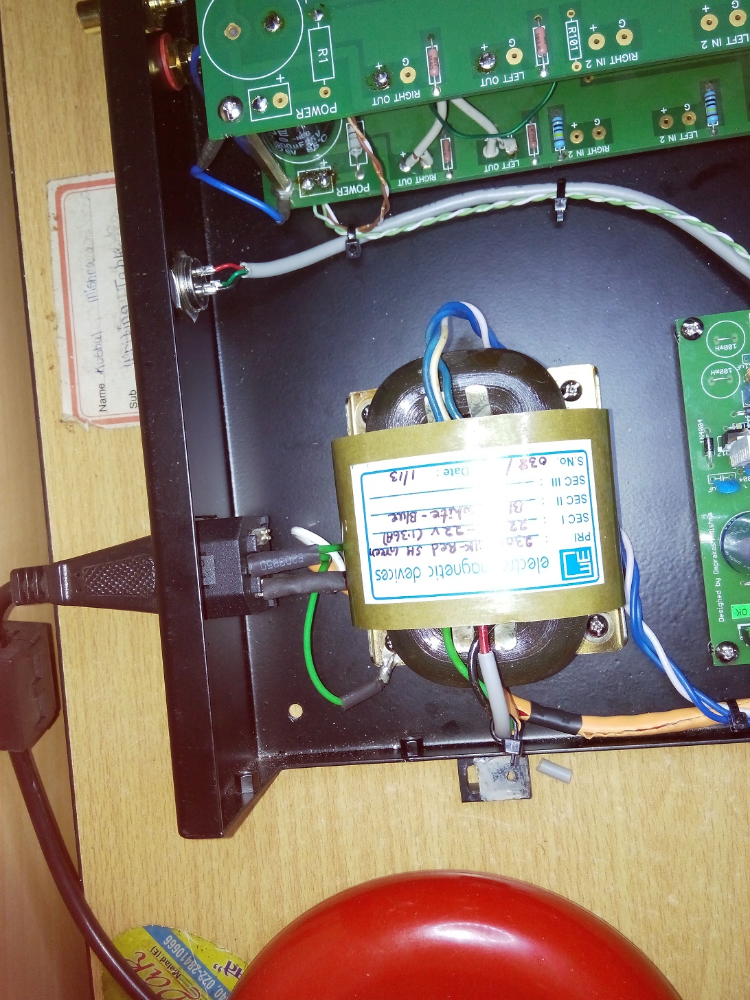

This is for my son which is using LM317 based regulated PS powered by 22-0-22 rcore transformer. Also I have used +15,0,-15 supply for external phono preamp etc. Here I am using resistive ladder 23 step volume control of 47KΩ.

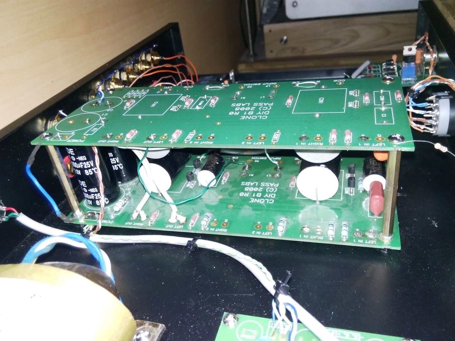

Another one is for my listening room. Ths is double buffer B1-> (Volume Control) -> B1. This is also using LM317 based regulated PS powered by 22-0-22 rcore transformer. Here I took out unregulated +33V, 0, -33V for Pearl 2 Phono stage. Volume Controls is LDR based Attenuator.
In the rack both look same from outside, hence posting only one.
I find it sounds more lively with double buffer, one before volume control and one after volume control.

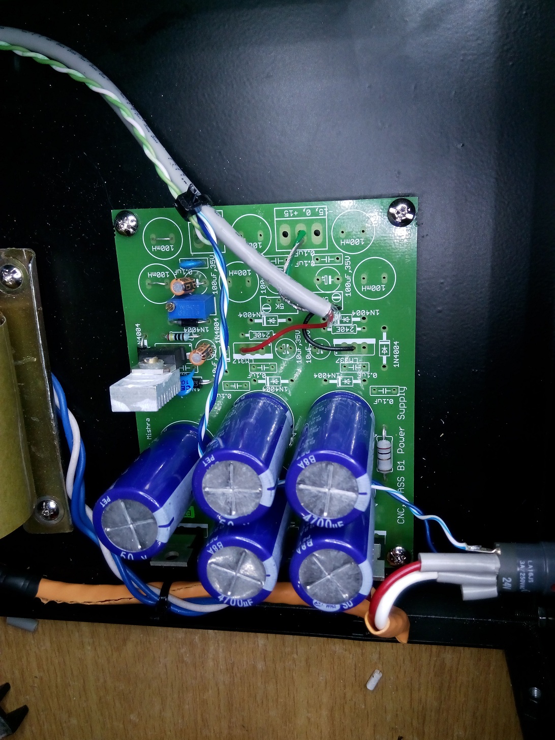

I am using the same Power supply designed by Omishra for B1,SSP and CNC Phonostage.It is one of the best available Power supply for preamps,and also has adjustable output voltage.

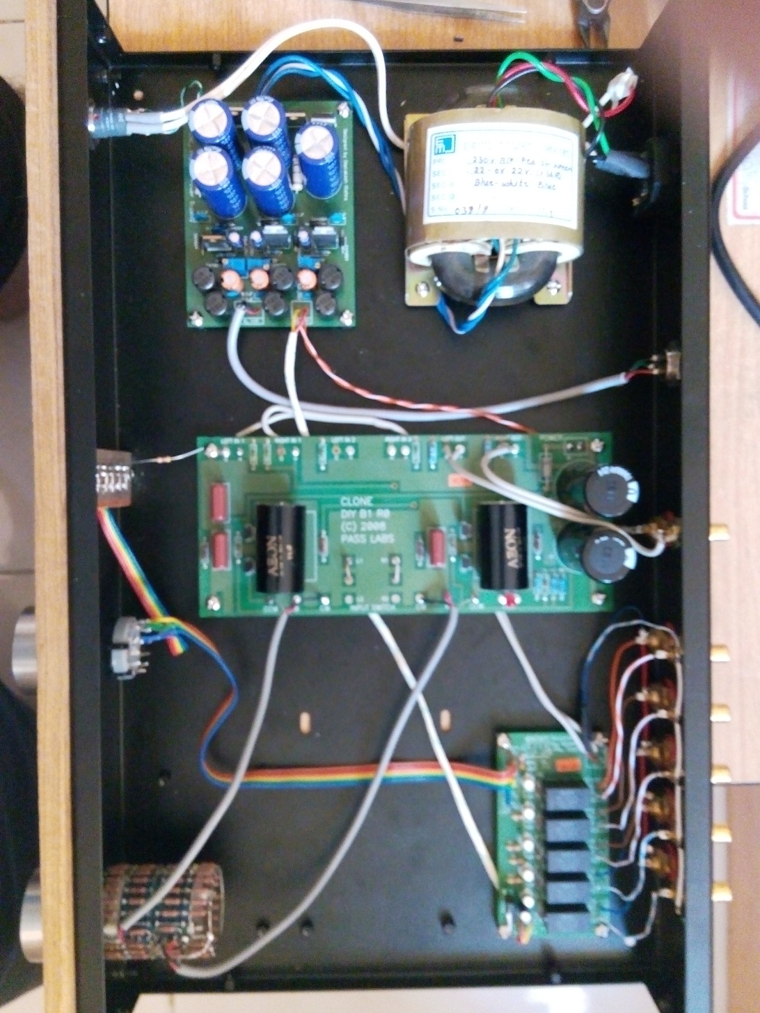

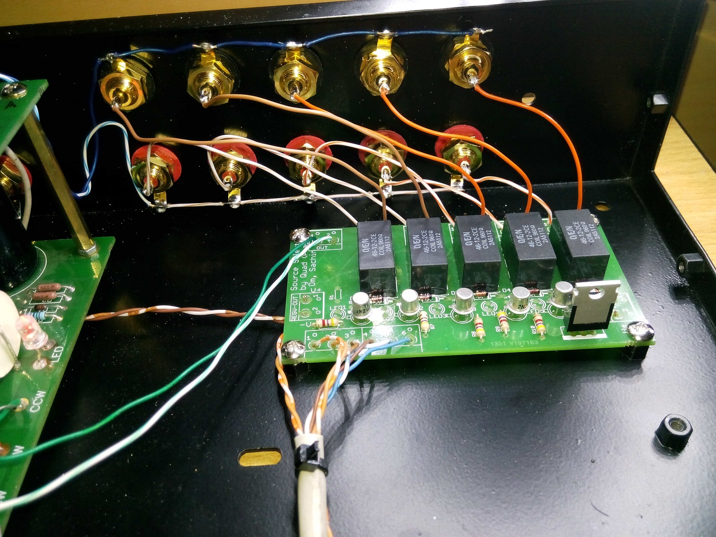

I like the layout putting the input selector relays beside the Input sockets.
But you have incorporated enormous loop area into every input.
The Signal to the relay is a TWO wire connection. The Flow and the Return. You must run the Flow and Return TOGETHER to each Relay. The Return bypasses the relay and then follows the relay output to the Receiver, or coax than then feeds the receiver.
Each single Wire Flow from your input sockets must have it's partner Return Wire close coupled or even better a twisted pair.
You have 5 stereo inputs. That requires 10 twisted pairs.

Sachin - do you have a link for Omishra's power supply? Geez, I don't pay attention for a little while and feel left behind when I return...
Thanks!
Thanks!
Thanks!
You can see few OPS pics here Introducing the (mini) Tower of Power - AudioKarma.org Home Audio Stereo Discussion Forums
and here Looking for full size Chassis for CNC phono pre - AudioKarma.org Home Audio Stereo Discussion Forums
Sachin
Thanks!
This is here! It has link to schematic and PCB as well.
Thanks for suggestion!I like the layout putting the input selector relays beside the Input sockets.
I thought this does not have any gain stage. So I can use bare wires for connection without shield and twisting. There is return path of all RCAs connected together and referenced at ground pin of PS capacitor of B1. Relay switches only live wire of stereo, L and R simultaneously. Do you think it's still problem? It's dead quite and sounding lively as always.
the Signal connection is a two wire arrangement.
If you include a large loop area in that two wire connection you make the input susceptible to interference.
Think of the relay as a single pole switch.
The return runs past the single pole switch as close as possible to minimise that loop area.
Now look at the input of the receiver circuit.
It expects a two wire connection.
You must feed it a two wire connection from your selector board.

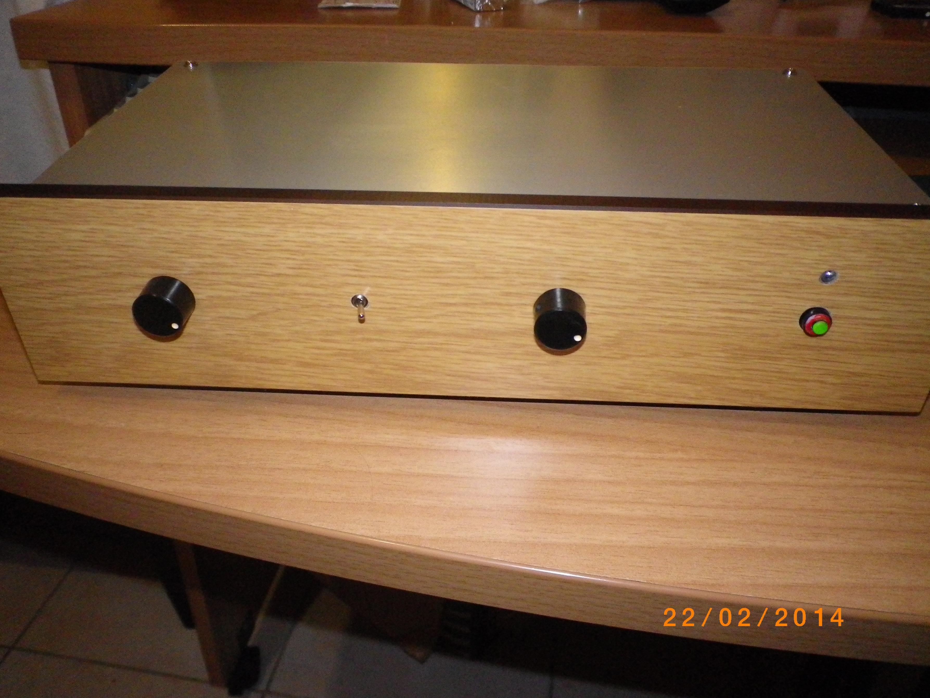

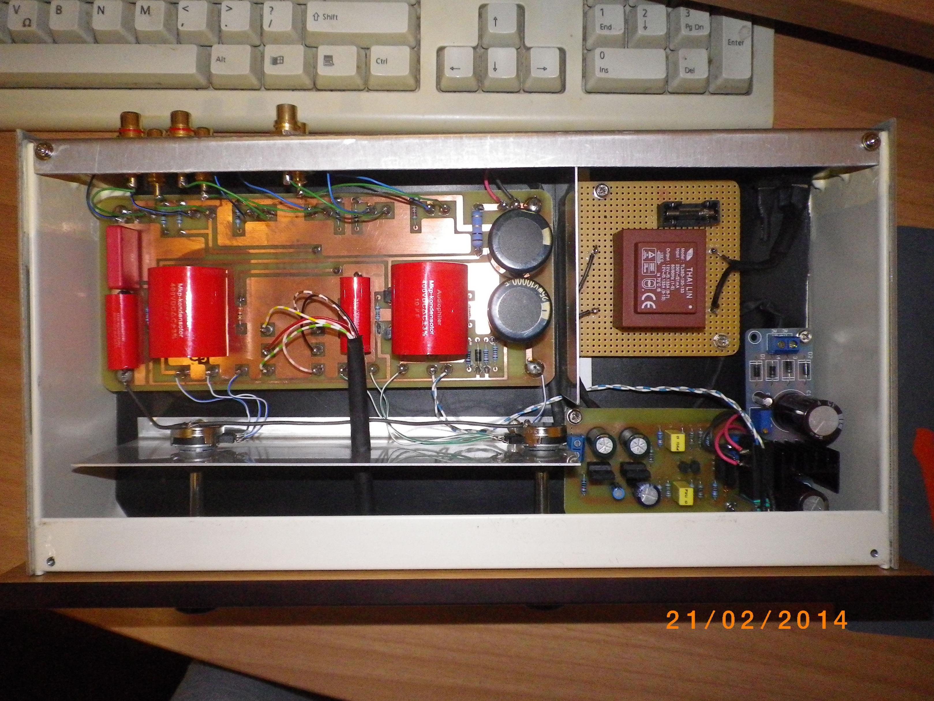

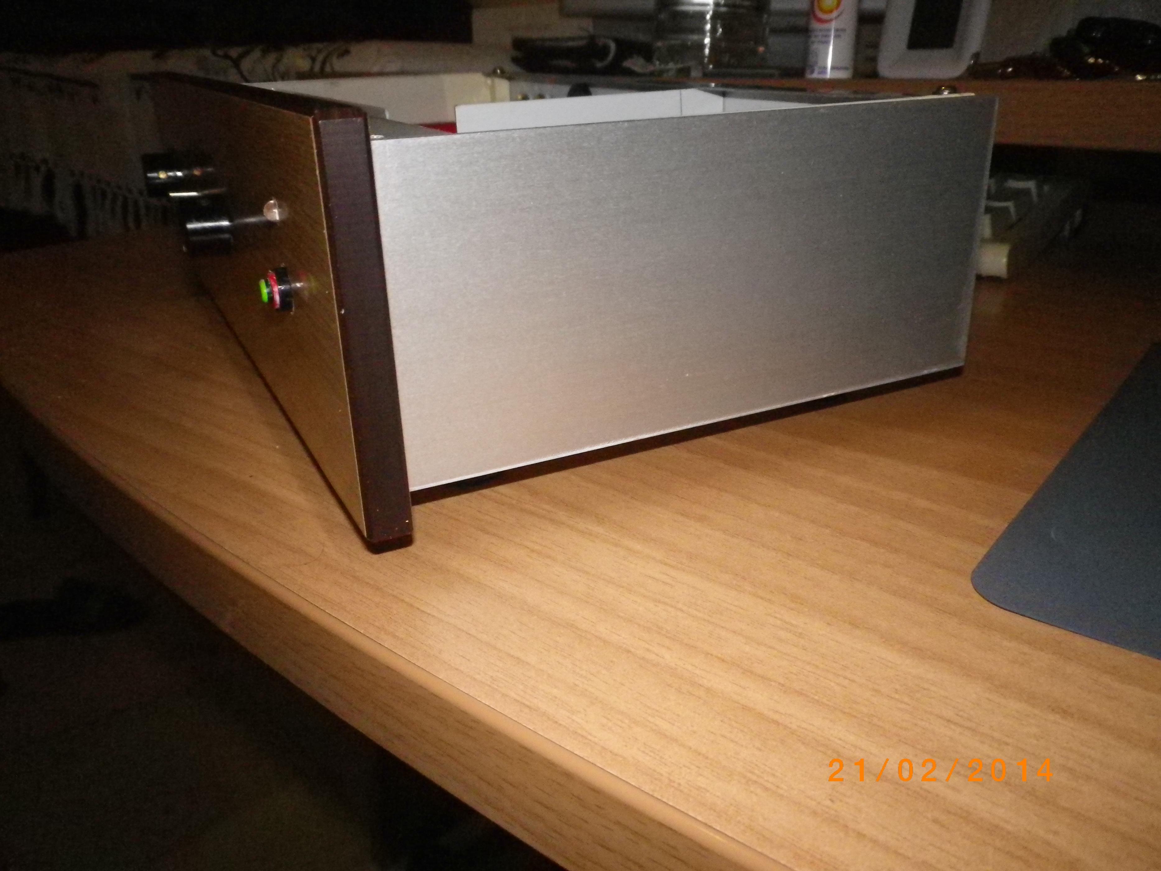

B1 BUFFER
Hi
this is my B1 Buffer .
Pcb its from gerber fille .
2sk 170 matched to 7.8 ma at 640 mv vgs
10mf-1mf Audiophiller
JLH Shunt Reg at 22V
LM 317 at 22.10 V
Two separate pots 25kΩ
