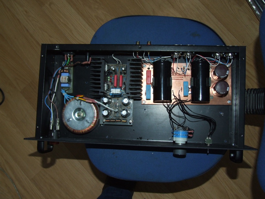

I run mine from a 30VA 9-0-9V into a stock 1A bridge then CRC with 2 x 4700uF LCR caps with 2R2 between them. Reg is a straightforward LM317.
Its actually better than a DCB1 that I am trial building at the moment. I did use Obbligato 10uF Caps though.
The little PCB on the top left is just a Mains Filter that I pinched straight out of a VCR.
The PCB is Home-Brew. Although it is Double Sided there are no tracks on the Upper Surface, just the Ground Plane.
Ever so easy to make at home.

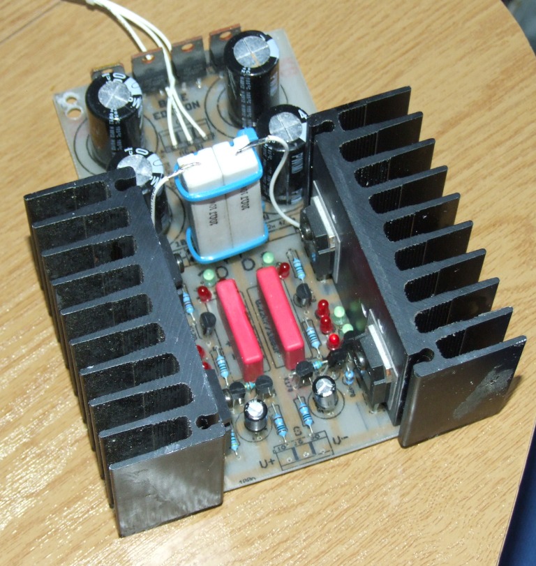

My B1 has evolved with a Salas Shunt Reg.

If you wonder where the Salas Shunt Reg PCB came from, it's Home Brew. After talking to Salas he graciously let me use the original artwork for the Mesmorise which I cut off the B1 portion. For some reason my H.B. DCB1 wasn't at all reliable, probably down to a track shorting somewhere. I eventually kept the PSU part and reverted back to my H.B. Pass B1 with the huge Obligattos. Result is pure Nirvana.

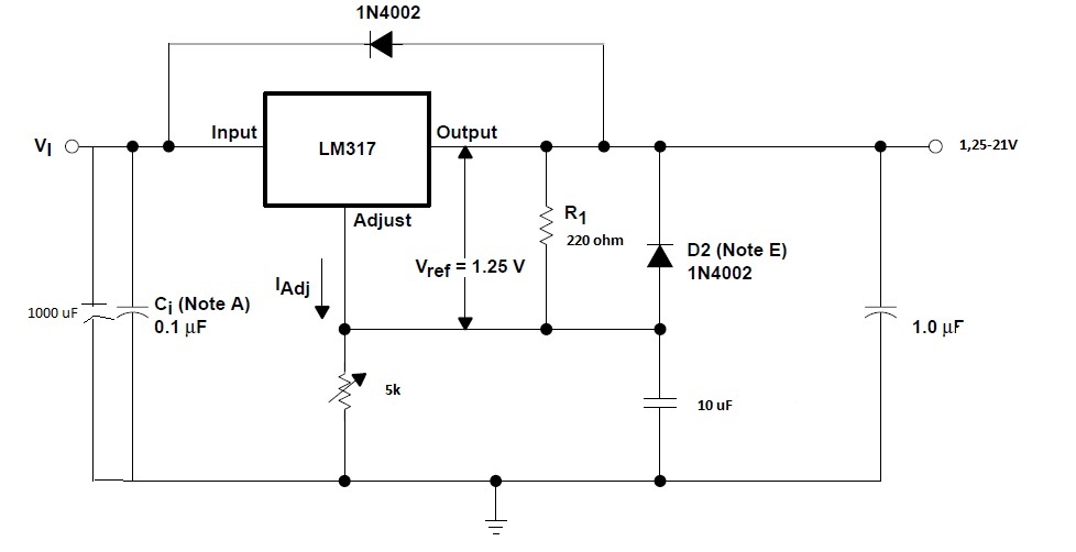

PSU circuit board - Universal Power supply PCB from Peter Daniel DIY Chip Amplifier Kits, PCB's, Components and Information. This product is not on his website, but email him and he takes care of it quickly. Lots more info on this board here - http://www.diyaudio.com/forums/audio-sector/149672-universal-power-supply-pcb.html
PSU regulator Schematic - http://cache.national.com/ds/LM/LM117.pdf

Is this the PSU? I can´t open the file.
Have it enough filtering?
