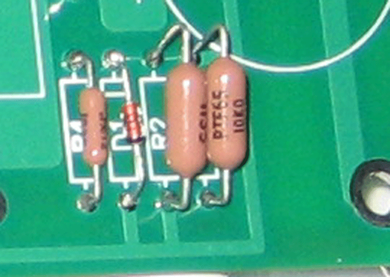

diode polarity
Hi could some one please tell me if the diode has been soldered with the correct polarity.
