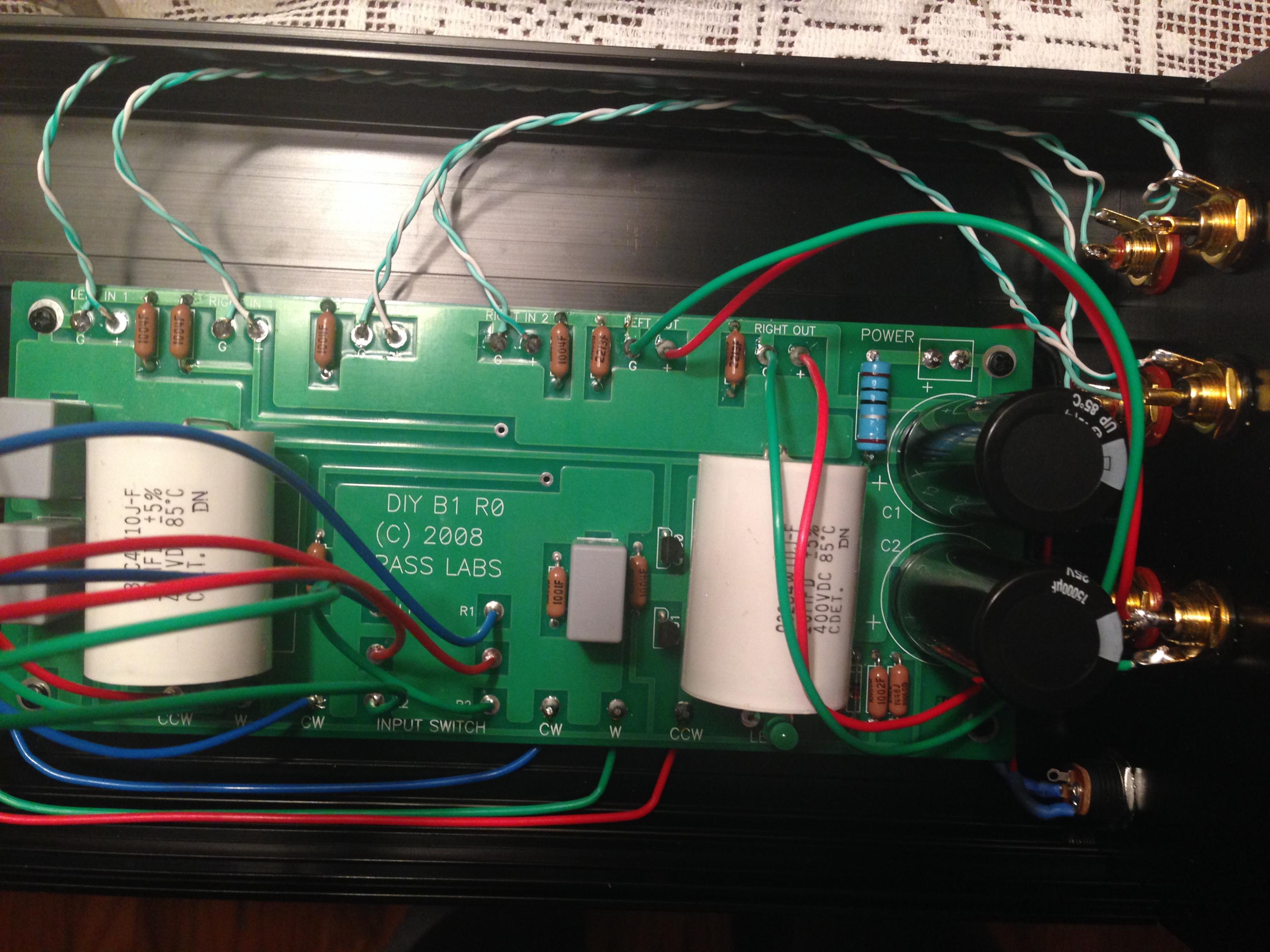

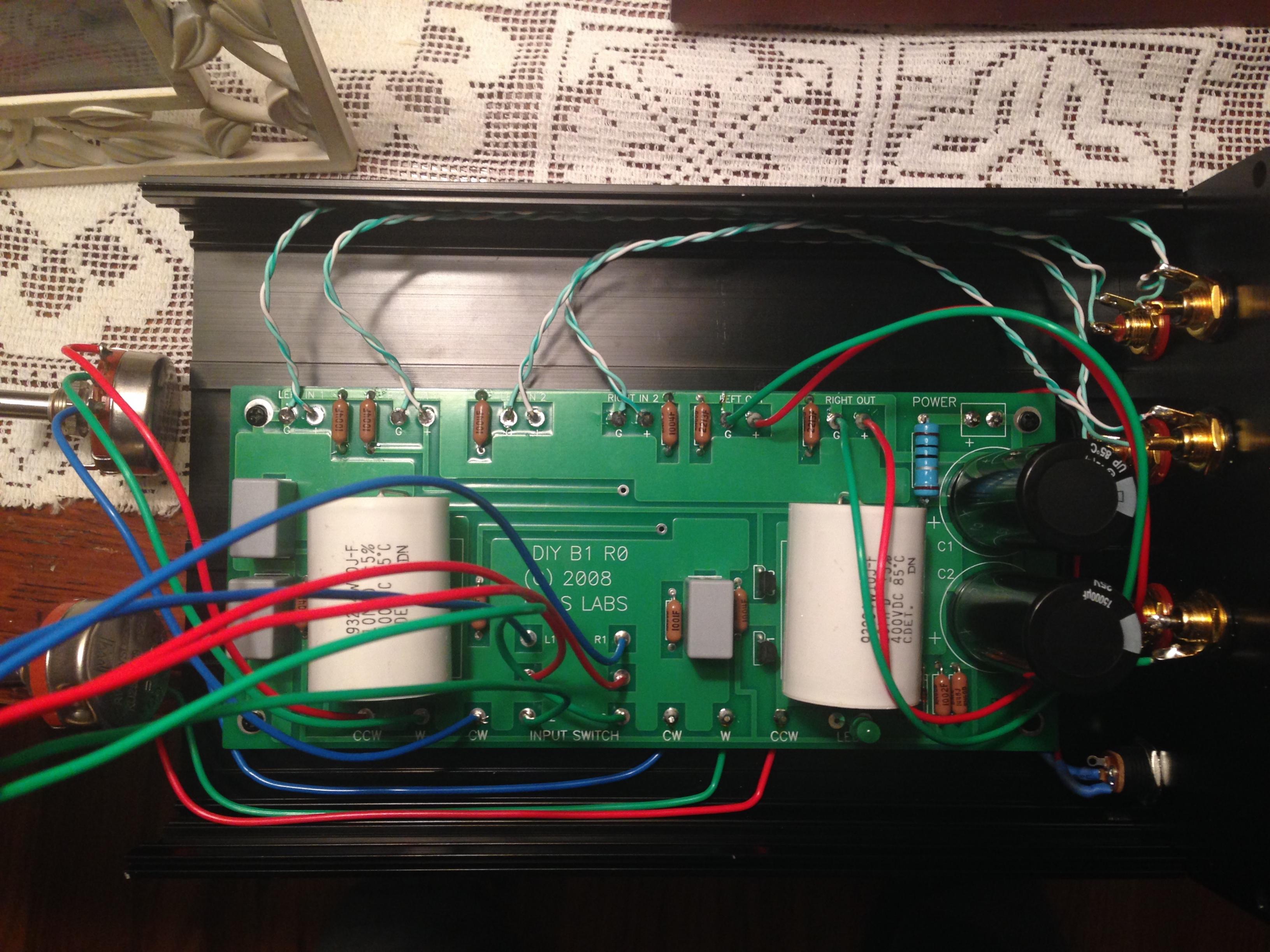

I'm posting my build, below, just to share with others on the thread...
Well done! Looks great. Which size Galaxy case did you use for your build?

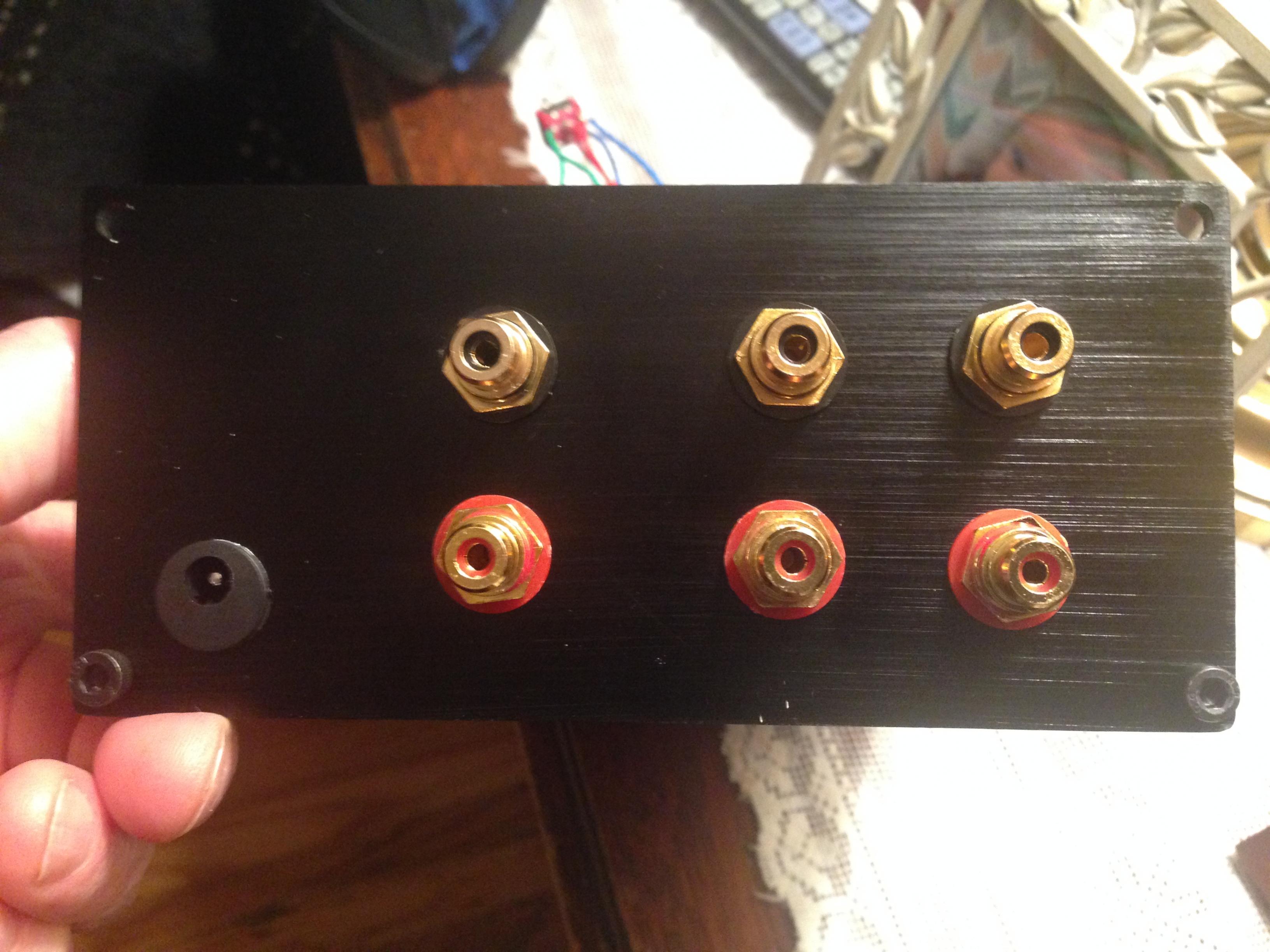

2U w/ Al. covers. I struggled a little bit with height (to fit NPs preferred caps plus stand-offs) vs. depth (length of hookup wire) for a width that would fit the board. In the end it was the correct height and width, but a little too deep (which means longer hookup wire that was preferred).
In any case, I'm happy with it, and it was my gateway drug to other builds.

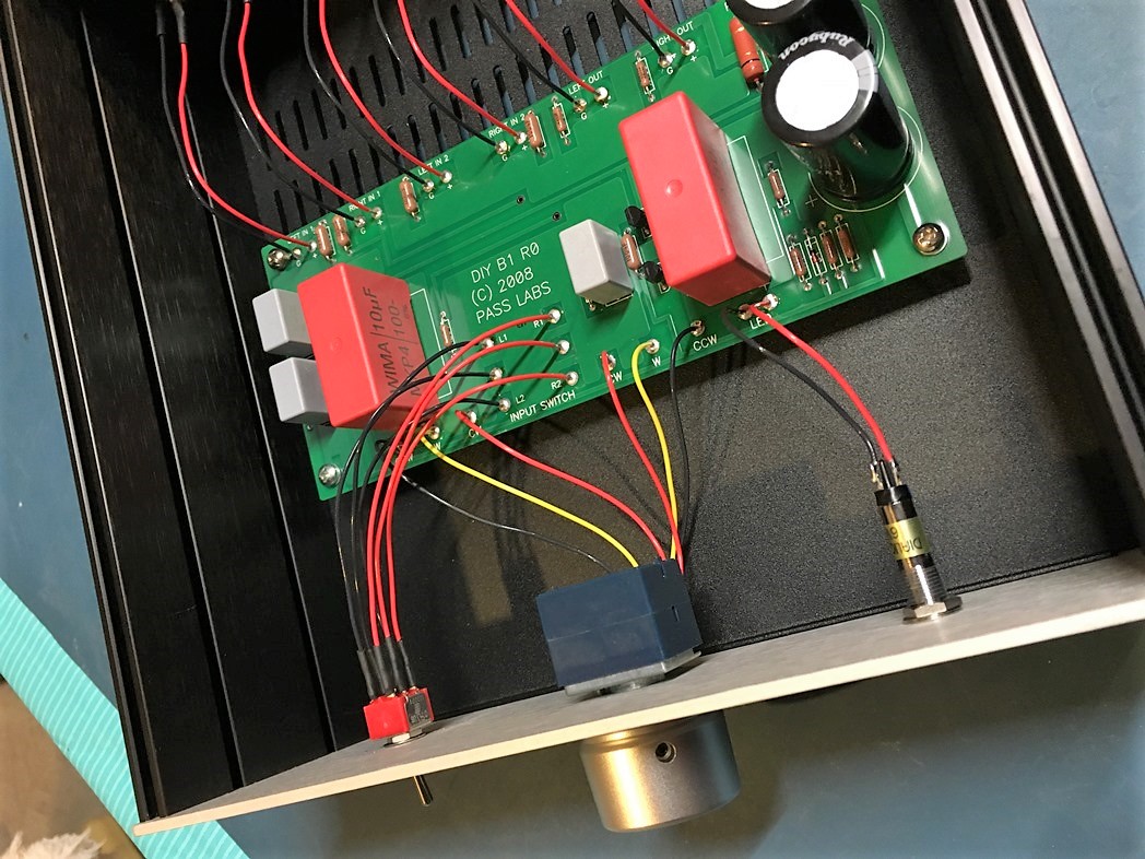

I have the B1 pre amp.
I can't figure out how to wire the source switch.
I have 2 devices, a CD player and a phono which has it's own phono stage.
Can someone show me how to wire a switch to the board ?
Take a look at the pictures in post #560. Wire your switch that way and you will be good to go.
