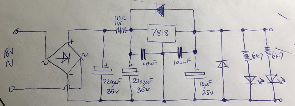

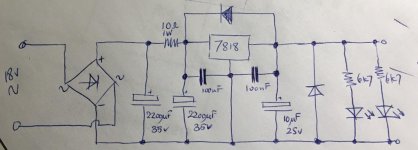

If you measure +/-15V on the output of that PSU it's probably fine. However, what isn't fine is that you seem to have a dual-rail PSU supplying a single-rail amplifier. Can you draw how the two boards are connected together? From an earlier picture it looks like you have previously run the B1 on two 9V-batteries in series - did it hum then?
i'm afraid you're quite right. i did use the dual power supply for the (single rail) b1. i have to admit that i really only used it for maybe 5 seconds - with reverse polarity as mentioned before. after that i only used the two 9V batteries. and yes, there was some hum - how did you know?
unfortunately i don't remember how i connected the together. i believe +15v to '-' on the B1 and -15v to '+' on the B1. Wrong obviously.
Would it be possible to use a dual supply for a single rail amp at all?

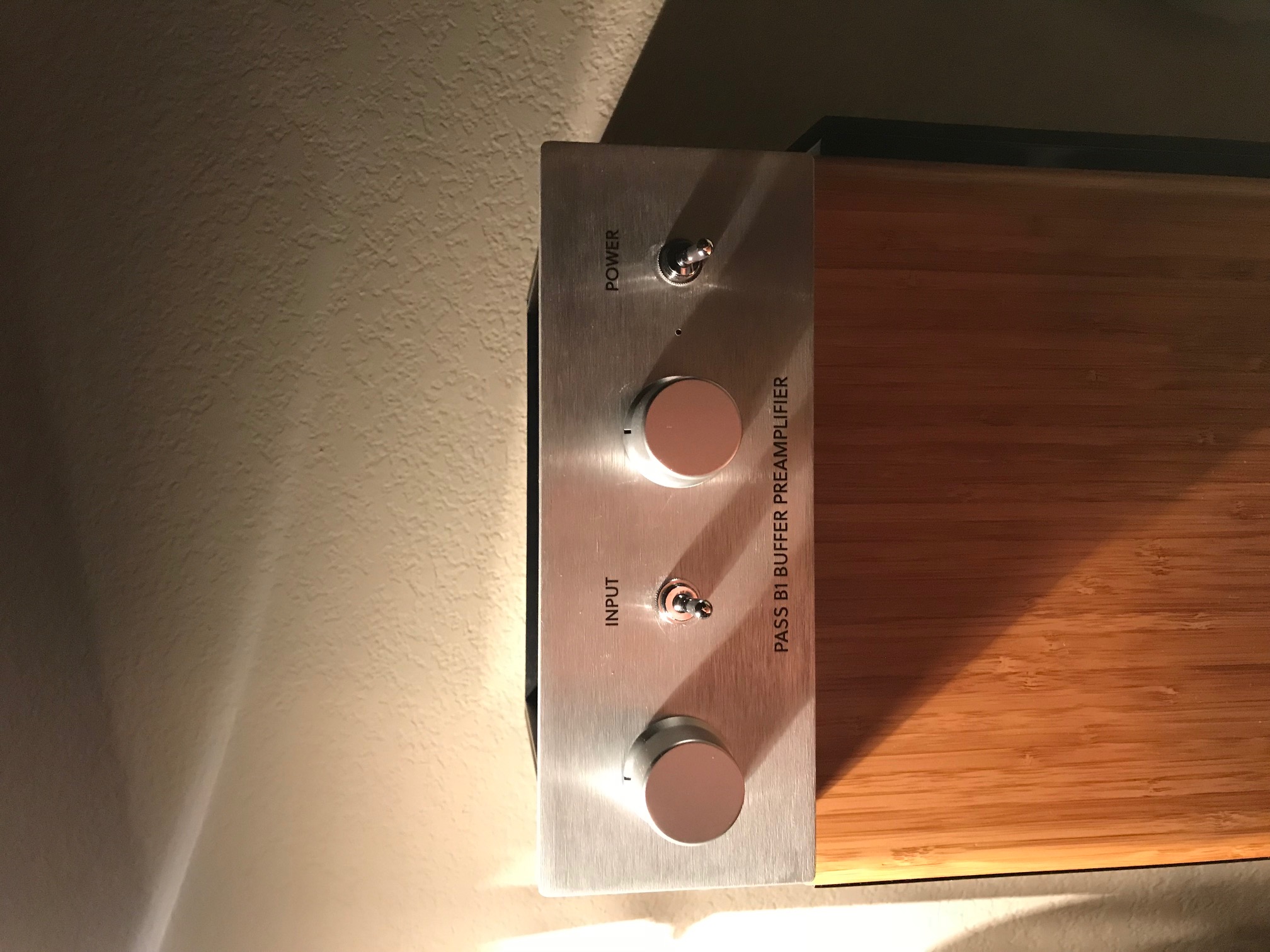

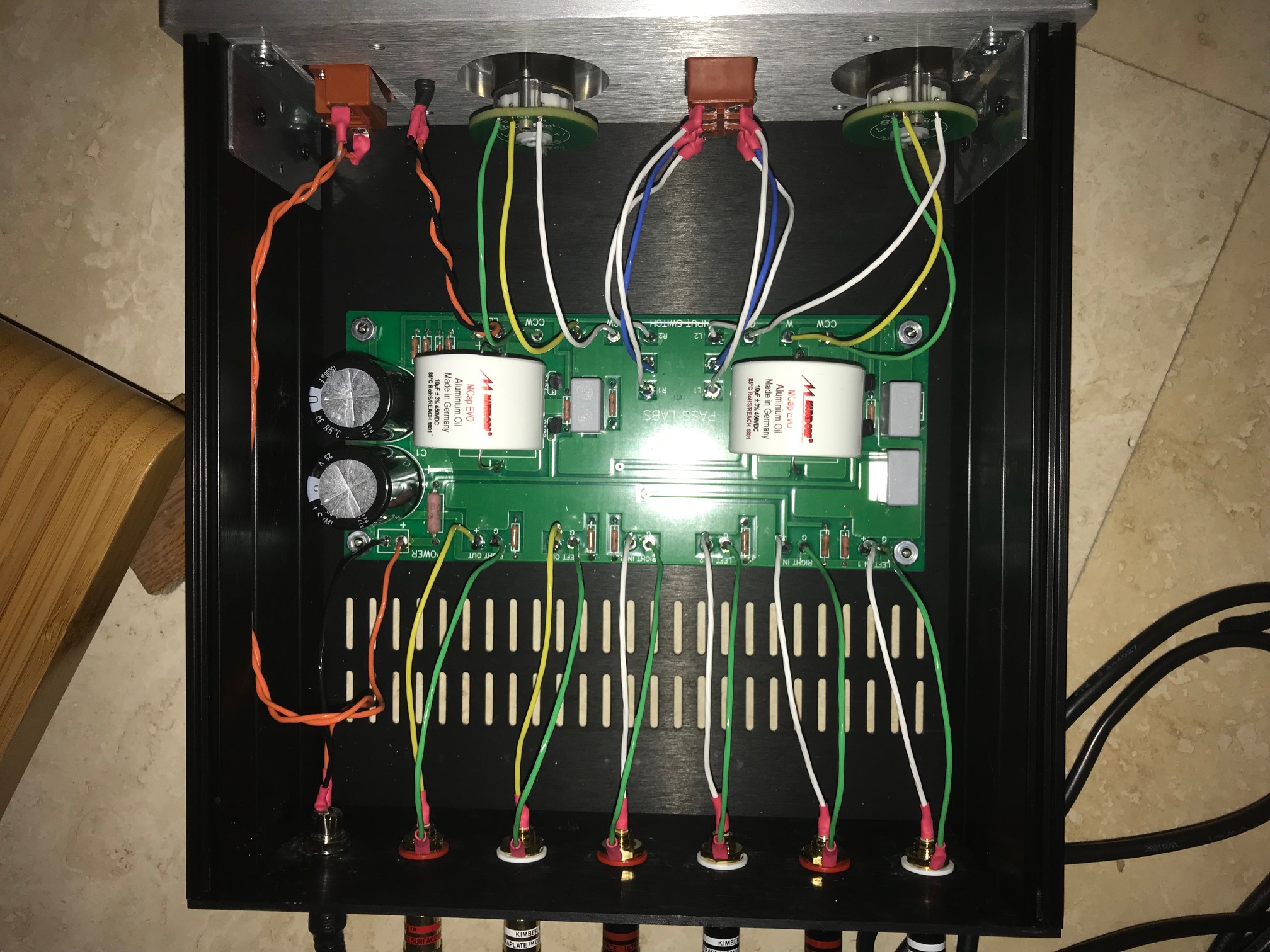

I'm posting my build, below, just to share with others on the thread...
But first I'd like to thank Jim (6L6) and Gianluca (HiFi2000). Jim answered, very patiently, LOTS of questions, and Gianluca made sure the chassis fit all of the parts properly. My build and understanding certainly would have been lesser without their assistance. Their time and contribution to the threads (in Jim's case) and customer service (in Gianluca's case) certainly make the DIY experience of many folks much better. Many thanks to you both.
I built my B1 to match the ACA amps I built concurrently. The only modification I made from the stock form was to add a power switch to the front panel.My big parts splurge were the Goldpoint attenuators, which are fantastically cool. Everything inside is from the recommended parts on the BOM with exception of the Mundorf caps I purchased at a stellar discount, and then only because I couldn't find the ones NP used.The hookup wire is Kimber, the RCAs are Cardas and the switches are NKK. These aren't the cheapest parts, but are far from the most expensive. I'm not sure the unit would sound much different if I used more or less expensive parts. In fact, I'm a little amazed at how little sound signature the B1 has. NP noted that some folks find passive pre's lifeless in sound quality, but I don't find that in this case.
The B1 and the ACAs were my first builds. I think the jump in the learning curve from the ACAs to the B1, which is very easy, had more to do with learning how to pick parts from Mouser, follow a BOM and other minor skills not needed with a project like the ACAs.
I'm very happy with my little DIY system. Now I"m off to try a few more complex projects like the Pearl 2 and the AJ. I've caught the DIY bug and really enjoying learning about how the electronics "work" and the simple pleasure of putting something together with my own hands.
Thanks again to Jim and Gianluca!

As to lifelessness and the B1 I think it is entirely related to all the ancillaries. I was never quite happy with it driving F5 in the system it was in....seemed like I needed more throttle that a pre with gain gave.
Driving my BA3 amp which has more gain, I never noticed so much.
In my vinyl system with Pearl 2, I substituted B1 for usual pre with no problems either.
Pearl has plenty of gain, and even though power amp was F5 at time, ( or was it BA3?) there was plenty of drive.
In systems without a lot of gain and somewhat inefficient speakers, even though plenty "loud" something seemed missing that pre with gain returned.
Will vary from setup to setup and user to user. In proper setup, all is fine with B1, or at least that is how I sense it in multiple systems here.
