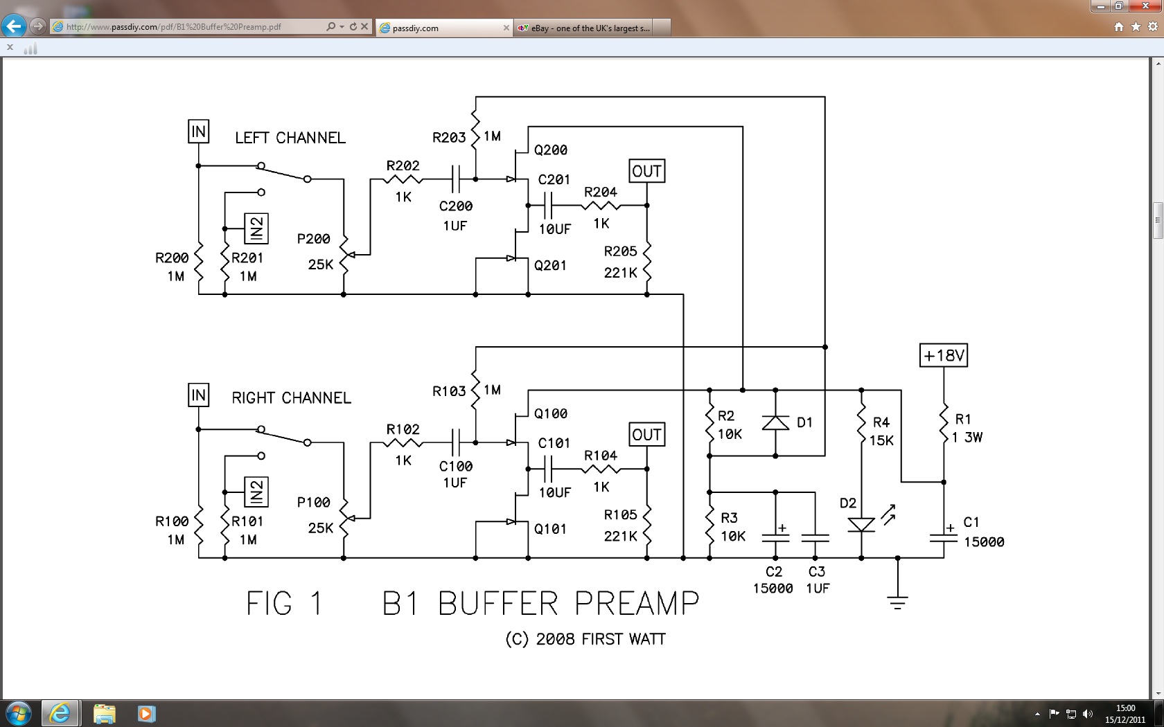

Has anyone tried to clone the diagrams that Nelson has posted on the PassDIY site ?

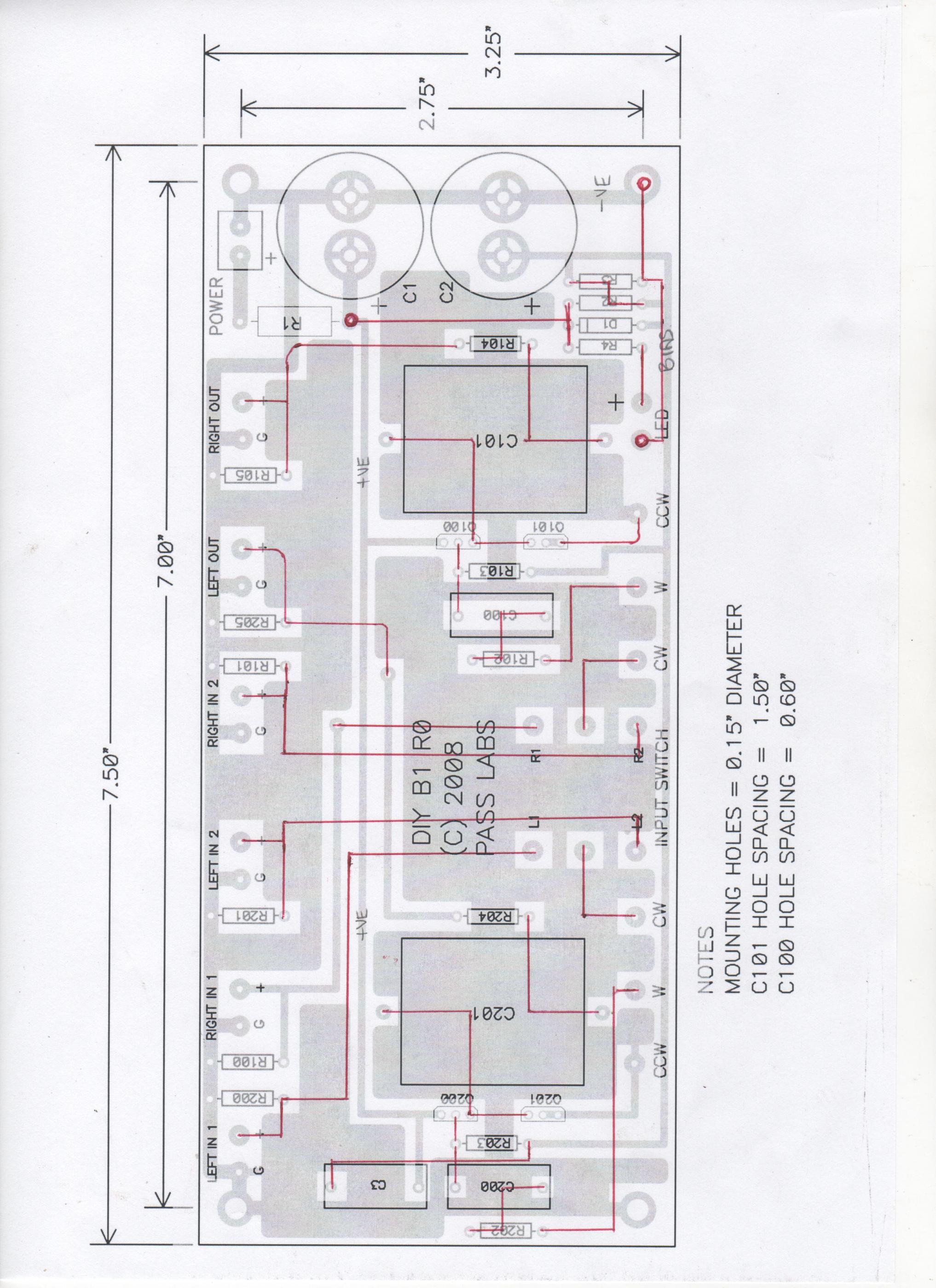

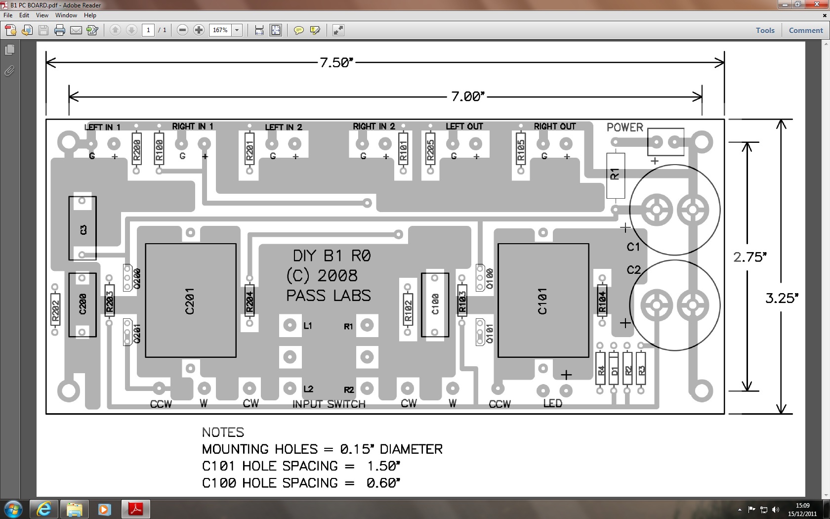

If you look carefully there is a discrepancy between the PCB layout and the schematic.
On the schematic C3 is connected between 0V and Vcc/2.
On the PCB one end of C3 is connected to Vcc.
Which one is right ? Should C3 be across C2 or across D1 ?

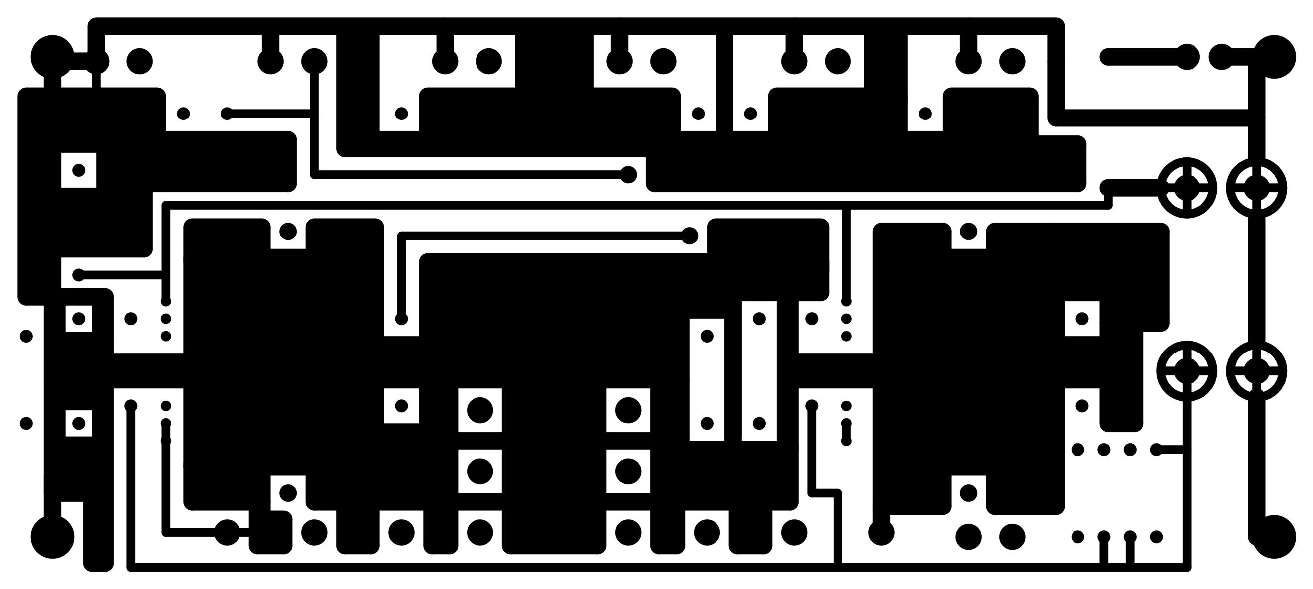

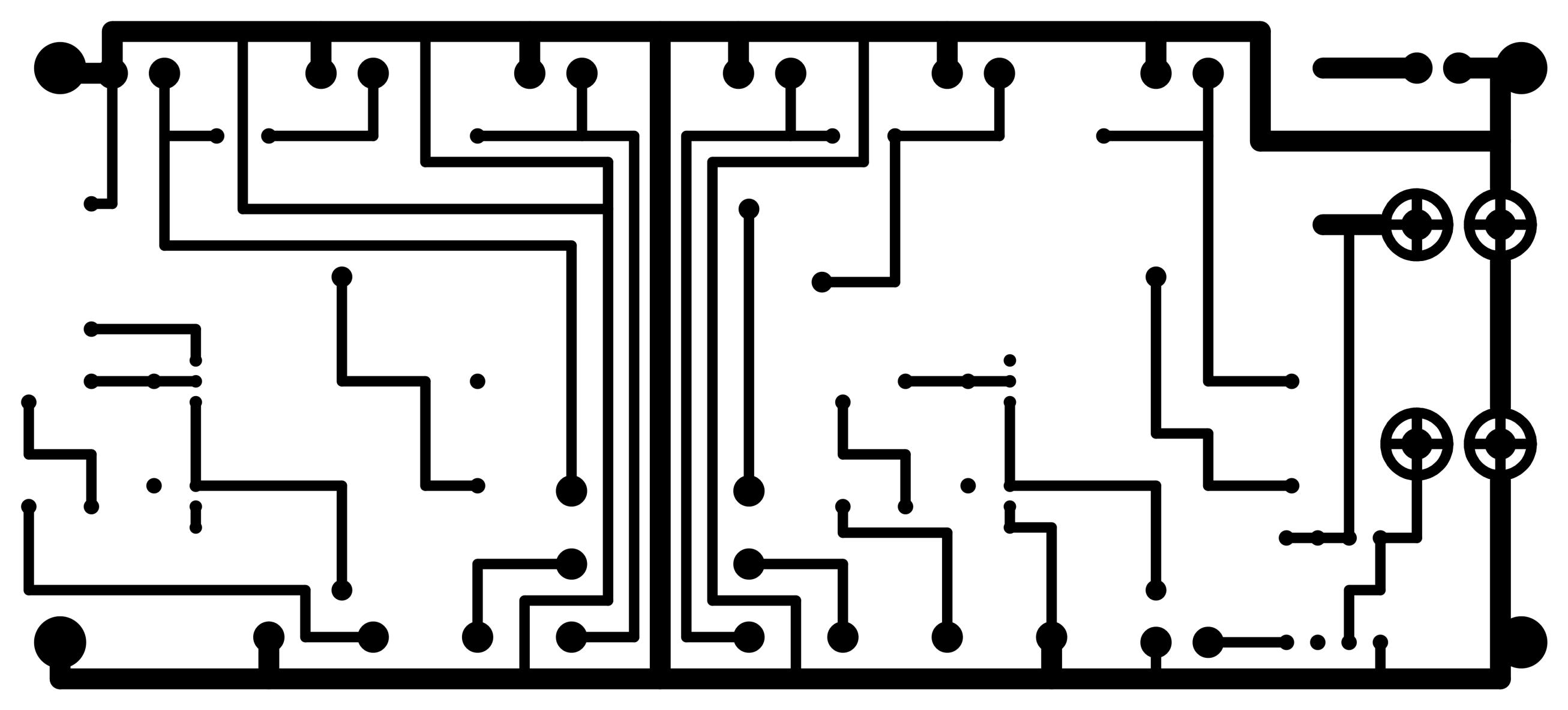

The plot thickens.
Using a Gerber File Viewer it would appear that Nelson has connected C3 across Vcc to GND.
There also seems to be a few possible places where GROUND loops could occur.
