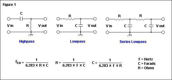

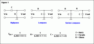

A high pass (HP) filter (blocks DC and attenuates low frequencies) is series C followed by R to Signal Ground (SG).
A low pass (LP) filter (attenuates high frequencies) is series capacitor followed by R to SG.
Your Power Amplifier should have both. So, expect to see Series R+ series C, followed by R//C to SG.
Now pick out the HP components and pick out the LP components and calculate the component values for the required passband.
I think Andrew meant a series resistor followed by a capacitor to SG.

I'm still trying to figure out what a smaller or larger value for C100/200 would do to the frequency response. Following the signal, I see a 25k pot to signal ground, followed by a 1k resistor and a 1uF capacitor in series. Can I conclude that this is a high pass filter with a cut off frequency of about 6.4Hz? And by raising the value of C100, the cut off frequency would be lower? (1.9Hz for C100=3.3uF)
Yes, as pointed out C100 R103 form a high pass filter.
There is no low pass filter in the B1. RF is fed in and the buffer has to cope with it.
F-3dB of the HP is ~0.16Hz & F-1dB ~0.3Hz.
If the effective Zin of the actual jFET were also 1M @ very low frequencies, then the F-1dB would move up to 0.6Hz.
You could change C100 to 100nF for F-1dB ~ 3 to 6Hz.
Whether you could hear any change in the low bass can only be tested by listening. Measuring will simply confirm that >20Hz has <0.05dB of change.
100nF Teflon might sound better than 1uF MKT, in the rest of the audio spectrum. Again listening is the only way to tell.
