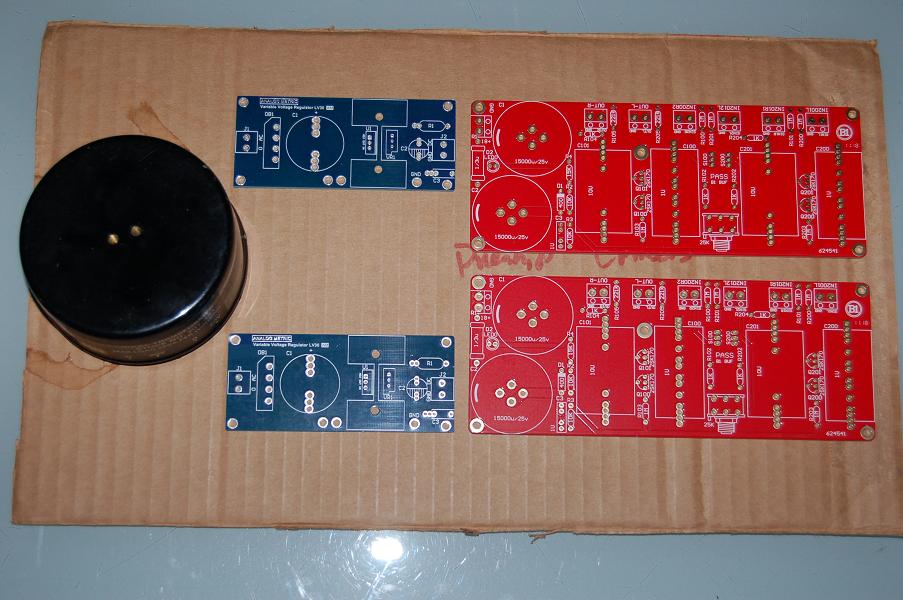

The stock value of 15,000uf is there so the original PCB can be used with an unregulated supply, such as a wall-wart.
If you have a regulator, a smaller value cap could be appropriate.
Killing it in what sense, making it useless?
not useless but not as effective(?) I read somewhere the output of the regulator does not want to see a large capacitance. The large capacitance should be on the input side of the regulator. that's why I'm asking.
Mr. Pass says anywhere between 1000uF to 15,000uF so there is a good reason for the wide range. justed want to know why.

the B1 has only 2 active devices in each channel.
It does not need a regulated supply.
Just follow Pass build instructions.

Yes, no real worries about values. It's not that critical. With the items you mentioned, I would use 4700uf in each position - the 2 filter caps on the regulator board (but remember to use the film caps as specified the the 317 datasheet, and 4700uf on the B1 board. (in lieu of the 15000uf)
That said, you could save a bit of money and use 4700 before the regulator, and 1000 downstream, as well as 1000 on each of the board positions.
Remember to look at lead spacing ( to be sure they fit on the pCB) before you buy filter caps.
I used 6800 on my build mainly because that was available at the surplus store. It works fine and is dead quiet.

What about ripple and noise on the rails? Can it be worse to utilize the precision series regulator(with high quality bypass caps) than just a bridge driving generic 15,000uf caps??

Exactly. You are most certainly not going to make anything worse (in fact, probably the opposite...) with a regulated PSU. Plus, you will like it more, and it has the added satisfaction of your project being made the way you want it. Which is very important -- it's why many of us do the DIY thing. 🙂

When we all started building these a lot of us used wallwarts. Yeah, I said it.. wallwarts. Then a few guys started using Lm317 and other adjustable regulators. That's how they found that some voltages sounded better than others. I don't think anyone left out the big cap. Why not do both?

I used the 15000uf caps prescribed by Mr. Pass. I will try to post a few pictures latter.

Thanks for all the input. I'll go with my largest caps: 4,700uf caps(Nichicon KG type, bypassed with a B.G.NX/HQ 0.47uf) on the B1 board. Then I'll be using a B.G. FK 100uf(bypassed w/ B.G. 0.1) on the output of the LV30 regulator board. ok4me.
