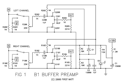

I'm trying to understand the function of the capacitors C100/C200 in the original B1 diagram. Mr. Pass states in his article that 'C100 and C200 are there because the Gate of the JFETs needs to be set at 1⁄2 the DC voltage of the power supply'. But as far as my basic knowledge lets me understand it, according to Kirchoff's laws, there must be some DC current flowing back from the JFETs to P100/P200 and to the inputs, and C100/200 prevent this by blocking this DC current, is that correct? But how exactly do they provide for 1/2 of the DC voltage at the gate of the JFETs? What happens if the value of C100/200 is changed (higher or lower?)
Another question: I see a resistor (R102/202) and a capacitor (C100/200) in series between P100/200 and Q100/200, so I'm thinking this is a nice low pass filter between the signal in and the buffer, with a cut off frequency of about 150Hz. Of course this must be wrong😕 Where did I go wrong?

C100 blocks DC and passes AC.
Look at the quiescent operation where there is no AC signal to pass.
Imagine that all to the left of C100 is removed, because it has blocked the DC connection.
The gate is insulated from the Drain and from the Source. The Gate is effectively only connected to that 1M (R101) and then on to the junction of R2&R3. Since that Gate in sulated from Darin and Source no current can flow to the Gate through R103. This "no current flow" requires that the voltage at the Gate is exactly the same as the voltage at the junction of R2&R3.
Th,
look at what R2&R3 are connected to. The top is connected to V+ (+18Vdc), the bottom is connected to Audio and Power Ground (0Vdc).
the two resistors are the same value so the resistive ladder they form ensures that the junction sits at half Vsupply. We have (very) effectively biased the input jFET Gate to half the supply voltage.
Isn't the capacitor, C100, supposed to act as a High Pass filter, or is it C101 that has this honor (i.e. to adjust the high pass corner frequency, is it C100 or C101 whose value we select)?

The B1 is not a crossover.
Basically C100 is there to make sure that any DC from the input doesn't make it to the FET, and C103 insures that any DC from the power supply isn't found on the outputs. You need to keep those values the same as the schematic.

Right; however, isn't a circuit which has a high pass response, in effect, a high pass filter? I'm not looking for a low pass here(my woofer already has one).
it's not a schoolbook high pass filter since the mentioned 1k is in series with the 10uF cap, forming a voltage divider with the real R, the 221k resistor. Assuming 10k input impedance of the power amp, one gets 221k||10k, so essentially 10k. Using these values one obtains a corner frequency of 1.6 Hz
I'm just trying to verify from one of the experts here how to determine which capacitor(is it C101?) and how to determine the needed value for say, a 75Hz, 100Hz, or 125Hz corner frequency. We need to know the input impedance of the power amp, obviously.
Is this not possible (or is it detrimental to the function of the B1 circuit)? 😕
