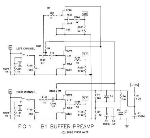

B1 Buffer Preamp
What I mean is: better thinking about using something like this (only left channel shown) :
to avoid any impendance problem with two amps connected to the buffer?
Thank you, guys!

simply add a R104 for an extra output. Similarly add an extra r204 for the other channel.
You now have two outputs each with an output impedance of ~1k0
Thank you very much, Andrew!
Simple and effective!🙂

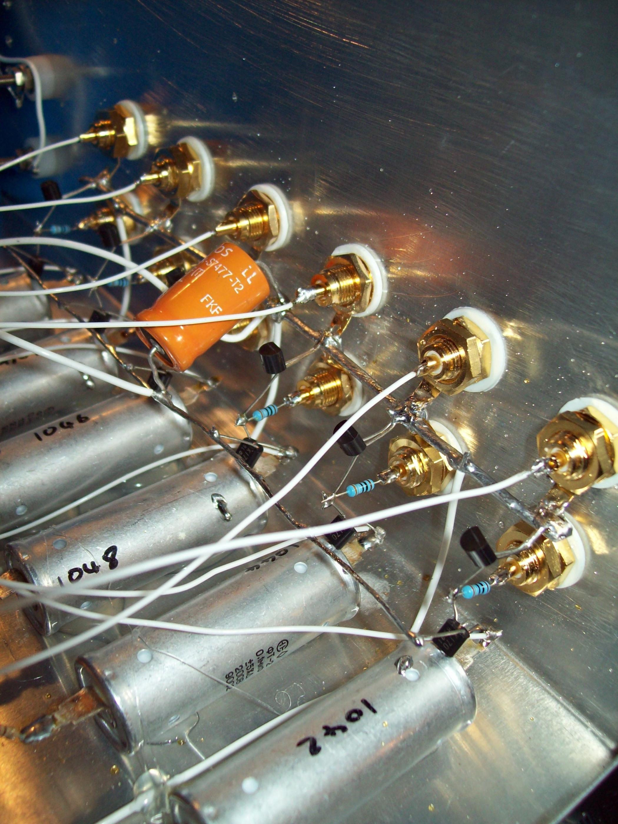

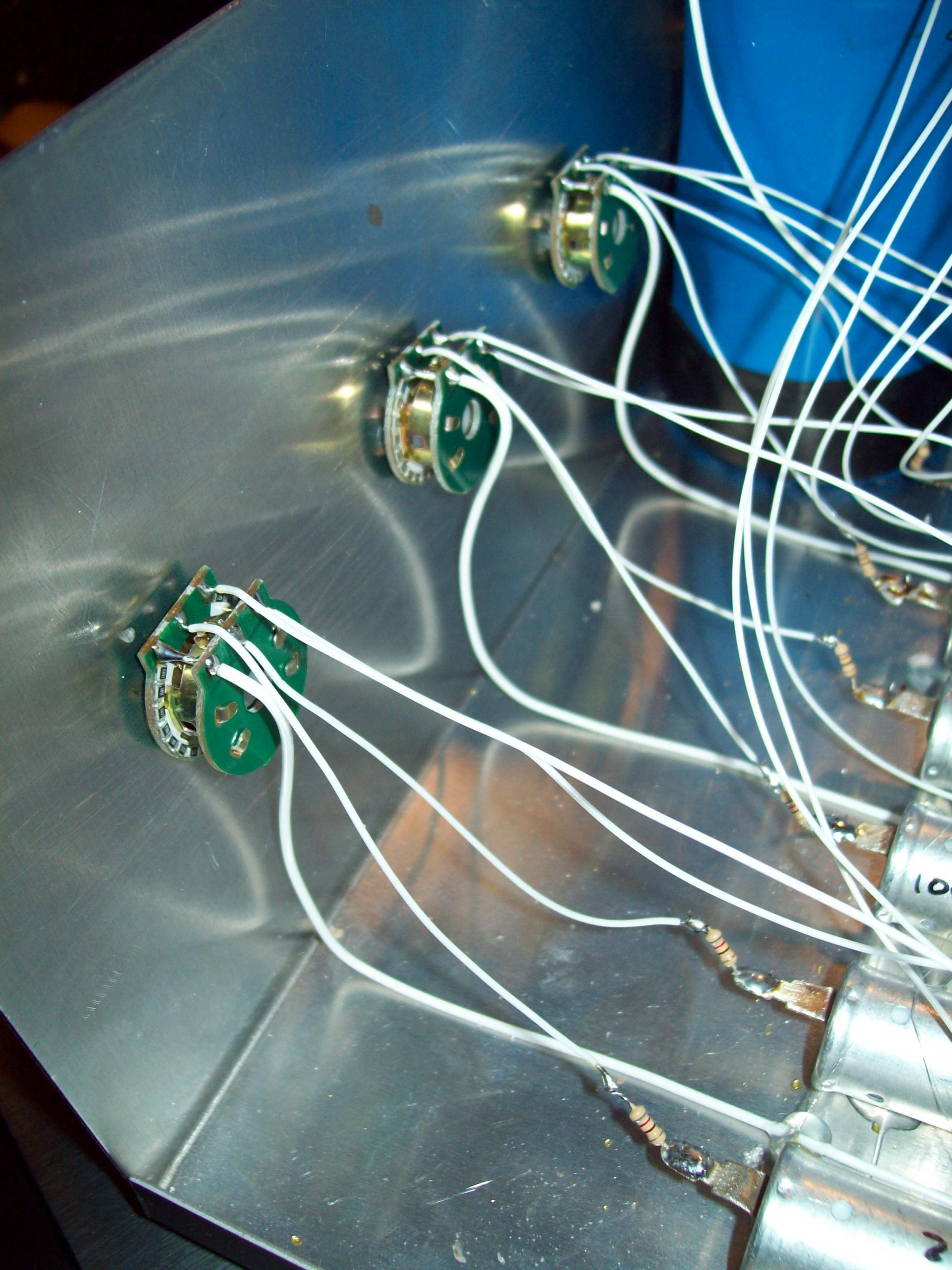

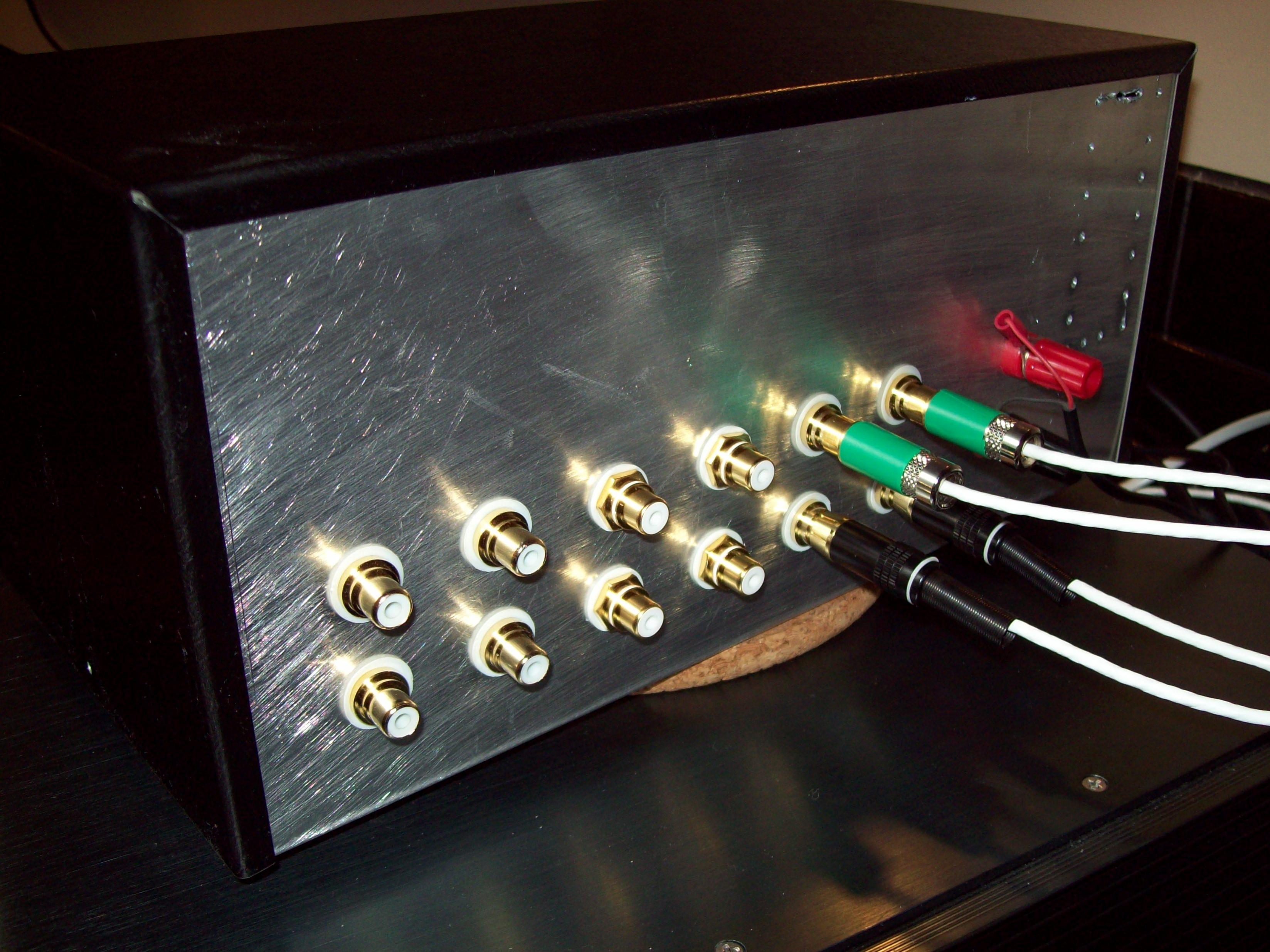

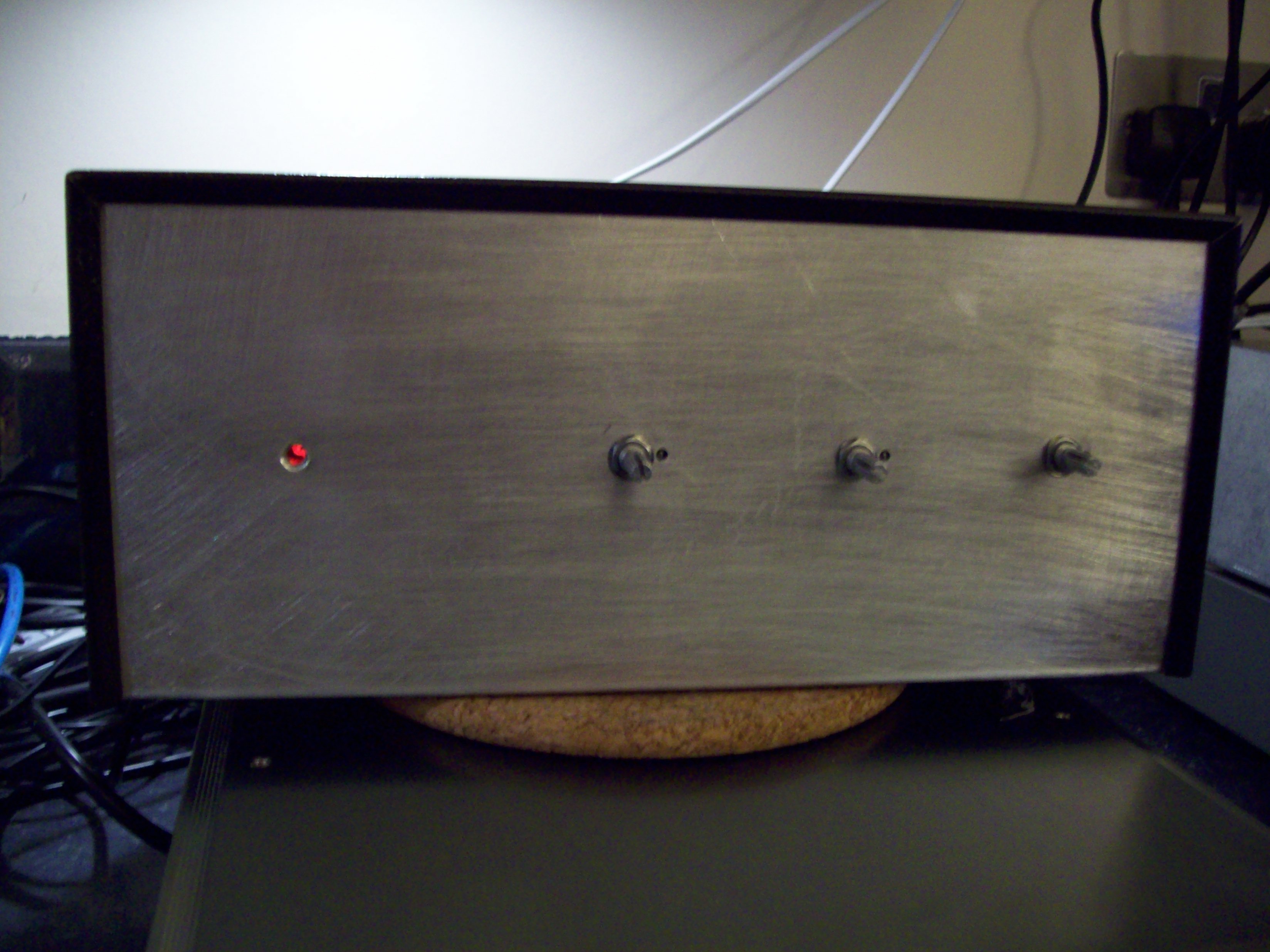

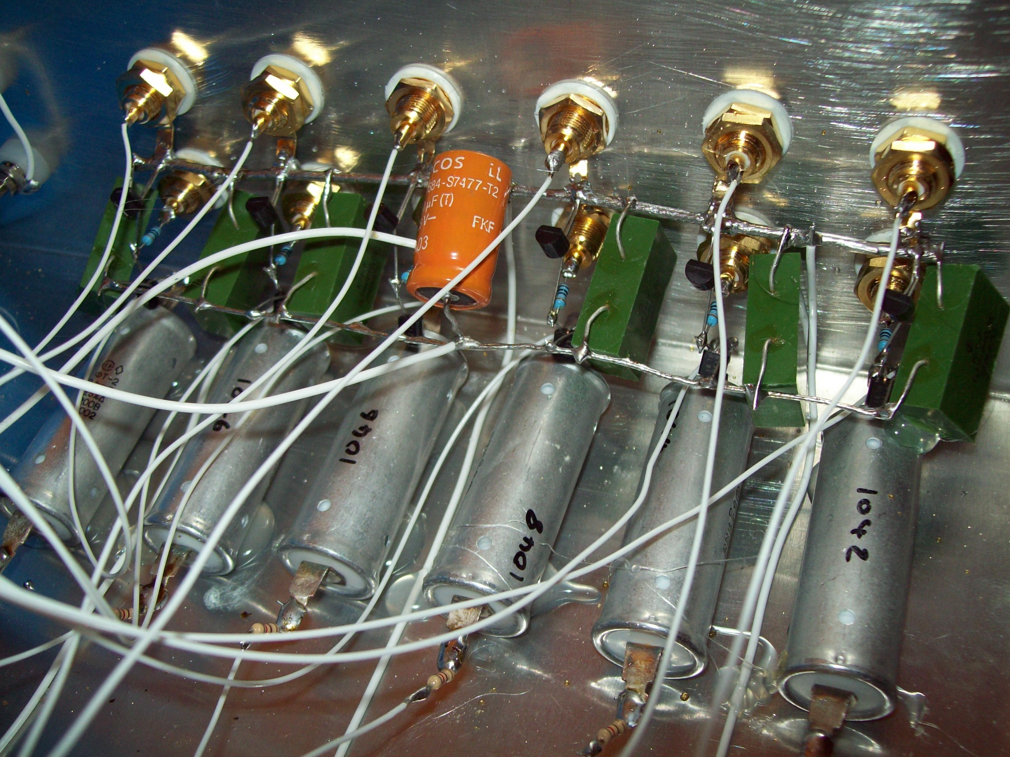

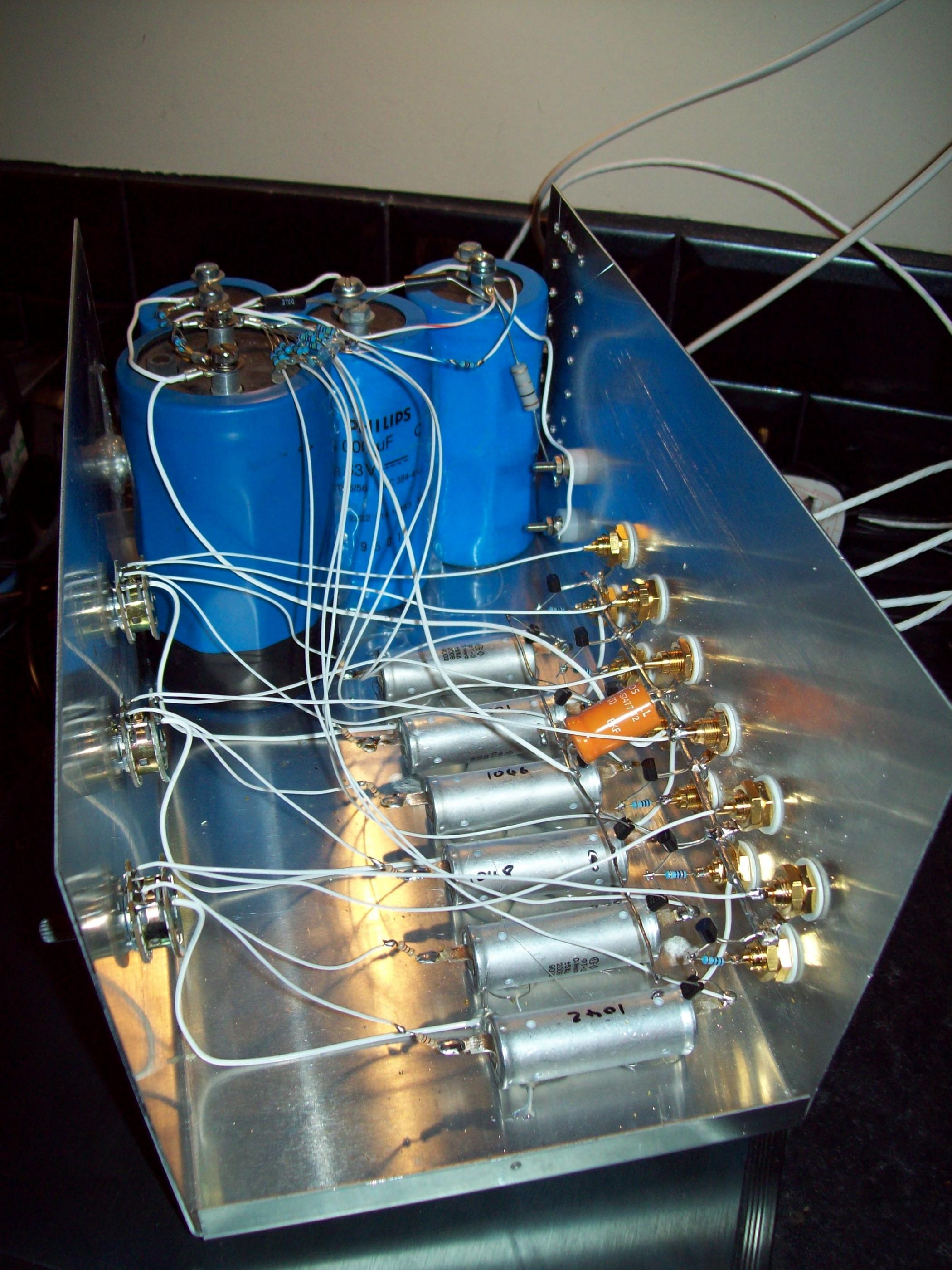

6-channel B1 buffer preamp
Just finished my 6-channel B1. All running from one PSU. Input caps 0.1uF teflon and no output caps (I have settled on fitting input caps only to amps and preamps, as you know exactly what value of cap is required for the input impedance and avoid doubling up on coupling caps). Thanks Nelson 🙂
Yes, Yes. Design the DC blocking where it is needed and can be designed for. All else does not need extra DC blocking.

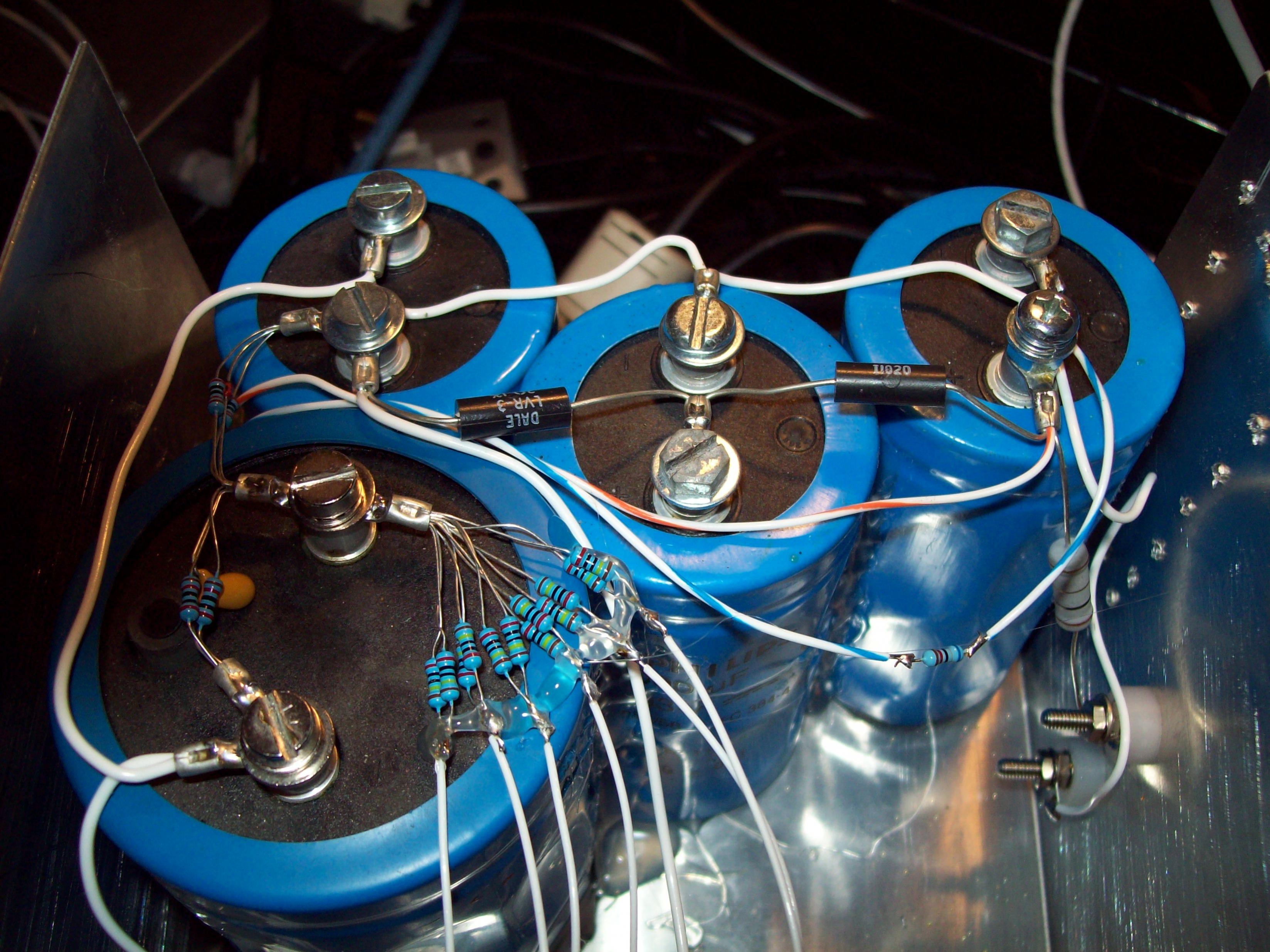

C1 is now 1ohm>150000uf>0.22ohm>15000uF>0.22ohm>15000uF and C2 is 68000uF. Takes about half an hour to get going though
......... you can run it disconnected for a while
I love the P2P mounted directly to the RCA/Phonos.
I even like the idea of plugging in half an hour before intended serious listening and then unplugging for the serious relaxation time.

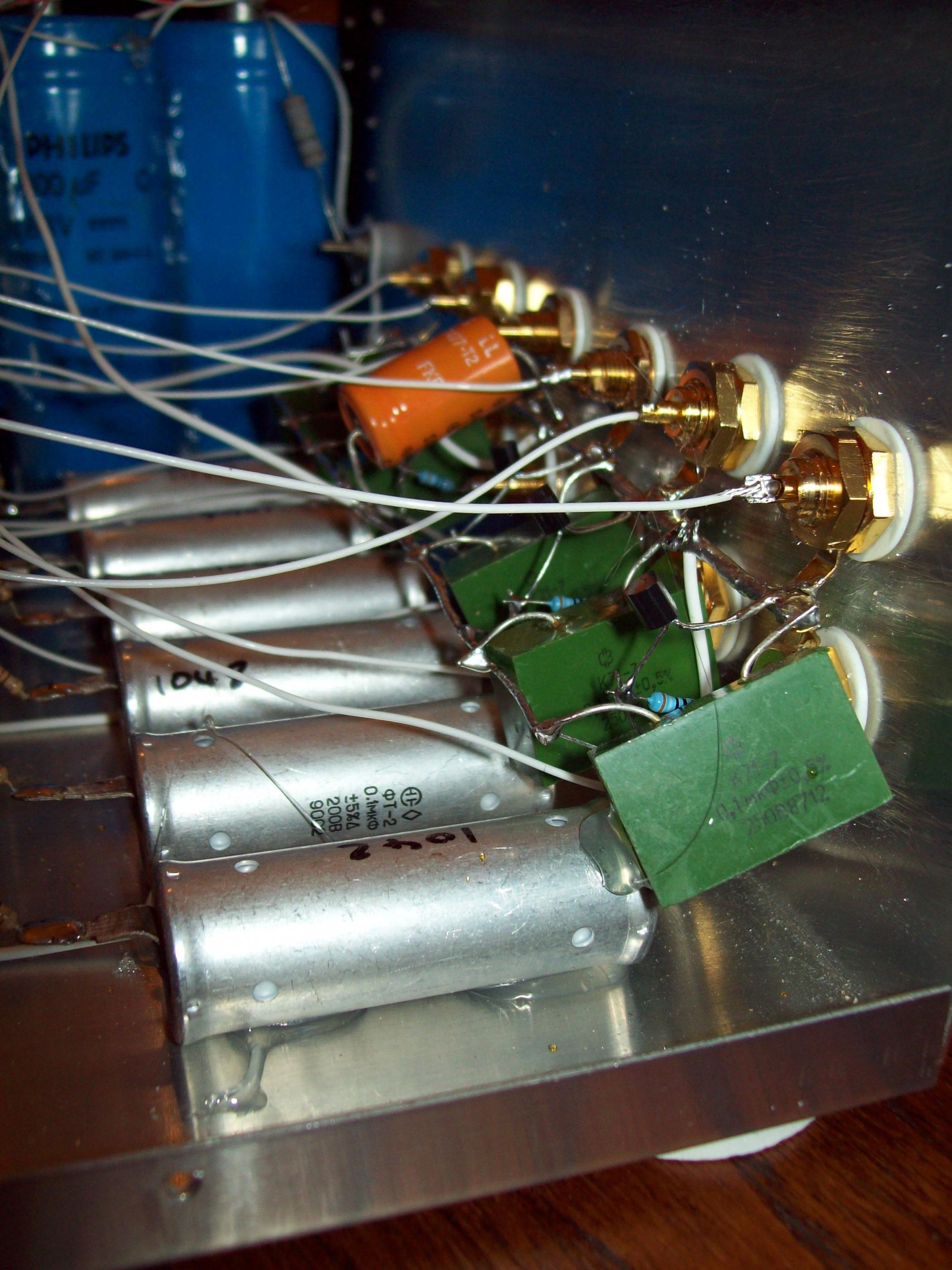

Verry interesting, and nice job.....how do you intend to use it? In a multi-room setup, or maybe for surround?
Thanks guys. Not the neatest build but does the job. It's been powered on continuously since I first posted (still not installed bypass caps across each pair of fets, but will do this at some point). I disconnected the cheap 18V switch mode power supply I used initially and connected up a regulated linear supply of 24V 500mA - the swap took a minute or two but the preamp kept playing throughout 🙂
I forgot to say that I used matched (within 2%) pairs of 2SK170 fets - actually three sets of matched quads (to give me three pairs of matched channels).
A while ago I modified a DCX2496 with Jensen output transformers (standard active output stage completely bypassed). I plan on using this with a DEQ2496 (due any day) and SRC2496 (as digital source selector and upsampler) to give me a 2x3 way digital crossover solution. I've also built 6 channels of TK2050 power amplification (one stereo amp using Arjen Helder TK2050 mono boards & one quad amp using Sure TK2050 stereo boards - both amps use higher grade Meanwell 24Vdc SMPS). The 6 channel B1 completes the system and will allow me to play with 3-way speakers in the future (I use 2-way Martin King open baffles right now with mono sub - the system will cope with these too).
Just added 6x 0.1uF Russian polystyrene caps across the voltage and ground rails (one beside each transistor pair). Don't hear any immediate difference but I'm still listening with a pair of old speakers in my kitchen (and it will probably take 15mins for voltages to settle after power was switched back on).

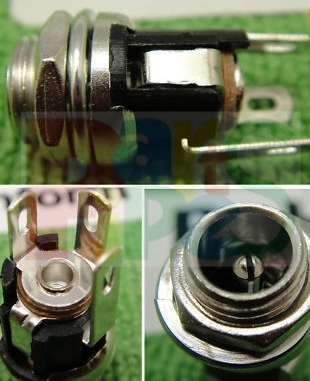

I bought one of these DC Panel mount jacks off ebay.
When measuring at the pins on this DC jack, the neg or gnd return
is shorted to the chassis. It looks like it is by design.
Is it safe to use this DC jack since it ground return would be through out
the chassis?
I could not locate one that has all pins isolated. Do you know of one

Whether it is safe or not is relative to the way you setup everything. If you want to isolate both conductors here is one possibility as there are a lot of jacks that are similar to the one you showed us.
KPJX-PM-4S-S Kycon DC Power Connectors
Eric
