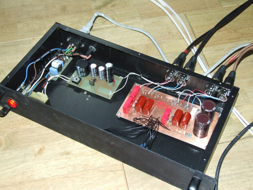

Well the B1 is built and under test.
First impressions are that it's not as bright as the Pumpkin.
It is ever so easy to DIY and is absolutely silent in operation, something that I cannot say about my Pumpkins.
I eventually used a single Capacitor Muliplier PSU to supply the B1 with just under 28V of clean DC.
I bought 4 x 2SK170 off E-Bay that were "supposedly" matched - they might well be. However, it's just "out-of-the-box" and it works splendidly.
All I need is a little bit of gain between my Arcam CD36 and the Aleph 4, and obviously a bit of volume control as well.
I haven't given up on the Pumpkins yet but they are proving to be disappointing.
The black wires that you can see in the foreground are to the toggle switch and the volume control. I dont want to spoil the case until I have made my final decision on the design.
