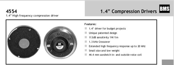

..and BMS doesn't have any HF drivers with exit larger than 1"
The 36mm (1.4") exit BMS 4554 is larger than 1":
oh snap. i only looked at their neodymium drivers because i generally only look at neodymium drivers. the ferrite magnet adds extra length to the throat so the same driver that is 1" in neodymium version ends up being 1.4" in ferrite version with the extra throat expansion. it's not a true 1.4" driver though because the same exact diaphragm is also used in 1" drivers.
Any size diaphragm truly can be used with any throat size, the BMS 4554 happens to use a 1.75" (44.4mm) annular ring diaphragm in that driver.
If it were a 1.75" dome diaphragm, it would be capable of far more clean output at a lower frequency, but not everybody wants or needs over 120dB at 1kHz.
