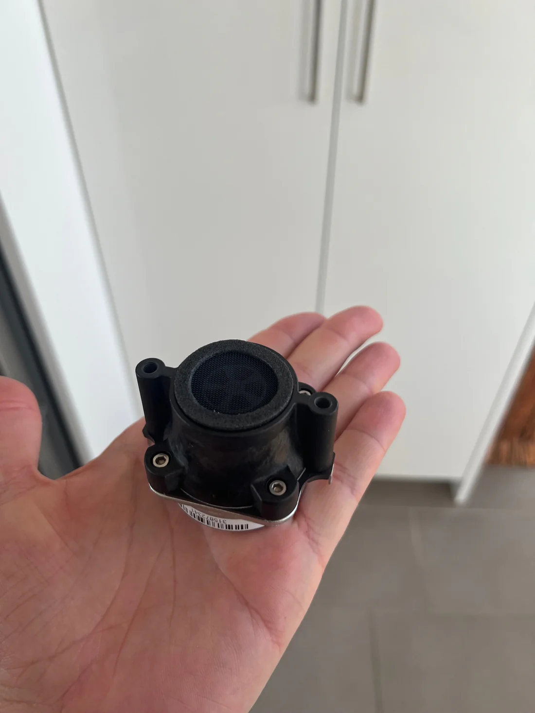

The 36mm (1.4") exit BMS 4554 is larger than 1":..and BMS doesn't have any HF drivers with exit larger than 1"
oh snap. i only looked at their neodymium drivers because i generally only look at neodymium drivers. the ferrite magnet adds extra length to the throat so the same driver that is 1" in neodymium version ends up being 1.4" in ferrite version with the extra throat expansion. it's not a true 1.4" driver though because the same exact diaphragm is also used in 1" drivers.
Any size diaphragm truly can be used with any throat size, the BMS 4554 happens to use a 1.75" (44.4mm) annular ring diaphragm in that driver.it's not a true 1.4" driver though because the same exact diaphragm is also used in 1" drivers.
If it were a 1.75" dome diaphragm, it would be capable of far more clean output at a lower frequency, but not everybody wants or needs over 120dB at 1kHz.
the point is BMS doesn't have anything that can go head to head with the D2, even if JBL borrowed a few ideas from BMS.Any size diaphragm truly can be used with any throat size

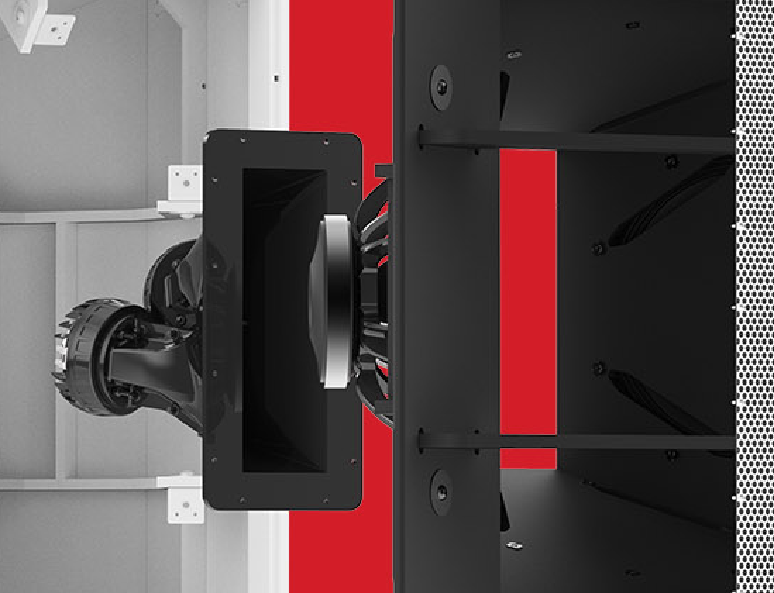

When it comes to the arrays they use 3xD2430 /3xD2415 in multiple entry waveguides on some.
Some still use 243x family drivers.
The D2415 is also in the 4349 fx.
D2's in M2, 4367 also etc.
The most recent is the D2423K which is used in a few smaller arrays, 1" exit, special design. I guess that is what the original DA2420 concept driver turned into.
