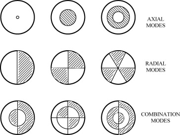

any corrugation will stiffen the material in one direction and soften it in another. speakers have both radial and axial breakup modes:
for radial modes indeed the ribs will stiffen the cone but it is axial modes that are dominant.
the "ribs" on a woofer cone are really accordion surround rolls that have partially migrated to the cone. whereas surround is used to decouple the cone from the basket the "ribs" decouple inner parts of the cone from the outer ones strategically to break up axial modes. this optimizes both frequency response and off-axis response because now the center of the cone can act as a smaller speaker at high frequencies.
but this does in fact reduce cone stiffness, which is what i meant by "soft cones" ...
of course that was trolling speak. they are simply cones optimized for wide bandwidth operation, whereas a cone without corrugations would be stiffer at low frequencies but have potentially deal breaking behavior at higher frequencies.
I agree with your analysis here, and stiffness in the axial mode direction is enhanced by means other than concentric ribs. This can be thickness/stiffness of the cone material, cone profile shape, size and placement of the dustcap (to a lesser extent on a large cone), or something else.

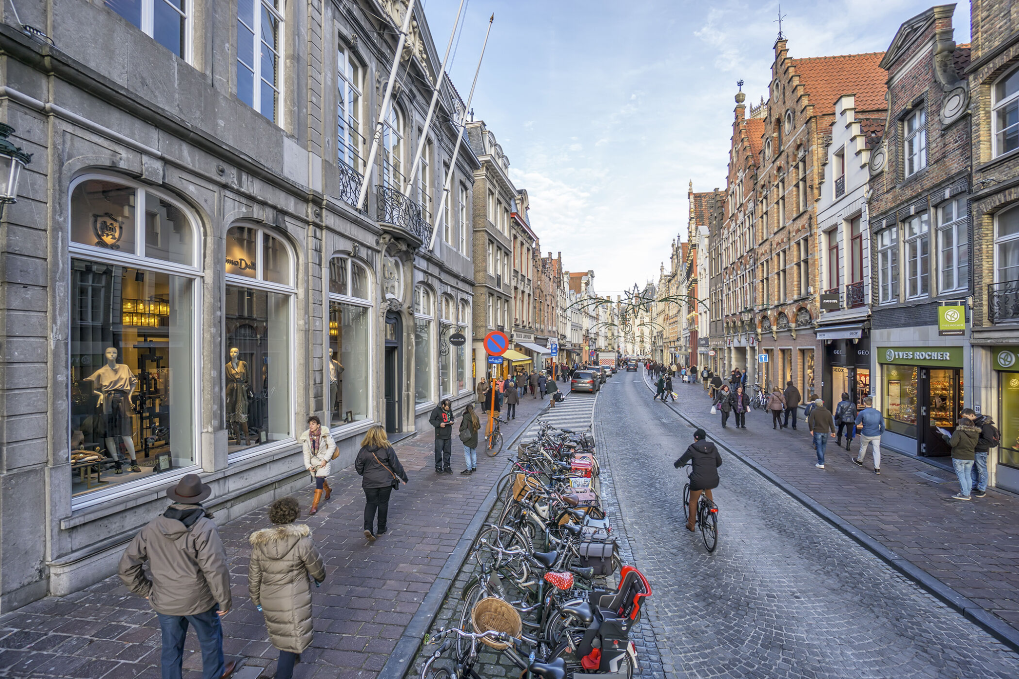

Even (relative) old American cities have way bigger streets than our old, often medieval city centers. This is the Steenstraat (Stone Street) in the center of Bruges, and that is one of the main streets in the center. Most American cars don't fit in here. Sidestreets are even smaller.reality is our most popular vehicles like Ford F150 Truck are too big even for our own cities in America - that's why most Americans live in suburbs
i drive a mid-size sedan but even for me as soon as i get out of the city i breathe a sigh of relief to finally have wide straight roads
the truck guys don't even bother driving into the city
this is also why American cities are dying - because anybody who is able to leave them - does so
the oldest, most densely built cities like NYC, Chicago and San Francisco are hit the hardest.
and the fastest growing cities are the ones that are all highways and sprawl like Orlando.
Most travel even by foot or bike in the city center, because even with a smaller car like the one i drive now (BMW 1 series) it is tricky to move around. Big American style cars can't move in here and often got stuck while trying to turn into an other street. Most parking spots are also to small for those cars so they need to take several spots or find a large place to park (mostly truck spaces). Villages, also often centuries or even millenia old (i near in a hamlet that is inhabitated at least 6000 years now), have often even smaller streets.
You can't change the street here in Bruges and many other places as most buildings here are historical monuments and listed and protected. Many in Bruges of them are build before 1500AD actually and got renovated over the centuries to their actual form. And this is not only Bruges, this is almost any historical city in my country (and most cities are quiet old). Bruges goes back to about 100BC (as far as we know), when it was a small harbor called Bruccia (Germanic) or Bryggia (Belgic Celtic) used by local (mixed Frissian/Saxon Germanic/Belgic Celtic) tribes to trade with the related Britonnic Celts in the UK. These streets were not made for cars, and the city is not adapted at all like American cities for big vehiclies, as they did not exist when the city was build millenia ago. Even horse pulled cars were rare at that time.
And those big american trucks are the only one that are a bit popular here by some drivers. But taxation is very high for such gas gugglers and they are not allowed to come in inner cities like here mostly as they are to big, heavy and have emissions that far exceed the local limits. You mostly see them also on the countryside, not in cities. The most sold European car in the last decades was the Volkswagen Golf, as that is the perfect size for our roads.

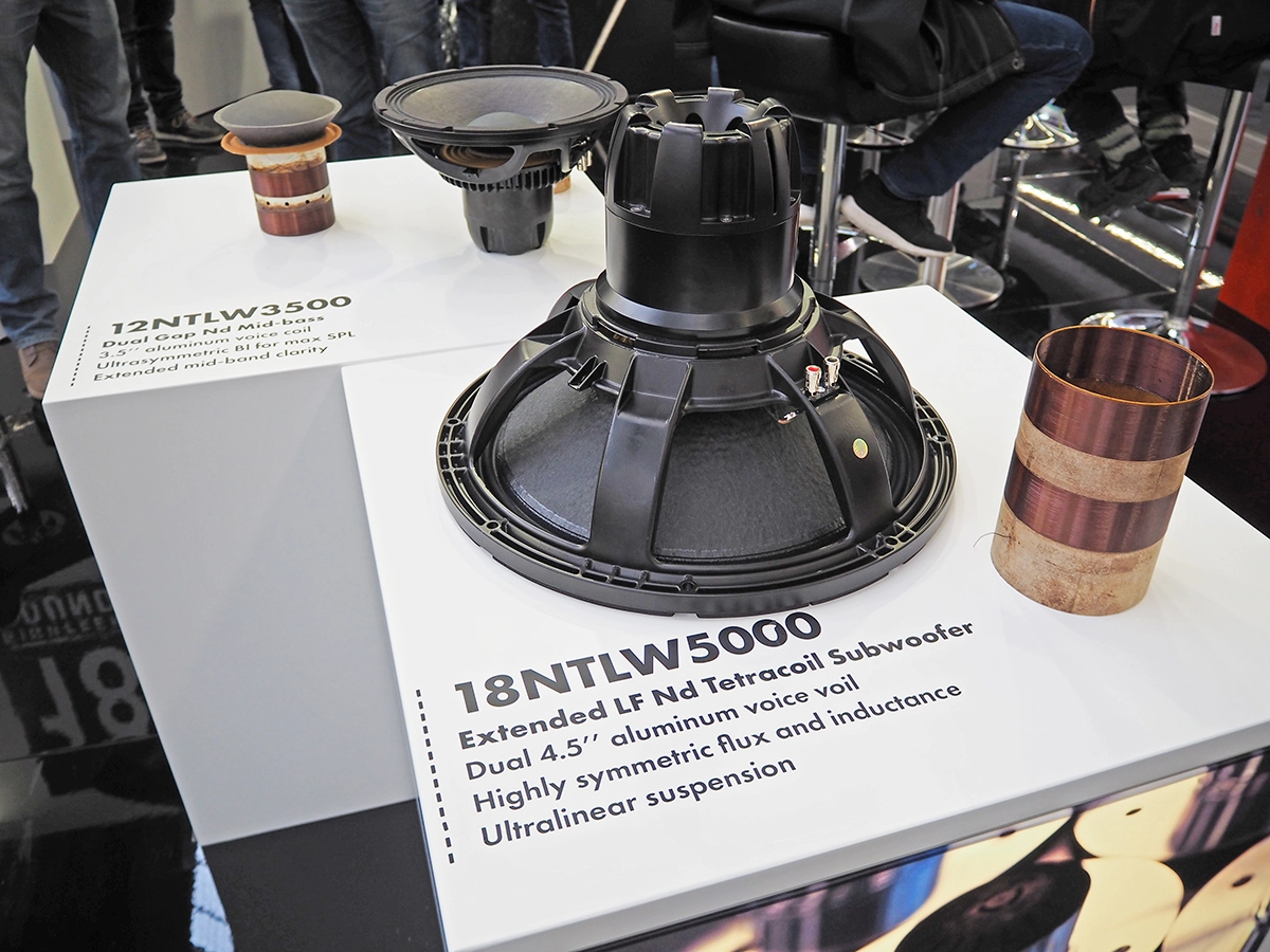

The Ipal has only slightly better performance/weight ratios than the old JBL 2269 or newer 18sound18NTLW5000.for any speaker that is hanging up in the air over the crowd i would want it as light as possible.
The B&C18SW115 weighs slightly less than the 18NTLW5000, slightly more than the 2269, performance/weight of the three drivers quite similar. New JBL 2269 do not appear to be available currently.
From a cost/performance ratio, the 18SW115 has around a 10/7 advantage, ten drivers for the cost of seven 18NTLW5000.

i am curious by what metric you judge "performance" ? B&C doesn't even list AES power on their spec sheets. i can only assume the AES power of their drivers is lower than "continuous program power" or they would list it.The Ipal has only slightly better performance/weight ratios than the old JBL 2269 or newer 18sound18NTLW5000.

anyway it seems 18SW115 and 18NTLW5000 are indeed almost perfectly matched in all aspects except price and depth, good job @weltersys
let me do some numbers side by side for these two drivers B&C / 18 Sound
power: 1700-3400 / 1800-4000
Re: 5.3 / 5.5
BL: 30.3 / 31.3
Mms: 275g / 295g
Xmax: 14mm / 17.5mm
Le: 1.9 / 1.85
EBP: 100hz / 96hz
Net Weight: 26.2lb / 26.46lb
It's uncanny how closely most of these match - good job @weltersys on coming up with a great apples to apples comparison - better than my comparison to the iPal for sure.
it seems the NTLW pulls away slightly in Xmax and Power handling, but not by a wide margin. intuitively you would expect NTLW to have a bigger power handling advantage since it literally has double the voice coils for heat dissipation, and they're the same 4.5" diameter as B&C:
but the cooling for both VCs is by the same air - that is when the woofer pumps the air through the VC gap the same air has to cool both coils, which means the total power handling is not double, but a more modest gain.
there is, however, one important spec missing and that is Xmech. an easy way to control the weight of a motor like in 18SW115 is by making it shallower which will cause the VC to smack into the back plate on long excursions but reduce the amount of iron required to make the motor. with Tetracoil motor no such compromise exists because VC travels all the way through the motor on both ends.
so NTLW5000 can work in the same subwoofer box as SW115 but has more power, more xmax and probably more Xmech while only weighing 1/4 pound more ... which means that if the total weight of the subwoofer system ( driver + box + rigging ) is say 150 lbs then with NTLW you're getting 10% more output with only 0.01% more weight ( 150.26 lbs vs 150.00 lbs ).
is this worth the difference in price of $700 vs $1000 ? well if you can get 9 flown subs to do the work of 10 then you're looking at $9,000 in drivers versus $7000 in drivers but you're saving about $1,000 on not needing an extra cabinet with associated rigging and the remaining $1,000 in price difference will be covered by not having to lug around that extra cabinet everywhere and constantly mounting and dismounting it.
so for a flown touring application the NTLW is worth it. for any other application that doesn't call for absolutely maximum power density it is a waste of money.
thank you @weltersys for forcing me go through this analysis. as a result i will no longer recommend NTLW5000 and 2269H for home use. instead for home use i will recommend what the guys on AVS already know - simply using more subwoofers.
push-pull motor remains king for flown touring application, which is what it was designed for.
