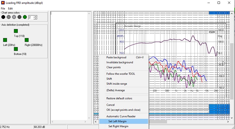

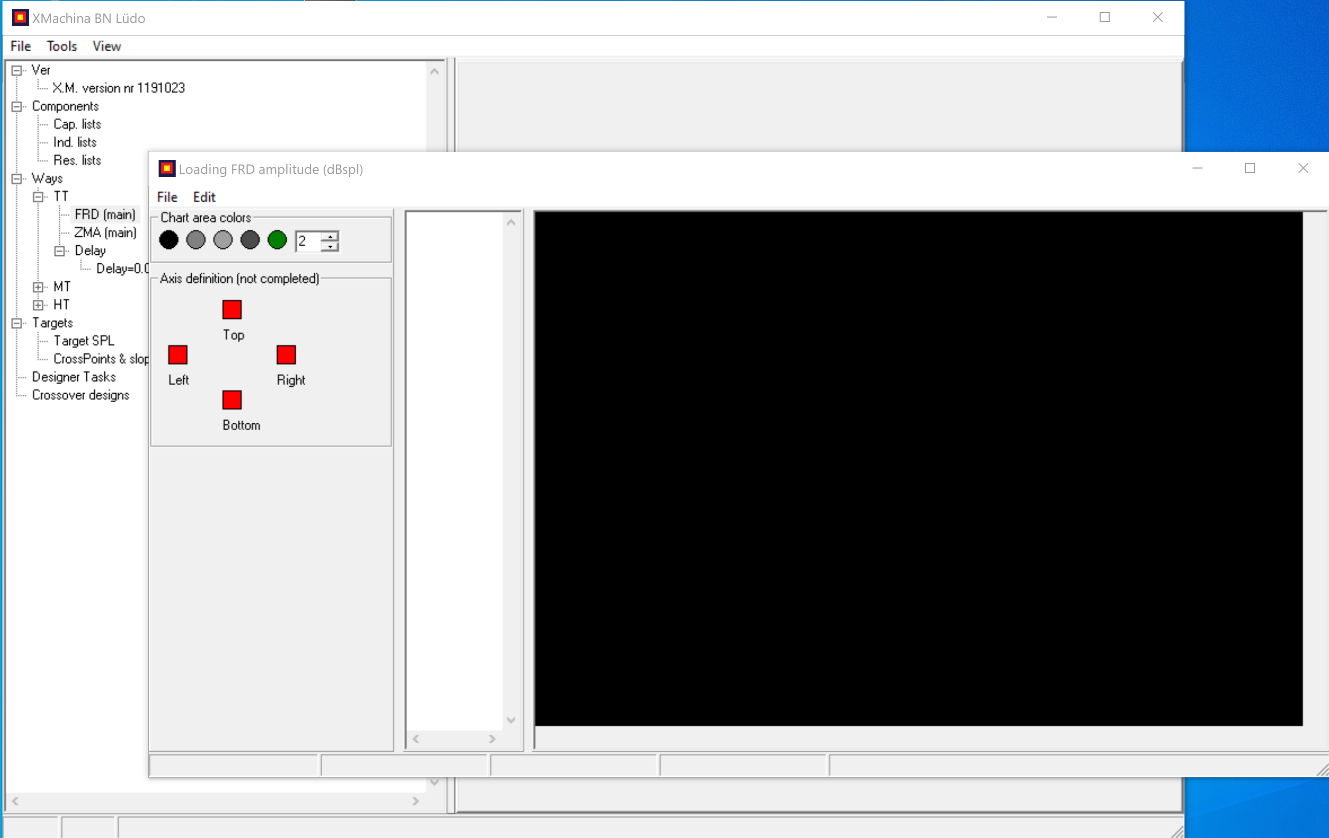

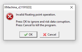

Hi, on my System (Win10, 20H2 last Build on Dell M3800) is something happen:

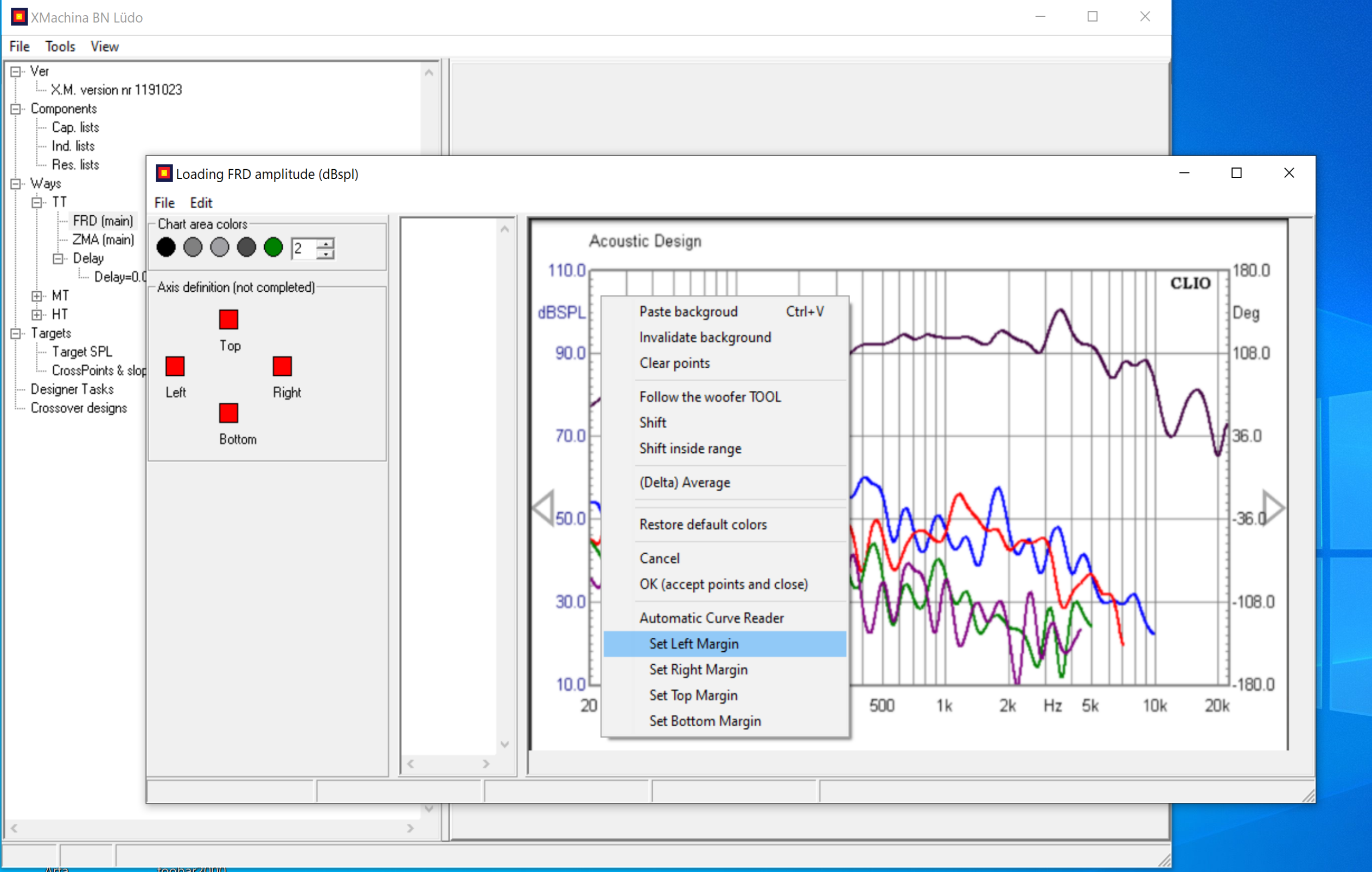

I select 'Load FRD from Picture', then the context menu with the right mouse button. The message in the popup box is followed and ... Yihaa .. a black screen appears. It's a shame because I have no idea what's going wrong there. Unfortunately the PDF is no help either.

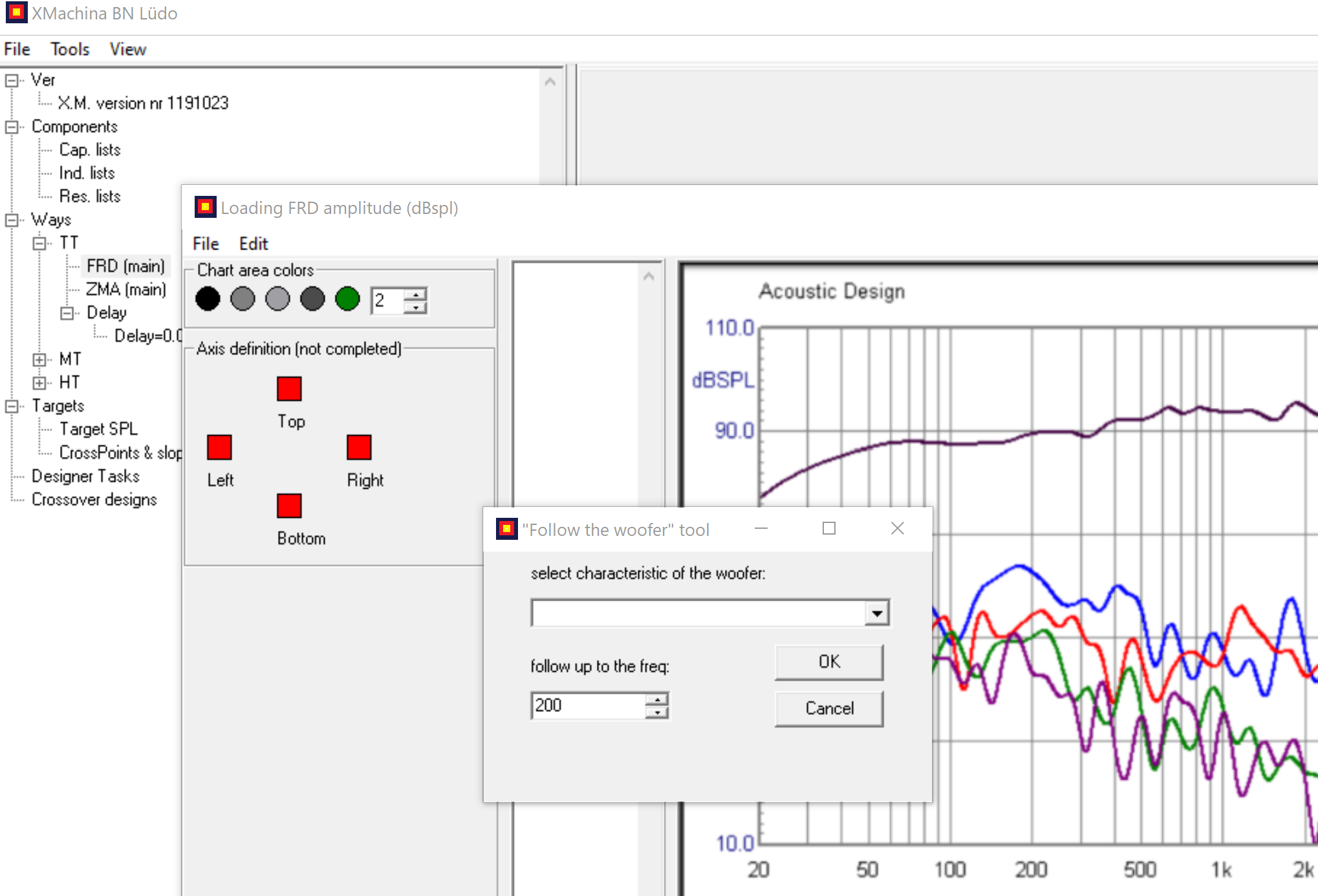

This is also the case with the woofer tool, here I don't know what is required, as it is also not available in the pull-down menu. (pls Look at the last Picture)

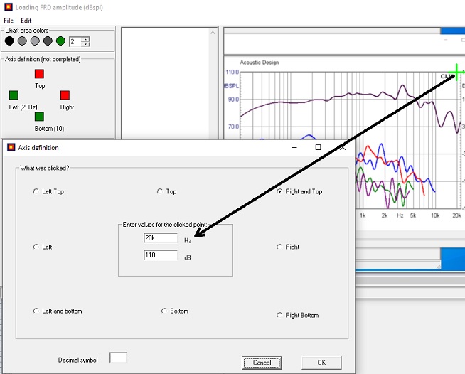

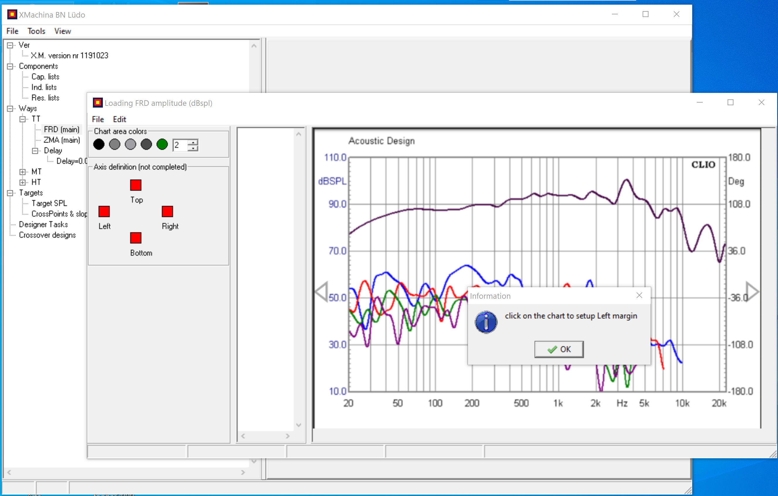

Strange. I'm trying to reproduce this effect in my system (also Win10) but I can't. Question: did the window went black when you clicked OK in the "left margin" message box or when you clicked your chart to define the margin? Or another moment?

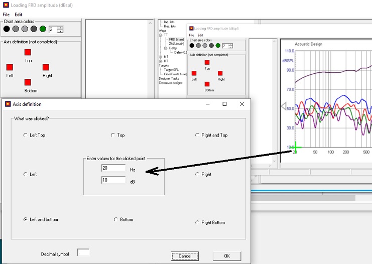

Just one thing that I noticed (which may or may not be related to the problem) is that your axes are undefined. Click a point on the chart and enter corresponding freq and dB values, for example:
attachment.php
Then click another point an do the same:
attachment.php
From this moment you can digitize the curve manually clicking on it.

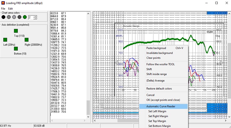

But if you want to use automatic digitization, first narrow the picture processing area on the chart with the margins (use the context menu) :
attachment.php
Choose "automatic reader" from the menu and finally click on the curve to get it digitized:
attachment.php
If you're satisfied with the effects, use "accept the points and close" from the context menu. Your curve will be transferred to the FRD node. (But if something went wrong with automatic reading you can select "clear points" from the menu and try again).

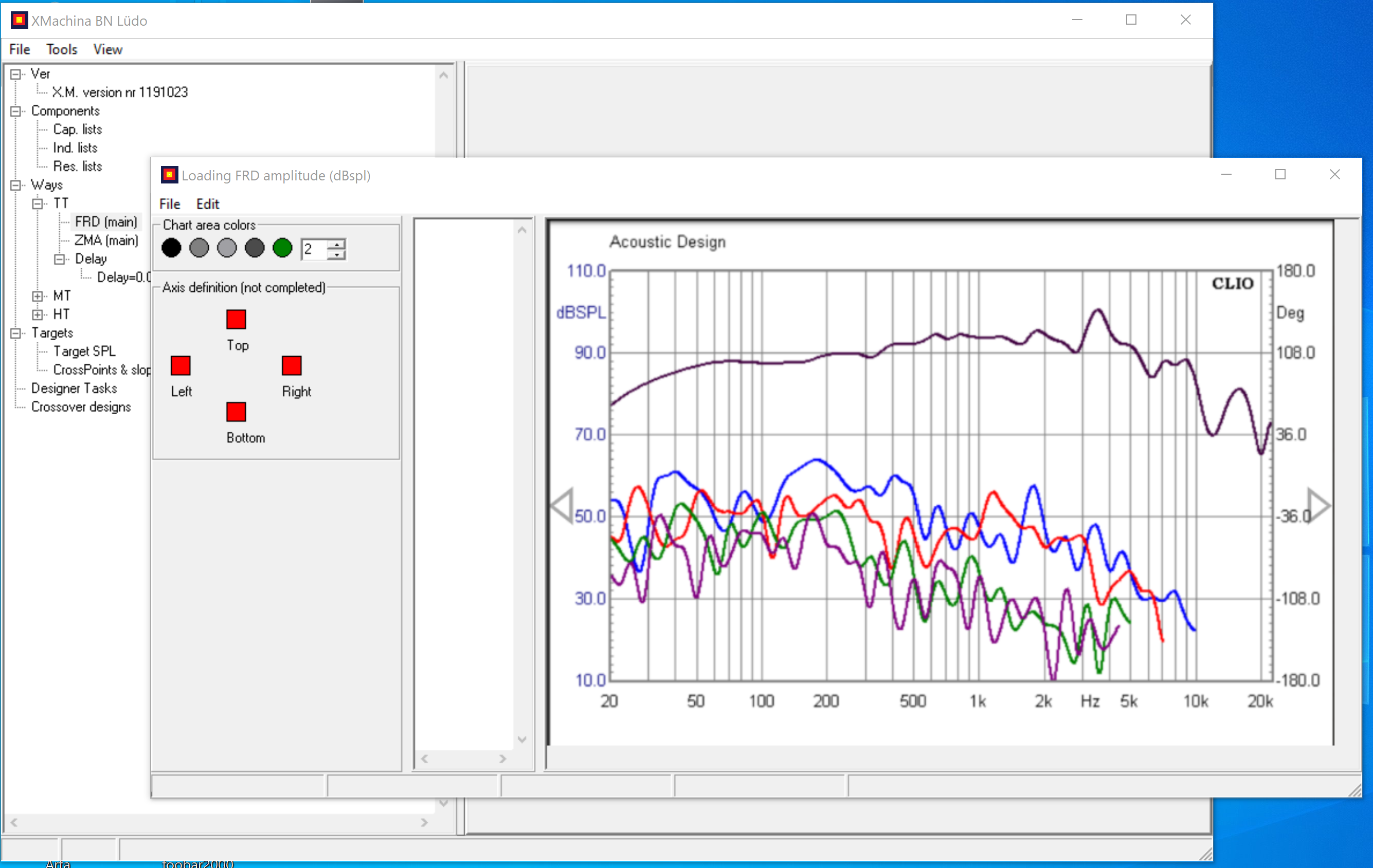

Hmm, my Win 10 is a 64-bit version.
Unfortunately, I can't even define the margin. When I open 'Load FRD from Picture' for the first time after launch and select and paste the .bmp, it is displayed as a picture. The directly following left click does not trigger a reaction, a right click brings up the context menu as in my 2nd picture. So I cannot define the frame, because the color of the Corsor-X does not go to 'green' either. As soon as I make a choice in the context menu, however, the image turns into a black area.
I close the window with 'X', open it again and ... again the black area.
The surface only turns white again when the application is completely closed. But then it starts all over again ...:verwirrt:
I would also like to know what exactly I have to do with the Follow The Woofer Tool so that I can go further, but that is the further construction site.:Ö

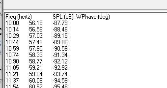

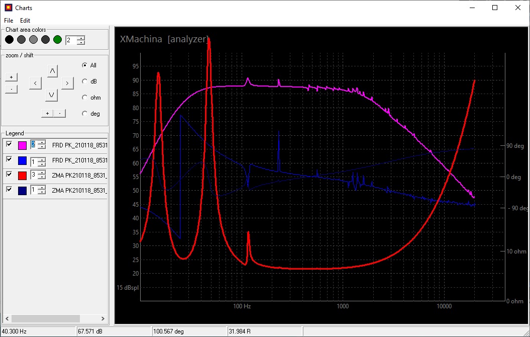

Hmm. Tried to import (space separated) Frd and Zma files. None of them worked. When trying the Frd filen from Hornresp i get this error message. And Yes I select that there is one header row, that the file is space separated and I take away everything from 10kHz because of a space problem.
Please attach the files you are trying to import.
64-bit shouldn't be a problem. My system is 64-bit too. Since I cannot reproduce the effect im my system I have to honestly admit that i have no idea how to help.
"Follow the woofer" tool is not intended for curve digitization, it's for target system response setting. It should be disabled in "Load from picture" window (I will fix that).
The idea came from the observation that correcting the low frequency response with a crossover filter would likely require the use of large, heavy and expensive coils and capacitors. Therefore, it is worth setting the target system characteristic so that the filter in LF range does not correct anything, i.e. it is transparent or, in other words, target characteristic follows the woofer characteristic. And the rest of the target system characteristic is set as desired.

Enclose two examples of Frd and Zma files. I have tried to create other versions through MS Word etcd.
  • PK_210118_8531_F.txt
  • PK210118_8531_Z.txt
On the weekend I installed XMachina on another Win10-64 bit Dell notebook (7470 / i7) and an ancient Samsung Win 7/32 ... strangely, the same effect, the image recognition does not work. However, the same function with VituixCAd works with their.
It may be helpful to allow other image formats such as jpg and / or png.
Fortunately, I can help myself with it.
^Actually you can forget about picture formats working with "Load from picture" window.
The easiest way is to copy - paste your chart. Don't mind whether its jpg or png displayed just do Alt-PrintScreen in the browser (or any other window) and Ctrl-V in XMachina "Load from picture" window. You'll get also the window frame pasted but it's not a problem. That's what the margins are for, narrow the picture processing zone with the margins, and proceed with the "automatic curve reader" tool.
Manual digitizing is quite effective too, no needing to setup the margins just click on the curve. With manual digitization you also don't care about noisy or repeated colors.
And finally I can see the reason of the problem - there is a bug in "Load picture" option From the File menu. Don't use it. Use copy paste instead. I can reproduce all the effect you were reporting, thank you for notifying.
